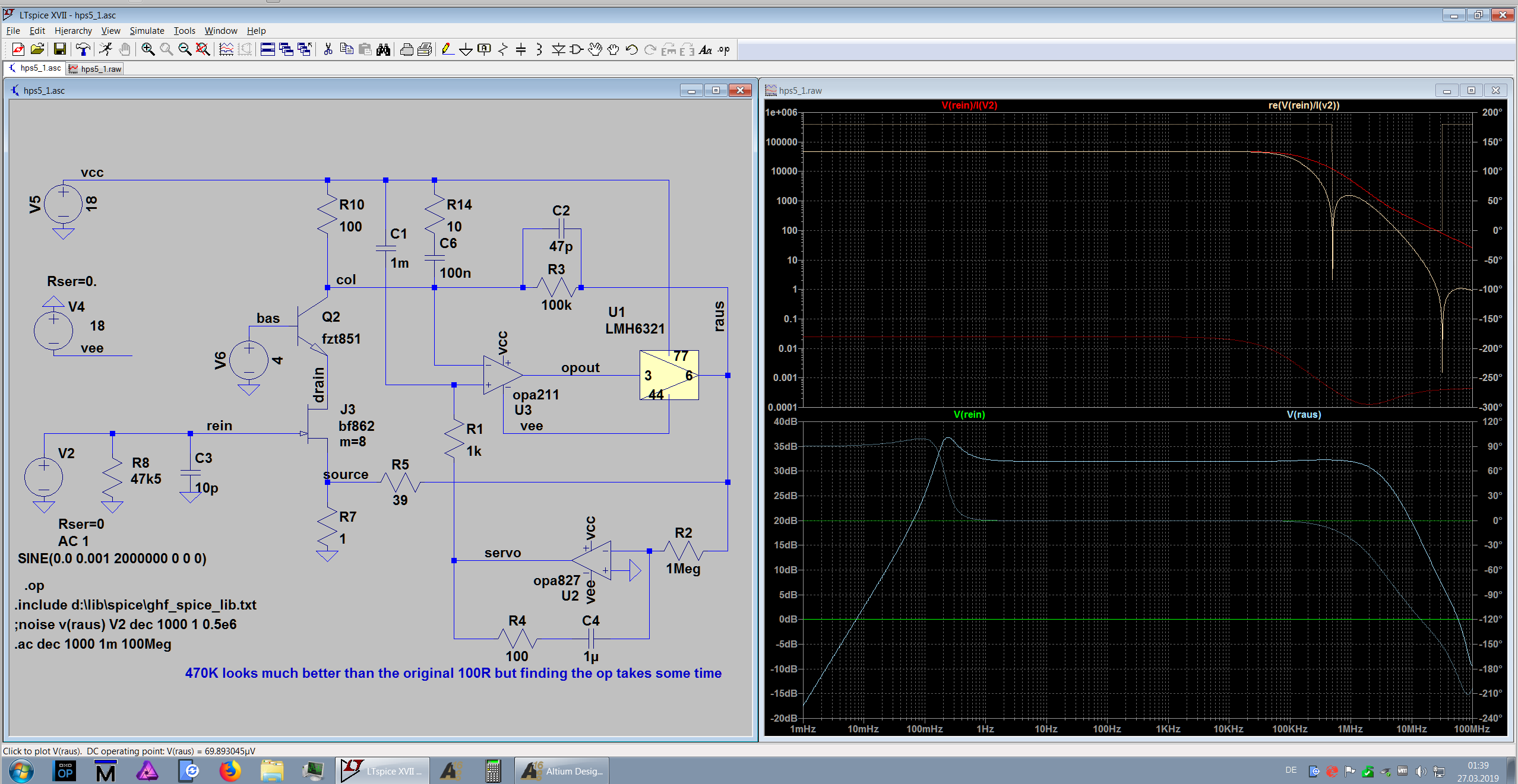

If it's possible, then why did you not do it?
Your HTS5.1 already failed in simulation, you have never proved the contrary
in more than 1 or 2 or more years. Negative real part of input impedance between
800 KHz and 80 MHz -> unstable with the right inductance on the input.
I have one that is both unconditionally stable, without feedback around some op amps
to the source and non-impressed by temperature; some people on diyaudio have it.
Obviously, I don't feel like proved wrong.
Gerhard

Tell this to the countless members that build it. Your simulation is obviously wrong, doesn't reflect the implemented final circuit (you missed even the servo circuit principle of pole-zero cancellation to avoid peaking), and you are looking in the wrong place, ever heard of "loop gain" and "compensation"? But I am willing to debug it for you, if you can afford my hourly rate. As a free benefit, you could then stop sleeping with this wrong simulation under your pillow, ready to pull it anytime when you see my posts. This behavior is exclusively licensed to Andreas, with my PLL noise results.
BTW, a MC head amp is not a low noise measurement amplifier, but don't worry, be happy, and enjoy your grudge :rofl:!
