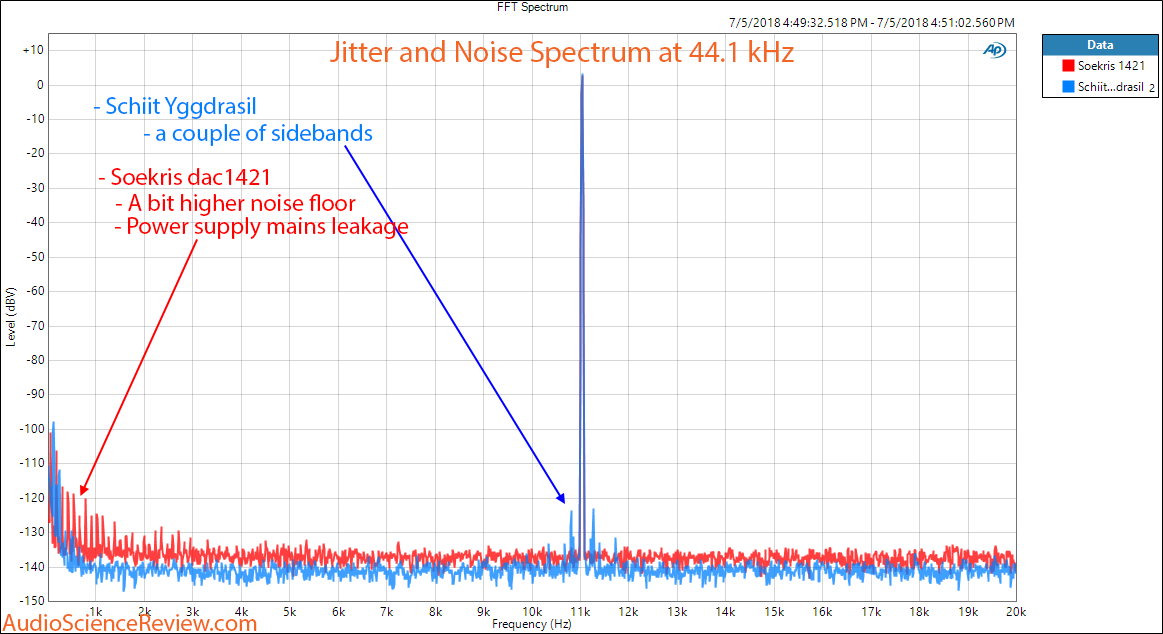

Discussing audibility, I don't see scaling back to 1 Hz is meaningful!?
No level matching? There goes objectivity of test.and the best test to understand what is better is to do a blind test where the listener does not know what he is listening to and tells you his feelings. but the increase in overall silence in the system, the increase in bass extension is irrefutable and beyond measure in my opinion.
Sound measuring devices today can measure what you can hear and beyond.it's like comparing a good power cable to a basic one ... we can't measure the differences on an instrumental level but only by ear, this is also a perception !?
What you've described is called anecdote, not evidence.only a fool full of convictions and prejudices can deny the evidence.
You won't be able to hear what the sound measuring devices today can pick up. Try -150 db noise for example or 30KHz.this is my experience on Andrea's work. comes from more than 20 years of audio. @ syn08 and companions, you are misrepresenting this forum, this is an audio forum and as such most of it cannot be measured but only heard
Correct me if I'm wrong, since it's audio, the audible traits would be the main focus.Improve a digital audio product. 😉
So far so good?
Next, a question, what does or did upgrading to Andrea's oscillator improve for audio?
Marcel says the measurements are 22 dB "to good". That would mean that the worse clock is creating a visible widening at -85dB and the Andrea clock is still down at -115.
Detectable territory? (-85dB)
Are FFTs being misinterpreted here - maybe those experienced in FFTs can answer?
Is the FFT plot a graph of power signal density - in other words a statistical plot of how much time the tone is rendered incorrectly at the various close-in frequencies to the fundamental?
Does the -85dB mean that tone is incorrectly rendered -85dB down from the fundamental or does it mean that the tone is incorrectly rendered at full power but intermittently at some percentage of the time i.e a density plot?
If this is the case (& I don't see why not), how does auditory perception perceive this type of spectral spreading of all the tones in an soundfield as the sound envelope progresses over time? It seems to me that this spectral spreading over time would affect soundstage perception (a already mentioned) but also timbre & other elements in the soundfield that require consistent rendition over time.

Because our dear TNT is the one who can't hear any difference between a 30 cent and a SOTA oscillator.
But he hears huge and clearly audible difference when he replaces the source for his Soekris DAC.
He is measurements obsessed and asks for solid proves about the audibily difference between clocks, but the measurements don't matter when he uses his golden ears listening to Soekris DAC.
So he wonder "Detectable territory? (-85dB)" about oscillators, but he is able to detect -120dB when he listen to the Soekris DAC.
Do at ASR they use a miracle source?
You're adding 22 dB to a number that I already added 22 dB to. At 10 Hz offset, Joseph measured -147 dBc to -148 dBc in one bin, so about -126 dBc in 1 Hz.
Anyway, my calculation is way too optimistic, so there must be some other effect that dominates.
Correct, sorry for the error, "only" a 78dB gap to cover.
Looking at the Joseph measurements, noise floor is some -170dB which renders a SNR (again counting the process gain of 22dB) of -148dB. A 24 bit ADC like the one in the RTX has a theoretical SNR of -146dB. Interesting result, maybe synchronous averaging was used kick down the noise floor? That would be opening another can of worms, though, since synchronous averaging has it's own jitter contribution...
