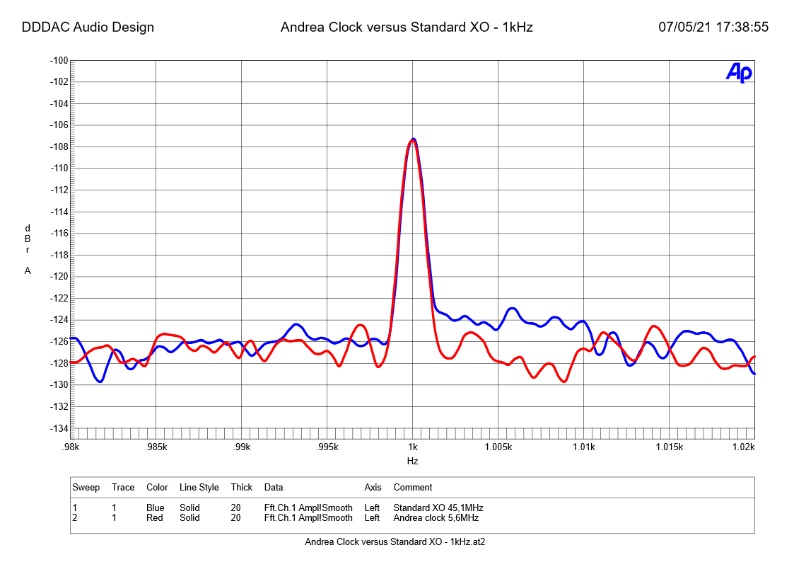

FFT on DAC Outputsignal - looking for skirts
I tried with Arta with a 24bit 192kHz ADC and also with my AP at low bandwidth and surpression of the main signal to gain extra headroom.
I used one and the same DAC and only swopped the standard cheap XO for the Andrea Clock
Unfortunately I could not produce anything meaningfull (just a small difference with the AP FFT)
anyway, still wanted to share it here
