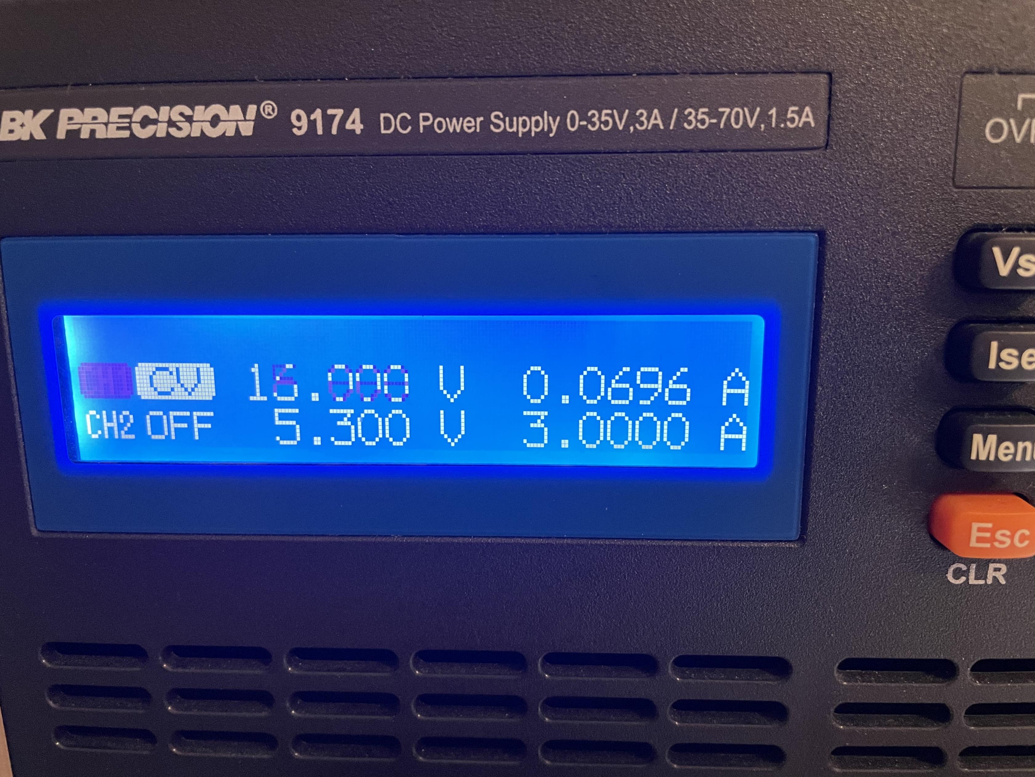

I tested the board and the squarer today. Worked fine with Vcc between 15 and 18 volt. Below that the sine is somewhat distorted.
Still I wonder if it is possible to have the Fifopi logic do the squaring? Was this already answered or discussed? I might have missed it.
As the squarer did not come with the sma connector, I can do sound test next week. I had to order them first at Digi-Key 😱

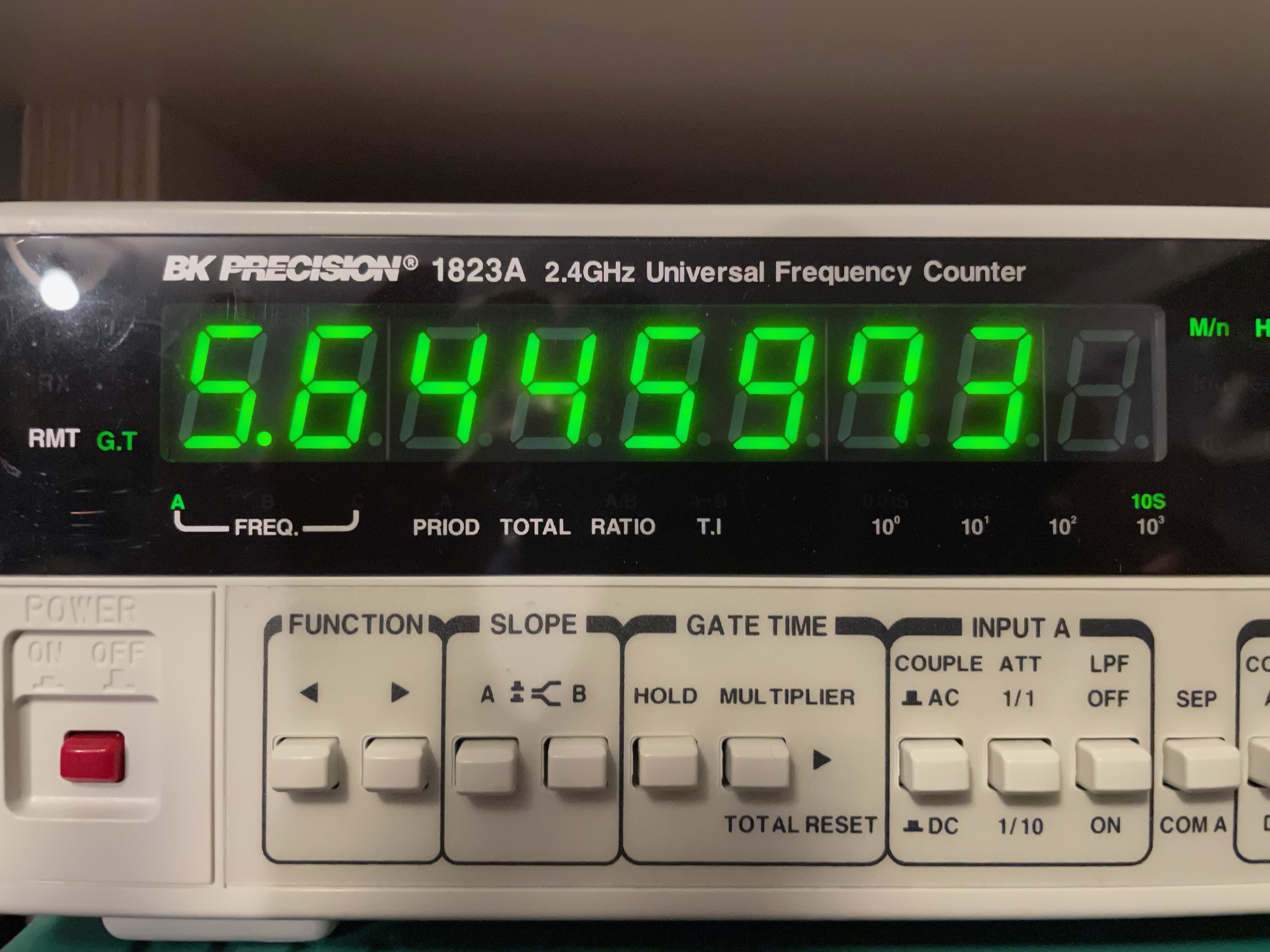

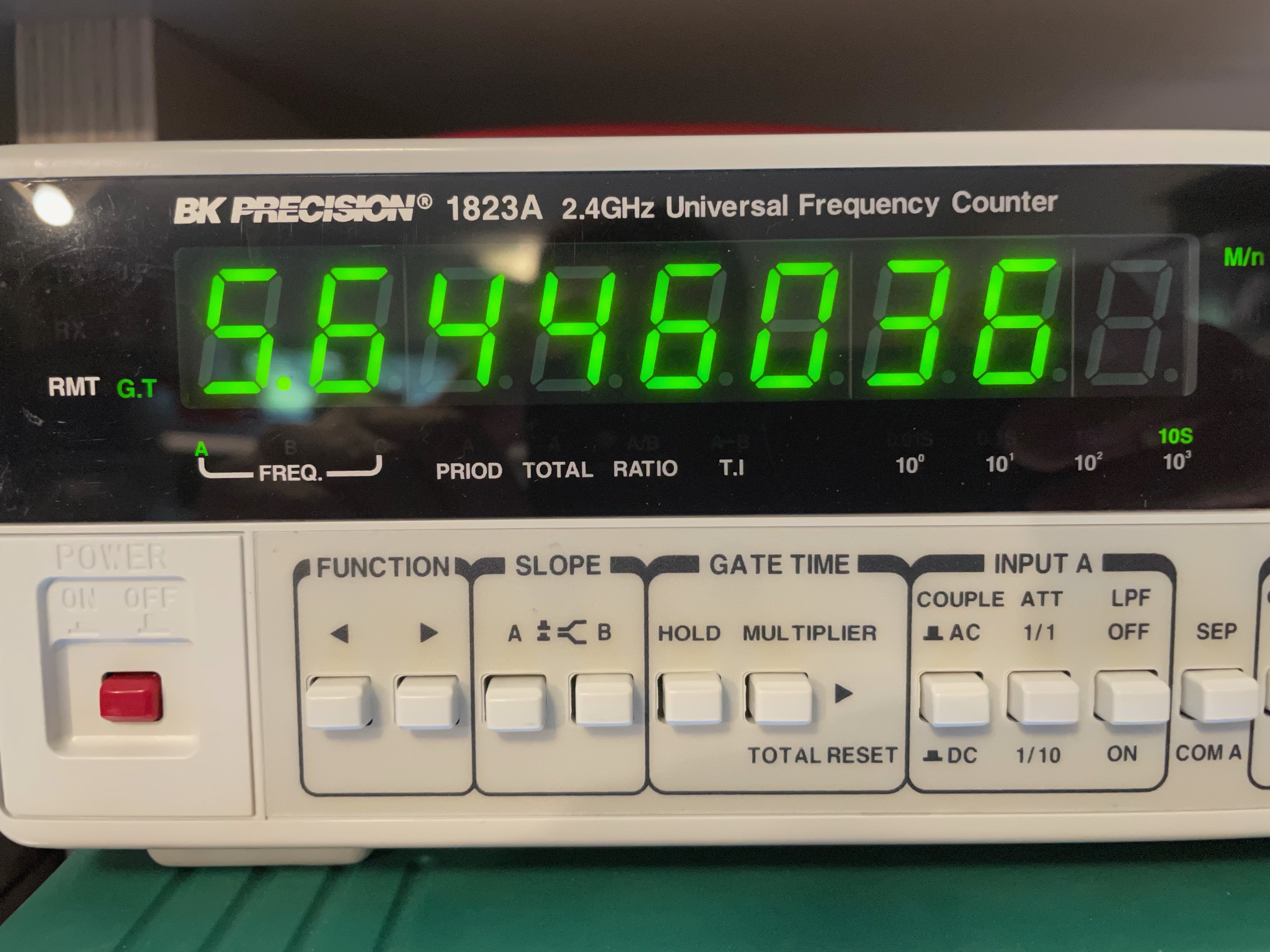

Below picture shows power consumption and the clock frequency at cold start and warm up situation

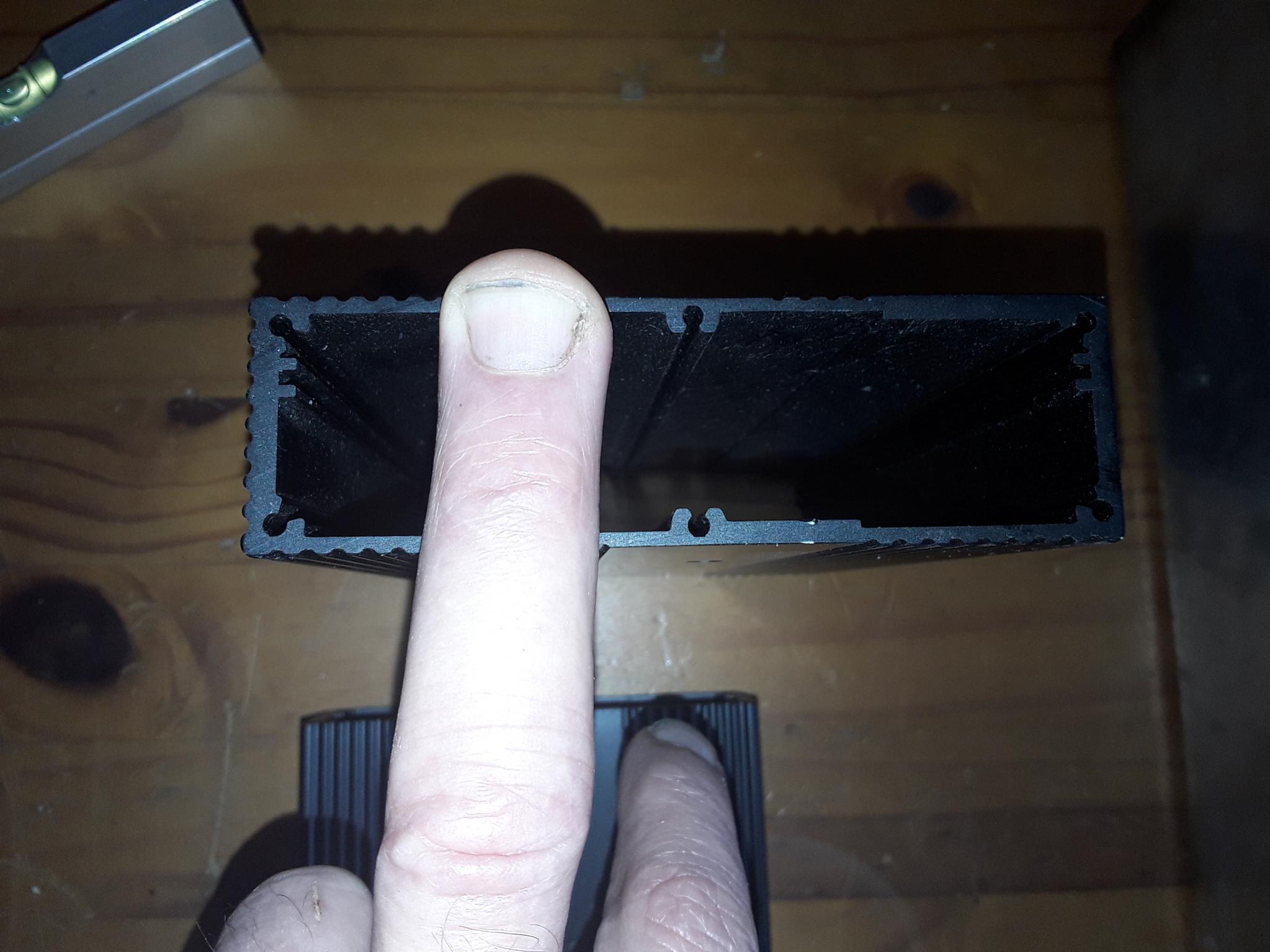

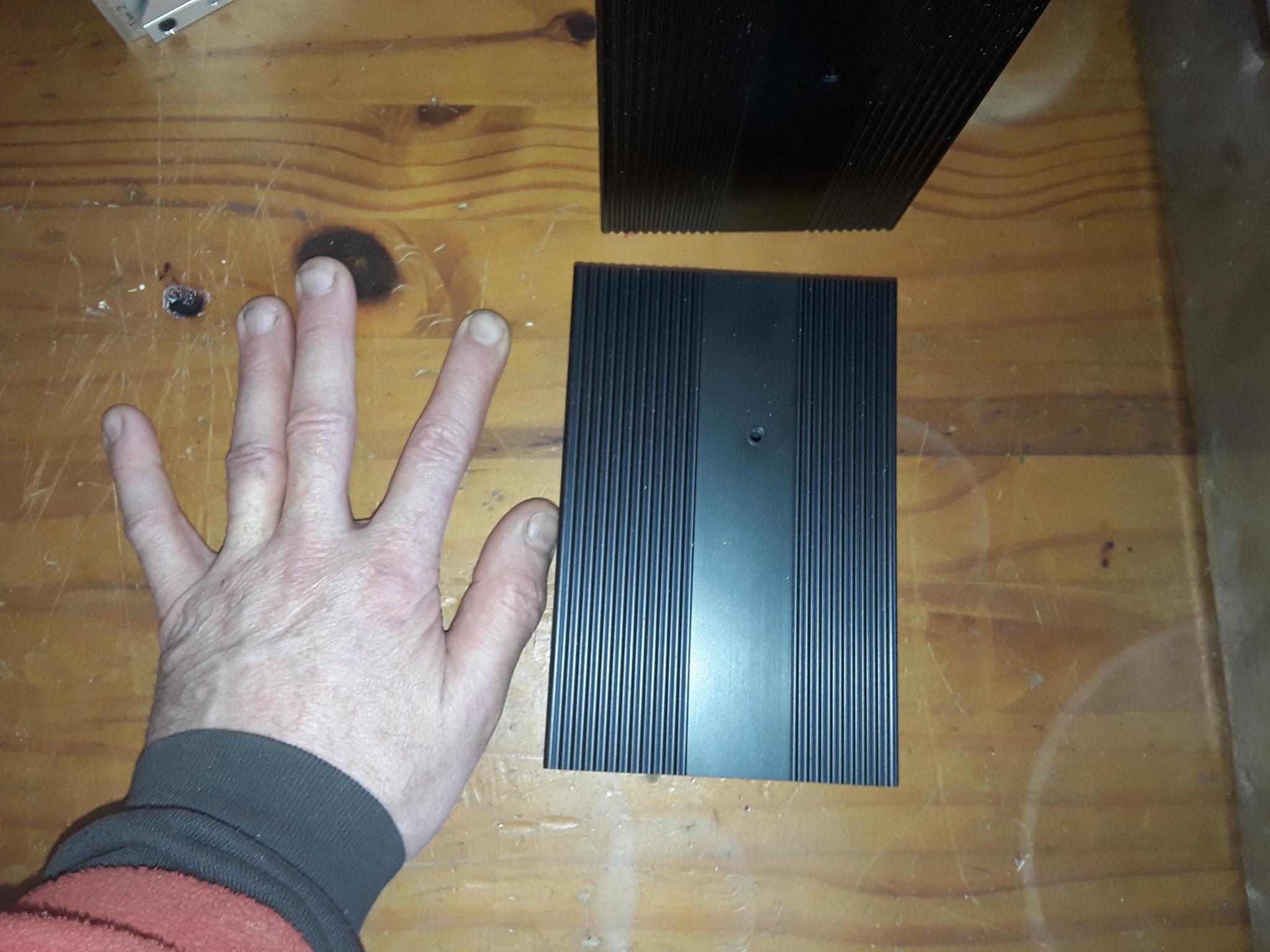

I found some rectangular aluminium in my stock that i could mount next to each other on one panel and on the front side i could give each rectangle it own front plate .
I remember from the past about making enclosure which are to " sturdy/ thick " sand will just add weight but no vibration killing properties. Make the metal kind of thin so it will have tendency to vibrate and then before it actually does stop it with sand.
SO probably not use anything to interconnect the 6 rectangles . Only the cables.
Make a thin aluminium? Box pour in some dry sand position the 6 rectangles on the sand and pour in the rest of the sand so the rectangles are kind of drowning.
You could rest the box on ........ or let it swing? If you will give it a little push would you hear that? I dont think so. Will an airborne vibration travel trough the outside box, through a few centimeter sand, than through the rectangular, than a little air and than through a cork to knock on the clock covered with a little felt?

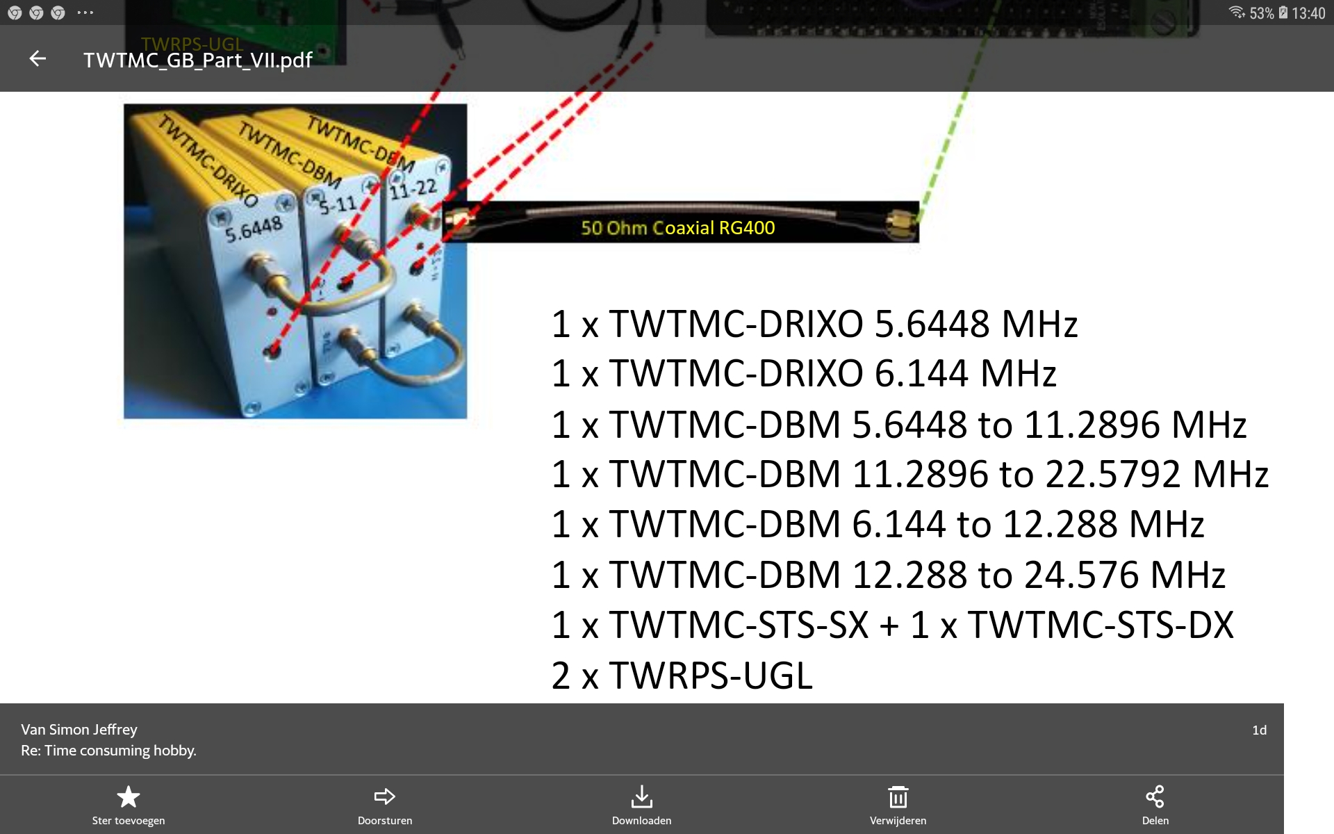

I've ordered RG400 cables of the proper length for my final set up.

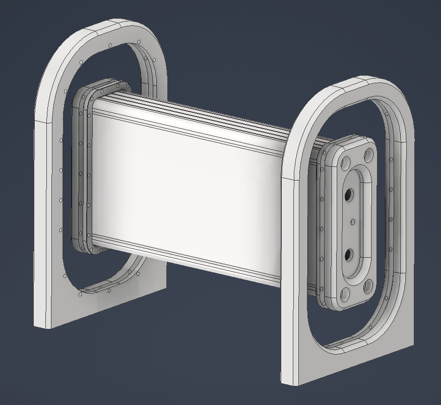

As vibrations seems to be concerning...
i am doing a suspended rig (with elastic band) that should isolate fairly good.
If that fails to isolate... oh well, at least i'll enjoy the view 🙂
a nylon elastic cord will be zig-zagged between pins in the channels.
If i don't get tired CAMming, surely i will share how it will look like once finished.
