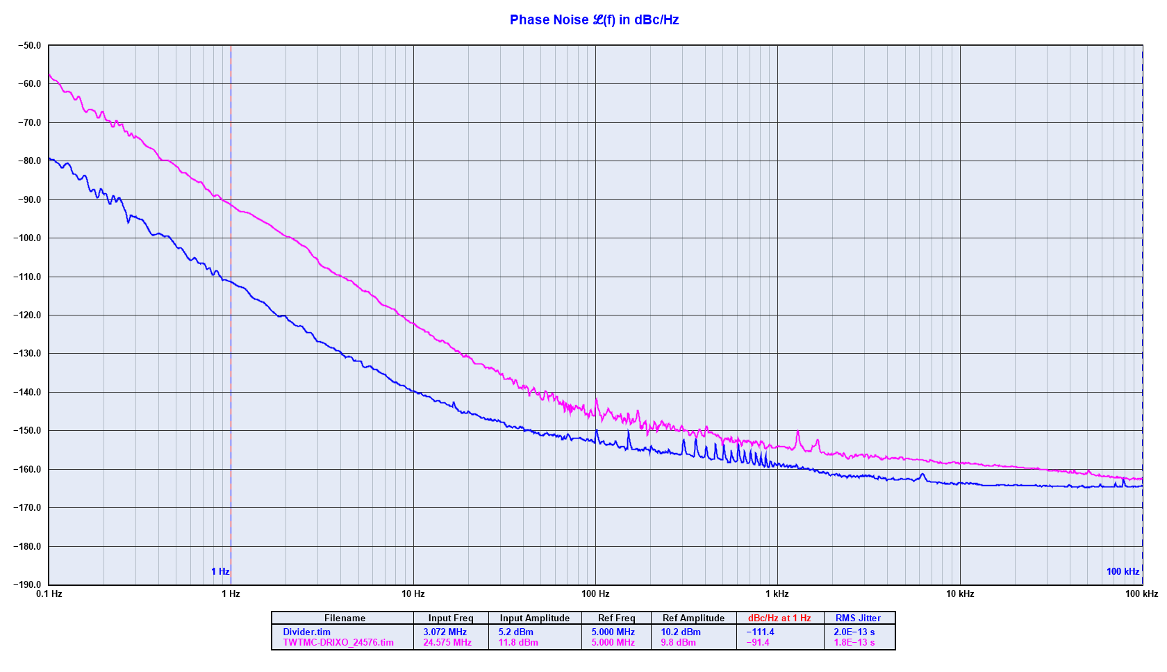

Exactly the opposite since the ordinary divider has better phase noise than the source (plot attached again):
- 22 dB better at 0.1Hz from the carrier
- 20 dB better at 1 Hz from the carrier
- 18 dB better at 10 Hz from the carrier
- 8 dB better at 100 Hz from the carrier
- 5 dB better at 1kHz from the carrier
- 5 dB better at 10 kHz from the carrier
- 3 dB better noise floor
And a regenerative divider could do better, we will try it soon, almost ready.

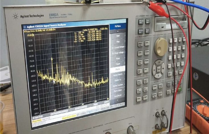

Poor guy, he doesn't have a proper tool to measure the phase noise. Unfortunately it doesn't go under 10MHz, so sometimes he has to use the other poor man's tool, the 89410A in phase demodulation mode.
The poor guy didn't read the manual of the E5052A or he knew how the cross
correlation thing with the 2 references works. But that worked much better in the E5052B.

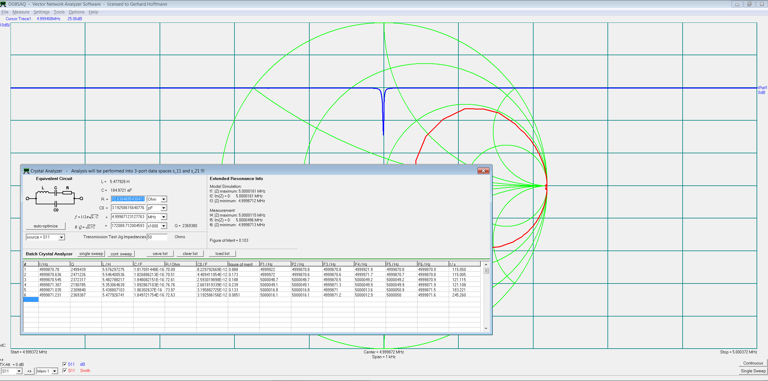

The SC cut crystal in the Morion MV89A is actually quite OK. Q = 2.4Meg @ 5 MHz.
That does not change much between room and oven temperature, only the
frequency drifts more at room temp. This particular Morion ceased to oscillate
at Vtune > 0.5V, so it was clear that it was a candidate for autopsy.

Admittedly I have not studied the E5052A manuals closely, but somehow I don't think they mention something that is not already well known for quite some time https://tf.nist.gov/general/tn1337/Tn190.pdf p.245 and the following (which I am sure you are aware of). Unfortunately I don't have a low noise double balanced mixer to use... and yes, I have no clue how to design one (and not planning to learn, life is too short, there's a bigger fish to fry for me) 😀. True, the E5052A is not that great compared to the E5052B. I wish I had an E5052B but, short of blind luck (which I already had with the acquisition of the E5052A, so...), that would require a second mortgage.
Your 89410A might have a problem. While indeed the noise floor is not that great (yes, the 12bit converters are poor in this respect), 1/f noise has nothing outstanding. It won't let you determine the low order Leeson constants, but for very low frequency measurements is good enough, see the screenshot I posted early, where the b-4 point is clearly visible, shortly before 0.1Hz.
The only difference between the 89440A and 89441A is the down converter. The 89440A is 1.8GHz, the 89441A goes to 2.65GHz. Other than that, the base band instrument (the 89410A) is the same, although I've seen an 89410E (if memory serves) that has a LCD screen and possible other improvements.
Neither do I. Since I am currently dabbling with oscillators, here's so far my best shot. A 0dB 6.144MHz sine, from a fractional PLL, using a MTI Series 225 VCOCXO (the best of the best, space grade, long live EBay, got it for almost free 😀).
Note: the chart shows L(f), to get S(f) add 3dB. -110dBrad^2 @1Hz and -124dB @ 10Hz is not too shabby, but a far cry from what they are claiming <-120dB @ 1Hz and <-148dB @ 10Hz, I haven't seen such numbers even for sapphire oscillators (normalized to frequency). Note the b-4 break shortly before 0.1Hz.
I've posted this here before but for your benefit 10MHz with 1Hz, -123dBc
10Hz, -148dBc. Full schematic in paper. You are welcome 🙂

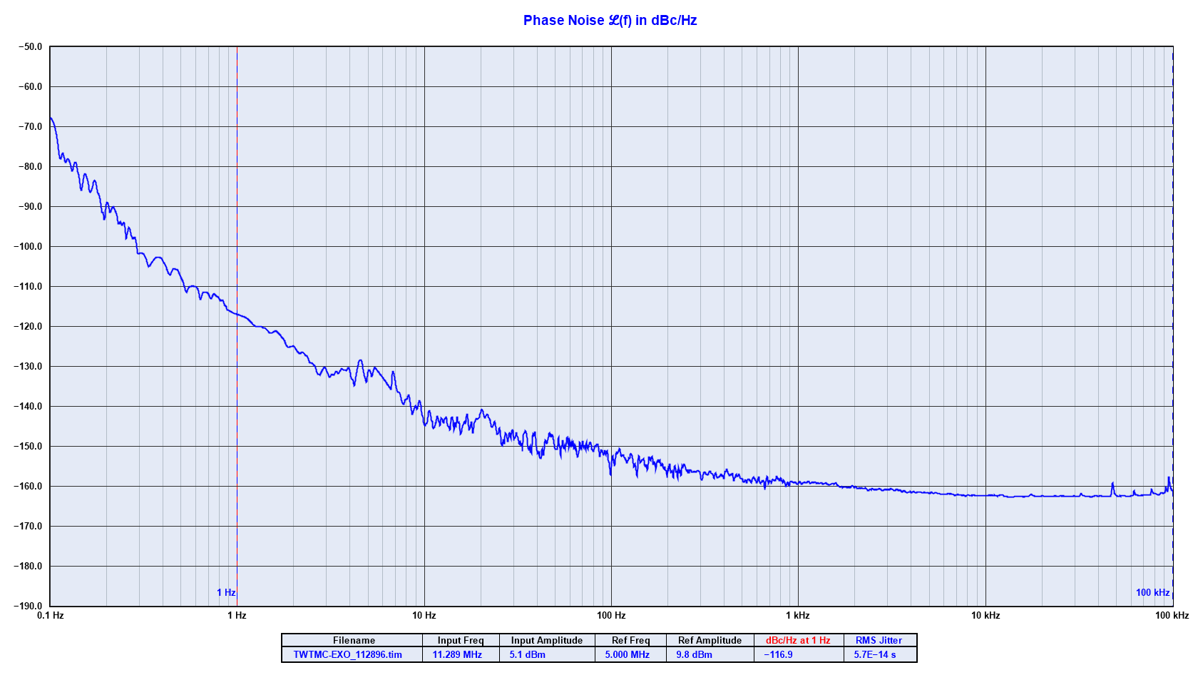

Indeed, as I already said, it's the starting point for the EXO oscillator, although we have made several changes to get it working with a single supply rail, we have added a pair of buffers and so on.
Of course, no PLL to get such performance (and several iterations for us).

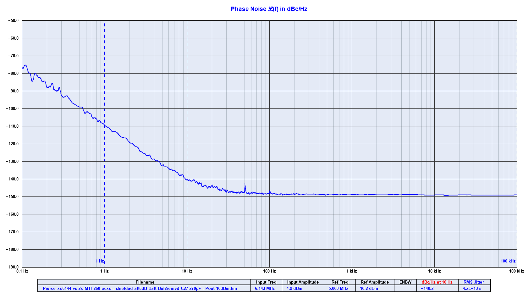

You should add the Pierce PXO at 6.144 MHz since the poor guys have measured -140dBc at 10 Hz from the carrier using an AT-Cut crystal.
But the poor guys are surely two cheaters.

Thanks, I've seen this before, did I ever said such an oscillator cannot be built?
I would kindly point you to the construction details in the paper, then compare them with a dangling PCB that is offered here. And please don't invoke "an oven is not required" argument, it's not only about stability, it's, as I already mentioned several times, about shielding, EMI, and other such issues that dominate at those levels.

And what does the article prove, other than it is possible to design a good low noise oscillator? Does it prove in any way, shape or form your claimed performance?
But then you, your colleague, and a few others remind me of a pack of wild dogs, waiting for anybody raising reasonable doubts, or making suggestions, to maul them good. Good luck promoting this BS for audio, good luck with the sales to the (for you) useful idiots that are the innocent audiophiles. I'm out of here, be happy.
I am not sure where all this anger came from or the need to insult those of us who value this group buy. But leaving may be the best option if you cannot be constructive.

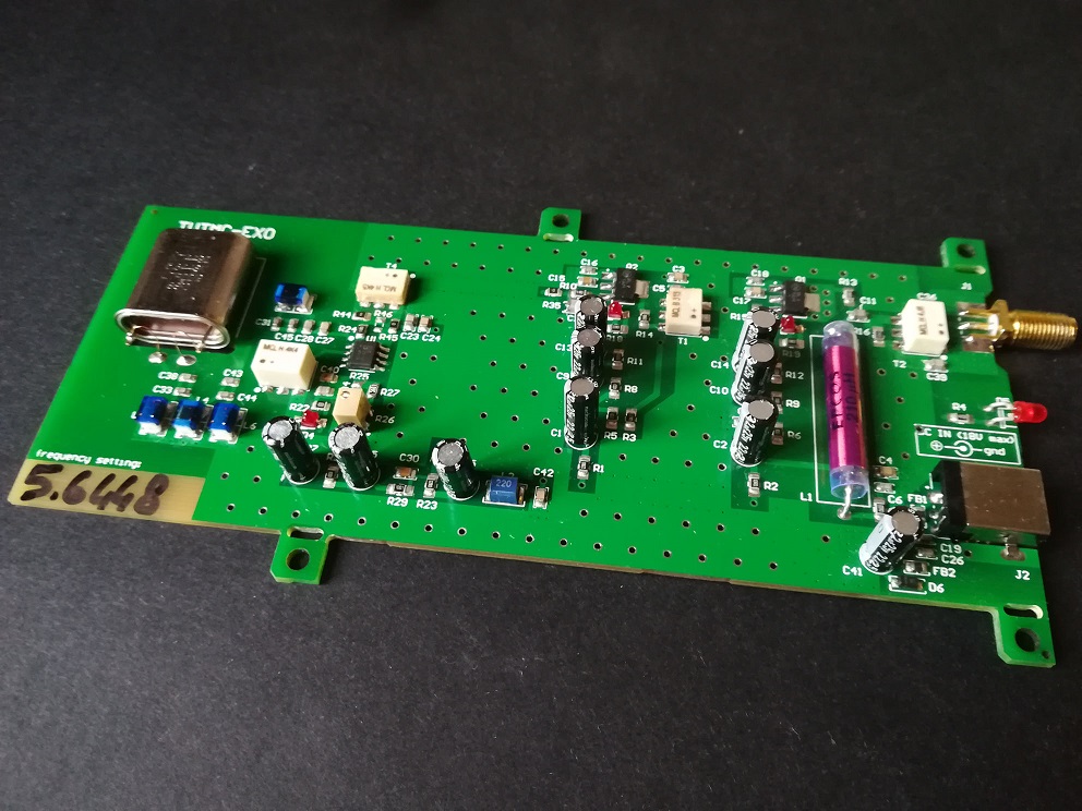

Now the poor guys don't even know how to design a RF PCB, they have to learn from the smart engineer.
But the poor guys are lucky again because the performances they got with such dangling PCB are remarkable.
And looking at the plot, EMI and other such issues don't dominate at those levels.
But by now we know, the poor guys are lucky or maybe they are just cheaters.

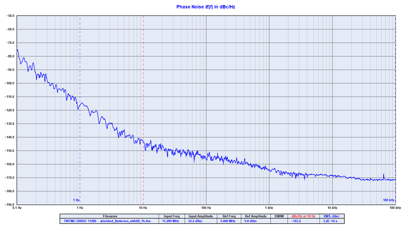

A quick first report of the TWTMC DRIXO (11MHz and 12MHz) Compared with TWTMC-D DRISCOLL (even frequency)
It is very positive, the space and the dynamics between the different instruments is increased, so we have a wider and deep sound scene, on certain pieces like for example 'Woman in Chains' of Tears for Fears, recording is such that it can quickly become aggressive and thrown forward, nothing of this with the Drixo, the voices are not aggressive or thrown forward, they stay there or they must be, but what immediately impresses me It is the quality of the bass sector it's very dynamic.
I will put the card in a chassis and leave the crystal to break and I would take a report
