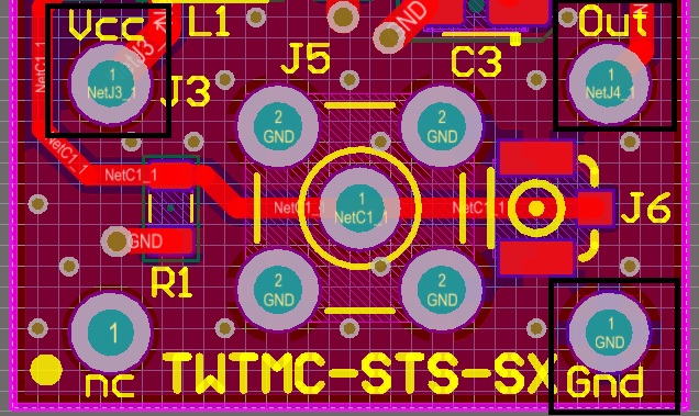

Andrea,
Can you tell me another information from squarer?
Input-output, PSU connections ....
Since you don't use the FIFO I refer to the TWTMC-STS-SX.
Input: 50 Ohm sine wave, SMA or u.fl connector (SMA recommended)
Output: 50 Ohm square wave (3V3 CMOS), pin header
Board size: 21mm x 28mm
Power supply: 3.3 Vdc 15 mA
For the connections please see the attached picture.
Andrea, thanks for the info.
What output cabling would you advice for the TWTMC-STS-SX ?
Should we use 50 Ohm coax, soldered to the output/GND pads on the STS-board, or shielded twisted pair wire would work as well?
I guess short cabling is best, but how long would you say the output cable can be before there is could be a problem?
