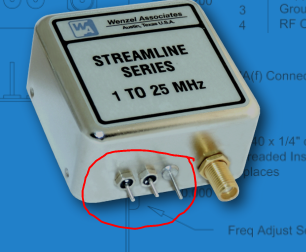

The best low frequency shields are magnetic. Mumetal works well but needs to be annealed after fabrication. Steel also works if thick enough. I have seen references to 18 Gauge in the past but that's fuzzy memory. For high frequencies you need conduction. Silver plated copper or brass works very well if there are no holes or slots (sounds like PCB ground plane recommendations). Remember you are both keeping the noise out and the RF in. Use feedthrough caps to connect through the housing, the Wenzel connections shown below are a good example of RF safe connections. The feed through prevents much RF from getting in or out of the enclosure. And try to seal up seams with RF gaskets if you can. Its why the commercial OXCO's are sealed with solder.
