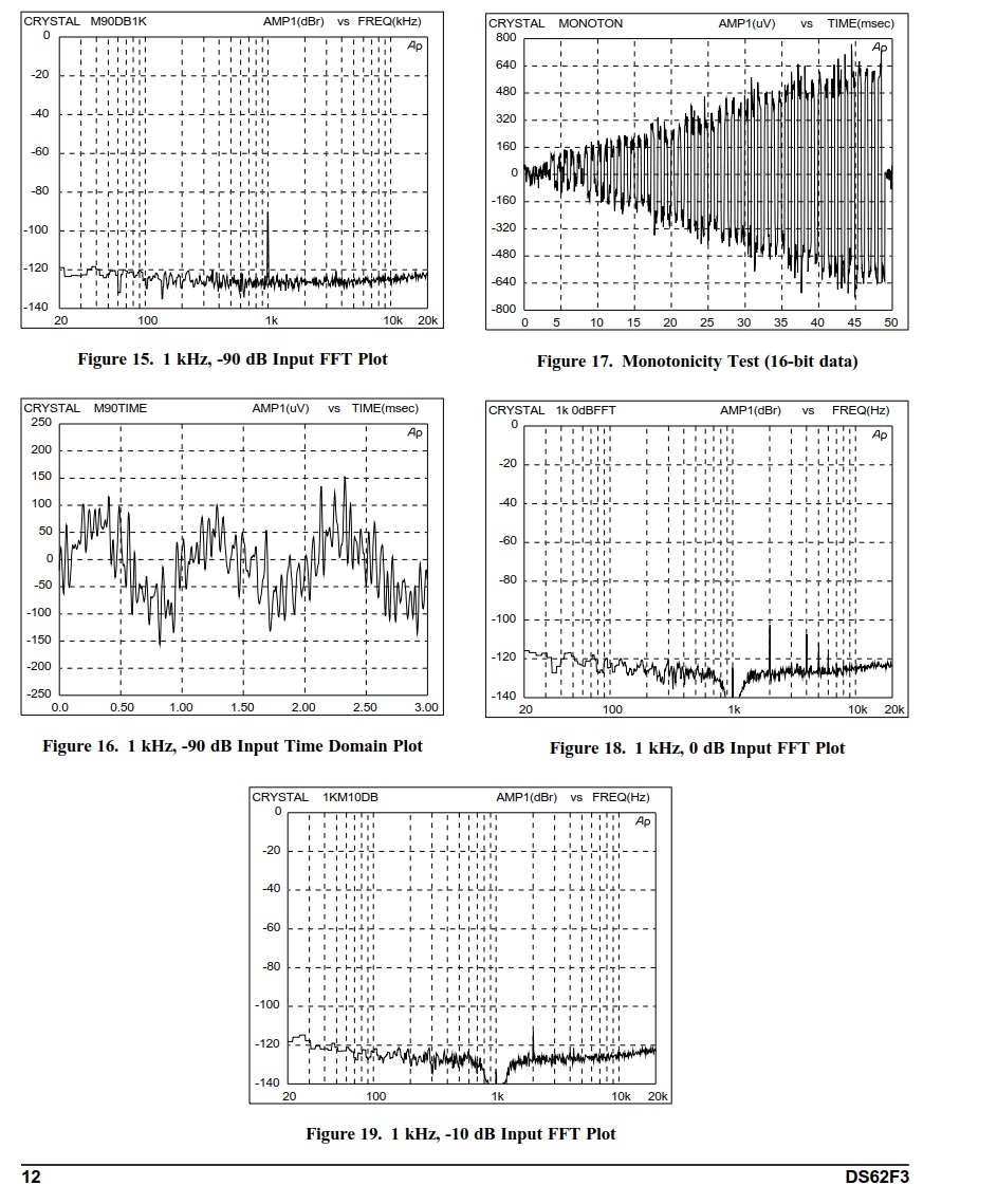

Hi Terry.
I you referring to the figures 15, 18 & 19 in the datasheet?
The data sheet I have shows FFT's on P12. Here....
