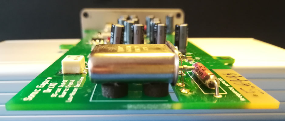

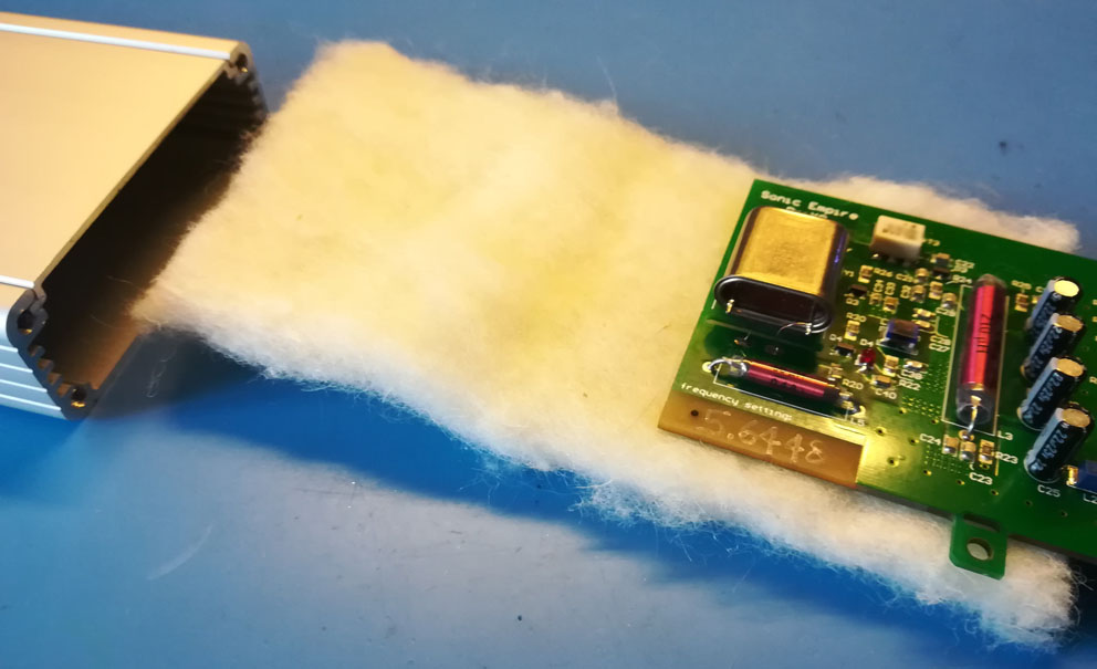

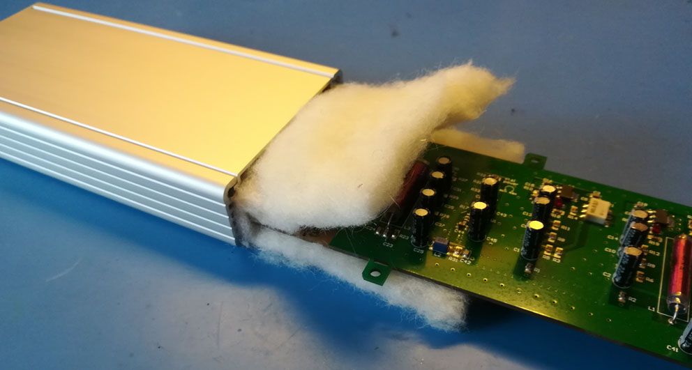

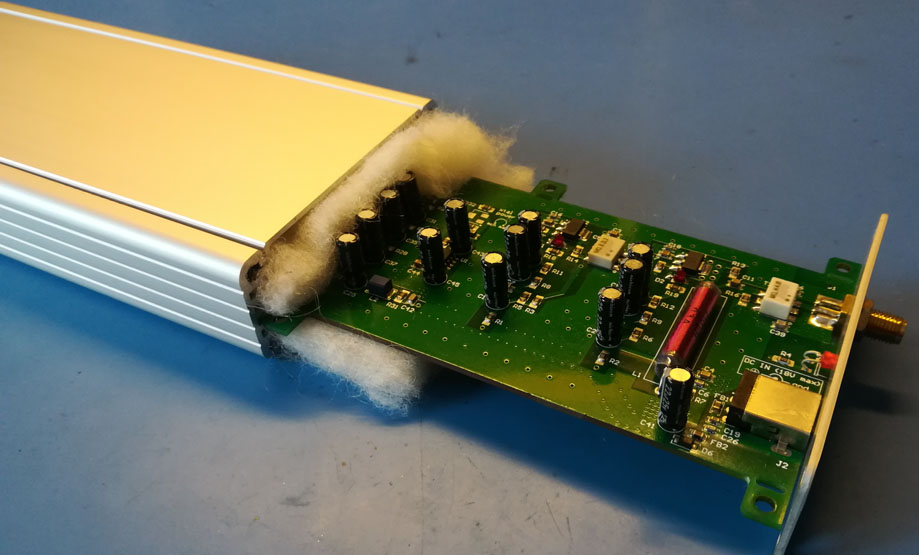

Vibrations and thermal coupling.
I attach a few pictures to show a good way to place the crystal on the board.
You can use a pair of neoprene cylinders to decouple the crystal from the board, then you can wrap the oscillator section with a polyester fiber or wool foil.

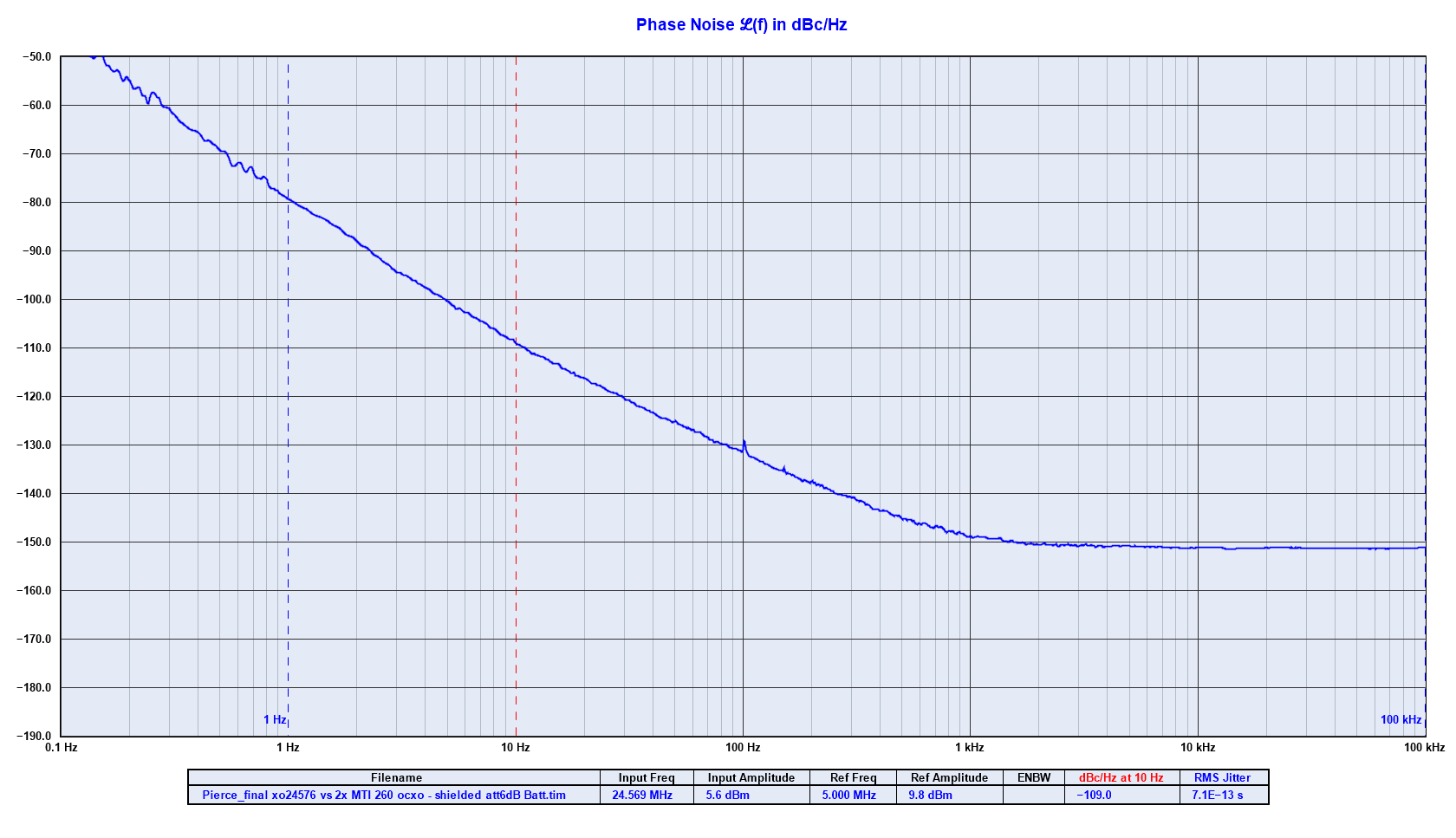

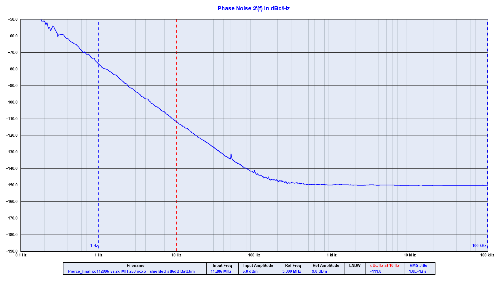

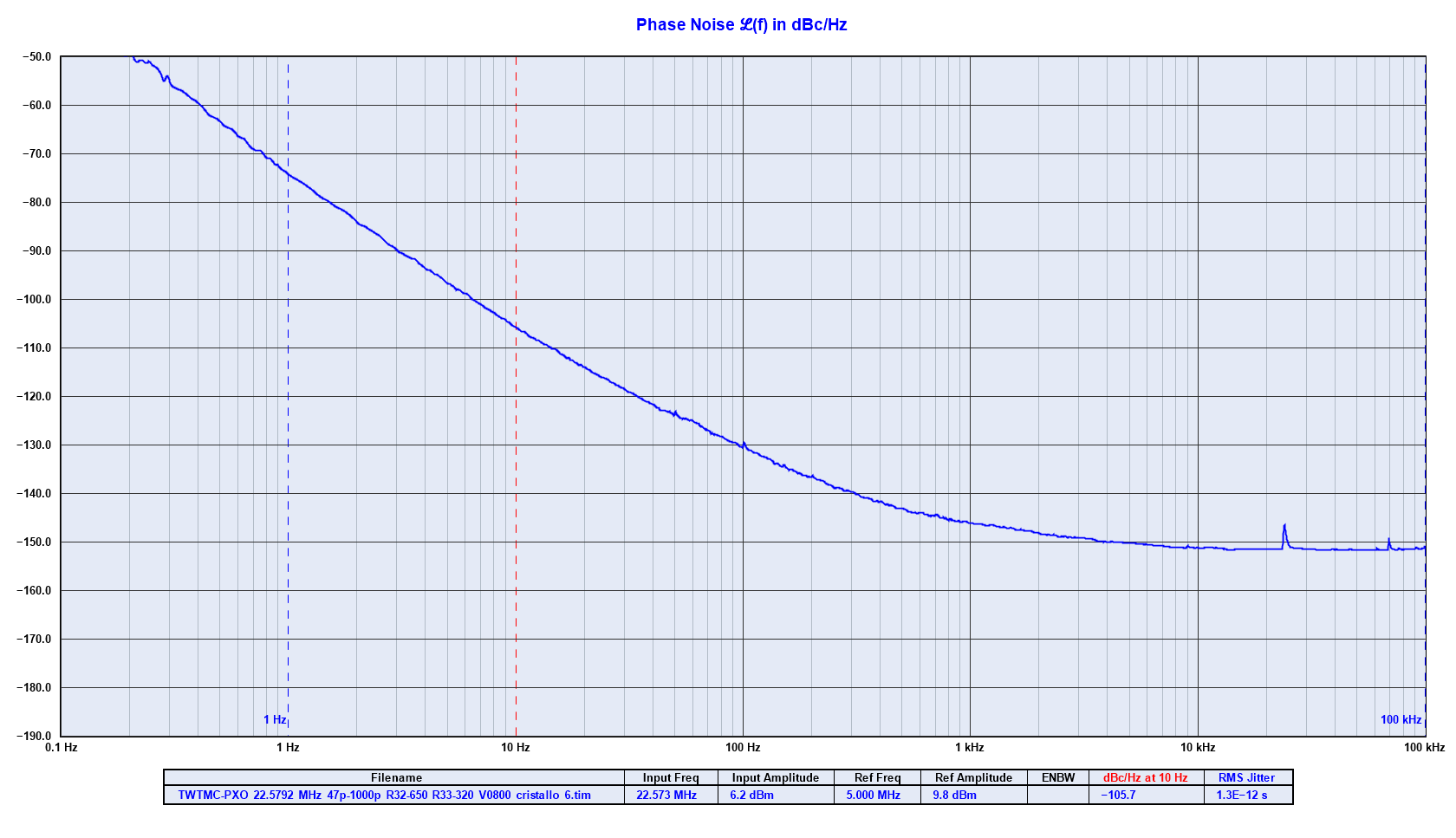

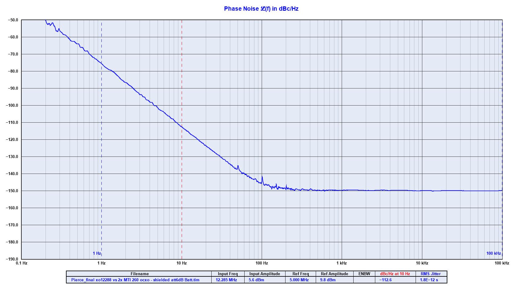

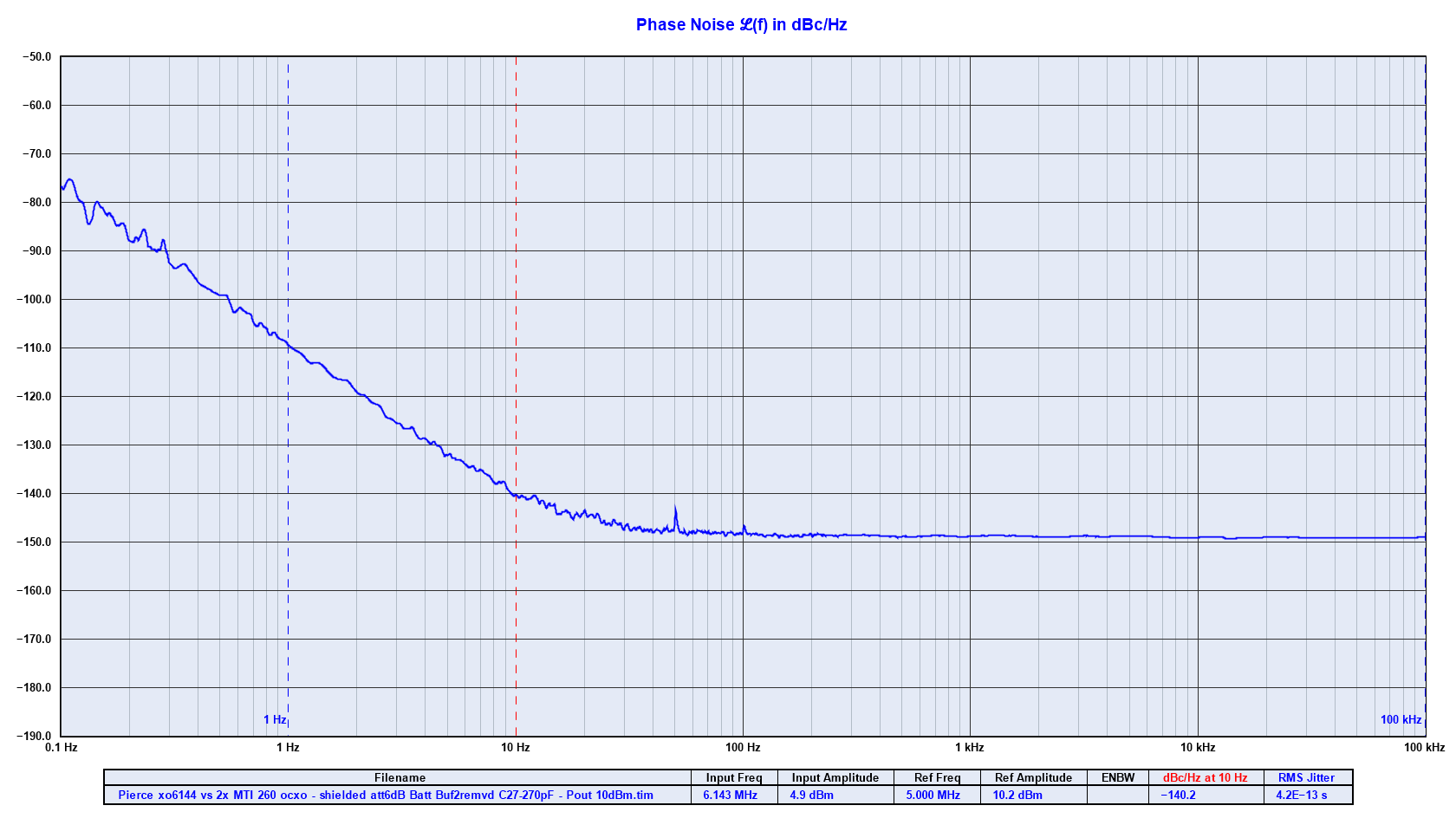

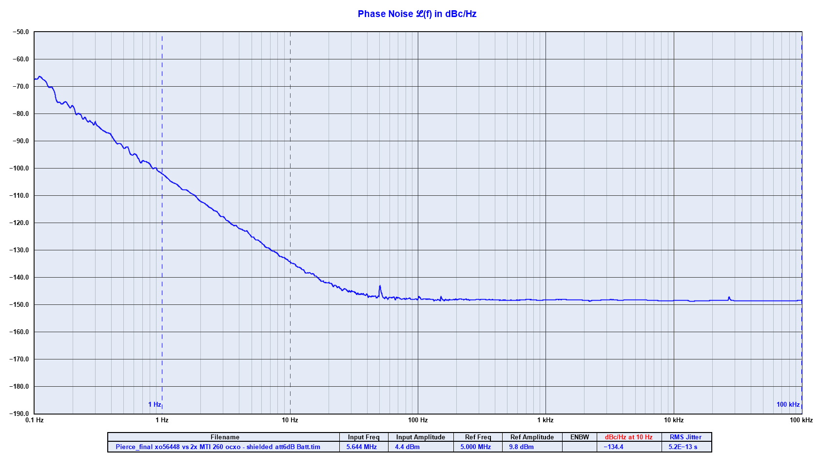

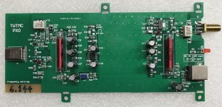

New Pierce oscillator TWTMC-PXO from 5/6 MHz up to 45/49 MHz
I attach a picture and the phase noise plots of the new Pierce oscillator from 5 MHz up to 24 MHz (we cannot measure 45/49 MHz due to the upper limit of the Timepod).

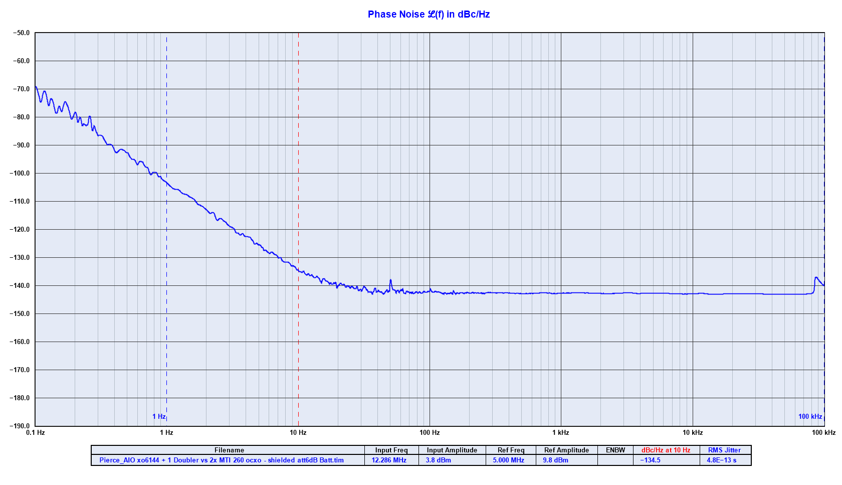

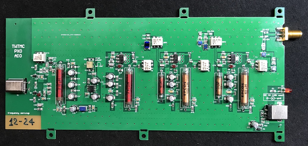

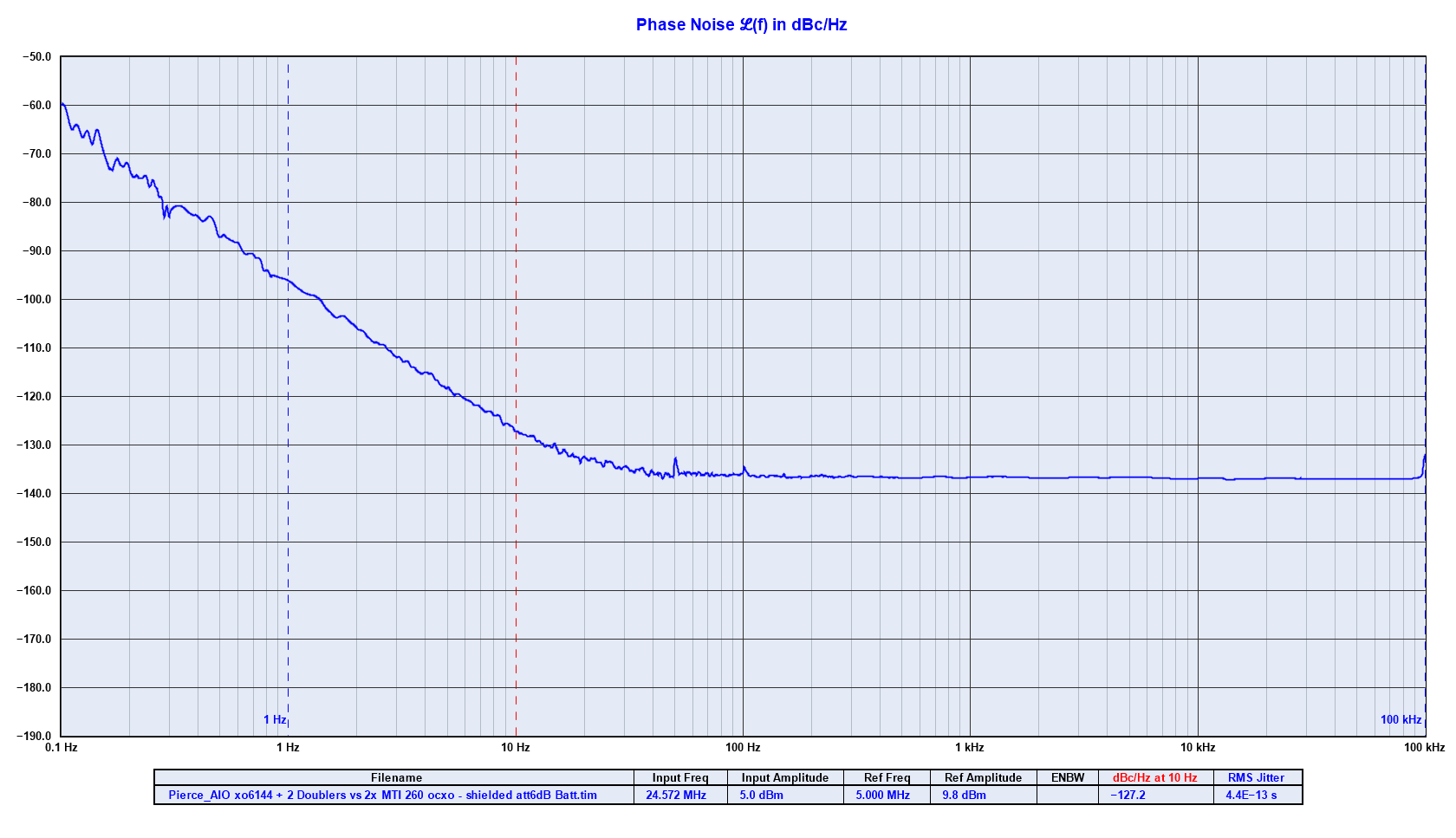

New Pierce All in One oscillator TWTMC-PXO-AIO from 11/12 MHz and 22/24 MHz
I attach a picture and the phase noise plots of the new Pierce All in One oscillator. The base frequencies are 5.6448 MHz and 6.144 MHz, then there are a couple of frequency doublers to provide 11.2896/22.5792 MHz or 12.288/24.576 MHz (output configurable).
The phase noise performance are very good for a AT-Cut crystal.
This combo oscillator could be also used to multiply 6 and 6.25 MHz for those who need 24/25 MHz.

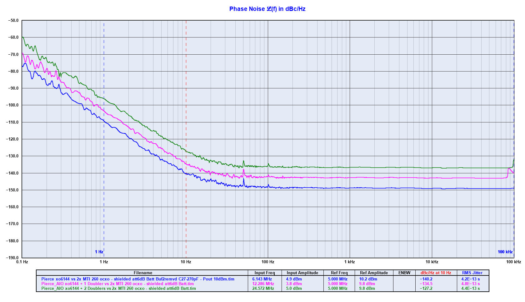

I forgot a plot related to the TWTMC-PXO-AIO, this is the comparison between the base oscillator at 6.144 Mhz and the multiplied output at 12.288 MHz and 24.576 MHz.
The theory is confirmed again, around 6dB was added for each duplication.
