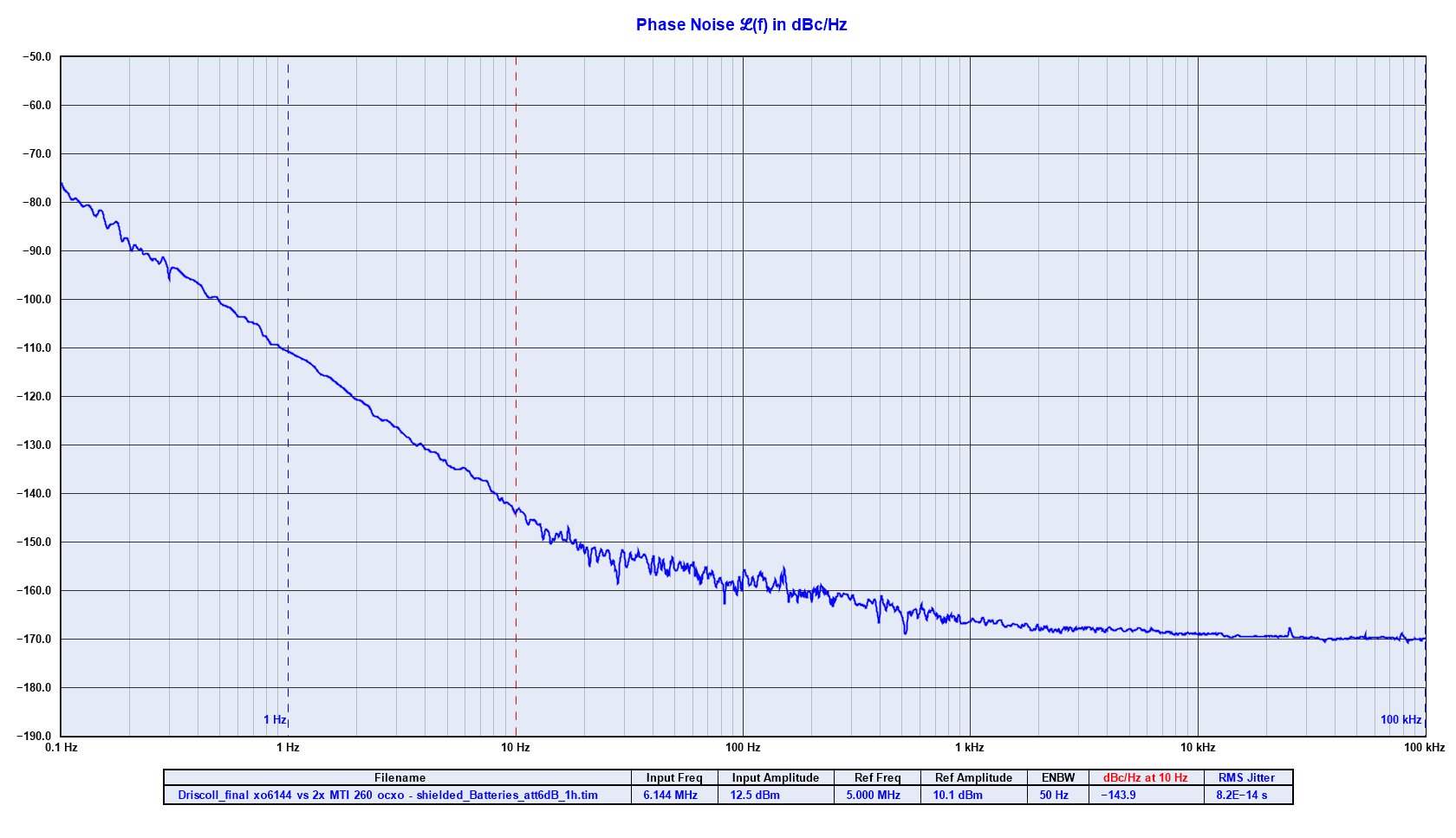

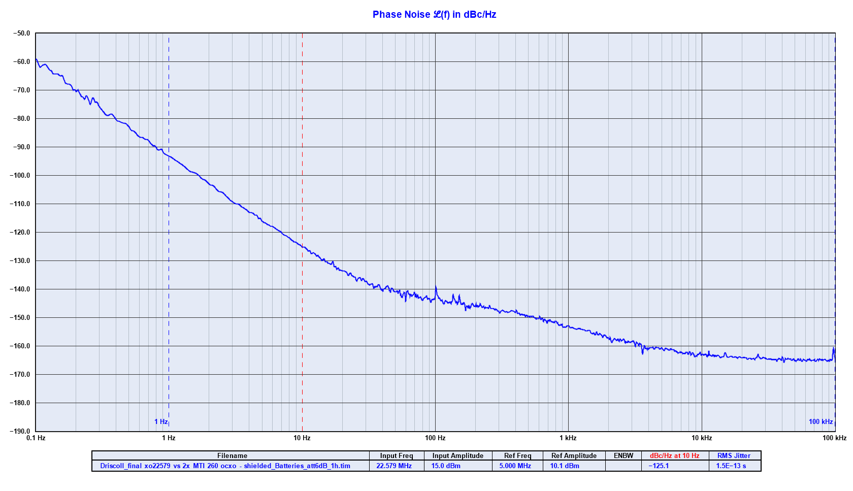

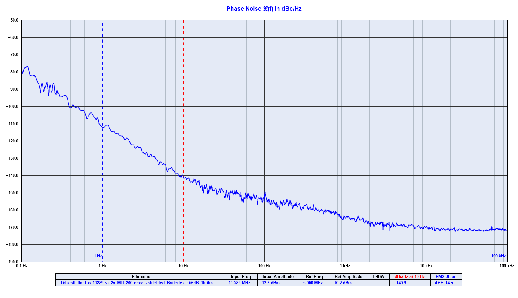

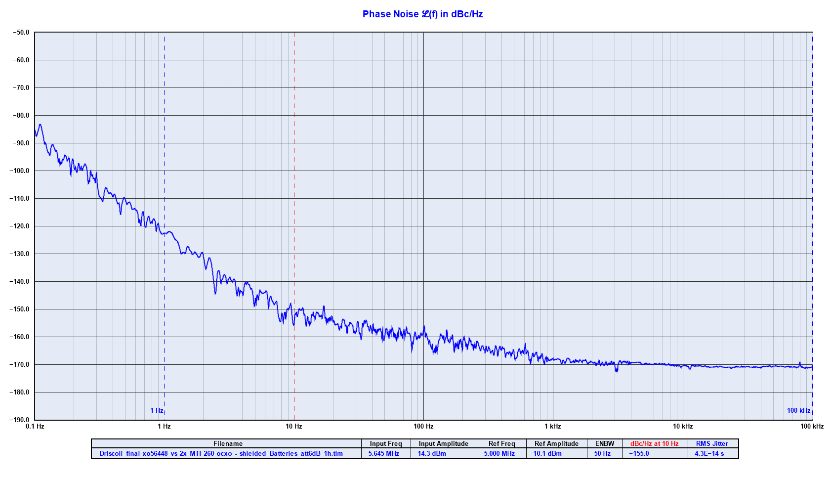

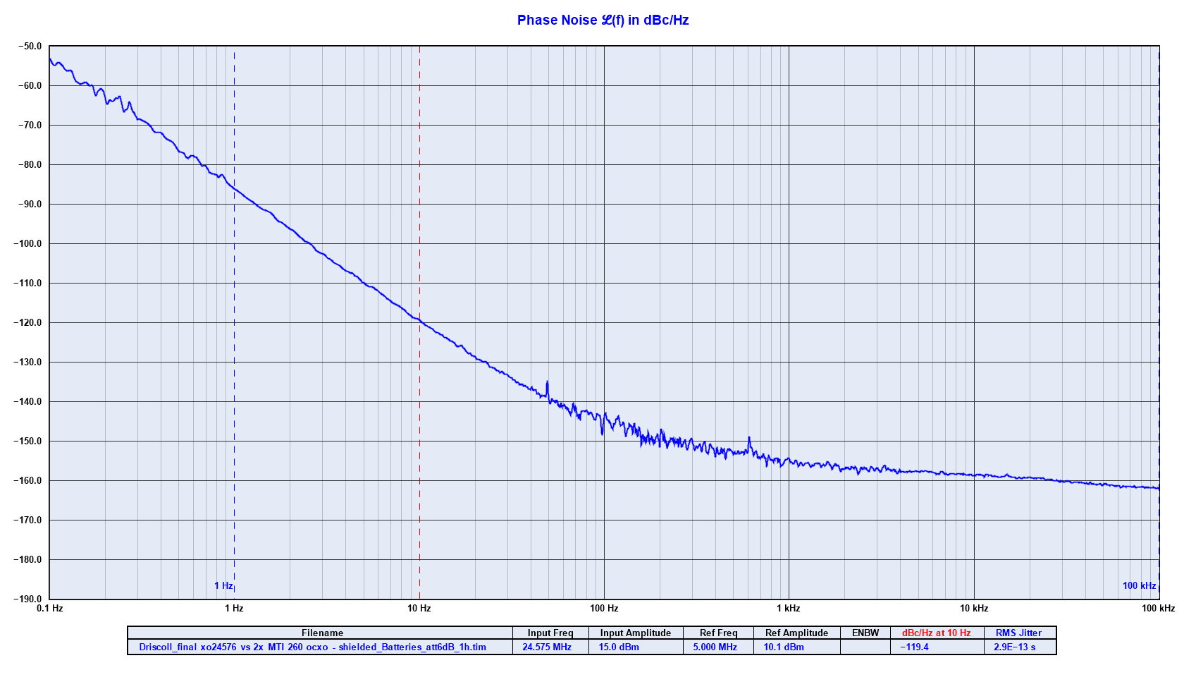

TWTMC-DRIXO Driscoll oscillator final measurements
After a few tweaking I attach the final phase noise measurements of the new Driscoll oscillator.
Driscoll_final xo56448 vs 2x MTI 260 ocxo - shielded_Batteries_att6dB_1h.png140.8 KB · Views: 557
Driscoll_final xo6144 vs 2x MTI 260 ocxo - shielded_Batteries_att6dB_1h.png133.7 KB · Views: 548
Driscoll_final xo11289 vs 2x MTI 260 ocxo - shielded_Batteries_att6dB_1h.png138.3 KB · Views: 524
Driscoll_final xo22579 vs 2x MTI 260 ocxo - shielded_Batteries_att6dB_1h.png132.3 KB · Views: 506
Driscoll_final xo24576 vs 2x MTI 260 ocxo - shielded_Batteries_att6dB_1h.png132.6 KB · Views: 503

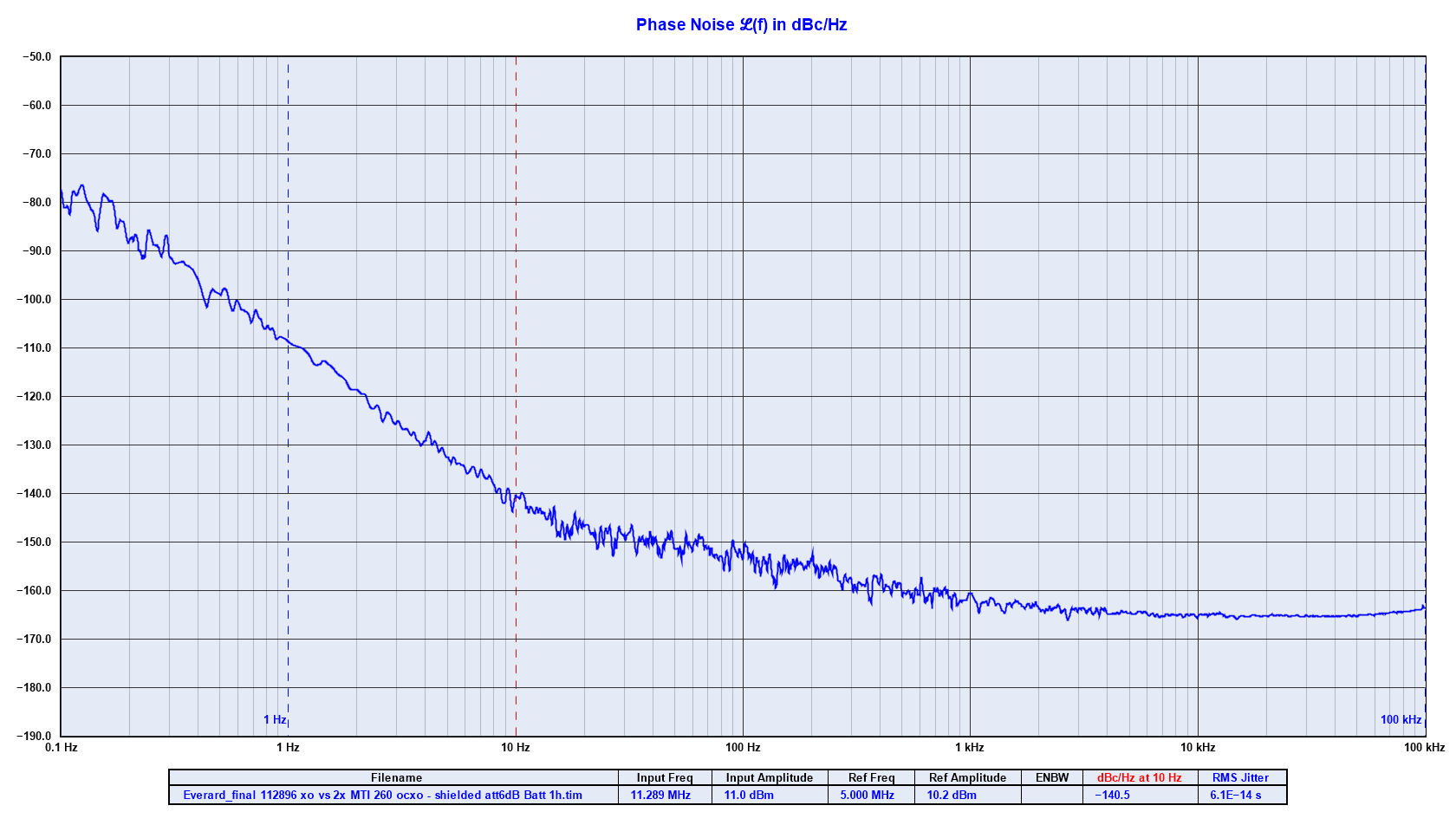

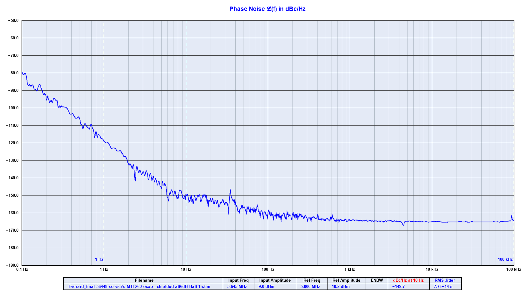

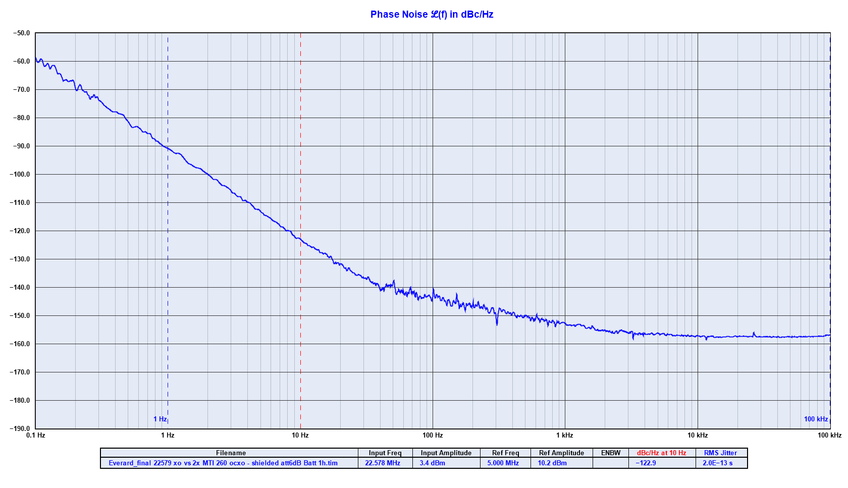

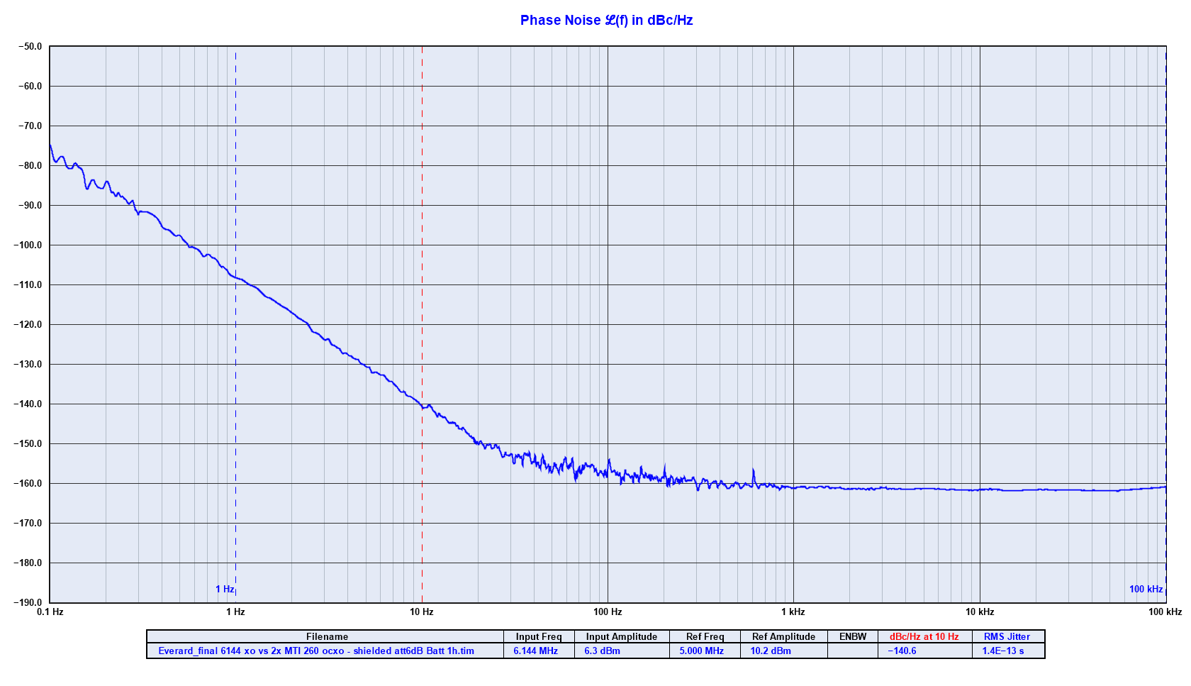

TWTMC-EXO Differential oscillator final measurements
I attach the phase noise plots of the new Differential oscillator.
Everard_final 56448 xo vs 2x MTI 260 ocxo - shielded att6dB Batt 1h.png135.1 KB · Views: 302
Everard_final 6144 xo vs 2x MTI 260 ocxo - shielded att6dB Batt 1h.png129.2 KB · Views: 288
Everard_final 112896 xo vs 2x MTI 260 ocxo - shielded att6dB Batt 1h.png137.6 KB · Views: 260
Everard_final 22579 xo vs 2x MTI 260 ocxo - shielded att6dB Batt 1h.png131.4 KB · Views: 247

At 5.6MHz the Driscoll and Differential appear to perform about the same.
How do we chose which to use for our application? I assume we look at the cost of the BOM for each and buy the most cost effective. From the pictures earlier it looked like the Differential is a much simpler design and therefore more cost effective. Am I on the right track?
The Differential has less parts than the Driscoll but more SMD to be soldered.
I suggest to wait for the Order form with final prices and the BOM for the various options (bare board, semi finished and finished board).

Amazing results, especially for the 5 / 6MHz oscillators, totally SOTA.
There is not much between the Dif and Driscoll, maybe Driscoll is just slightly better
- Are these without oven
- Which active device (BJT) did you use for differential?
cheers
TCD
Both oscillators are without oven, we have measured them with and without the oven and there are no appreciable differences, the phase noise plots are superimposable.
Of course there is a difference in Allan Deviation, but since we look for the best short term stability we have removed the oven to make the board easier to assemble.
In the Differential oscilaltor we have used the SSM2212.
We also have tried the SMBT3904 but the phase noise performance is worse.
