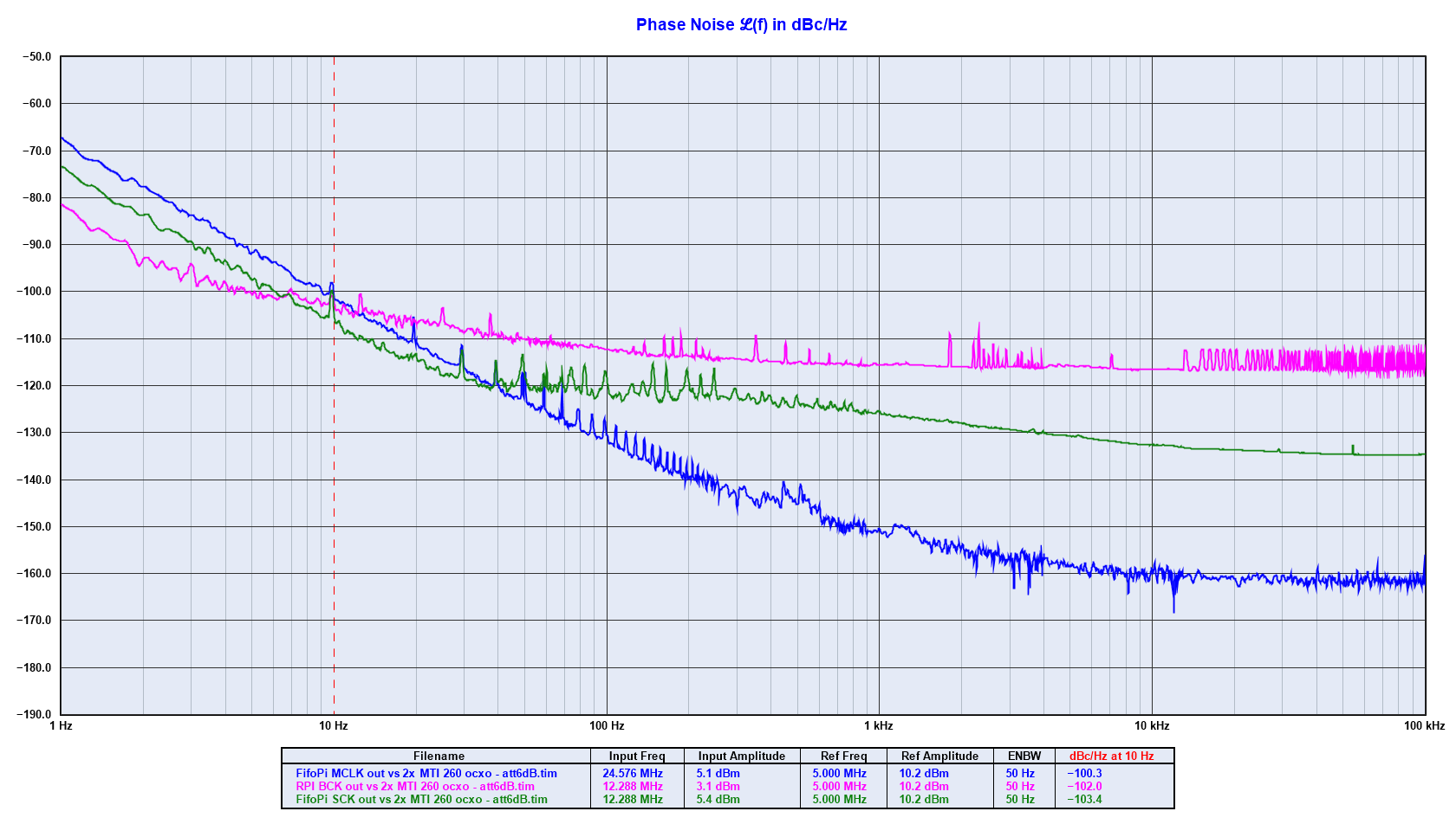

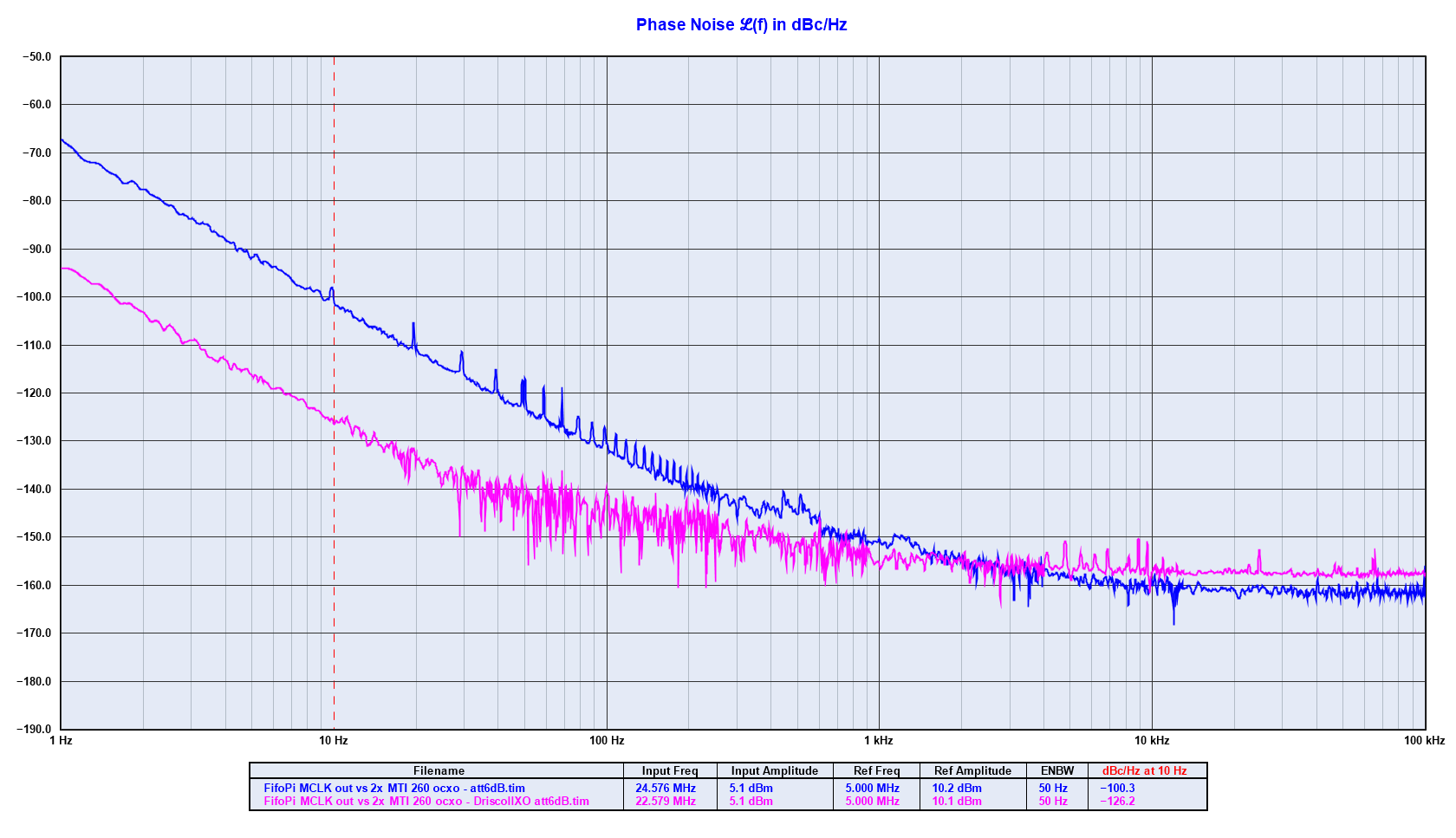

Temperature stability helps the long term stability of the oscillator, but since in audio we are looking for short term stability I would avoid the effort.
We have removed the oven because the phase noise plots with or without it was exactly superimposable, so better avoid more electrical and mechanical complications.
This is my last post about measurements, only because here someone is offending the reputation and the professionalism of people and manufacturers like John Miles and Microchip, that's unacceptable.
The Timepod 5330A (or the Microsemi 3120A) do reliable phase noise measurements of sine wave and CMOS/square wave clock signals, unless someone demonstrates the contrary.
The first two plots validate the reliability of the measurements beyond any doubt.
The first plot is the phase noise of the Driscoll oscillator at 22.5792 MHz (sine wave), while the second one is the phase noise plot of the same oscillator after squaring at the u.fl output of the FifoPi.
As you can see the two plots are almost superimposable, there is only a little difference above 3 kHz from the carrier, due to the noise added by the CMOS squarer.
As you know a square wave is a sine wave with infinite odd order harmonics, so the only issue measuring the phase noise of a square wave could be the noise of added by the harmonics, but since the bandwidth of the gear is 30 MHz even the 3rd order harmonic of a square wave at 22.5792 MHz does not cross the input filter (at 27 MHz).
The same about a 12.288 MHz square wave because the third harmonic is around 37 MHz and so it does not pass.
This means that even the phase noise measurement of a square wave at 12.288 MHz is absolutely reliable.
The third picture shows the phase noise plots of the Fifo MCLK output using the Driscoll oscillator, the RPI BCK output and the FifoPi SCK output, all are square wave signals correctly measured by the gear.
The phase noise (or jitter if you prefer) is not removed by the FifoPi, as you can see the phase noise of the SCK is 20 to 30 dB worse than the master clock. Only a part of the jitter coming from the RPI is removed, such 10-15 dB, but the most part such 20-30 dB is still present at the u.fl output of the FifoPi.

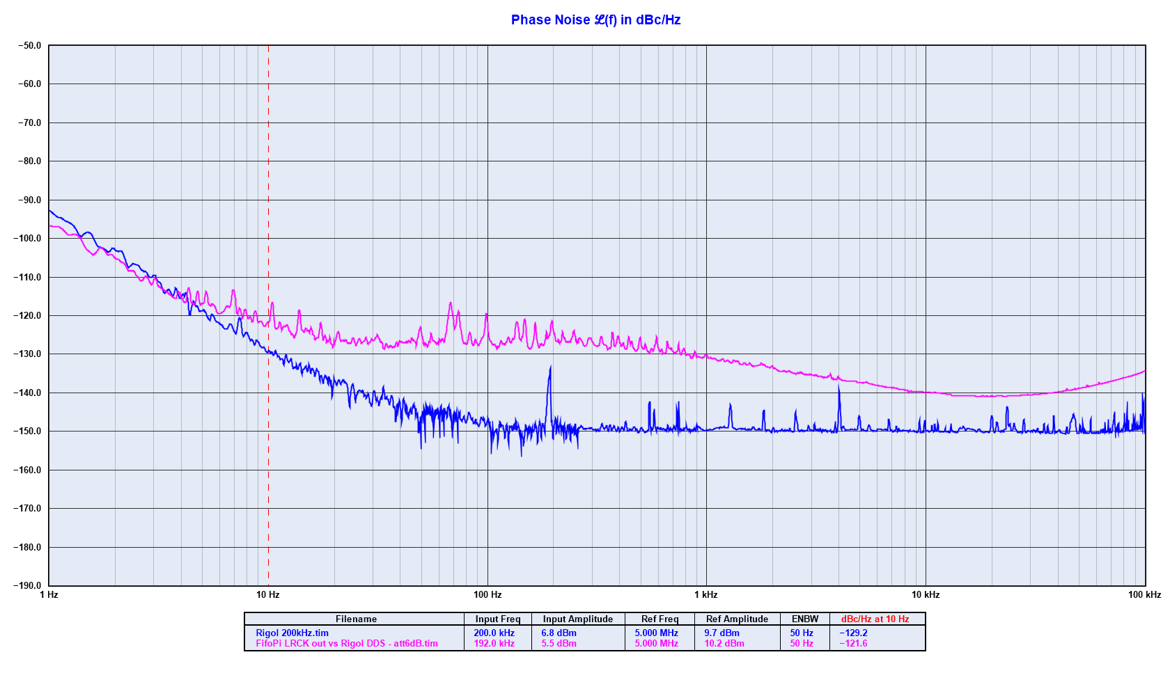

Now we can argue about the phase noise measurement of a square wave at 200 kHz, where some odd order harmonics could pass and affect the measurement.
When I will find the time I'll do a measurement with an input filter to understand if there is a difference.

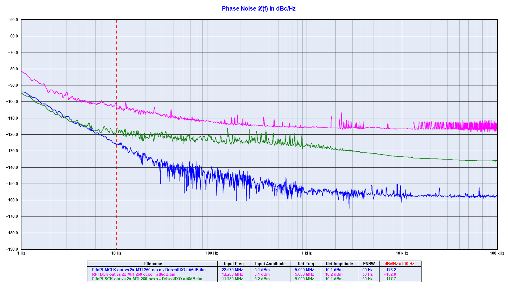

But even if we assume that the measurement was worse than the reality, looking at the 4th picture we can figure out the phase noise performance of the FifoPi LRCK.
If we assume the above we should shift down both the plots on the Y axis, I repeat BOTH plots and not only the FifoPi LRCK plot.
And this tells us that in any case the LRCK output of the FifoPi at 192 kHz has a phase noise 10 to 25 dB worse than a cheap Rigol DDS signal generator.
Keep in mind that this is the crucial clock to drive DAC like TDA1541A, AD1865, AD1862 and so on.
The fifth picture explains, at least in part the FifoPi LRCK phase noise, it's the LRCK clock captured with the oscilloscope. As you can see there is a clearly visible crosstalk, that's surely does not help the performance.
As you can see I keep always the discussion technical and I always try to motivate what I'm writing.
Please do the same
Andrea

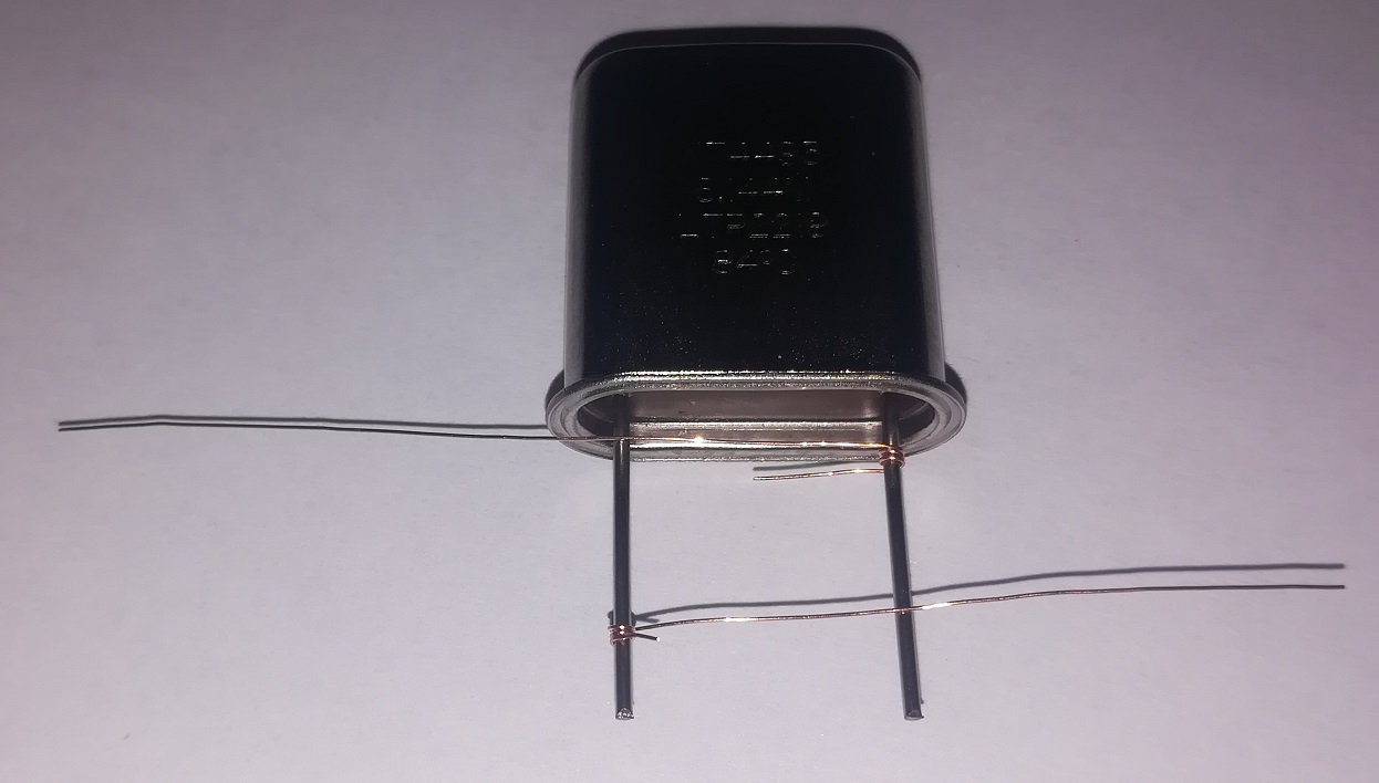

Vibration can affect the close in phase noise (even air motion), so better if the crystal is decoupled.
You can use a thin strip of neoprene or foam with biadhesive on both side.

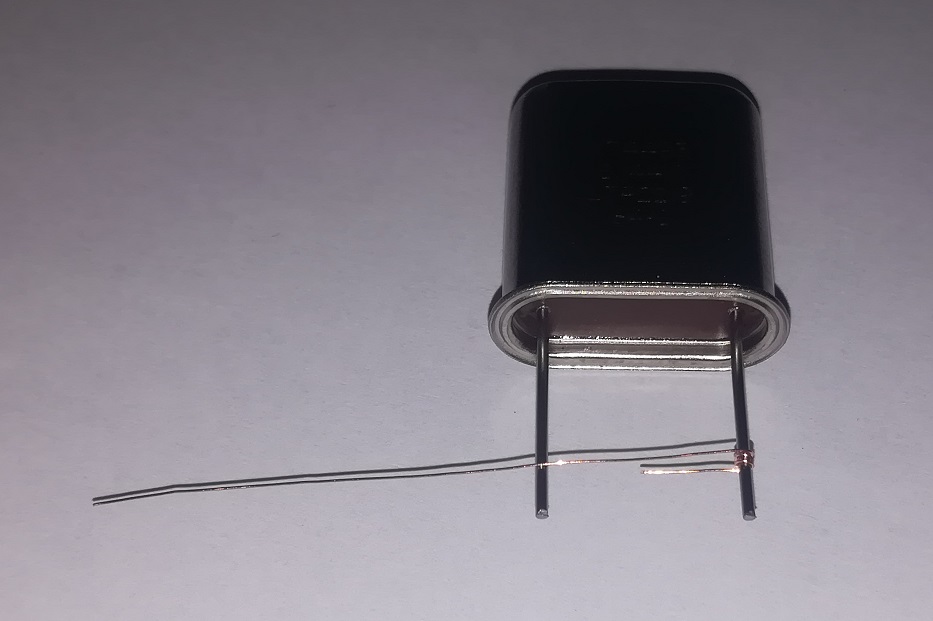

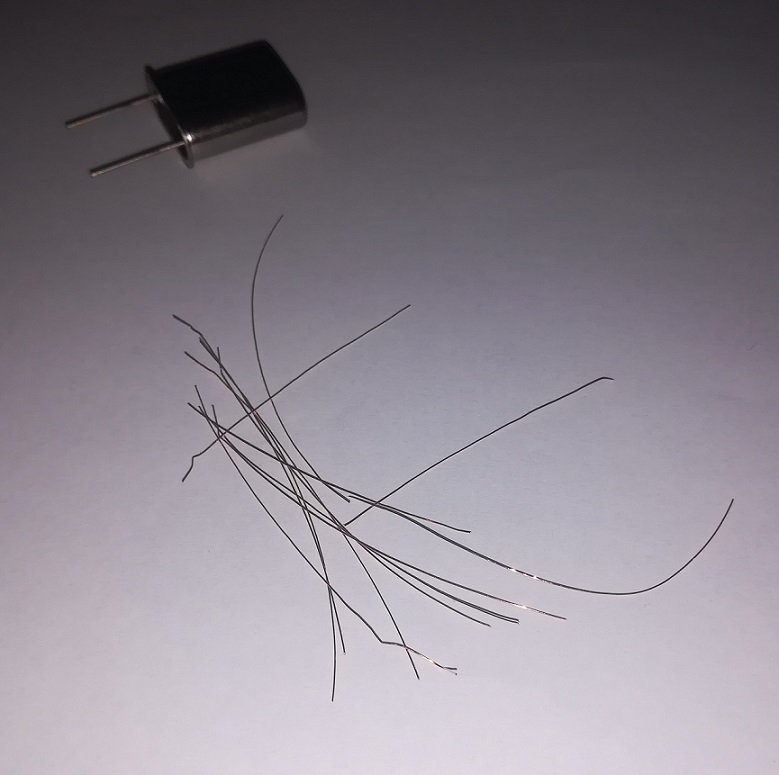

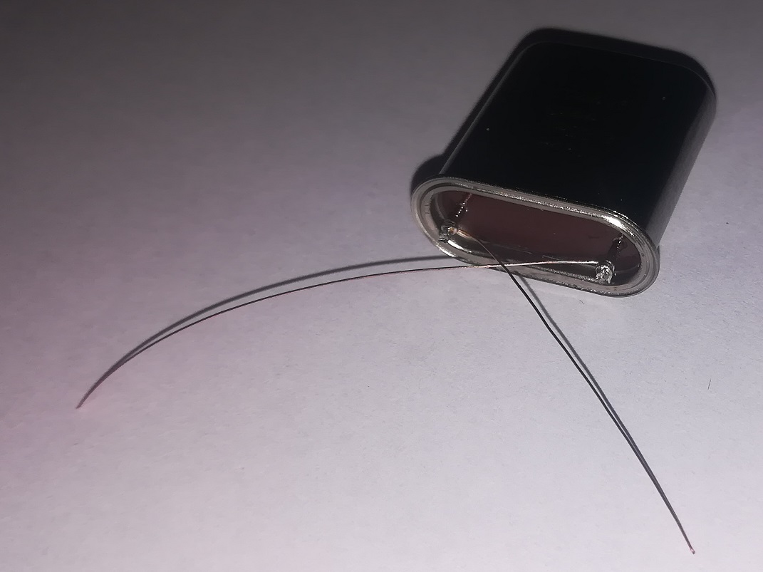

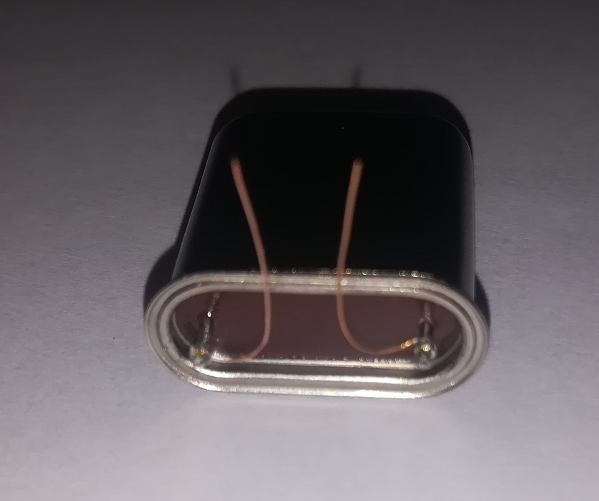

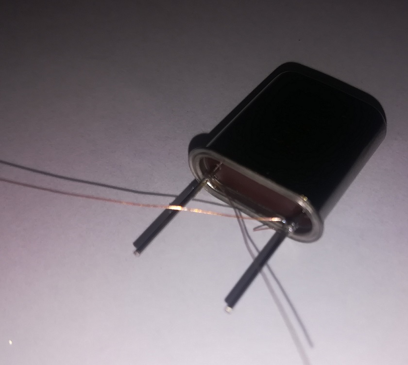

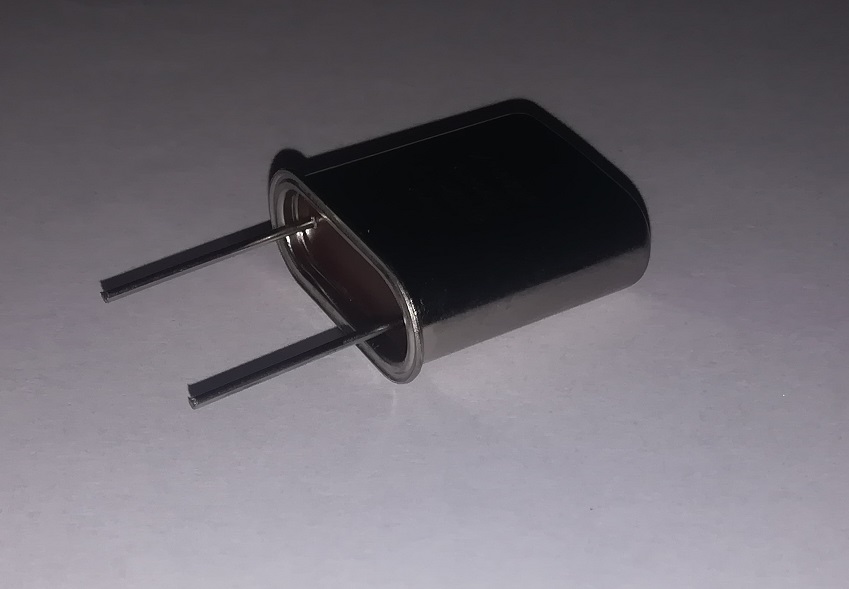

Great idea for vibration decoupling. I would never have thought of mounting the oscillator on foam with fine wires to decouple.
Your finished chassis could also be put in a larger box filled with sand.
Questioning about andrea_mori's test results(1), Real RPi SCK time jitter measurement
I was hoping his phase noise testing results have much better accuracy. However it seems that both his SCK and LRCK phase noise/jitter testing results have big problems. I need to post my time jitter measurement result to let us figure out what was wrong.
I'll do the jitter measurements in the time domain under the same condition. Let's start from RPi SCK.
The first picture is the time jitter histogram plot of my RPi 4B SCK signal before FifoPi. I2S was running at 192KHz 32bit.
We can see clearly that there are both random jitter and deterministic jitter. The two deterministic jitter deltas separated in 1.7ns in between, one taller and one shorter, which were from the systematic jitter of RPi internal PLL (to generate audio clock)
The overall RMS jitter measured was 247.8ps .
To make it easier to understand, I posted the second picture which is the direct jitter observation from my real time digital scope. The RPi SCK jitter is so big that it can even be seen directly from the waveform.
Both real random and deterministic jitter can still be figured out right away. (The 2.2ns rising time is also very slow), though it may not be as accurate as jitter histogram,

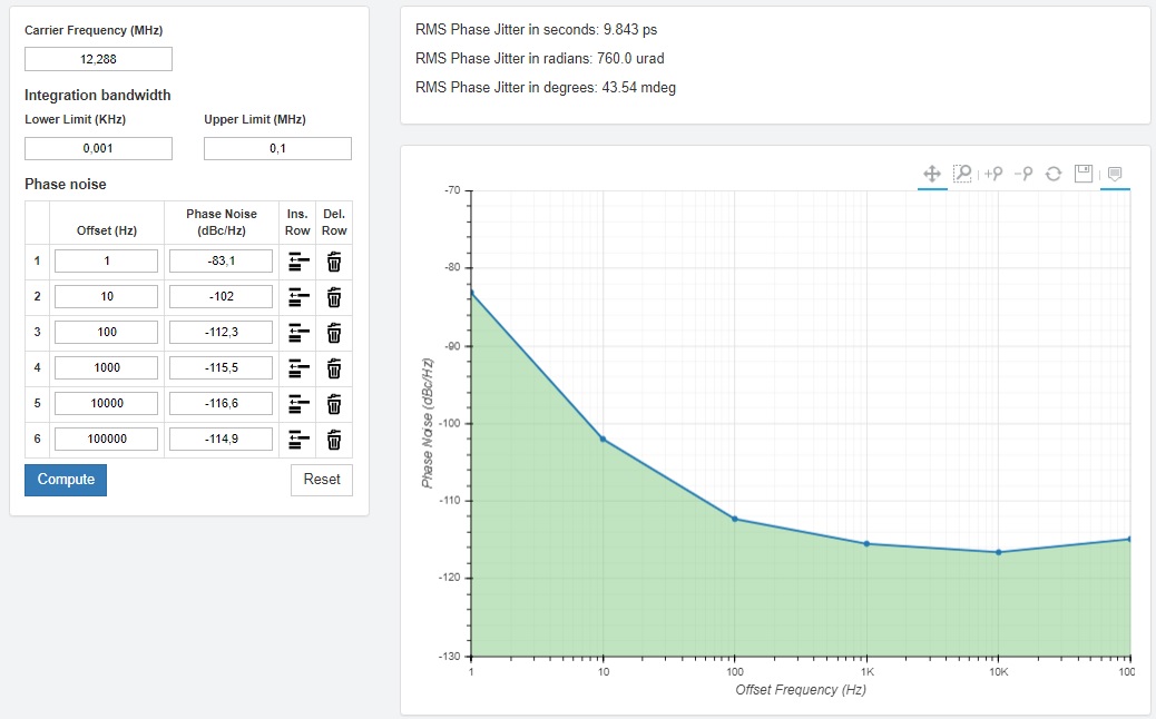

I attached andrea_mori's PPi SCK phase noise plot and phase to be compared. I see two problems with his testing results.
1. His phase noise plot didn't show any RPi SCK jitter signature in frequency domain (the pink curve). What was missing?
2. His RPi SCK phase jitter calculated was only RMS 9.843ps, far from the 247.8ps time jitter measurement. I don't think the measurement is reliable. Why can not see such a big jitter?
Seems his testing results can not tell what's the real jitter performance of a digital audio signal. I don't have a TimePod so I don't know what was wrong. But I think andrea_mori need to give us an explanation.
Please do the same
Andrea

Ian,
An interesting fact about jitter is the convertibility of it's presentation formats.
You could try it as well, by producing a very high sample batch, as much as max memory permits, perform a TIE trace extraction, and perform an FFT operation on the trace data.
That will provide a spectra which will show features very close to the phase noise plots of Andrea.
But worse quality. For several reasons: in the procedure to extract TIE values, an ideal clock stream has to be synchronized to the stream of data. This means a PLL algorithm is applied, with a pole usually at quite high frequency.
So your low frequency spectra information (close-in information) is cut off, truncated by the PLL.
Second, the sampling clock jitter of the scope itself is too high, generating a noise floor too high (in the zone close to the carrier)
You can not escape this limitation, the sampling clock is 8GHz.. It's noise floor is not comparable to the 5MHz reference clock in the TimePod spectra.
But, if You generate those FFT spectra, You will see that:
Random jitter is converted to noise floor 'shape' in the phase noise spectra;
Deterministic jitter is presented as discrete frequency spurs, sticking out of the noise floor;
Deterministic jitter magnitude is converted as height of the spurs.
So.
What You see in the phase noise plots of Andrea is the noise floor, the random jitter content of the Rpi clock. This You will never know how does it look like, because of the reasons above. There is no way to get at it with the scope.
Now there is a 'spur' supression function in the TimeLab software, that is probably used, and which kills the line related & other spur features as well.
The people who use these analysis tools, are usually more interested in the random floor evolution.
I do not totally share this thinking, I do think that deterministic jitter is important, especially if it is data correlated.
Another observation: your two peak jitter population are very unevenly distributed, means that apart from the main noise floor (first gaussian) there is only a very rarely present, (though far out) second family of edges..
That will only create a weak spur in any spectral presentation..
Ciao, George
