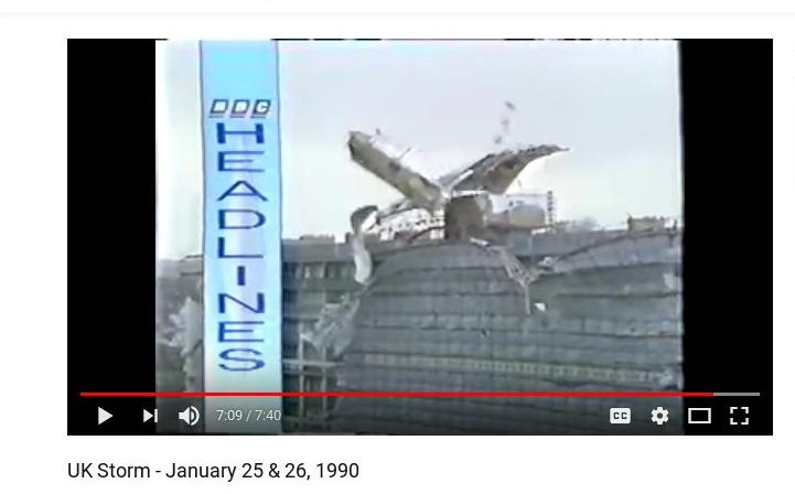

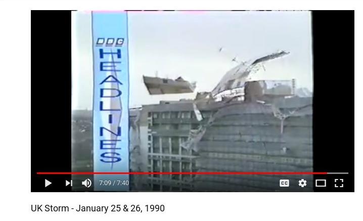

We do get hurricanes in the UK or at least something just as powerful.
Things still get ripped apart whatever the weather systems are called.
Great storm of 1987 - Wikipedia
Burns' Day Storm - Wikipedia
