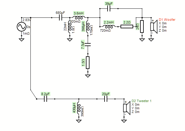

Hello Friends need help I have the SB 15OB350 not the eminence woofer also I dont know the corossover how to make. If I use the SB woofer what change in crossover is needed. I really want to make this happen. Also if I use the crossover that Perry published with my SB what issues will I have

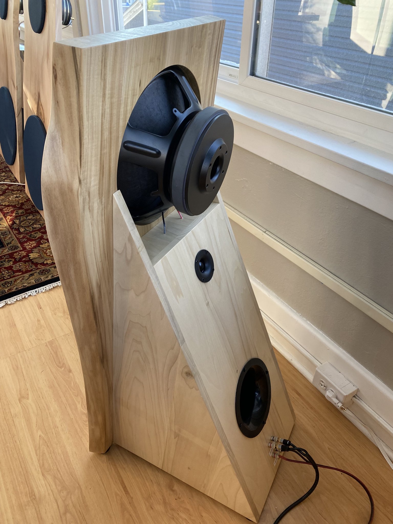

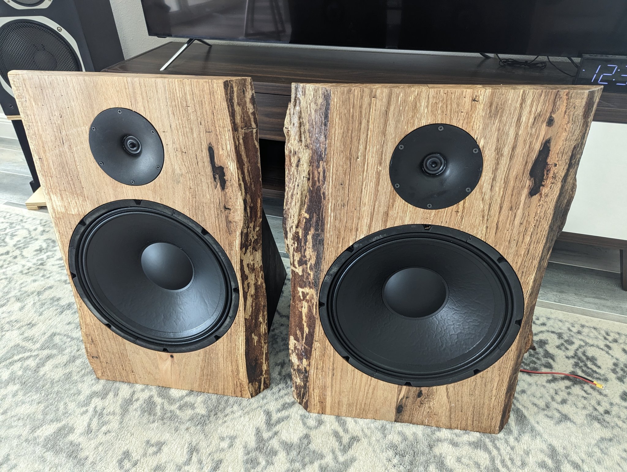

I want also to make a kind of walnut dipôles.
Plan is to use a 15ob350 a tw29txnb-8 either in the SB acoustic waveguide or a "somasonus" and a 8nmb420 as midi.
@perrymarshall do you think a single 15ob350 is enaught in a 70sqm living room to have a -3db at 30 ?
