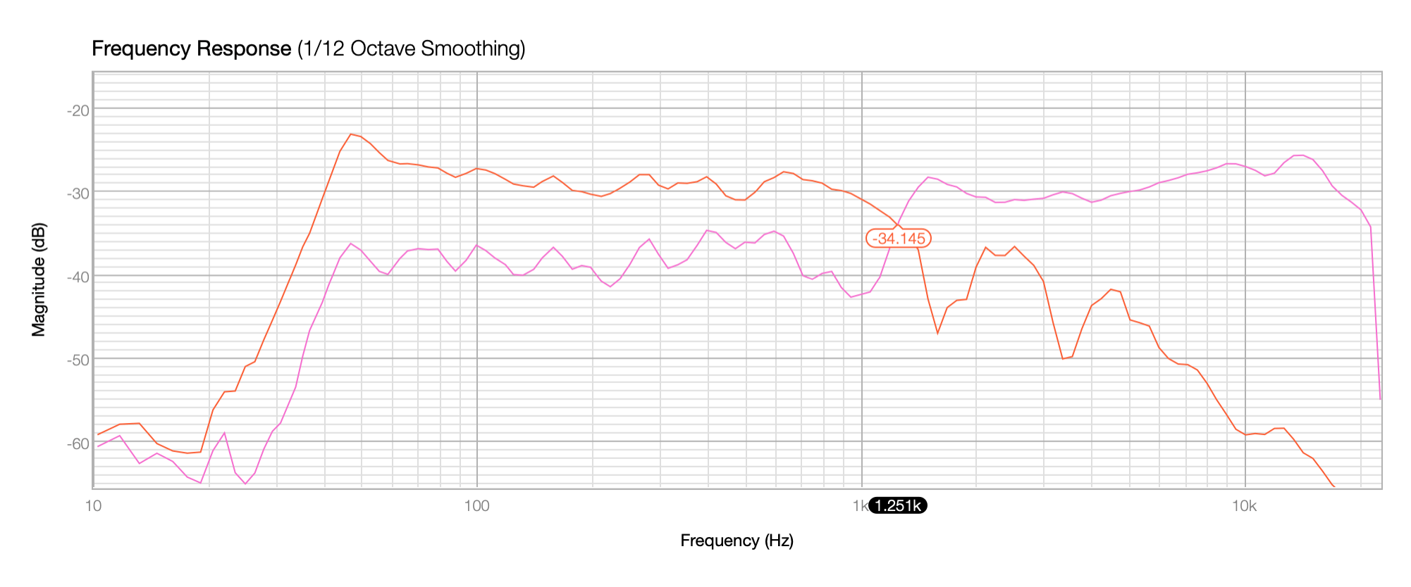

Funny you ask, because I admit it's not a stellar driver. I had a couple of extra on hand so I used it. It does have the virtue of having a Q of 1.26 which is desirable. Its 12dB peak at 1900Hz is a pain to deal with.
If you take a close look at the design, the crossover frequency is 1250. I use a pretty complex crossover network to tame it, and it blends very nicely with the tweeter.
Above: Nearfield measurements of both Alpha 15A and TW29R.
I'd say it's sort of like the KEF B110 in the LS3/5A: It takes a beast of a crossover to make it sound great, but once you do all that, it does sound great. It's the 2nd time I've used the Eminence 15 BTW.

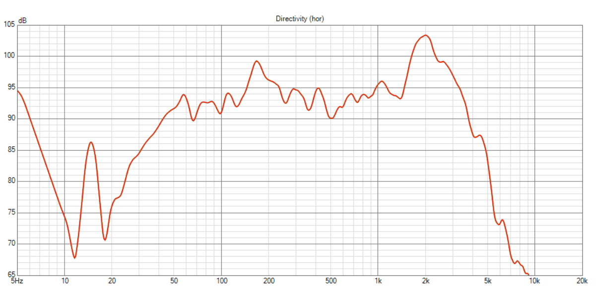

Biggest challenge was the nasty peak of the Alpha 15a. These are my measurements in the actual baffle with no xover components. (The 175Hz peak is a measurement artifact BTW). As you can see the bass without the Passive Bass Boost is a little anemic as well.
The question is, how do you tame the peak at 1900Hz? Most designers will just use a steep 3rd or 4th order filter. I avoid that wherever possible. One of my beliefs is, "don't use brute force when finesse will do" and "don't use nuclear weapons when you can use a bow and arrow."

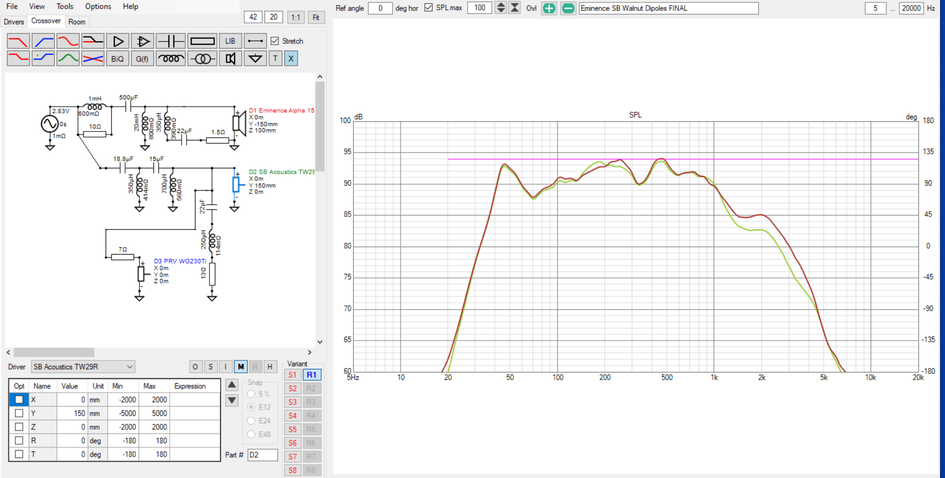

I combined a 1st order high pass (which is bypassed by a resistor!) with a notch filter at 1900Hz to essentially make a high Q shelf filter.

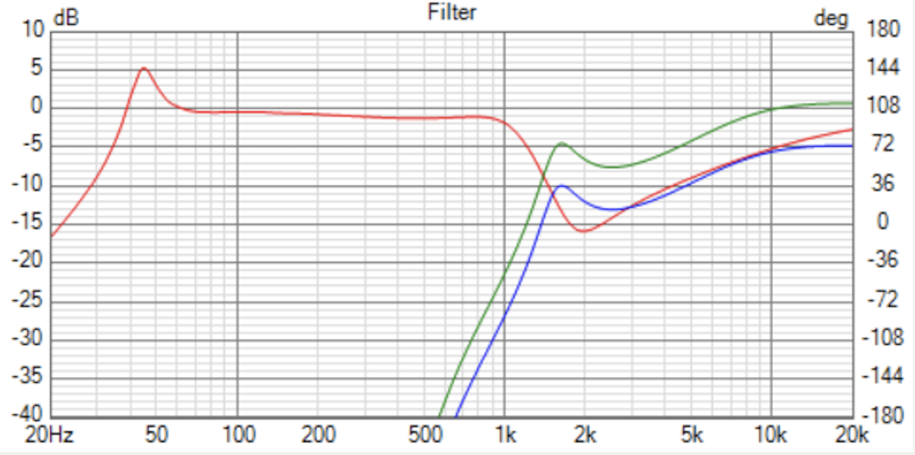

This is the drive signal received by the woofer:
I've carved out a 16dB notch, but as you see as you go towards 20KHz the level returns to 0dB. So Acoustically it's still a 12dB/octave filter with no phase rotations. Subjectively I think this approach sounds much better than a brute force approach.
Above shows the measured response of the woofer with crossover and Marshall Bass Boost in place. The 1900Hz peak has been completely tamed with no more coercion than absolutely necessary. My ears tell me that this minimalist approach sounds most natural.
Even though the crossover network is complex with lots of components, the overall strategy of the crossover is pretty simple as you see from the drive signal curves.
