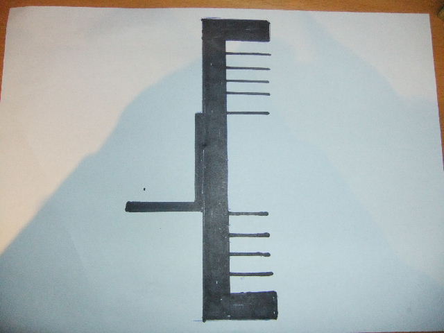

Thank You Eivind . I'll look into changing orientation of board and placement of transistors but it may not be that easy. I'm rather into tubes and haven't touched SS for ages so keeping the layout as is how big is the risk of oscilations and is there any other way to prevent it ?I may drill holes in heat sink closer to the back and group transistors close to each other in each half if its going to help. Since the components were specyfied for 80V B+ the 58 v ac trans will be just fine (~81 V) and as Vincent suggested I can use 58v AC before rectifier for security stage . I hope thats doable.
BIG.
It's not just the inductance of the wiring going back and forth, but also the proximity of the MOSFETs to the big heatsinks.

OK, than what do you suggest? If I use L alu bracket on the back and position transistors to align with the holes on PCB and attach bracket to the back of chassis will there it be enough heat sinking in this arrangement? Regards, L
If I use L alu bracket on the back and position transistors to align with the holes on PCB and attach bracket to the back of chassis will there it be enough heat sinking in this arrangement ?
Nope.
How many inches are left between the board and the front panel ?
Well, There are only 6" (14cm) behind the board to fit transformer. In this chassis there is no other choice than
A) cluster transistors close together on both side of the heatsinks and hook it up with wire.
B) attach small L brackets to both sides of heatsinks with 3 transistors each and run the wires to the board.
There is no space inside to position the board any other way and fit transformer
except maybe positioning the board side way with transistors facing heatsink and using two small 200V-250 transformers on each monoblock or scraping the chassis and building a different one.
What i would do :
- rotate the board in the amp case, output stage facing the transformer.
- saw the output stage part of the board.
- Tilt it at a 90 degree angle off the main board.
- mount it on an L-angle (0.2" minimum thickness), other flange facing up.
- attach the L-angle to an aluminum square bar that fits like a glove inbetween the heatsinks (1.5" x 1.5" or preferably 2" x 2")
- attach the square bar to the heatsinks on both sides (threaded holes and allen bolts, or with a small bracket on opposite sides of the bar, plenty thermal paste)
Connections between both boards with drilled holes and wire links.
Refurbishing cost of $50-$75 tops. You could cover up the holes in the heatsinks with an alloy strip.

hmmm, rotating the pcb is a good idea but you might not need to saw the pcb, just attach the L angle to the board attach the L angle to a square bar and attach square bar to heatsinks.

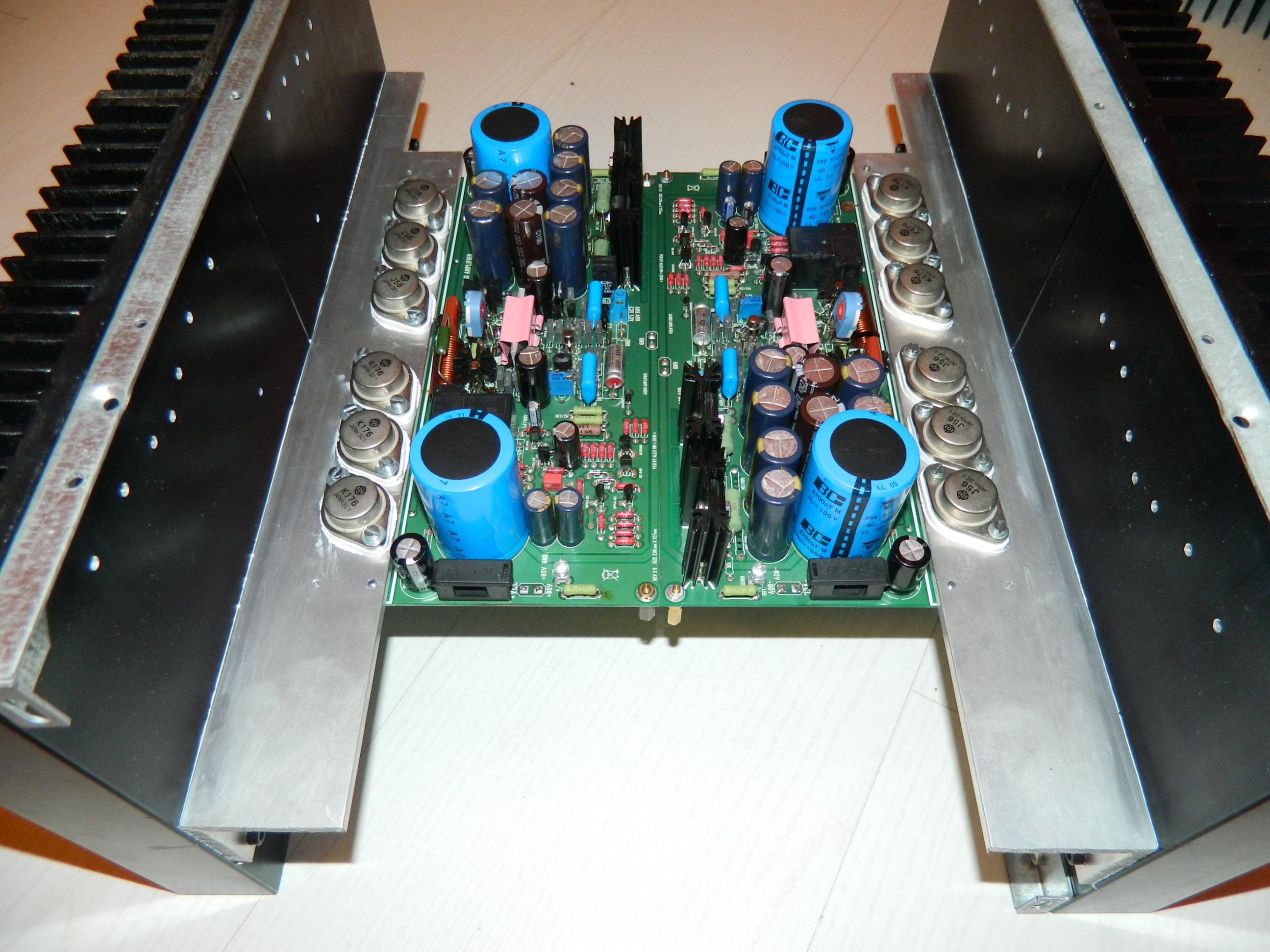

Goldmund works perfectly and the sound is best I've heard.
I currently Aleph2, Aleph5, F5, F5balanced, AEM6500.
Goldmund 9.2 for me is the top.
Very fast, very balanced and superb dynamics with very good bass.
I do not get enough of it 🙂

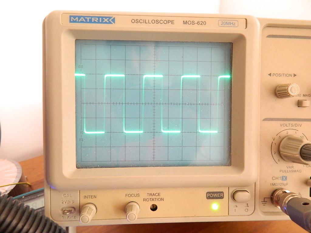

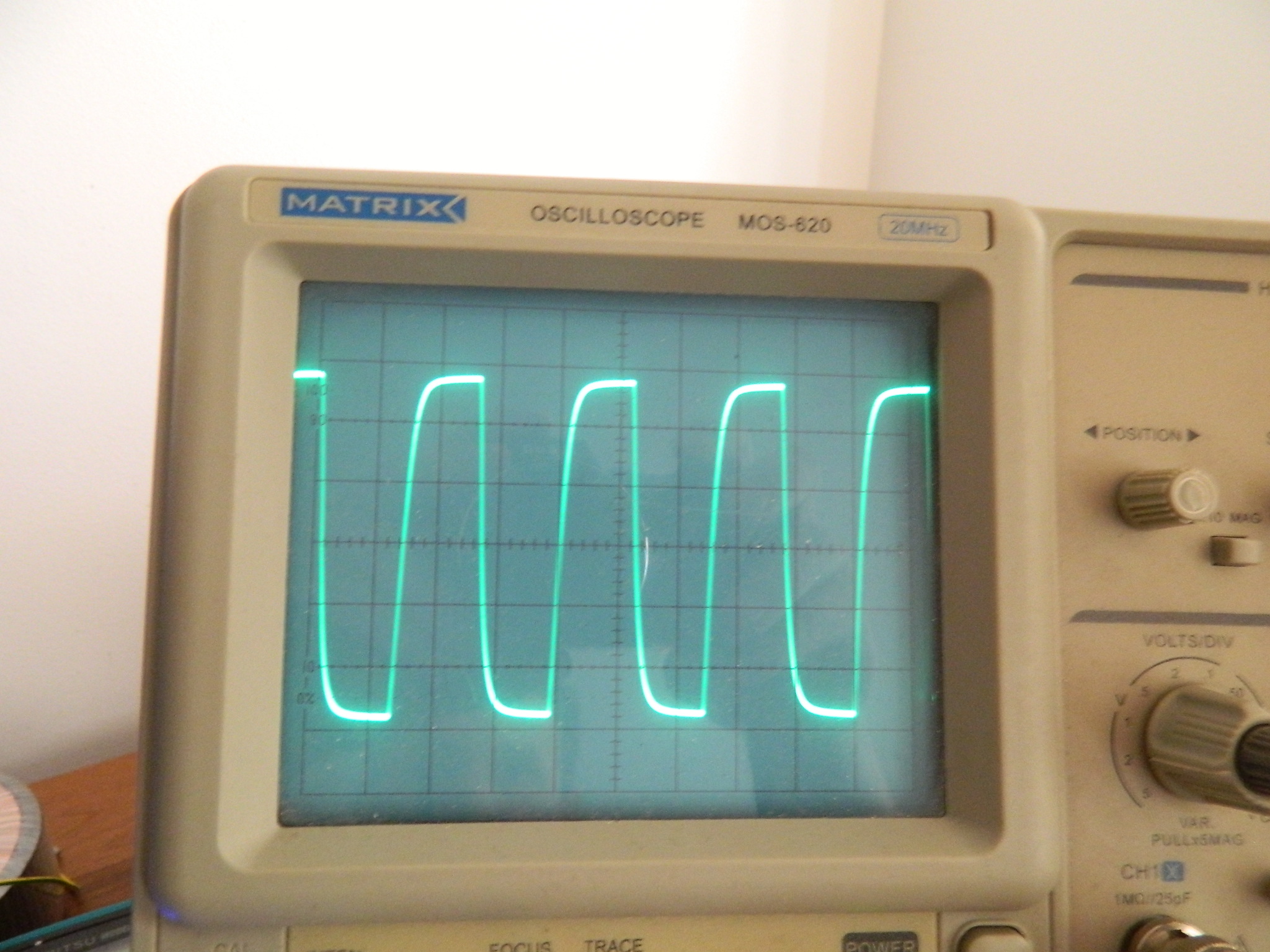

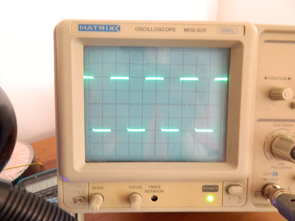

We used all components after original scheme.
Goldmund is very stable.
I 3mV output;
bias - 90mA per transistor;
AC - 60V (+82 V,-80V);
DC - 70 V.
The picture signal to 1kHz,10kHz,100kHz.
Now working on the case, I'll come back with more results.
I want to thank very much to Nikos, Alex mm and Liliya for help and advice.
