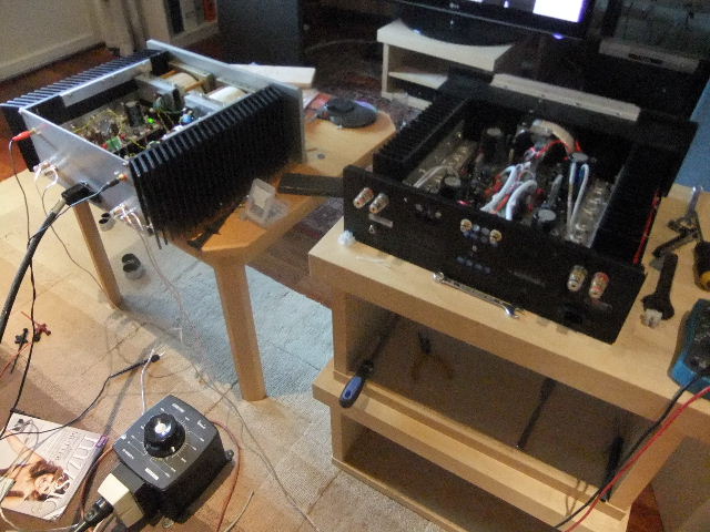

Golmund clone

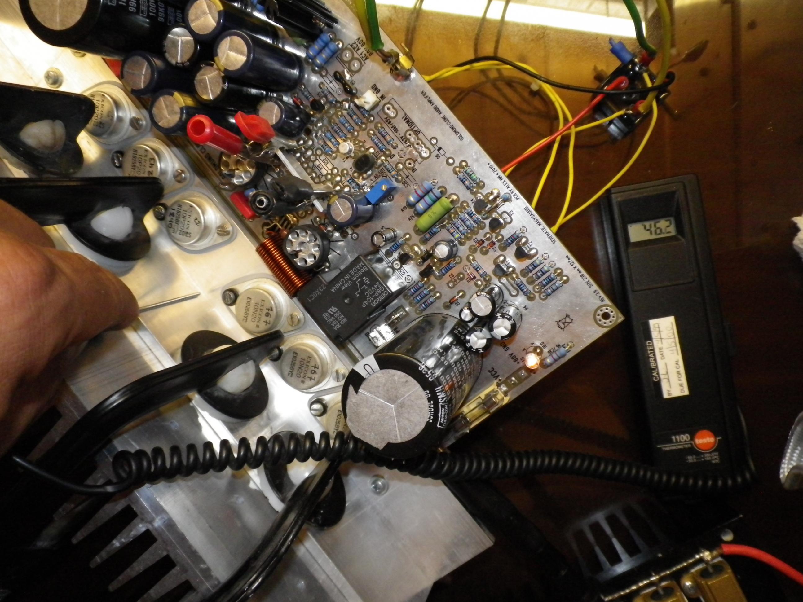

I bought 8 pieces ECF10P20 and 8 piecesECF10N20 and then I took measurements for Vgs match
ECF10P20
1.258 Volt
1.240
1.282
1.243
1.277
1.243
1.278
1.288
ECF10N20
753 mv
750
743
734
730
767
767
773
I've already placed on P channel 220Ω and 470Ω for N channel under the draft of Ηafler and paper Profusion .
www.profusionplc.com/images/data sheets/ecf10-demo.pdf
I've remained completely in the original design. The only changes I have done is mica 50-100pf/500V capacitor in parallel with two resistors 30k and a small piece aluminum joining Τ7,Τ8,Τ9,Τ10. Offset 1-5mv
I was delighted to counteract the noise and remained in the original design with multiplier . I have no noise and i don't put yet the amp in a box and connect the main earth ground on metal chassis .
I've taken measurements over resistor gate n channel 570 mv and over resistor gate p channel 920mv
Αfter matching of transistor Ι've taken measurements οn resistors source :
N CHANNEL 18mv-18mv-18mv
P CHANNEL 19mv-20mv-19mv
I have put 390Ω for R20
Perhaps this difference between n and p be due because i have not screwed properly the L heatsink with main heatsink.

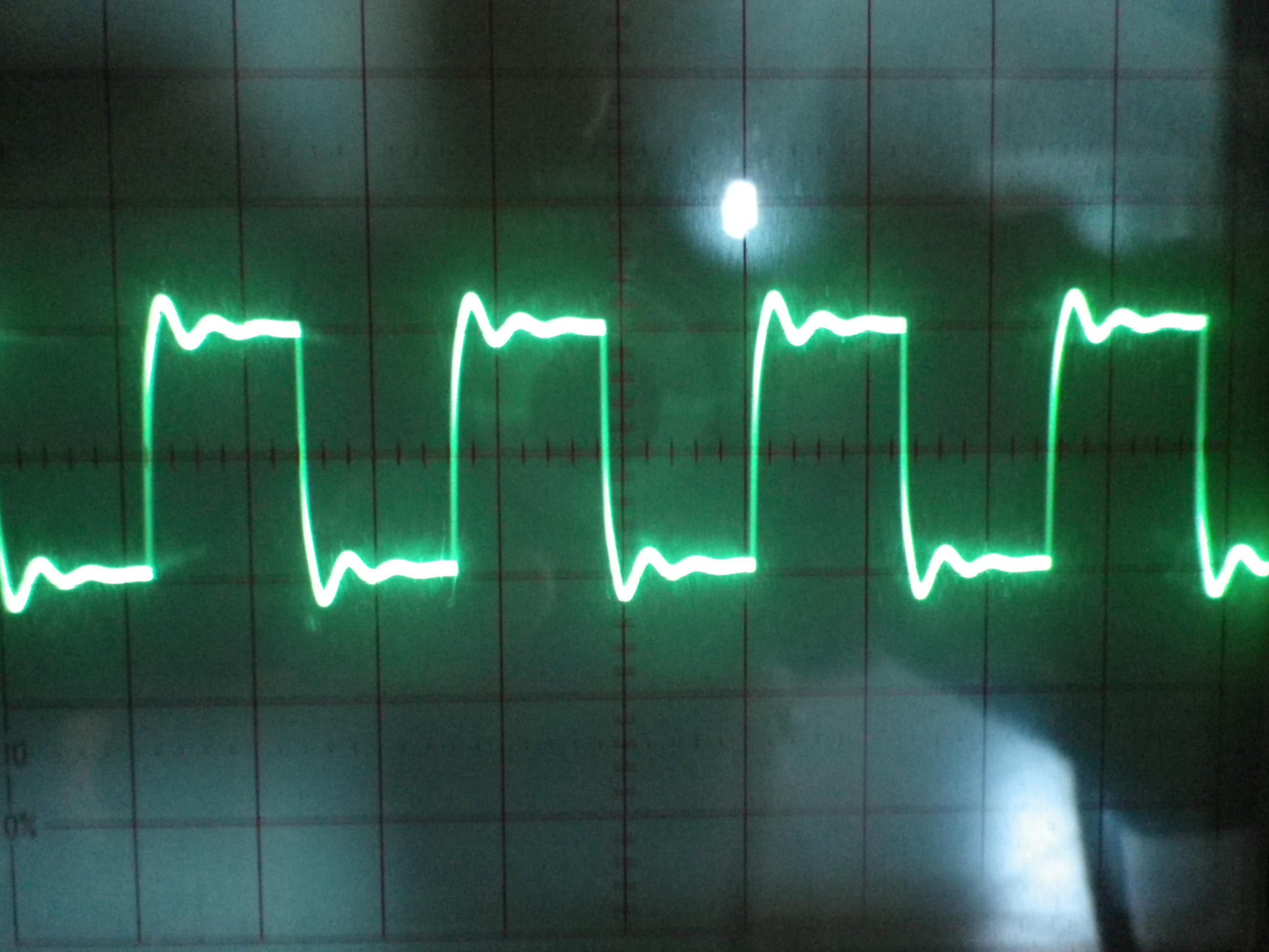

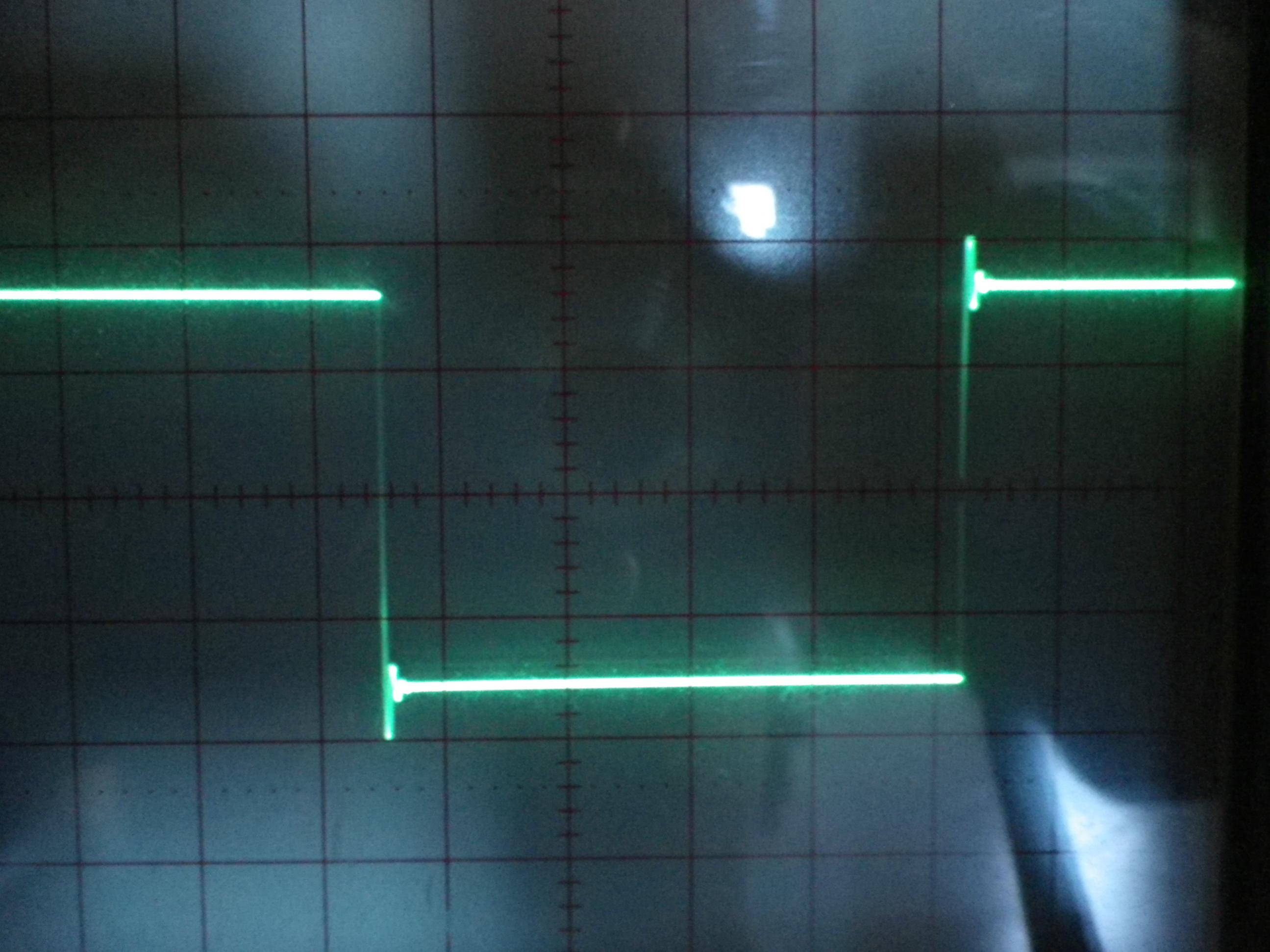

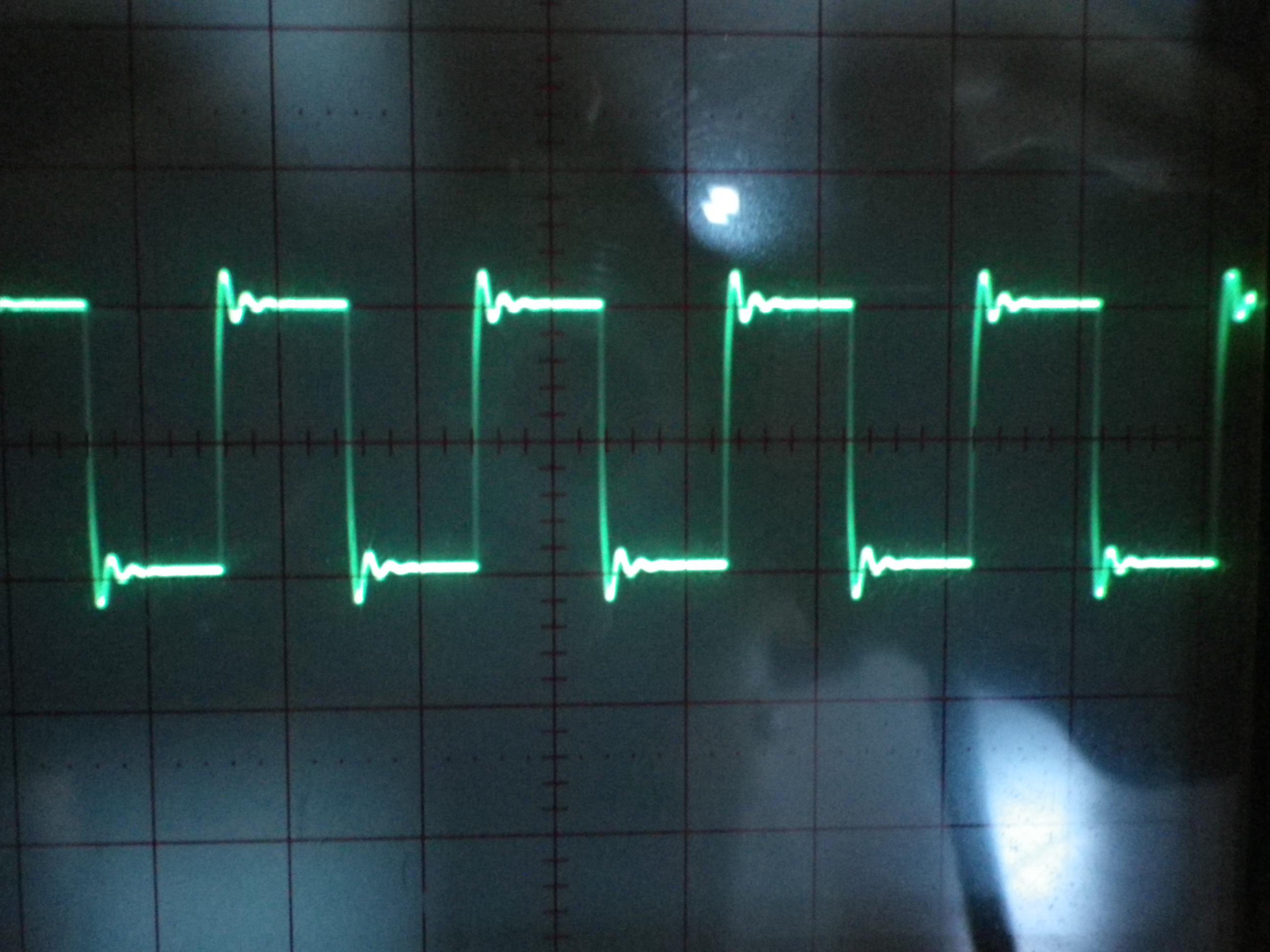

i put 8Ω load i take square wave measurements
NO different with or without load .
The next days will show photos with measurements.

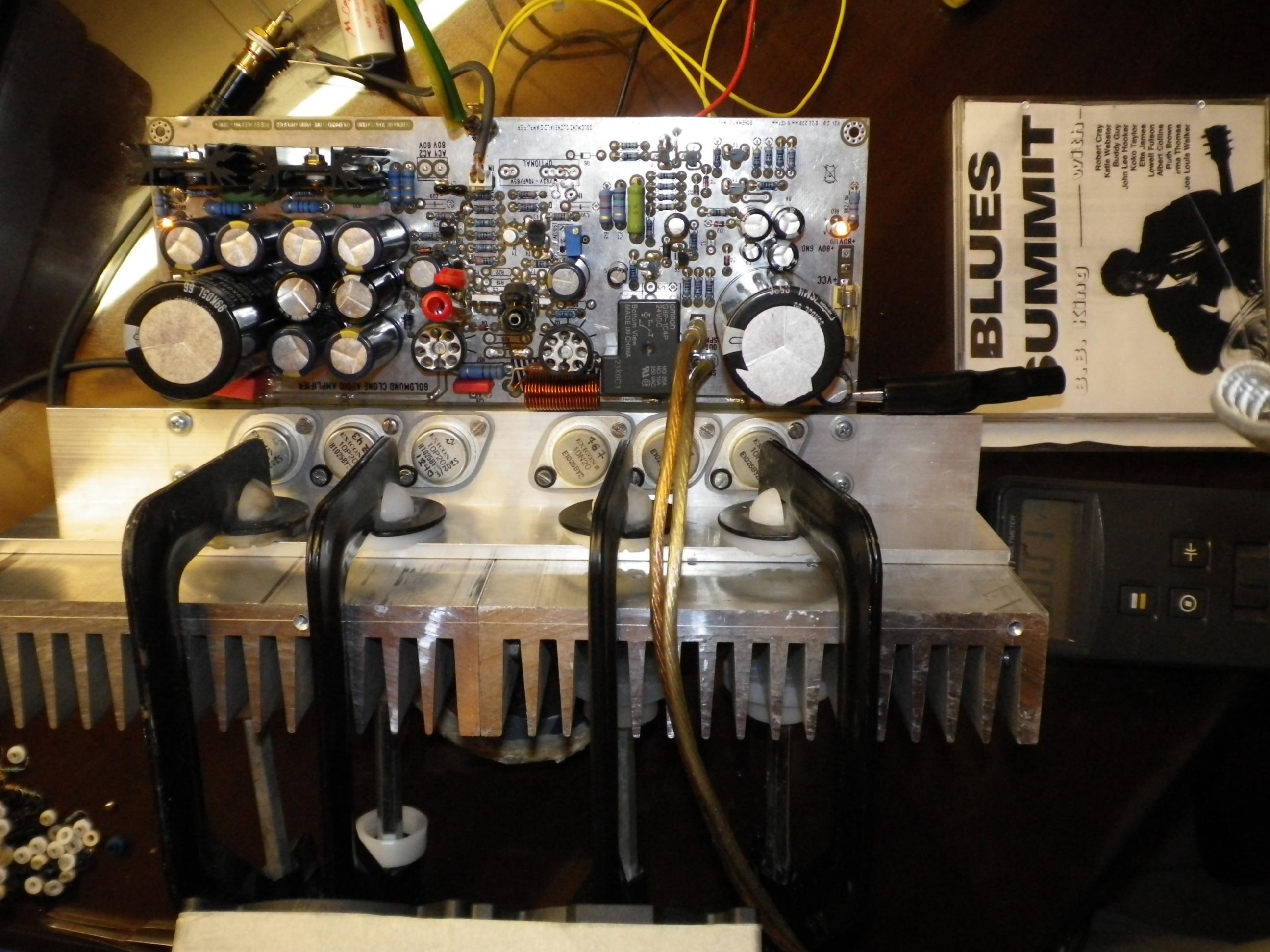

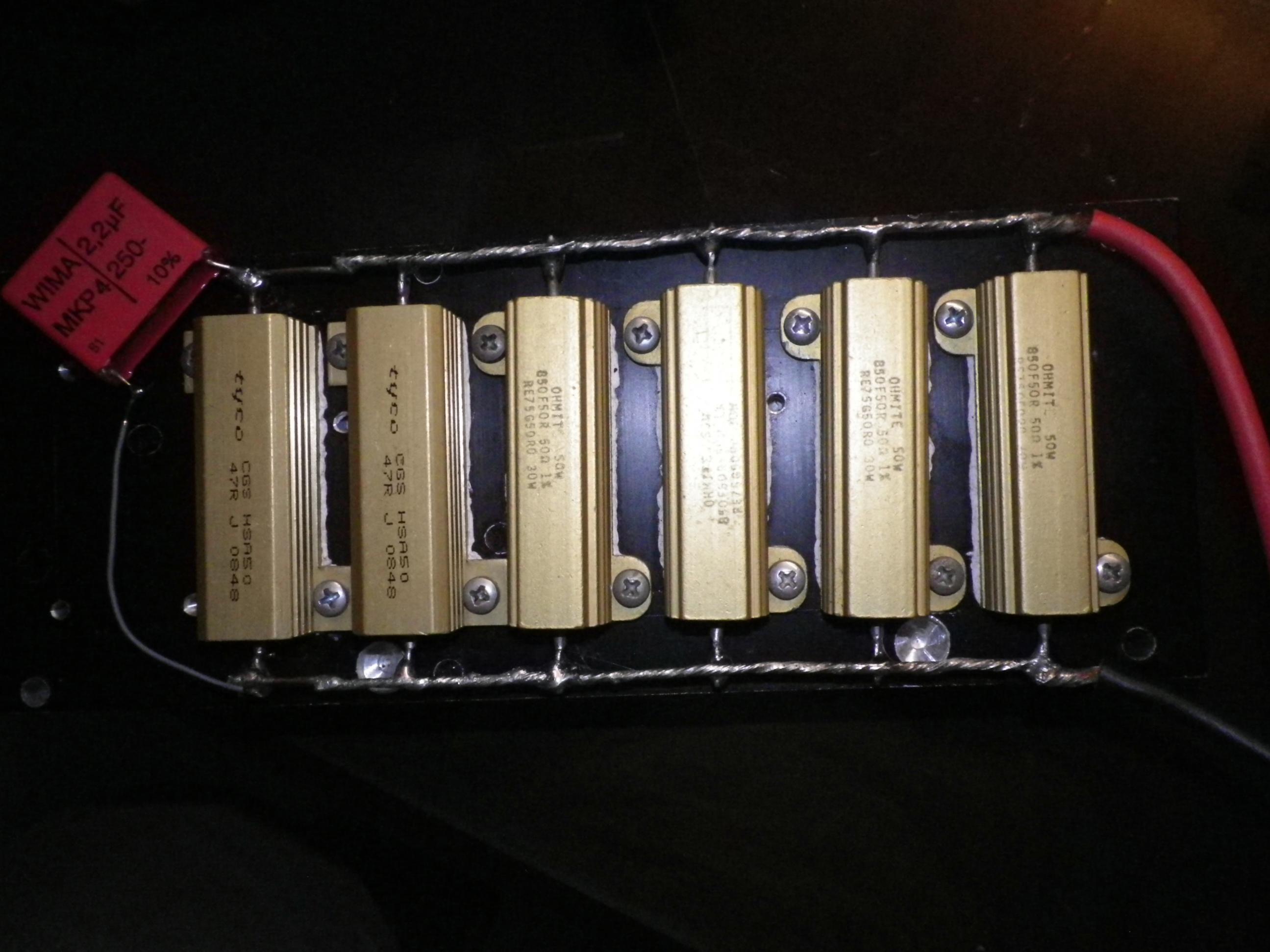

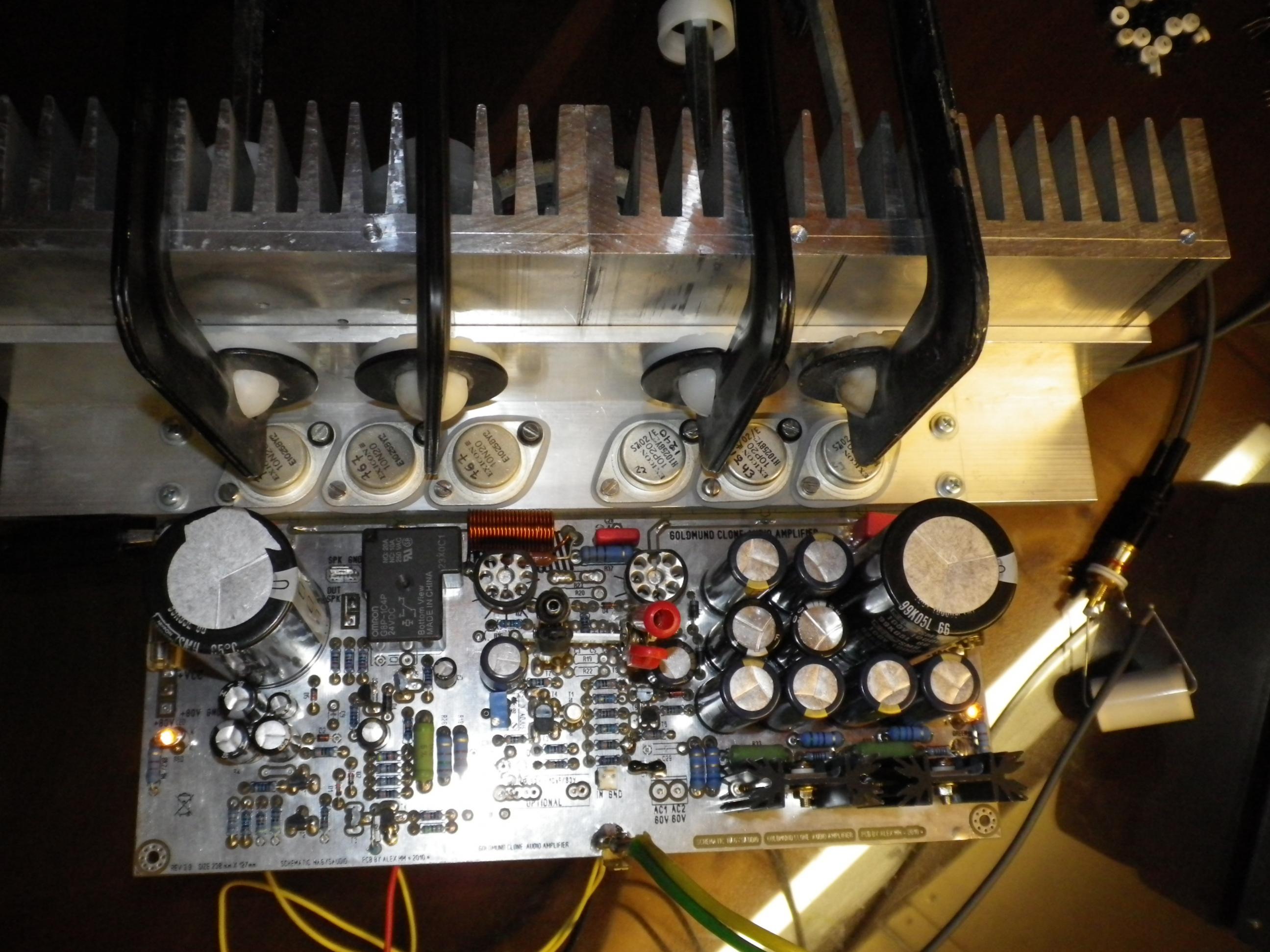

Golmund clone
Rail + / - 70V ---- AC 50V and R32, R33 = 1,8KΩ/4W = result front end voltage about +79,2V /-78V
With fitted resistance R20 at 390Ω the Bias current about 90-100ma for each mosfet
Voltage on source resistor 0,22/5W N Channel 22-22-22 mv and P channel 21-21-22 mv with heatsink 320mm X 100mm X 40 mm , after half an hour the temperature in the heatsink reaches 50 degrees Celsius with room temperature 33 degrees Celsius.
The amplifier is very detailed, particularly at high frequencies and does not go bad in low frequencies with fitted capacitors 10.000mf/100V on rails.
I am no expert technician I have not extensive experience in hearing about amplifier, but I think the amplifier is good enough.
Some results from tests 8Ω load with 2,2mf
1KHZ- 10KHZ - 20KHZ
