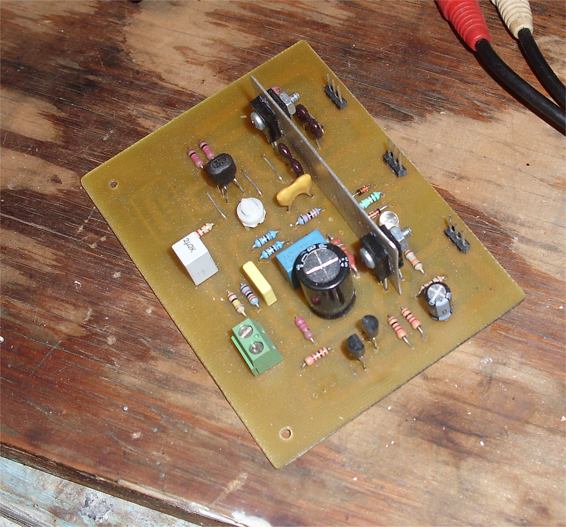

.... I have redraw schematic acording nikosokey implementation 🙂 home made case .....
Alex.
D2 cannot be 12V. There is little point running the pre/driver stage at 82VDC and the output stage at 82VDC, the difference has to be about 10V to be of any benefit and drive the MOSFETs to rail.
If the intention is only to make the front end more stable then two diodes would have been enough.

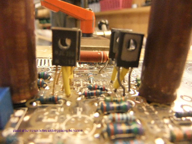

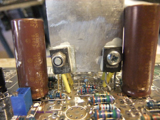

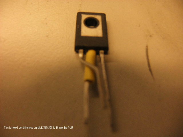

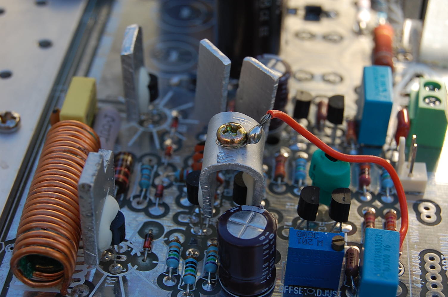

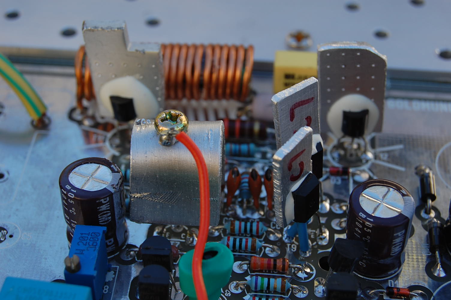

I should mention that the inspiration for the installation of transistors MJE340--MJE350 double CCS-VAS ## post 1712## was based on previous reports Mr Ostripper.
This is my second Goldmund clone.
With a transformer leaving 50 V DC I might call it a Mimesis 3 ?? I use three pairs of FETs instead of two.
As mention in post 1726 I took over a complete chassis from my friend Roar Malmin (a return for my help to him). PCB fits very well.
In both my Goldmund clones T7-T10 are now MJE 340/350 monted on a common heatsink (look at # 1652 and # 1728) DC is now low and much more stabel than before. Drivers are also MJE 340/350, but in my Mimesis 9 those drivers are now BSS71/74.
In my scaled down version T1 are 2SK170 BL. I changed R7 to 68 Kohm, R6 to 22 Kohm and R3/4 to 120 ohm. Voltage to the front end are +/- 65 V DC. Works very well.
Both power unit will take place in my rack feeding 50- 500 Hz and 500-20.000Hz. NAD 208 will take care of the sub- bass.Crossover is a very modified DCX 2496. I think I will live happy with this and my Magnepan/NHT 1296 loadspeakers for many years.
Eivind Stillingen

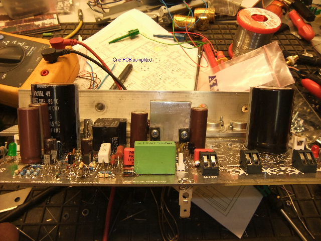

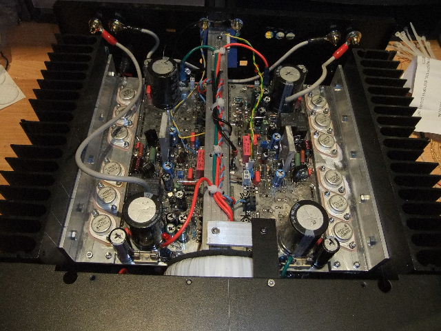

Photos
I took some picture (six), but went into troubles uploading.
I will try again to morrow.
Eivind Stillingen
Eivind Stillingen
Here are photos
Eivind Stillingen
Eivind Stillingen

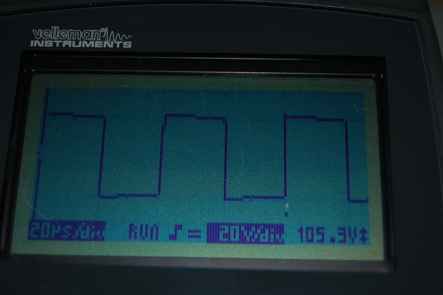

Tomorrow I will add the final touches on the rebuilding of my Goldmund Mimesis 9 clone. What the rebuilding goes on, I have described in #1732
In a private e-mail from my Greek DIYfriend Nikosokey he wrote the following:
"These waveforms you see is a result of some changes
I place a capacitor 100pf/500V mica in parallel with resistors R19 R22 30kΩ 30kΩ"
I am also considering to do this in my Nemisis 9, but wish comments from others who have participated in this thread. Are there any disadvantages of introducing such a mod?
Eivind Stillingen
