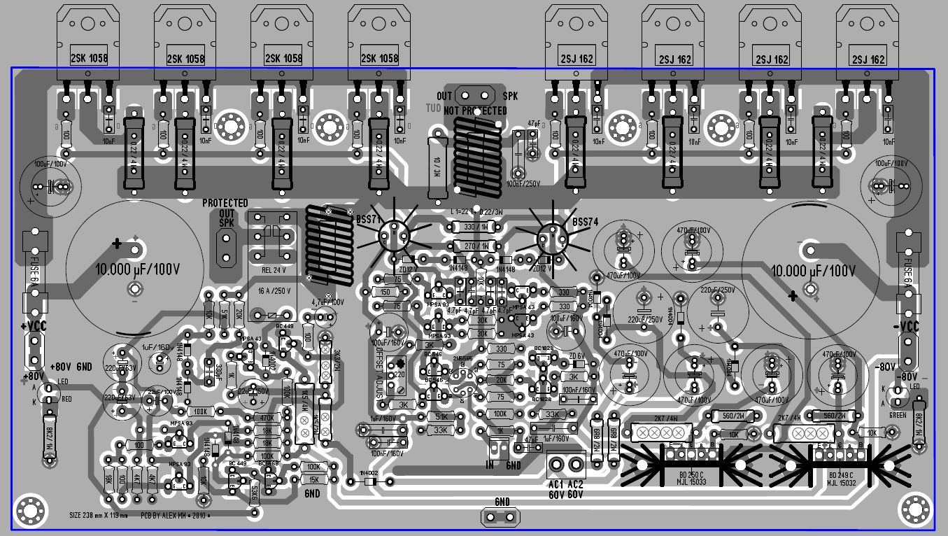

would there any noise problem as the 60v ac copper traces are close to the signal input pad ?
Should not even be on the same board...

I refer to PCB shown in #830 and #840, why the input resistor 100K is NOT
connected between gate and earth ?
TS

I still don't understand what's the grounding concept.
Is there anything else than the 10nF, 100uF/100V and 10.000uF/100V capacitors connected to the groundplane?
What's the point to connect some decoupling caps from same net to the plane and some to the crappy daisy chain ground?
Signal input ground is connected to the plane. Doesn't make sense since you have nasty currents there from decoupling caps. Other decoupling caps are connected to daisy chain ground. Doesn't make sense.
I miss some CONCEPT that makes sense.
The way ground is connected now there's no option to either have a single layer DIY board or a double layer board anyway. You can't have it all. You can design a good two layer board or a single layer board, not both in one board.
Another thing: What's the point having ground fill underneath all the small signal circuits? The plane there is everything but continuous and thus return current can't flow there anyway. The planes only purpose is to add parasitic capacitance to all the traces above. Maybe not an issue but in my opinion the plane is no good there.
My idea:
Use the plane for all power ground and use a separate star ground for all sensitive circuits. Don't mix.
Design a good board using two layers and really use the two layers, not only flood and nothing connected to it. Design another DIY single layer board with all shortcomings associated with such a board like the huge loops you created already despite having two layers at hand.
Btw: I still miss thermals in the latest design. 😉

The plane would most likely be "antenna like" as well , absorbing stray RF from various sources.
A full split .... separate voltage stage / current stage grounding and supplies with only regulated DC going anywhere near the input stage. What I did on my latest build necessitates using a CRO to detect any "garbage" on either the rails or the input stage ground.(there is NONE) This is DIY , why not do that here ?
Unless the "concept" is to have errata in an amp.
OS
Good design practice would dictate seperate grounds (or planes) for power and signal. Keeping ac fields away from the input should also be considered important (common sense).
Just because Goldmund did it that way............
Here you have a chance to improve the original (not even talking about circuitry) and .........just boggles the mind. 😕

Hi Alex, great work as usual! 🙂 I've been checking the board very carefully and found a few small mistakes. I would like to ask everyone for their help in checking over the board against the original schematic, please see attachment bellow. Here is what I found so far:
1.) There should be a speaker out - (negative) terminal piece of circuit track/tab on the bottom of the PCB board. This should be right next to the + (positive) speaker out. On the top ground plane side of the board, there should be a heat pad.
2.) There should be a protected speaker out - (negative) terminal piece of circuit track/tab on the bottom of the PCB board. This should be right next to the + (positive) protected speaker out. On the top ground plane side of the board, there should be a heat pad.
3.) 2 Jumpers from 100Rs to BSS71/BSS74s emiters should be circuit tracks on the top ground plane side of the board.
4.) C11 (100uF) capacitor should have the - grounded, the drawing of the capacitor should be reversed.
5.) C8 (100uF) capacitor should have the + grounded, the drawing of +/- should be reversed.
6.) R9 (100K) should be connected to ground.
7.) Picture of +/- on C16 (470uF) should be flipped.
8.) Picture of +/- on C15 (220uF) should be flipped.
9.) Picture of +/- on C14 (470uF) should be flipped.
10.) Picture of +/- on C9 (470uF) should be flipped.
11.) Picture of +/- on C19 (470uF) should be flipped.
12.) Picture of +/- on C18 (220uF) should be flipped.
13.) Picture of +/- on C17 (470uF) should be flipped.
14.) Picture of +/- on C12 (470uF) should be flipped.
15.) Jumper form -80VDC to protection circuit should be a circuit trace on the top ground plane side of the board.
16.) All ground points should have thermal heat pads on the top ground plane side of the board.

Hi , right I have forgotten a few resistors in the protection area it was corrected. I do not understand why I must change polarity to all elyt caps 😕 I think it's ok see schematic .I made few correction so I will finish with PCB nr.32 for me it's enough .😉
