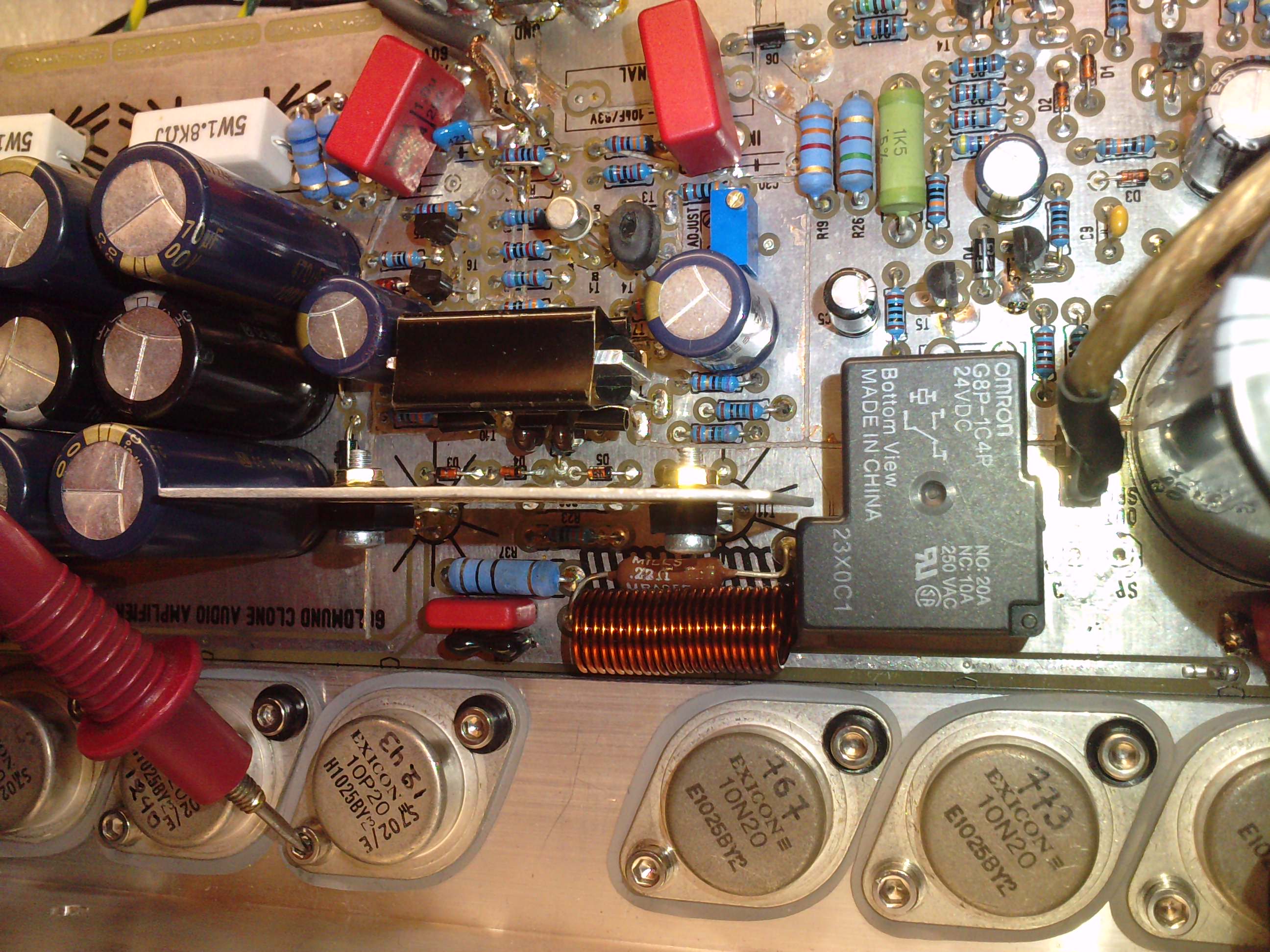

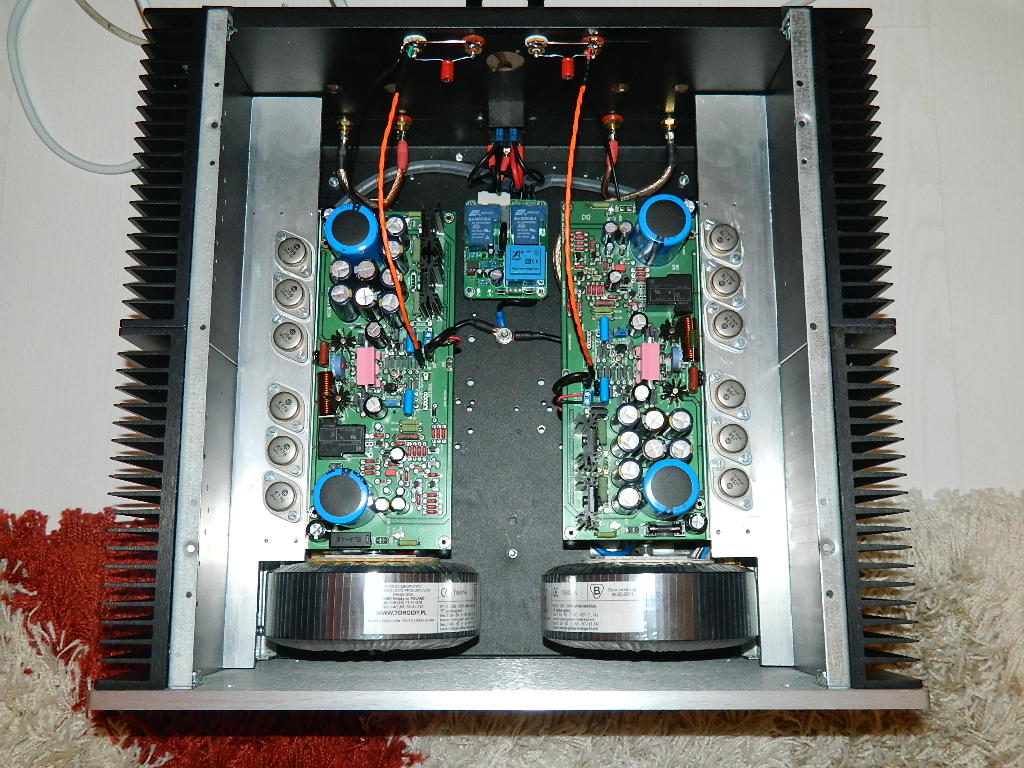

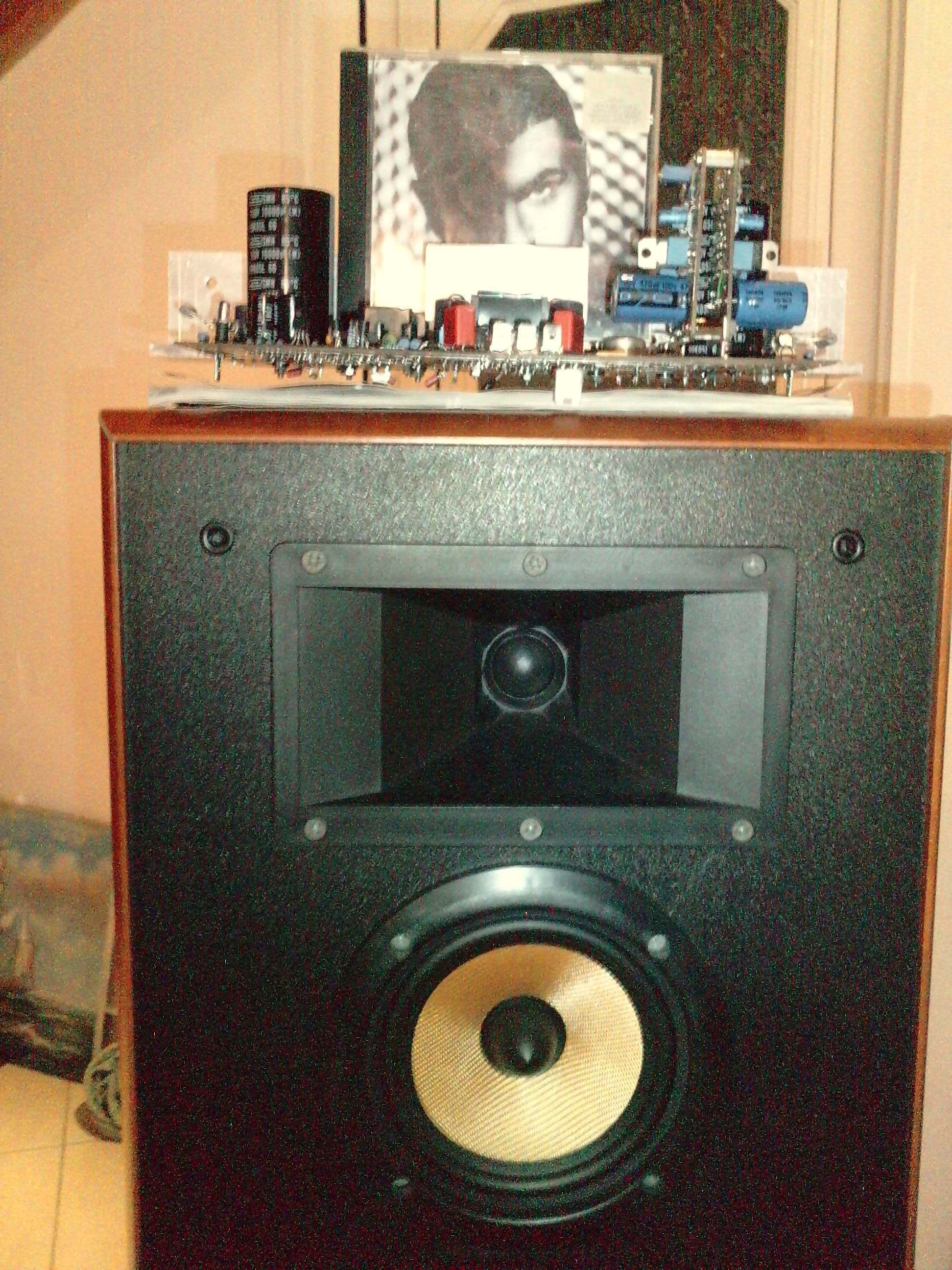

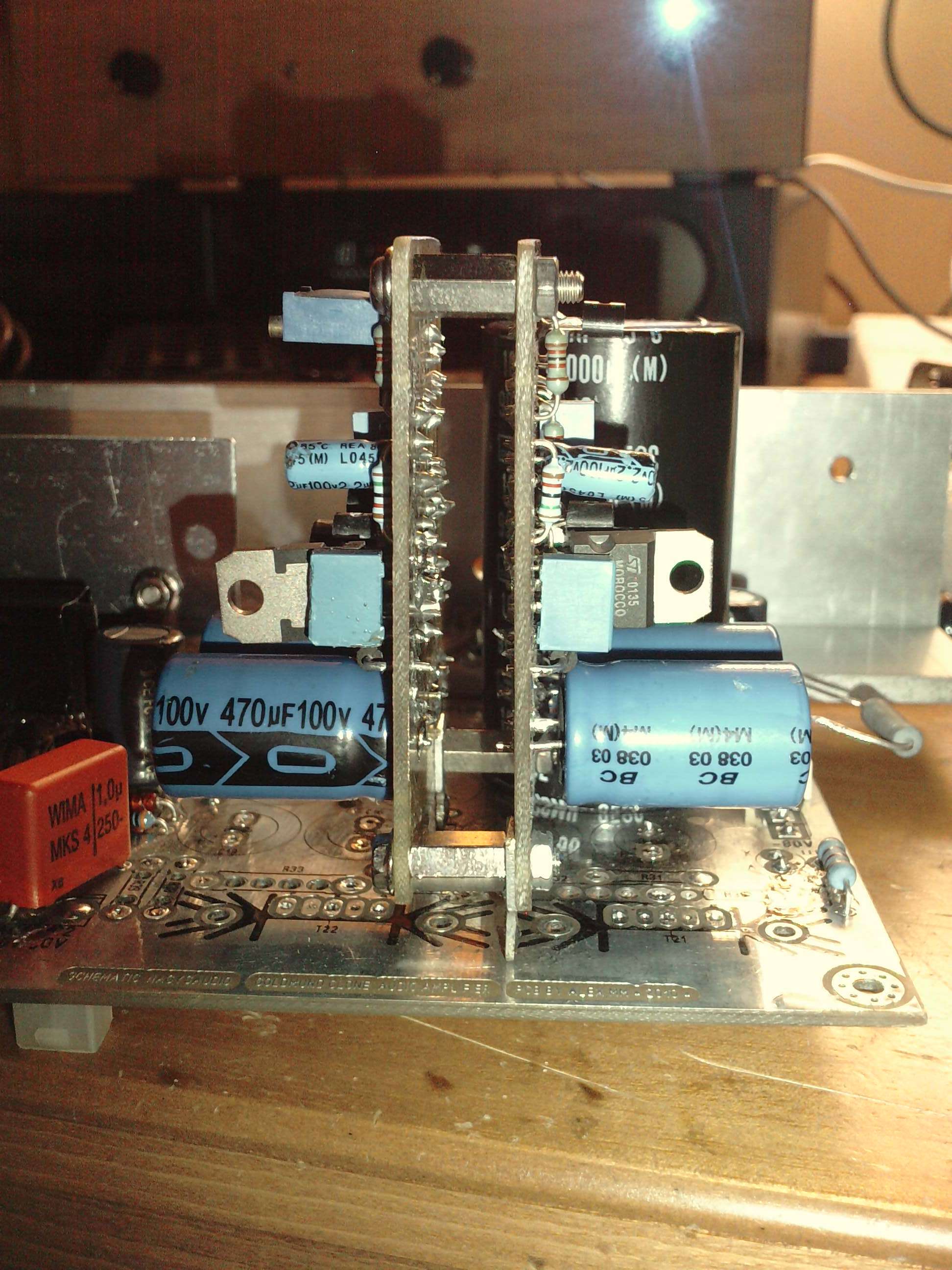

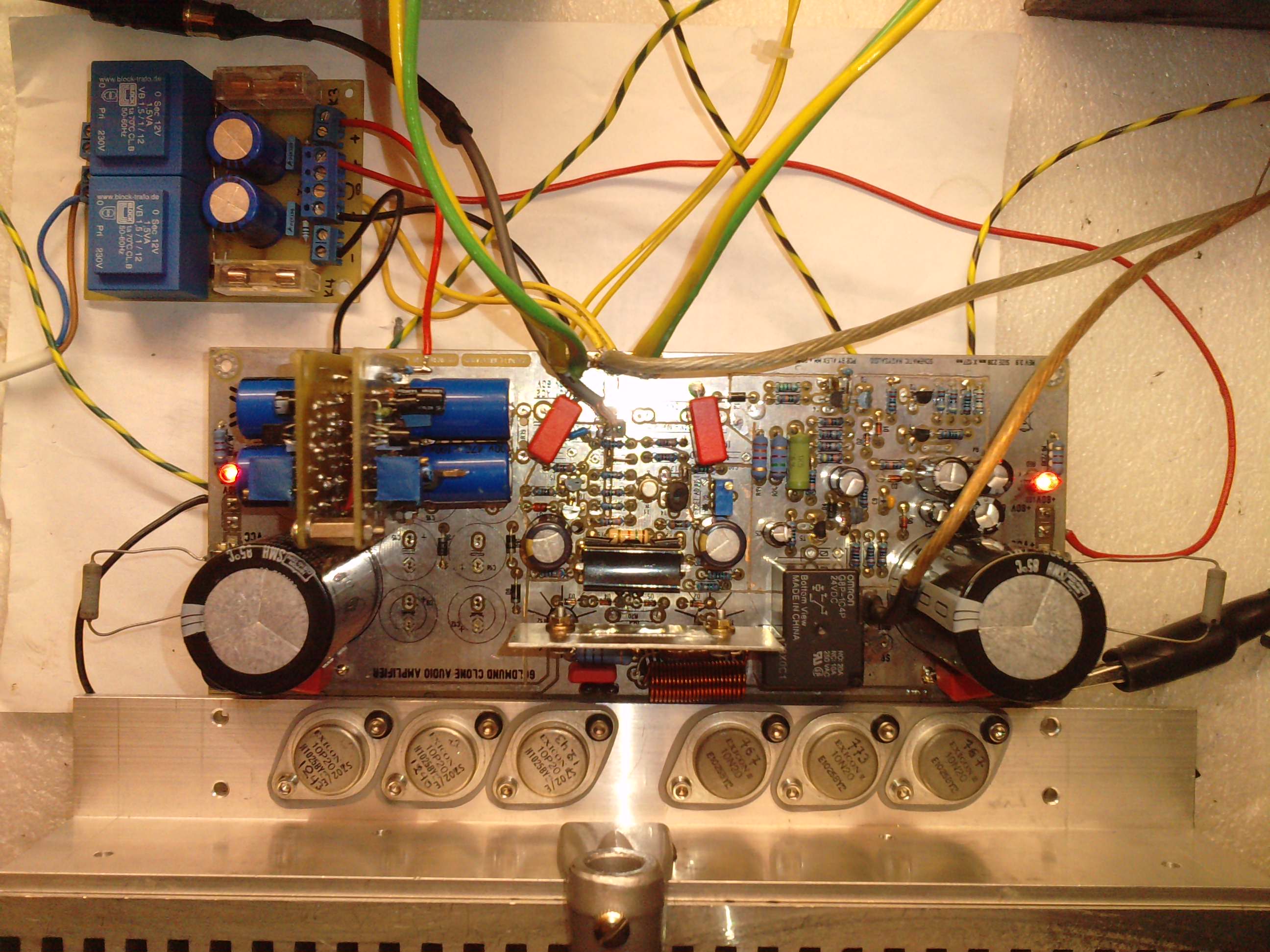

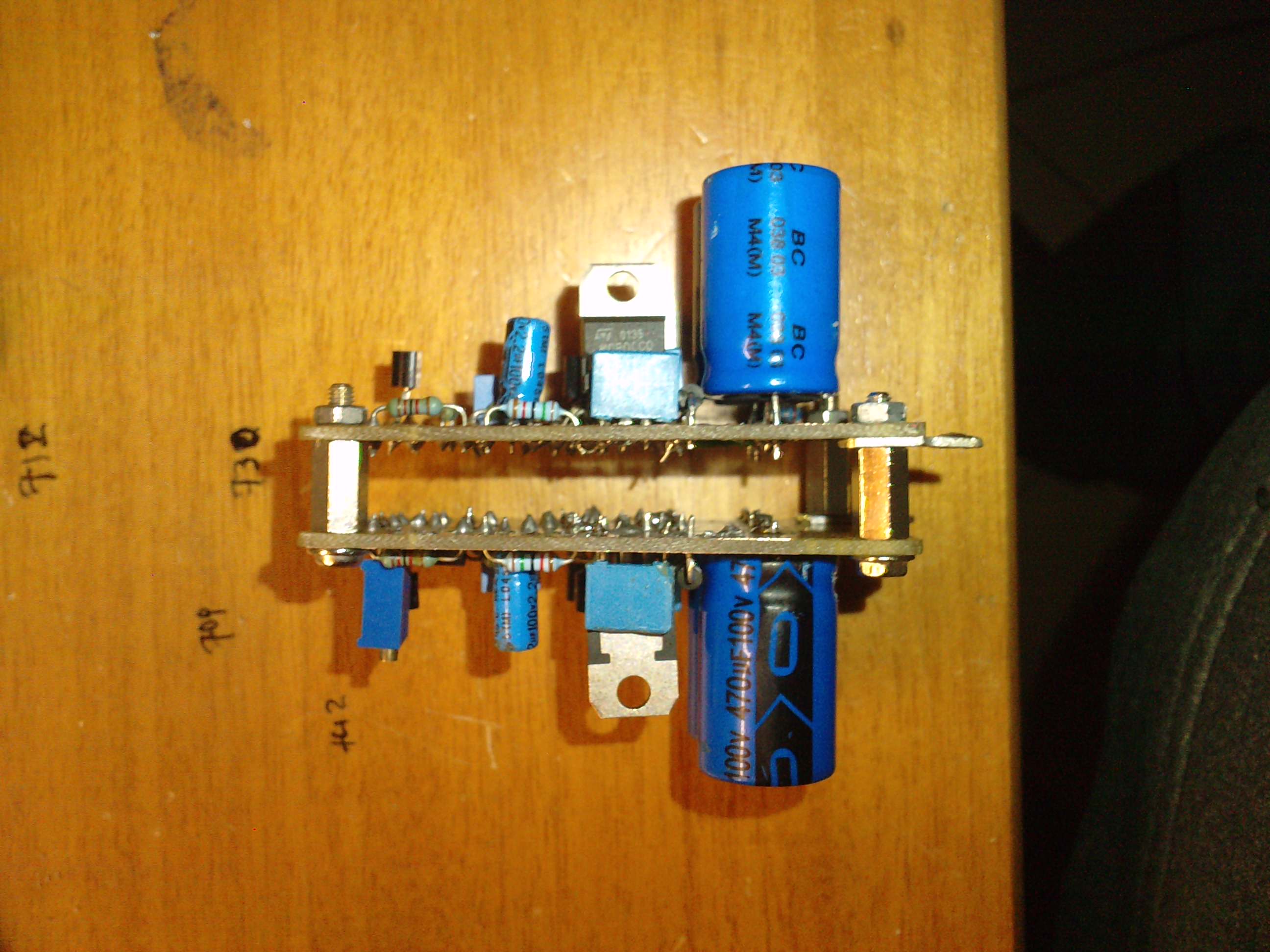

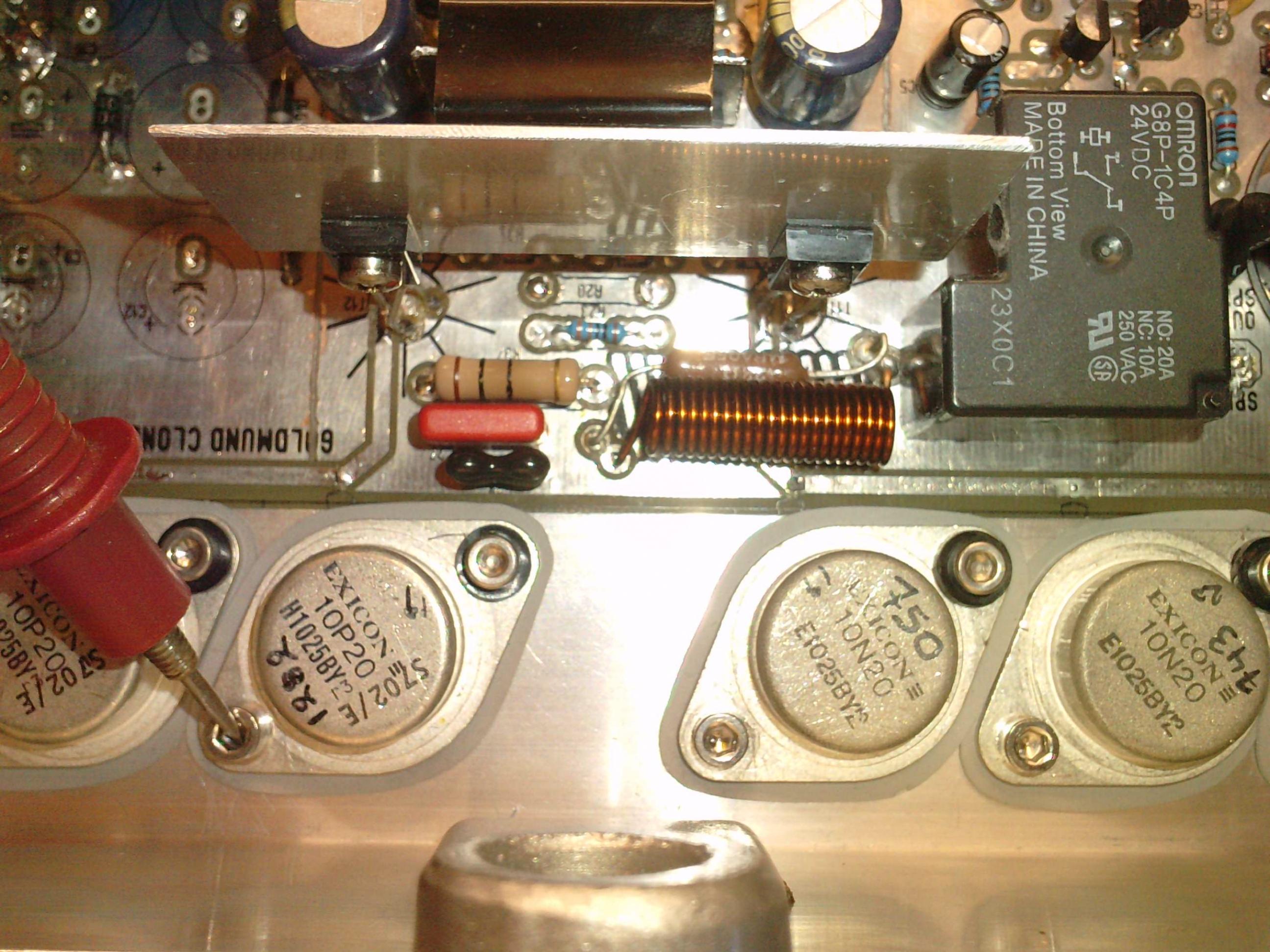

Now its time to put it on main board

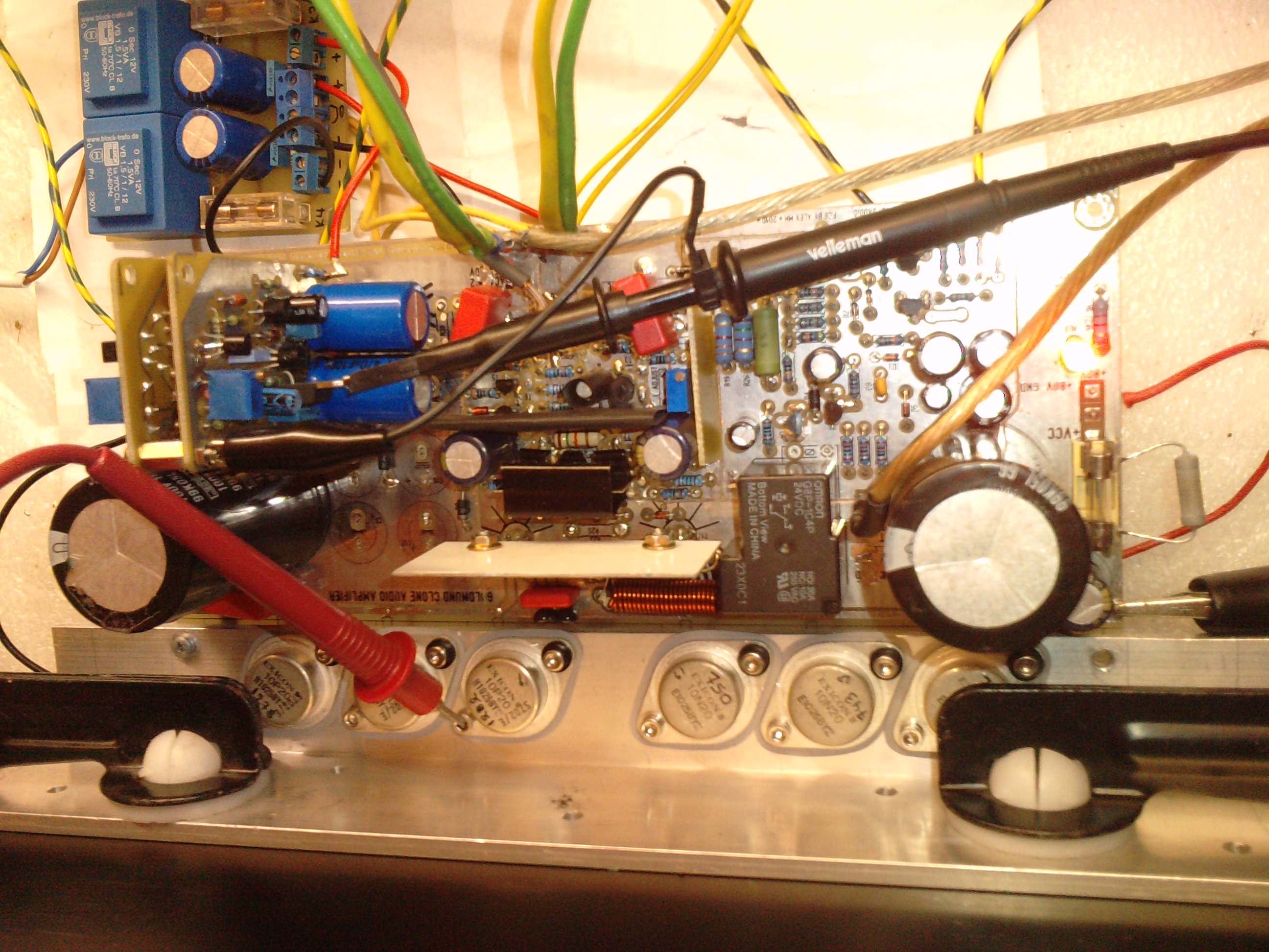

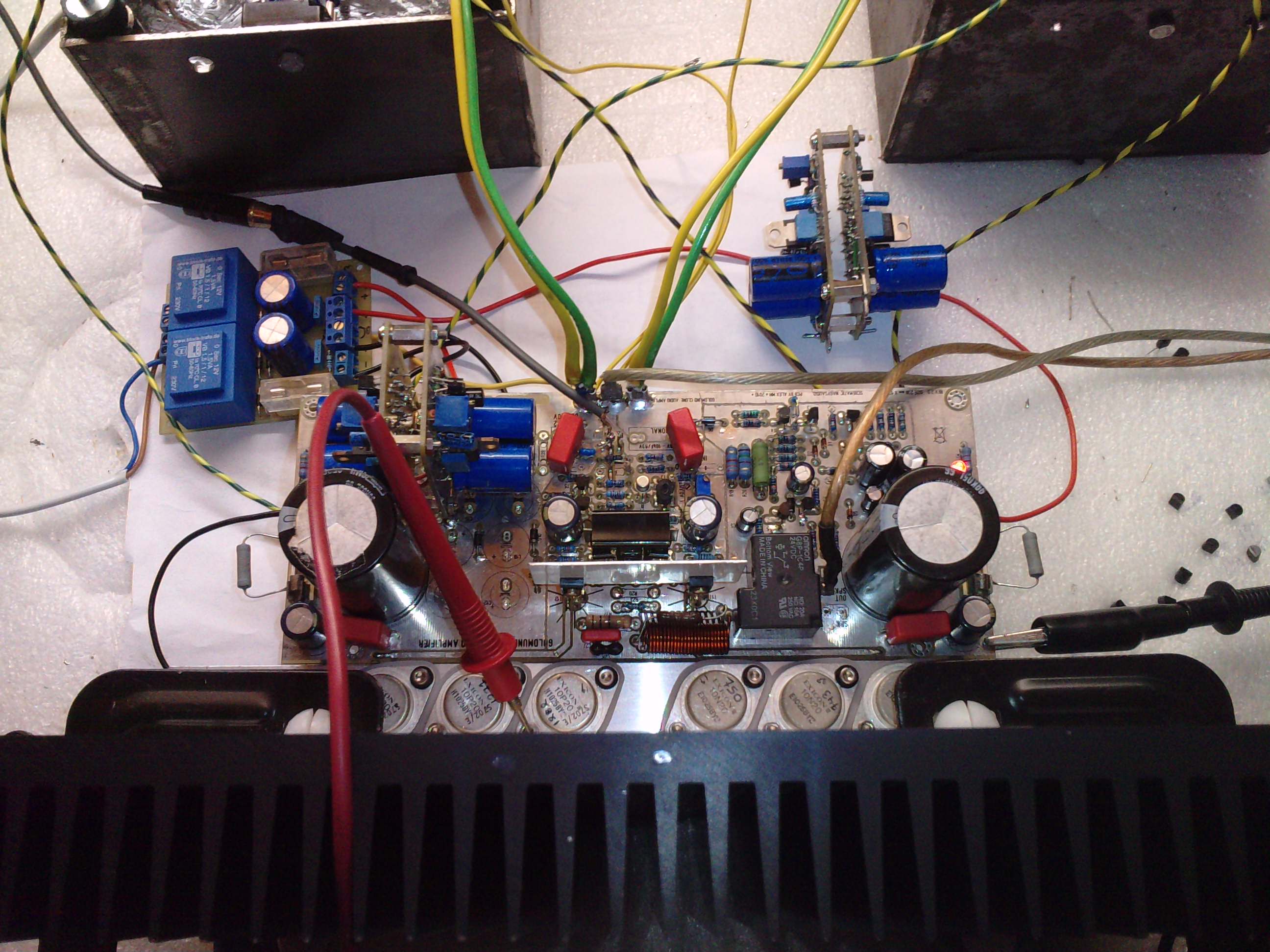

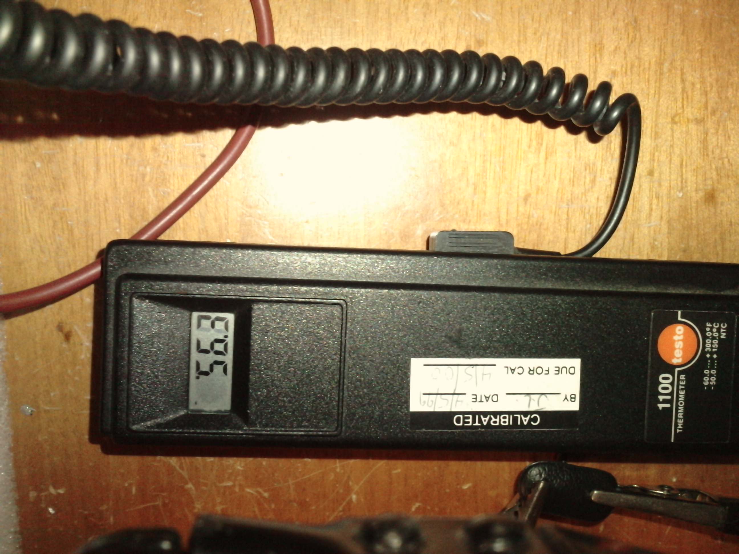

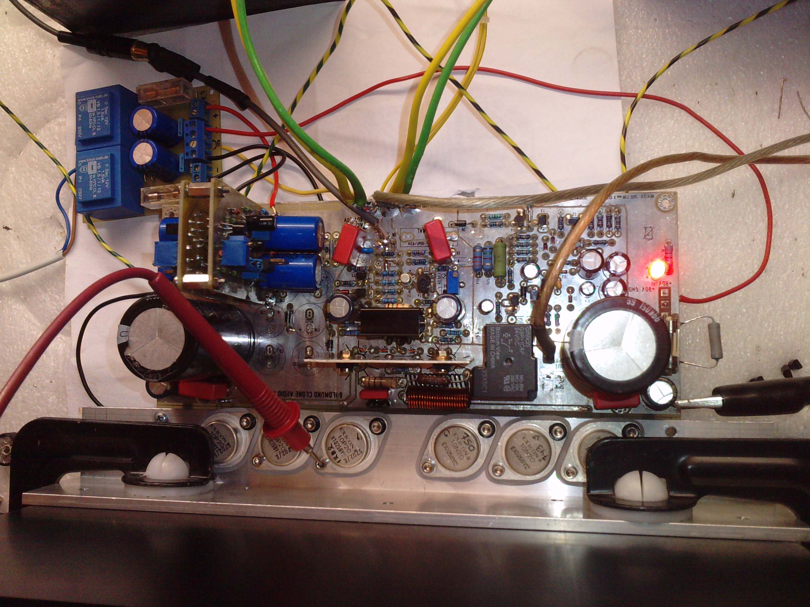

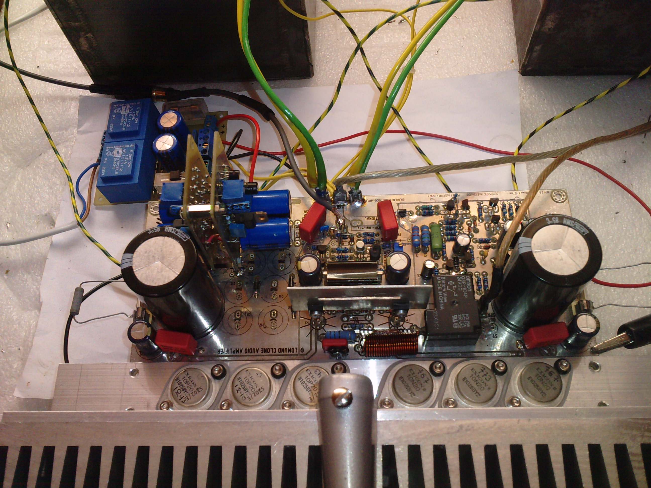

120ma per device 55-56 C on device 42C on heatsink as say it on manual.
Resistor R20 430Ω for 120ma +-/84v front end = 3035mv R14 3035mv R15 full load no fliker at all .
My friend Vit the drivers are KSA1381C KSC3503C

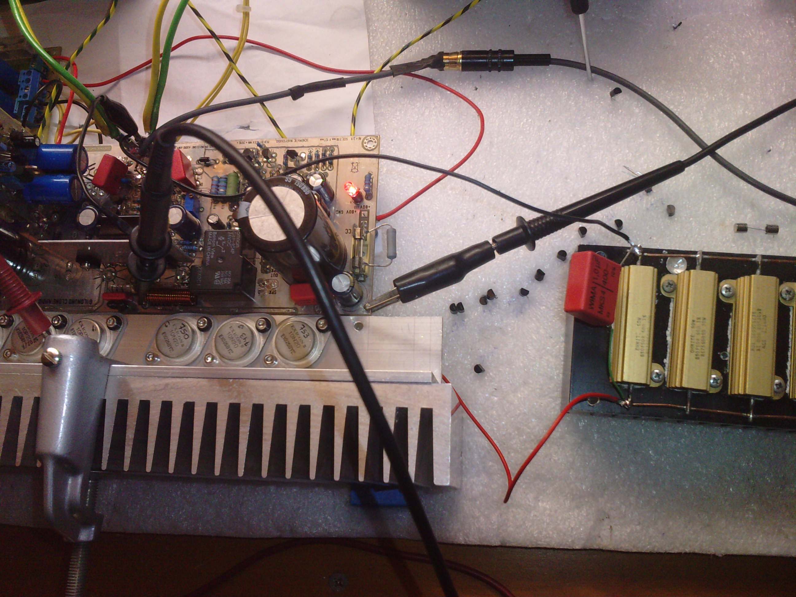

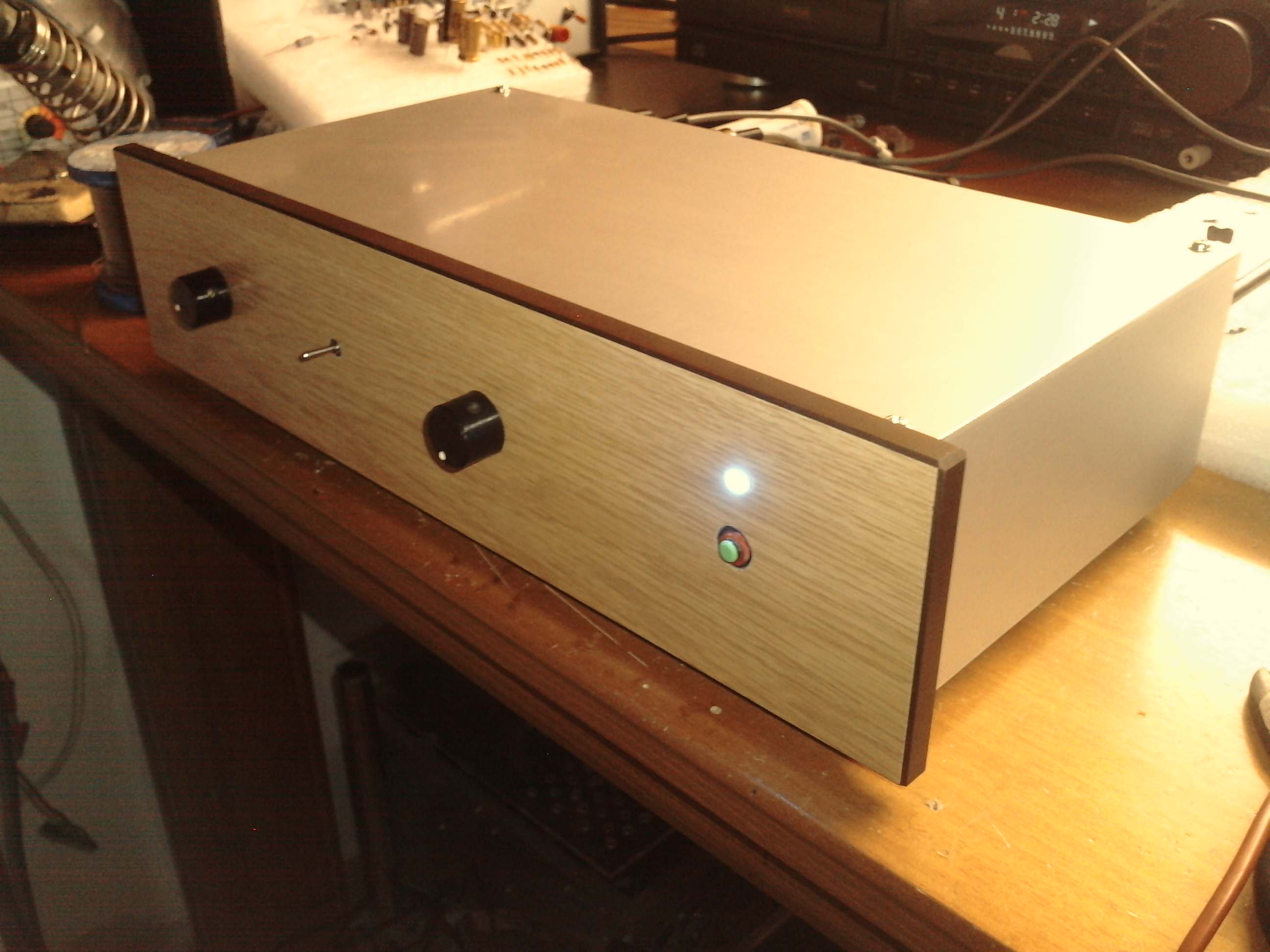

Goldmund 9.2
Next step BOX
42VRms on load 8Ω 118.7V p-p .Amazing sound with B1 buffer.

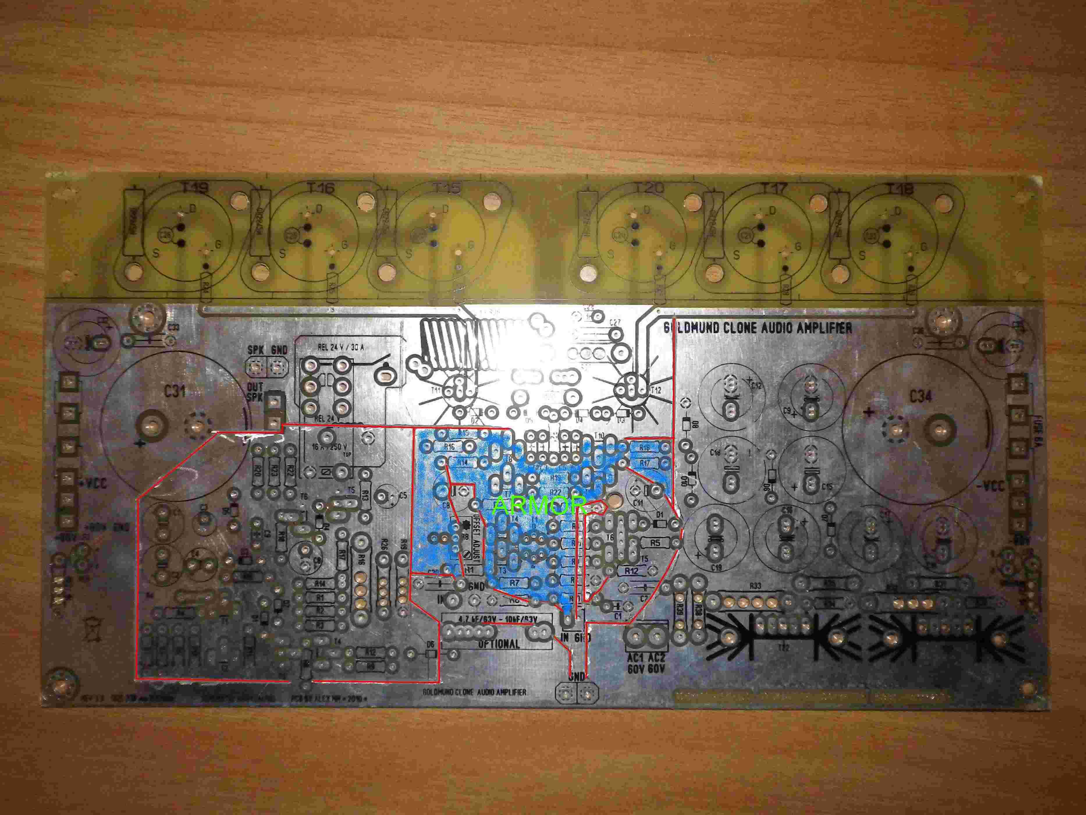

I'm sorry to see that this is yet another thread that has become so diverse that it is pointless. As A DIYer it would be nice to be able to find a DIY design that could actually be copied at home. This seems to be a mixture of someone modifying some ancient old design vs a new PCB design that is full of flaws.

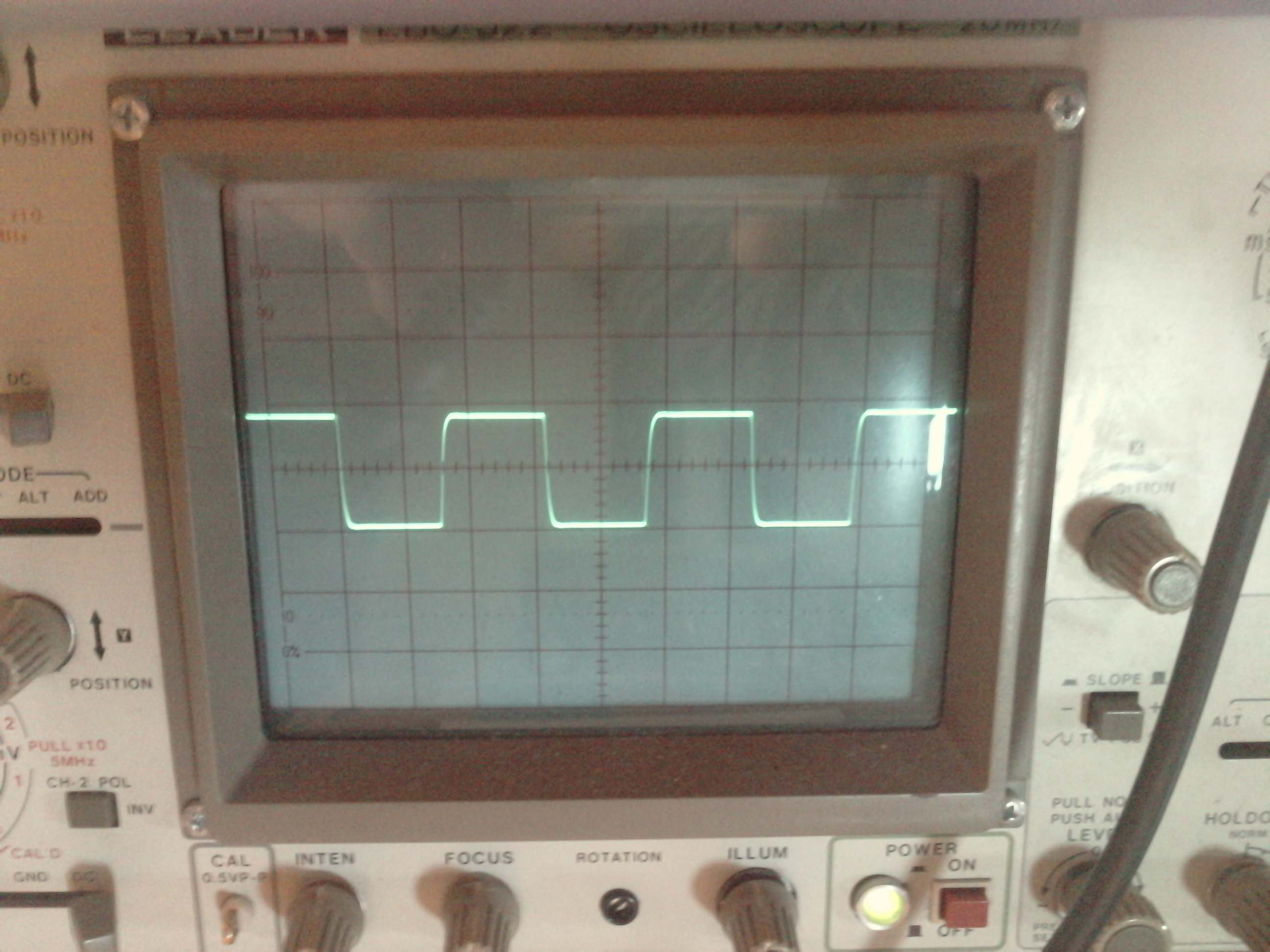

6) 100khz
7) 200khz
9) 1khz -1mf
5) 10khz-1mf
4) 20khz 1mf

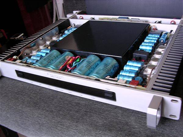

More than 20 years ago I fall in love with a mimesis 3, and loved to have mi own clone. Not only the circuit seems very good, the look of the slim amplifier was also important, so make a modified clone that only resembles the original (when looked from the distance)

It's time for you to show some new ideas and new pcb design.

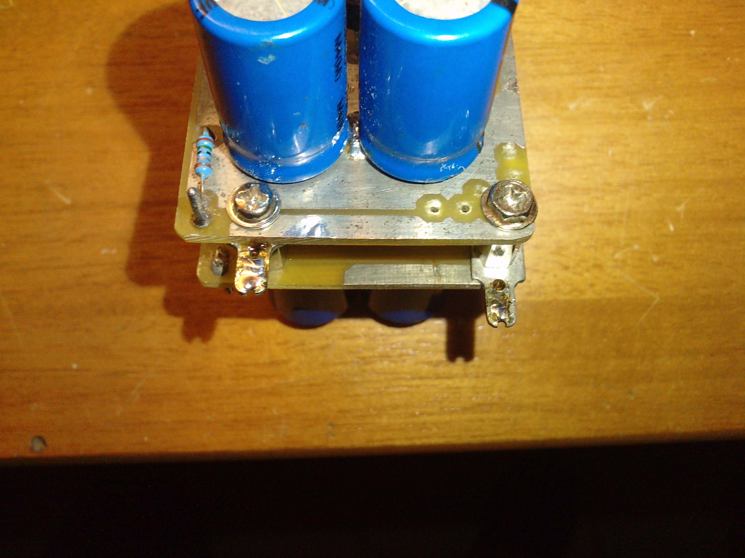

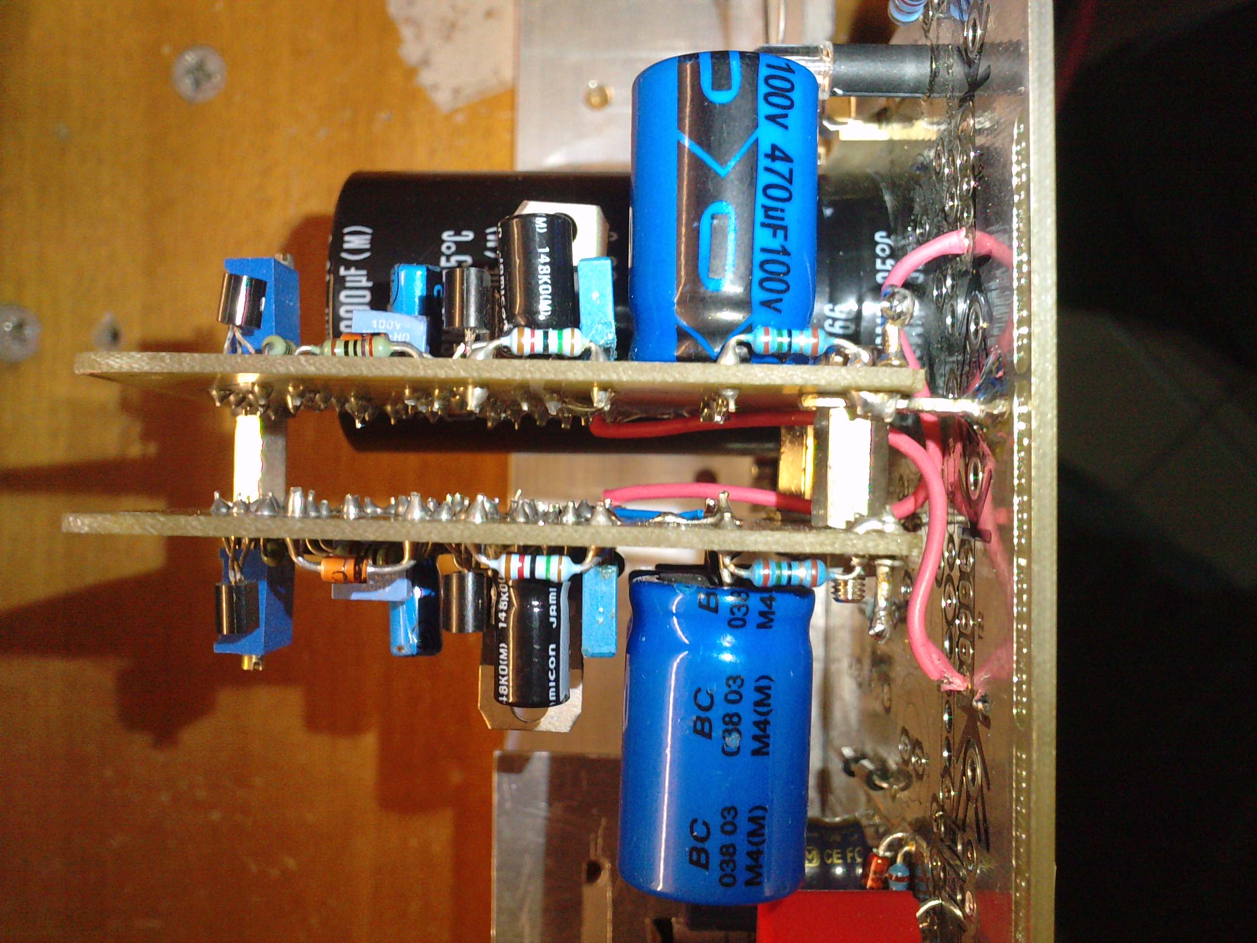

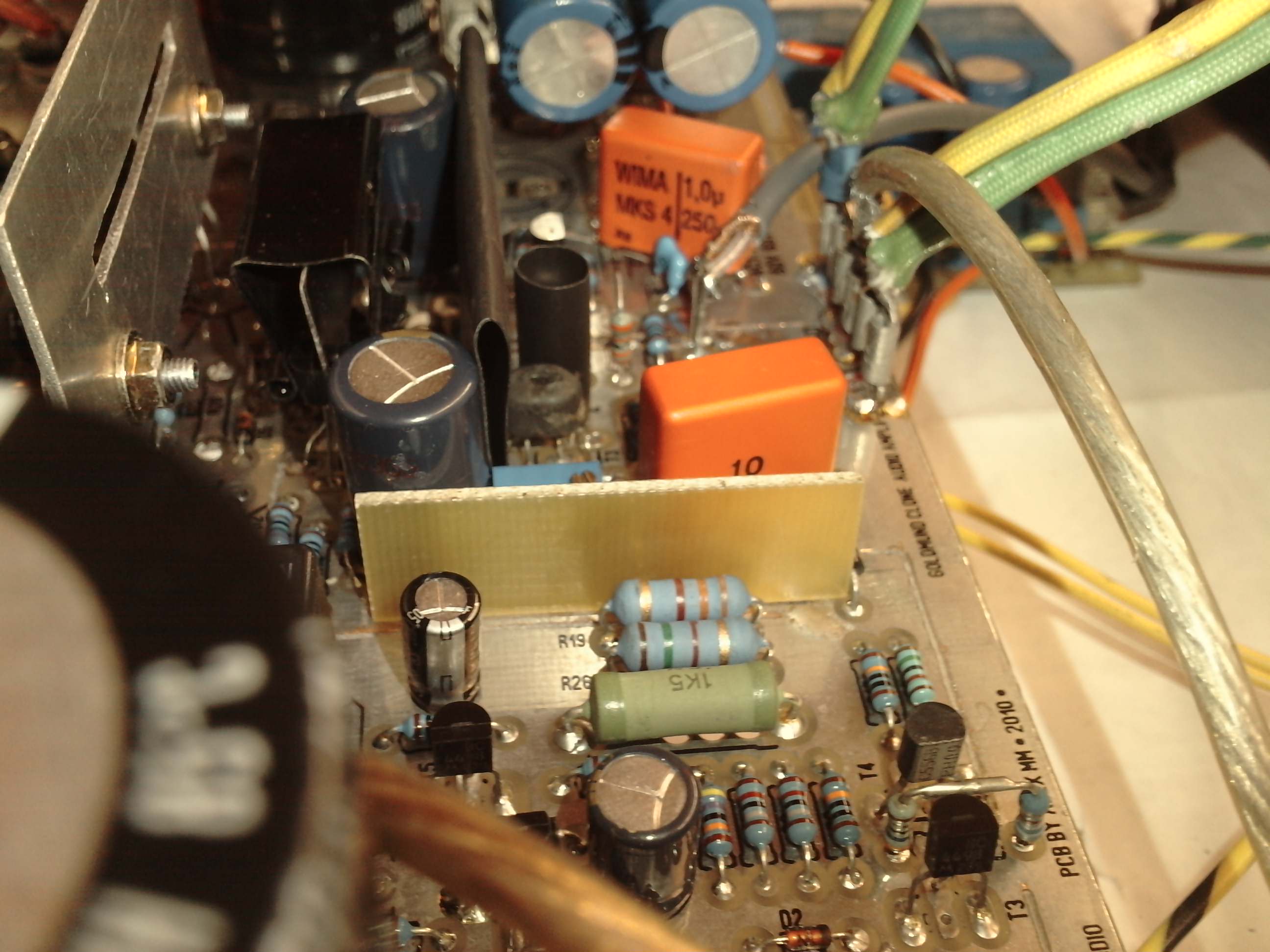

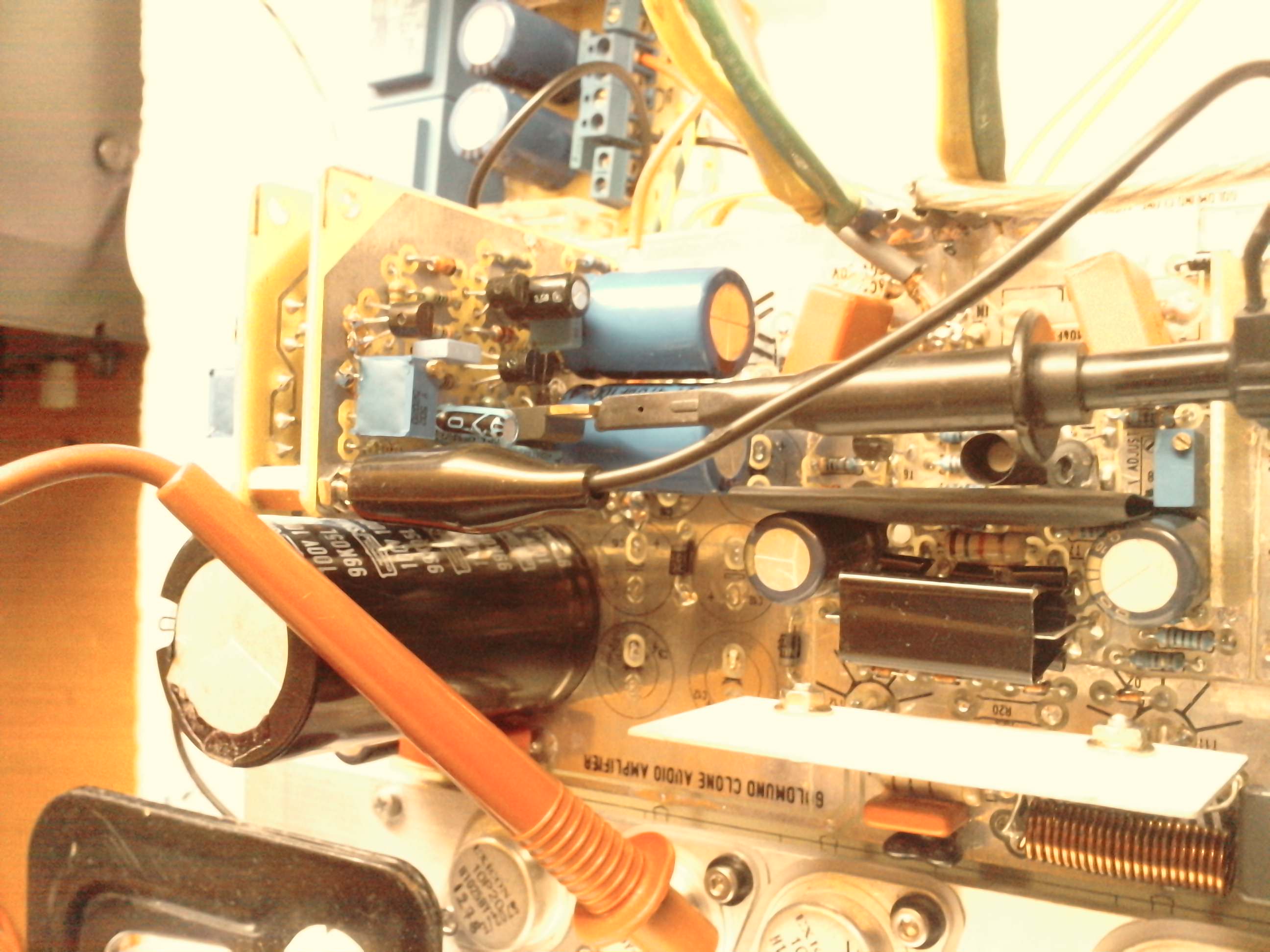

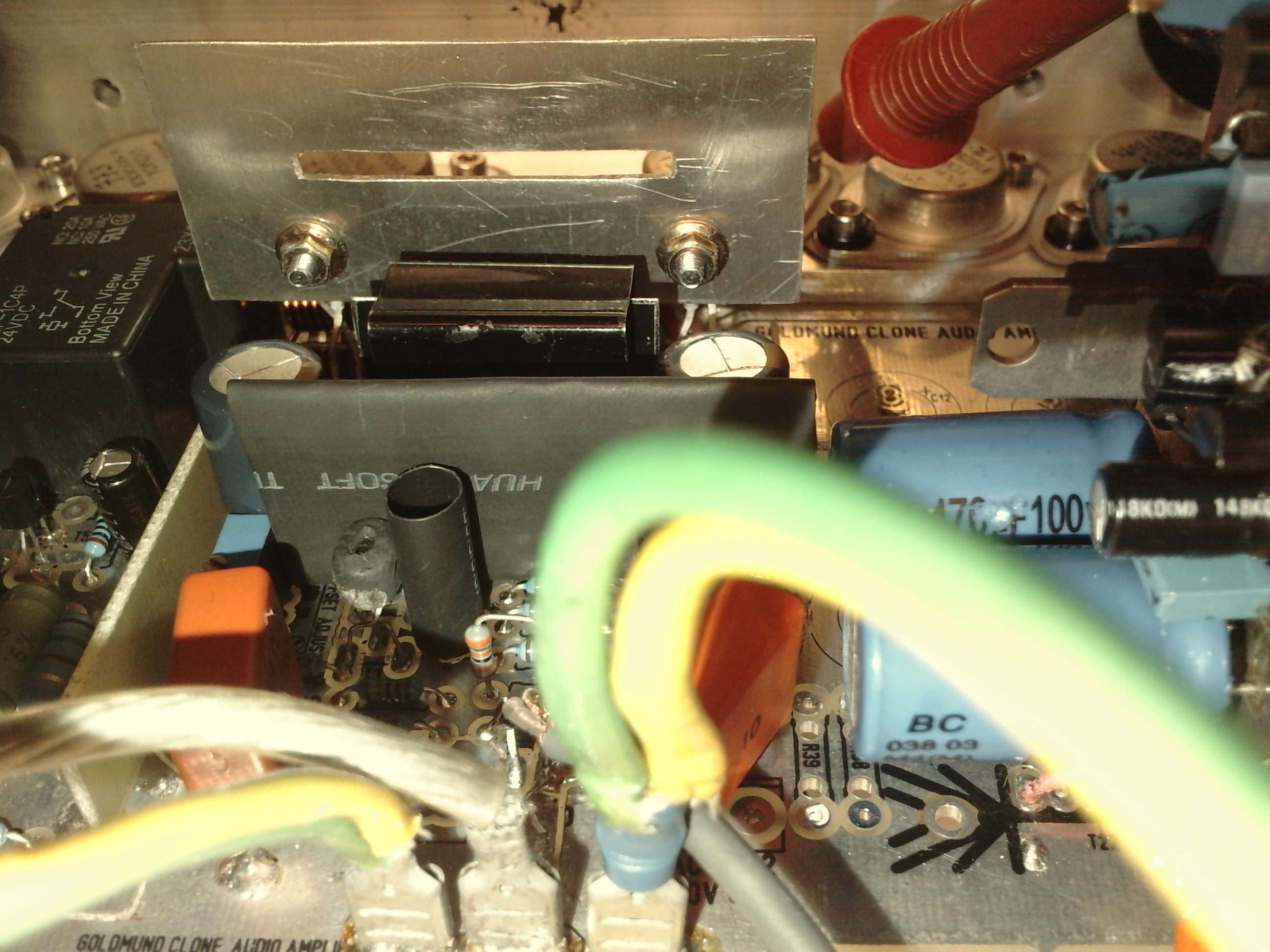

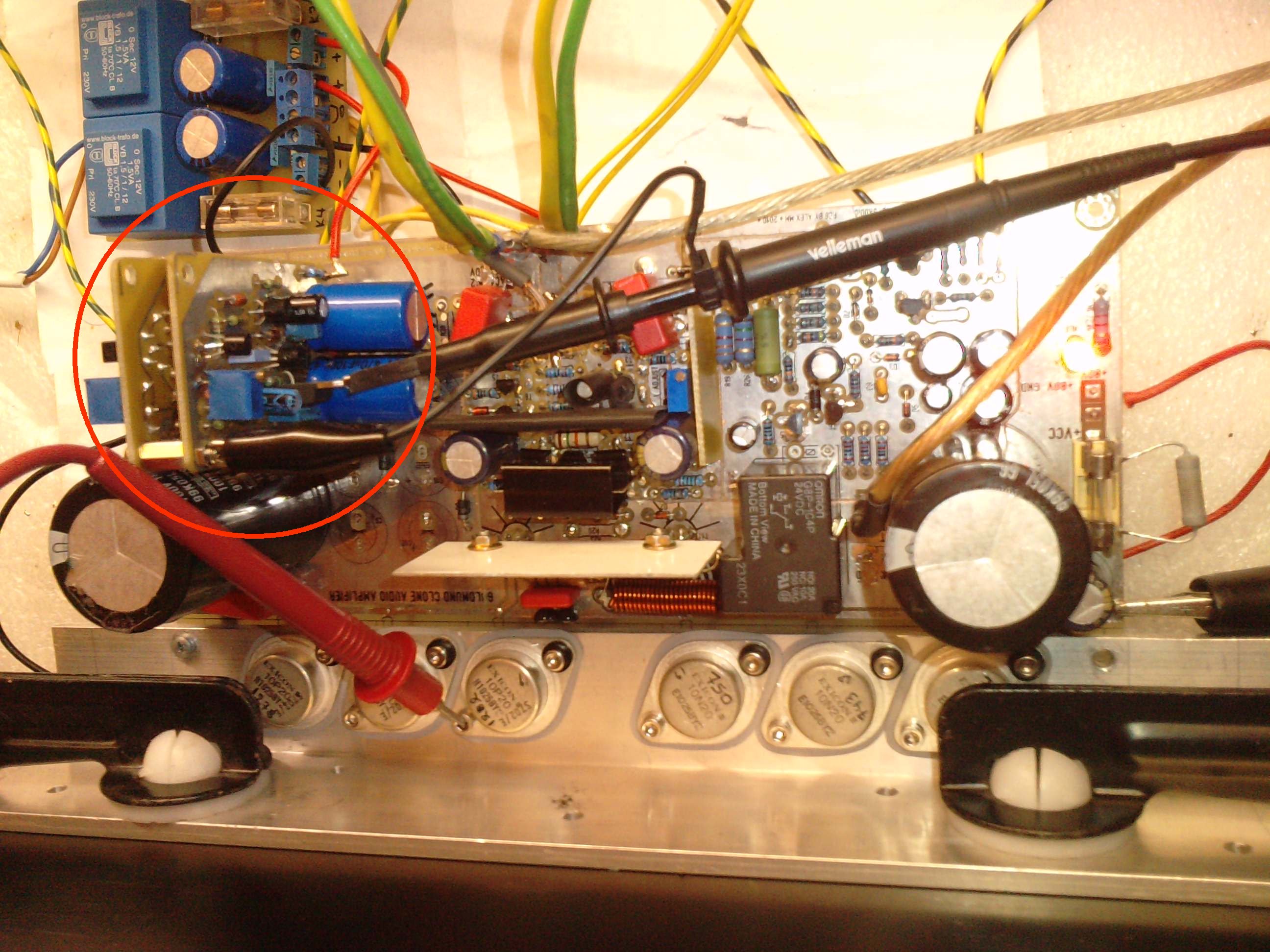

Τo all the friends who have built the amp this is the way to exterminate the offset :
+-/1-2 mV.
With a simple insulating between jfet and Vas plus insulating the jfet .
Isolating the input stage of the temperature coming out of the VAS and the nearby big resistor .
offset is always 1-2 mV and the value on resistors stable R1=3035mV and R2=3035mV.
120ma per device temp on heatsink 47C degree stable .
That's why the GOLMUND company enclosing the input stage to avoid the temp and for mechanical grounding reasons .The jfet transistor corroborate any defect.
Nikos

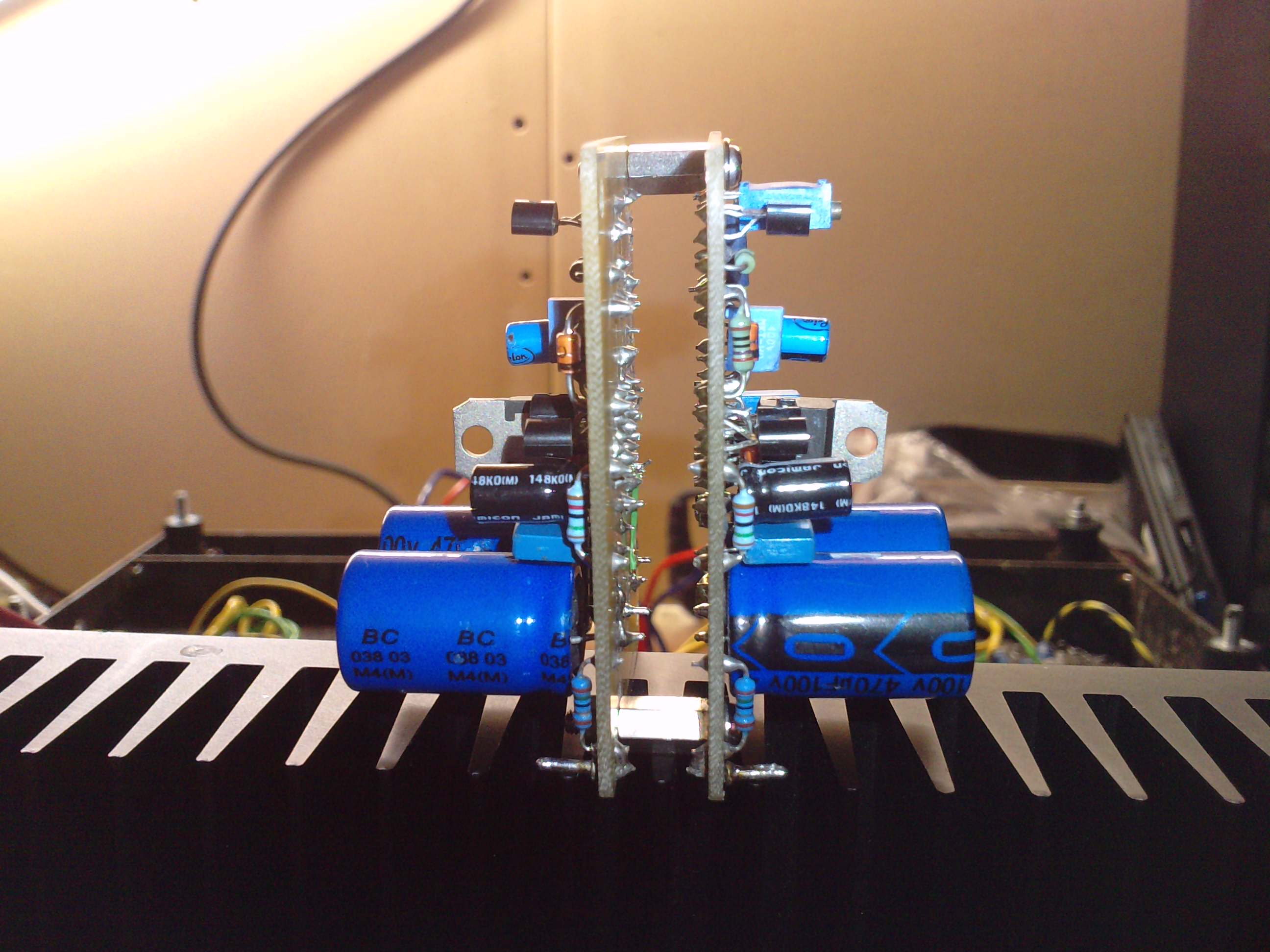

All the above requires the removal of old-timer power supply causes a temperature overmuch on pcb through ground plane .
That's why from the first moment split the PCB in areas and ground star reasons .

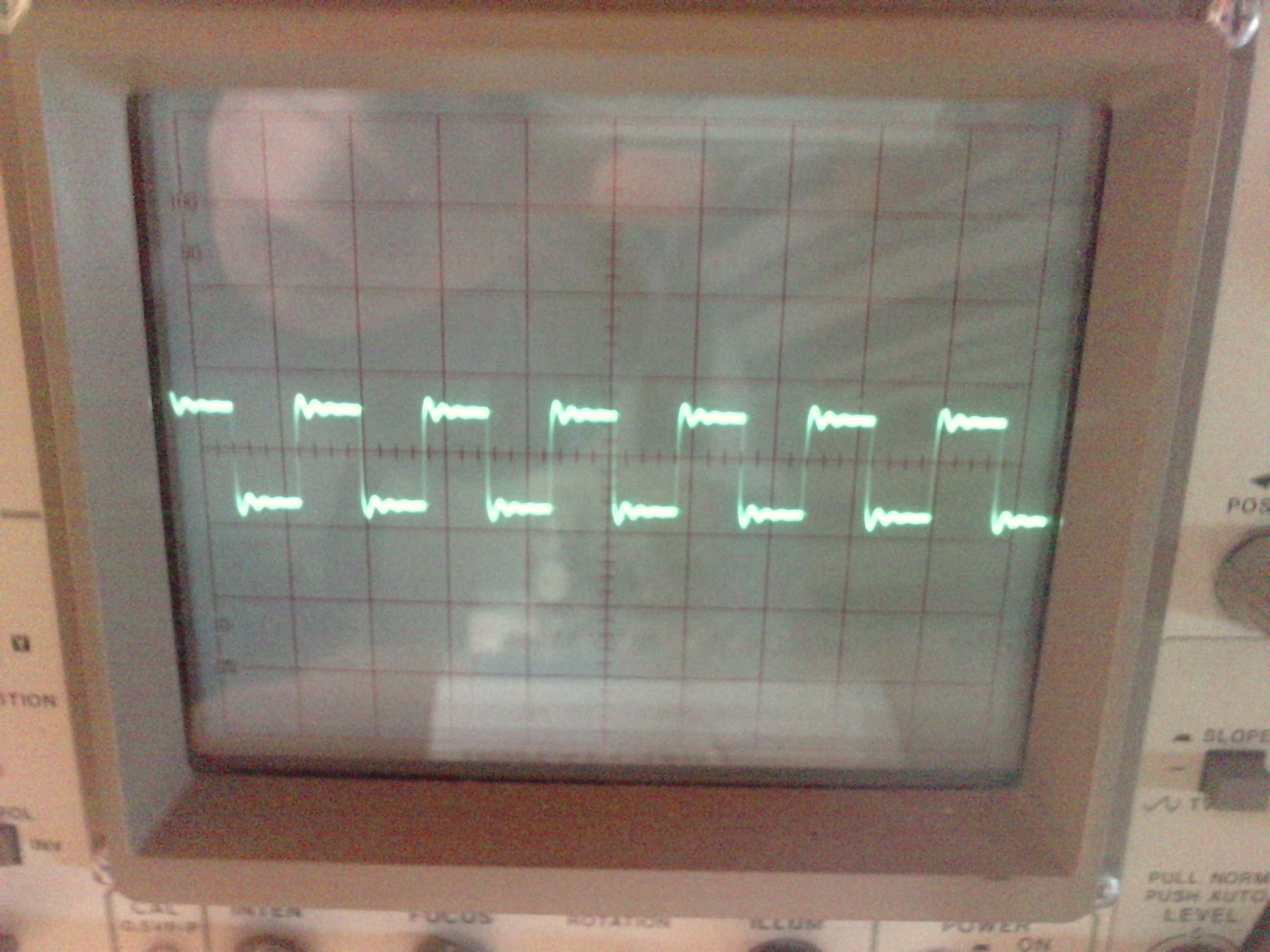

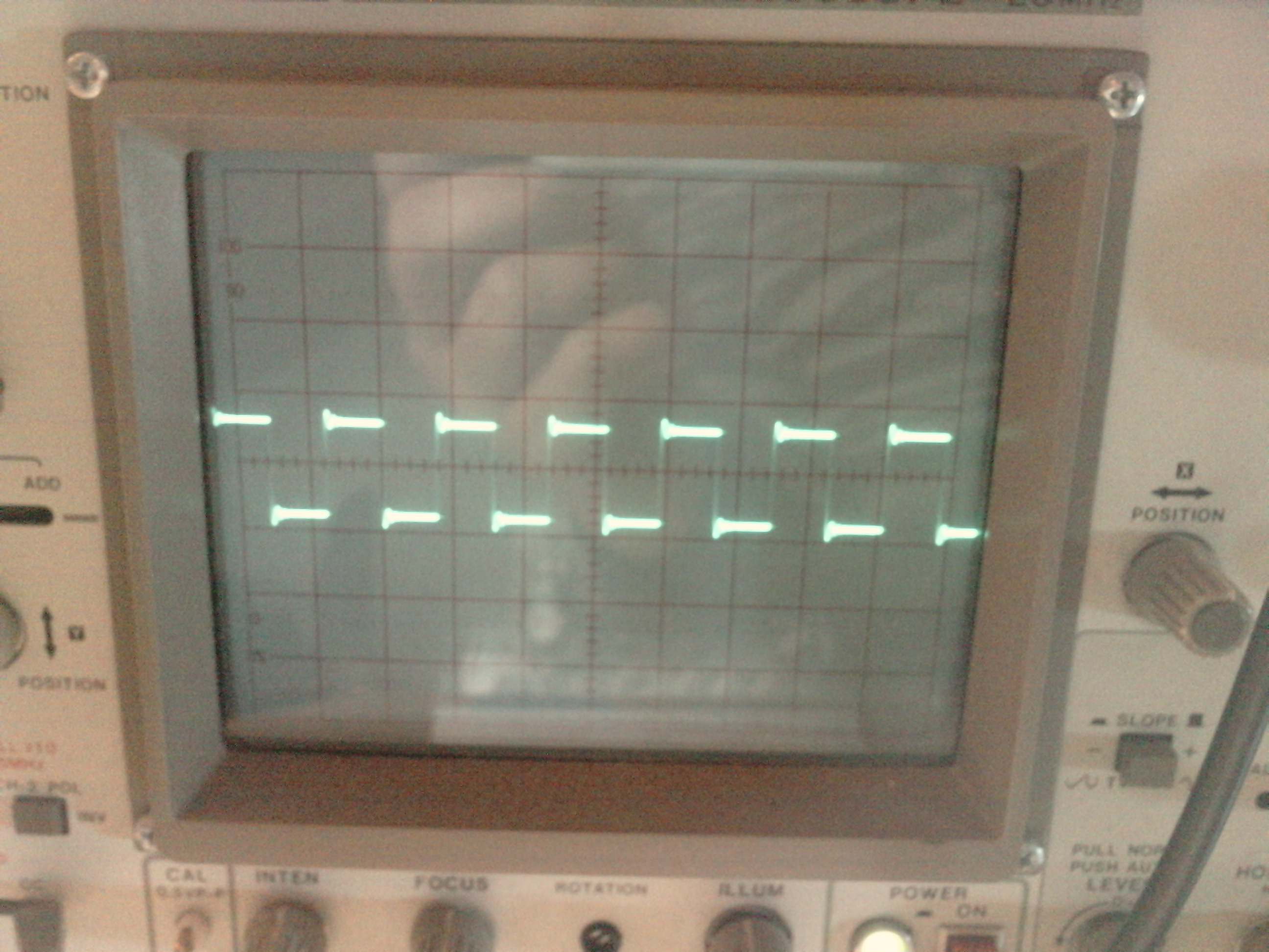

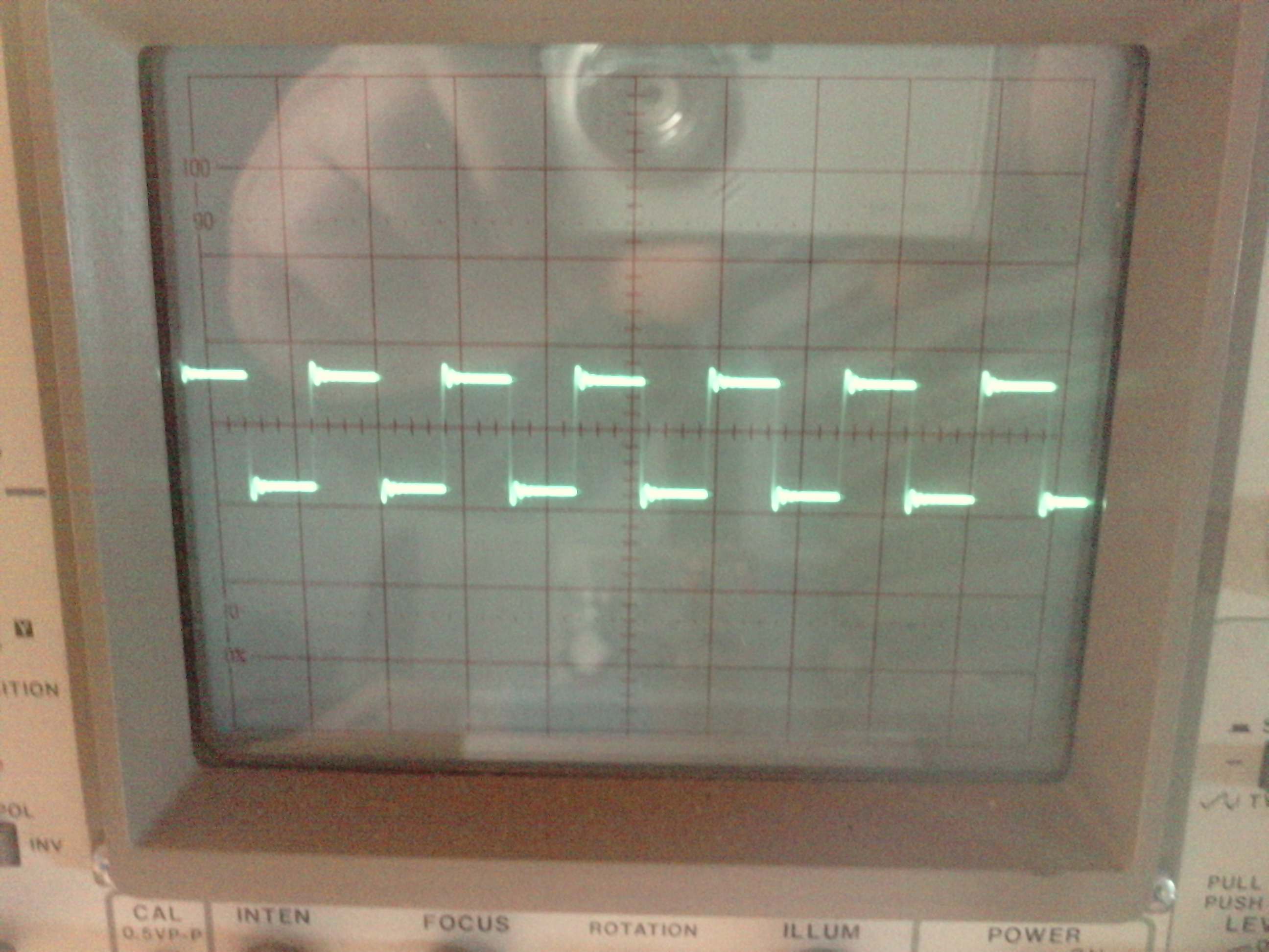

Goldmund 9.2

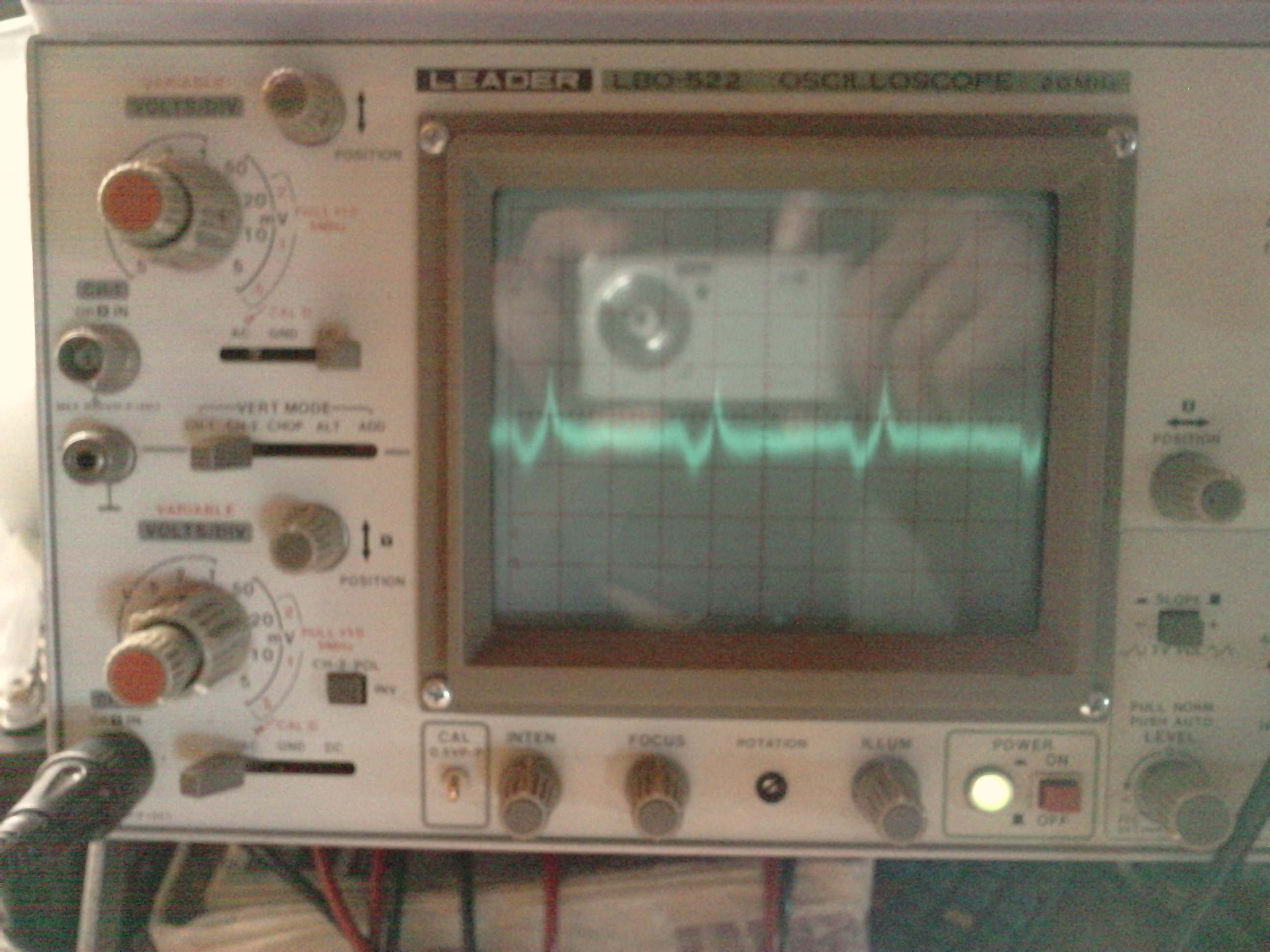

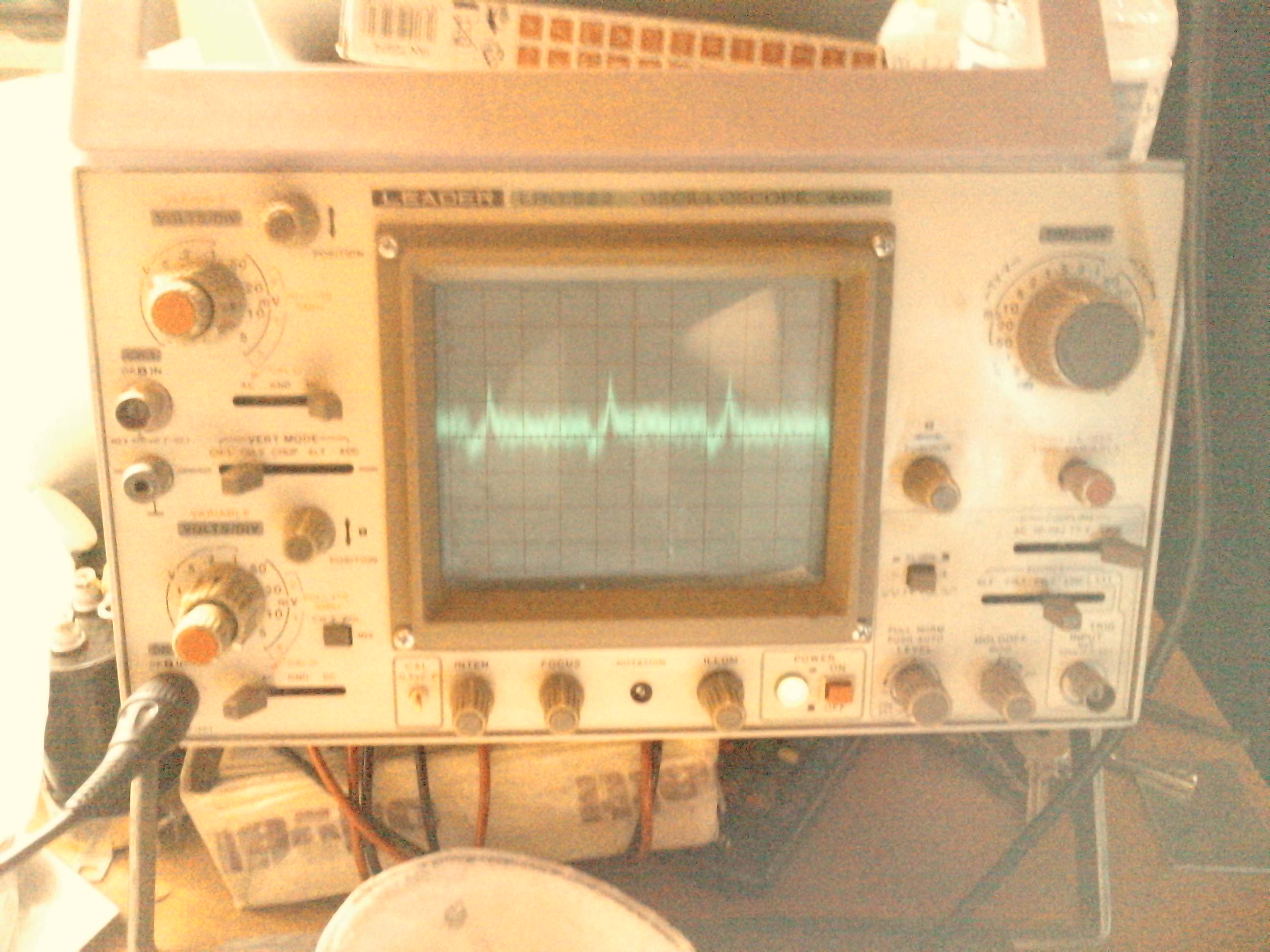

Ripple of front end
probe X1
vots/div pull out
