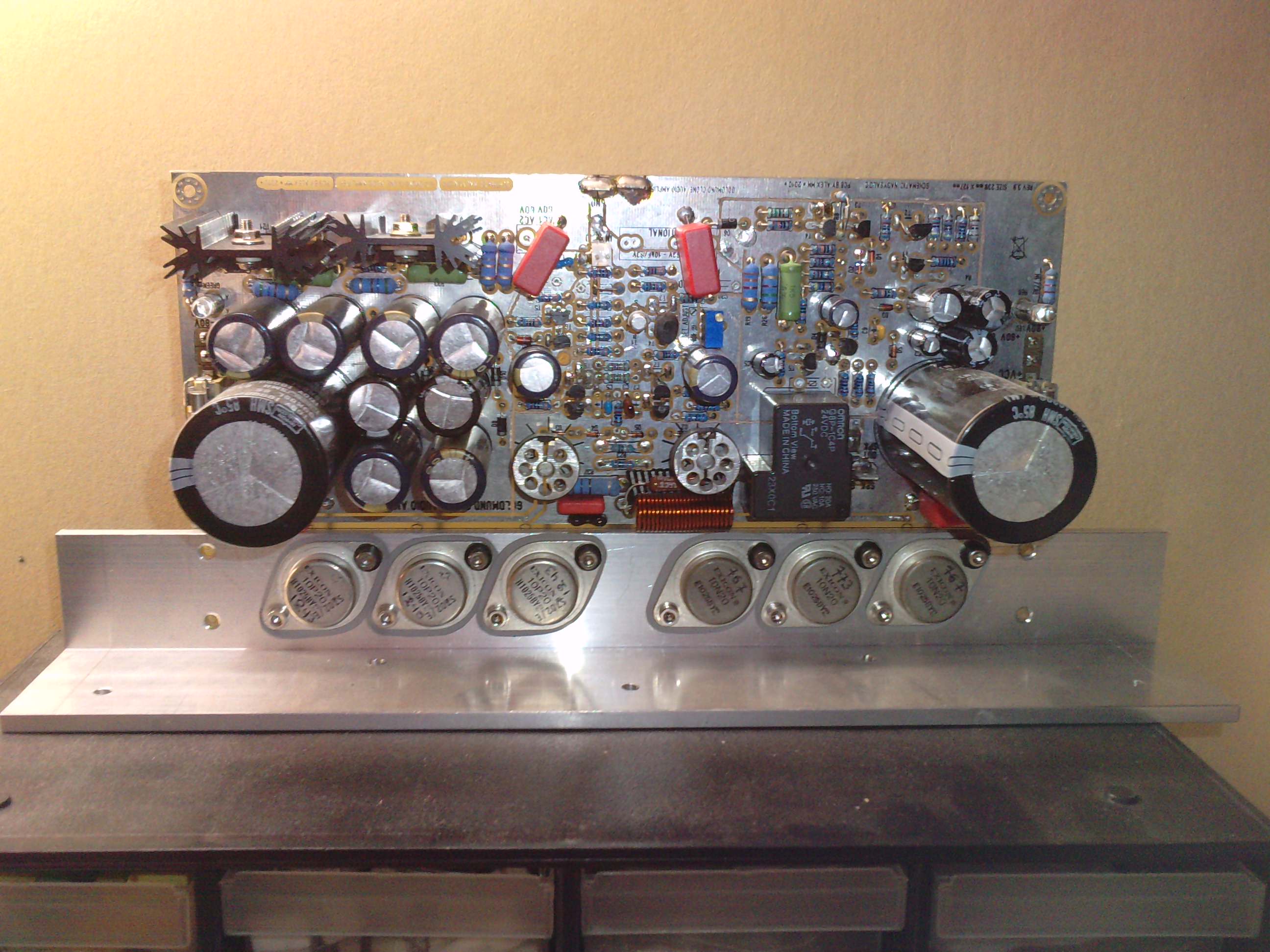

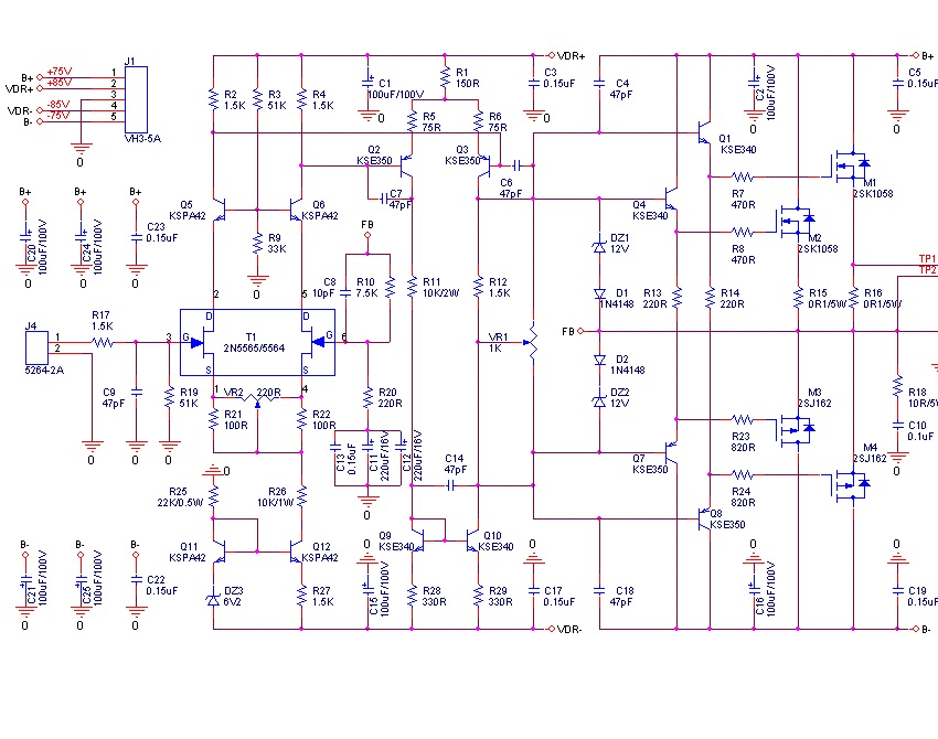

Does anyone knows the official the value of bias mimesis 9.2 ?
With R20 330Ω gives 0.6 V - 0.28V on gates for P-N devices and about 30-40mA for each device. My devices are EXICON. +/- 70 V rails.
Regards Nikos
"(E) T11 0.6 V (E) T12 - 0.28V" only 0.88v to open "BIASED" the two MOSFET final stage seems a little, I think your amplifier works in class B. Acording by datasheet SK134,SJ49 Gate-source cutoff voltace 1.45v u. need measured around T11 E+1.45V, T12 E -1.45V for running class A-B. thermal stability remain good questions,ideally u need R20 combination or replaced with super diode circuit, Mosfet output stage and equaly biassed around 50mA for all devices. good luck.

Have a look at post #677. I can confirm that "R20" was set to 270 ohm on the MM9.2 with A2 module and 300 ohm with A1 module.

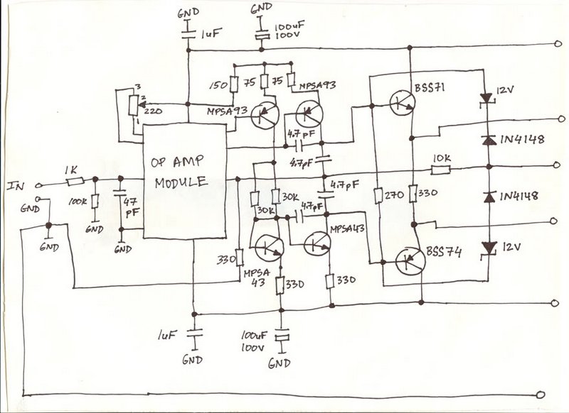

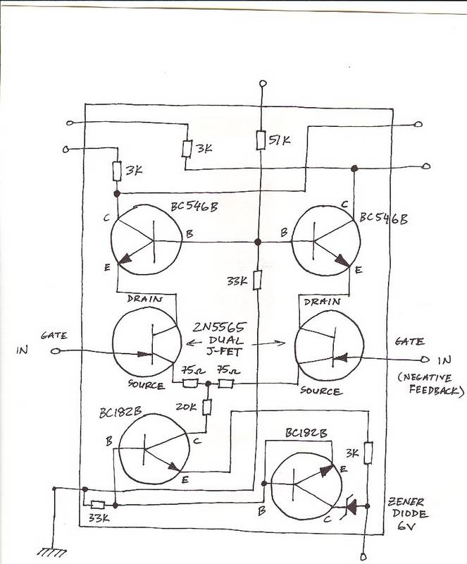

schematic
@Algar_emi schematic lost in time ..... 🙂 PDF schematic was drawn acording this hand ......
Regards,Alex

Are You sure about T6?
Sajti

Tommy thanks for your responce
But i want practical answer if someone measure the current idle .If 100ma for each device 300mA total for one rail with 4700mf/100V......
my devices TO3 EXICON 200V with +/- 70V rail needs 390-410 Ω R20 for 100mA but the balance of Vas need lower R19-22 about 13.5-14kΩ.

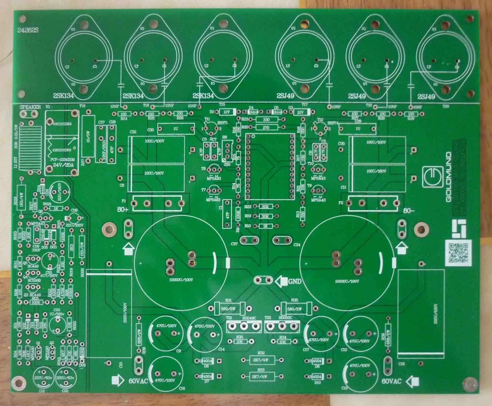

Hi Alex

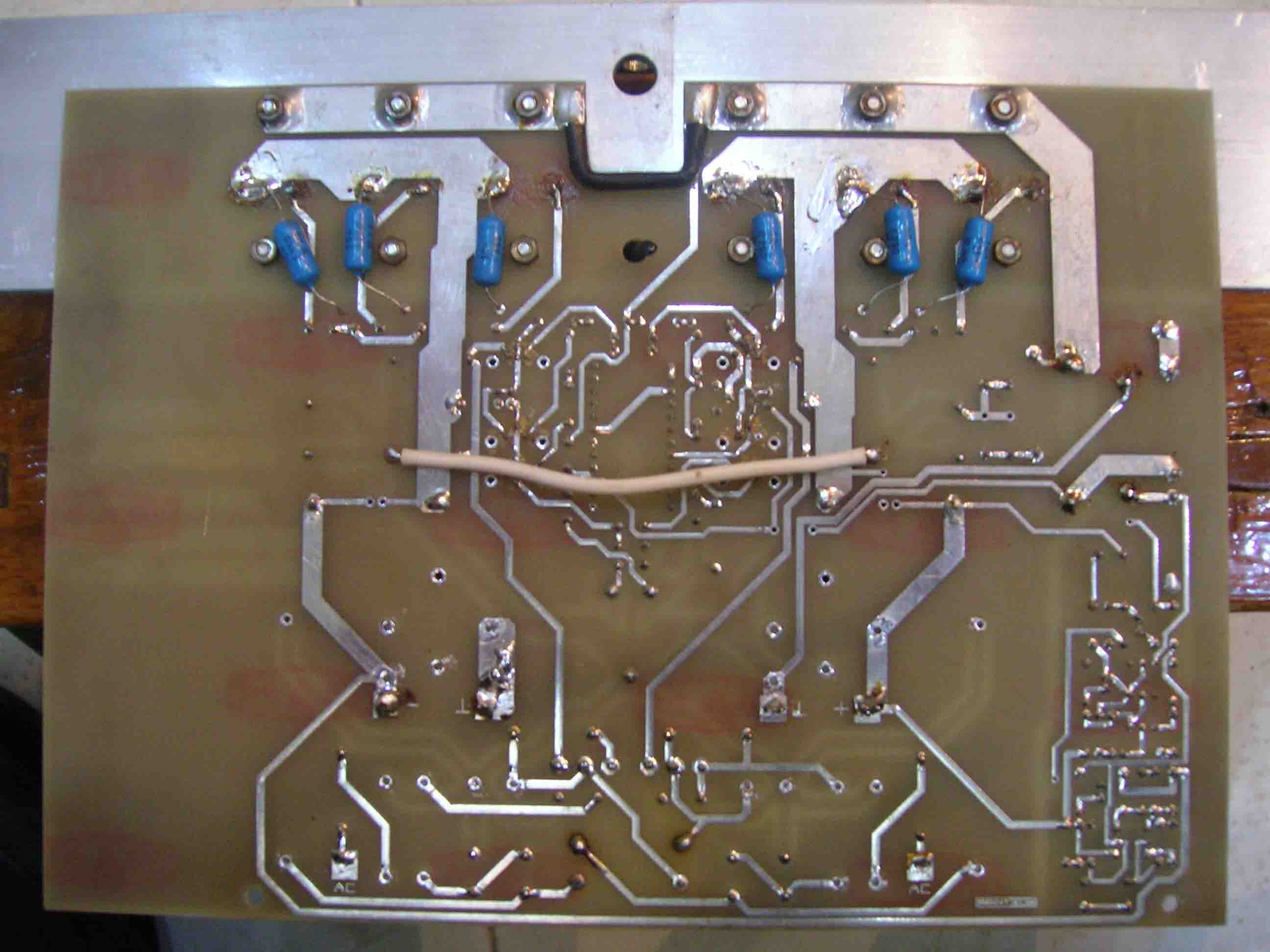

look what i found

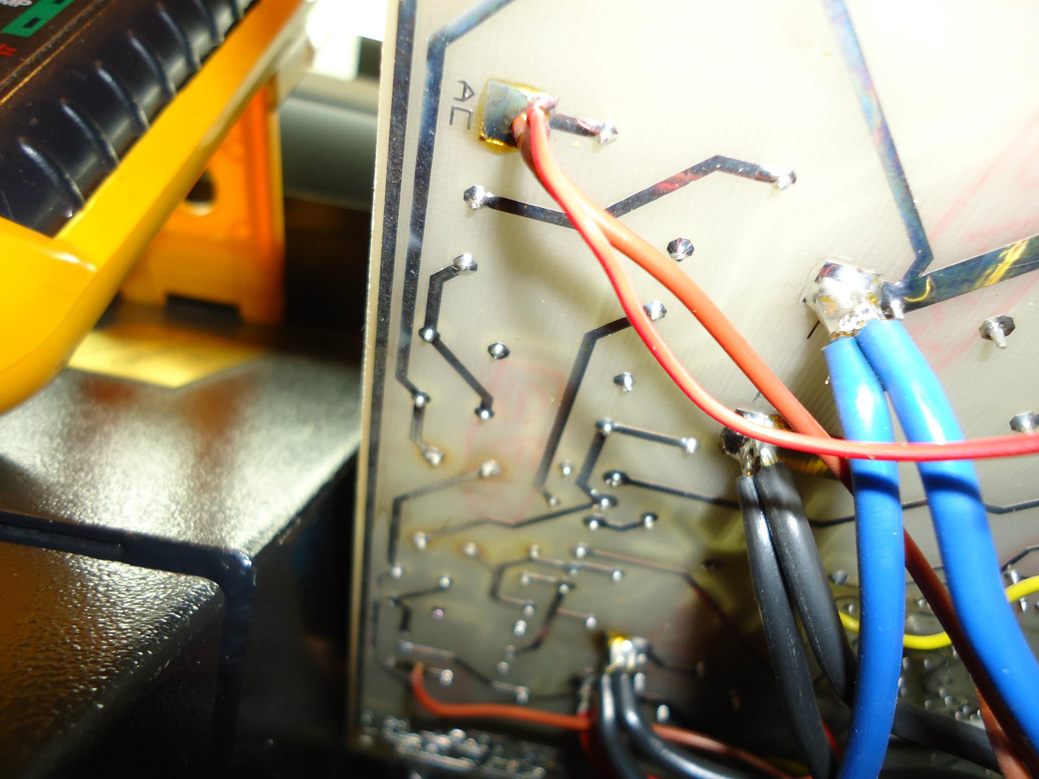

can you make board like this.
look what i found

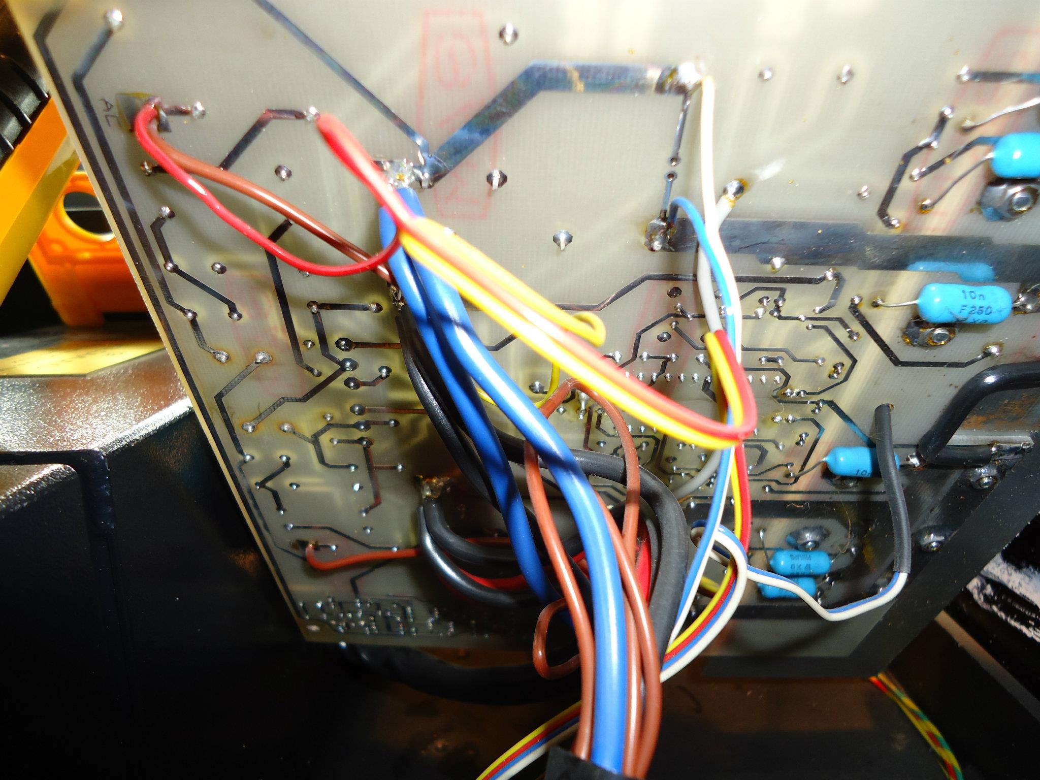

I love the symmetry of the Goldmund layout, and its single point ground. The board was of course designed for the op amp module. Maybe that circuitry could be placed in the board etch instead of using the module?
Hi Alex
look what i found

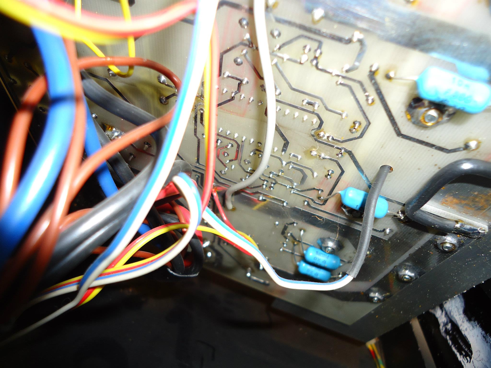

Do you have a photo of the other side of this board?
Hi Kris
I'm afraid not.
I'm afraid not.

.... yes I can 😀 , but I don't like the front end PSU , elcos in ac will heat up a.s.o. .
Of course you can . a little tease Mr Alexmm.
the board its from China.

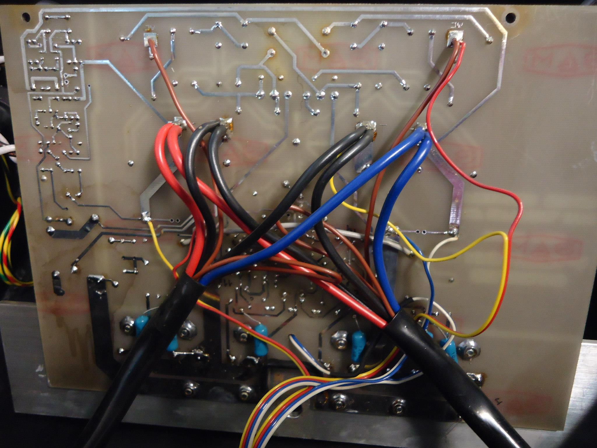

It is my schematic, I was modify from Goldmund schematic for low cost amplifier.

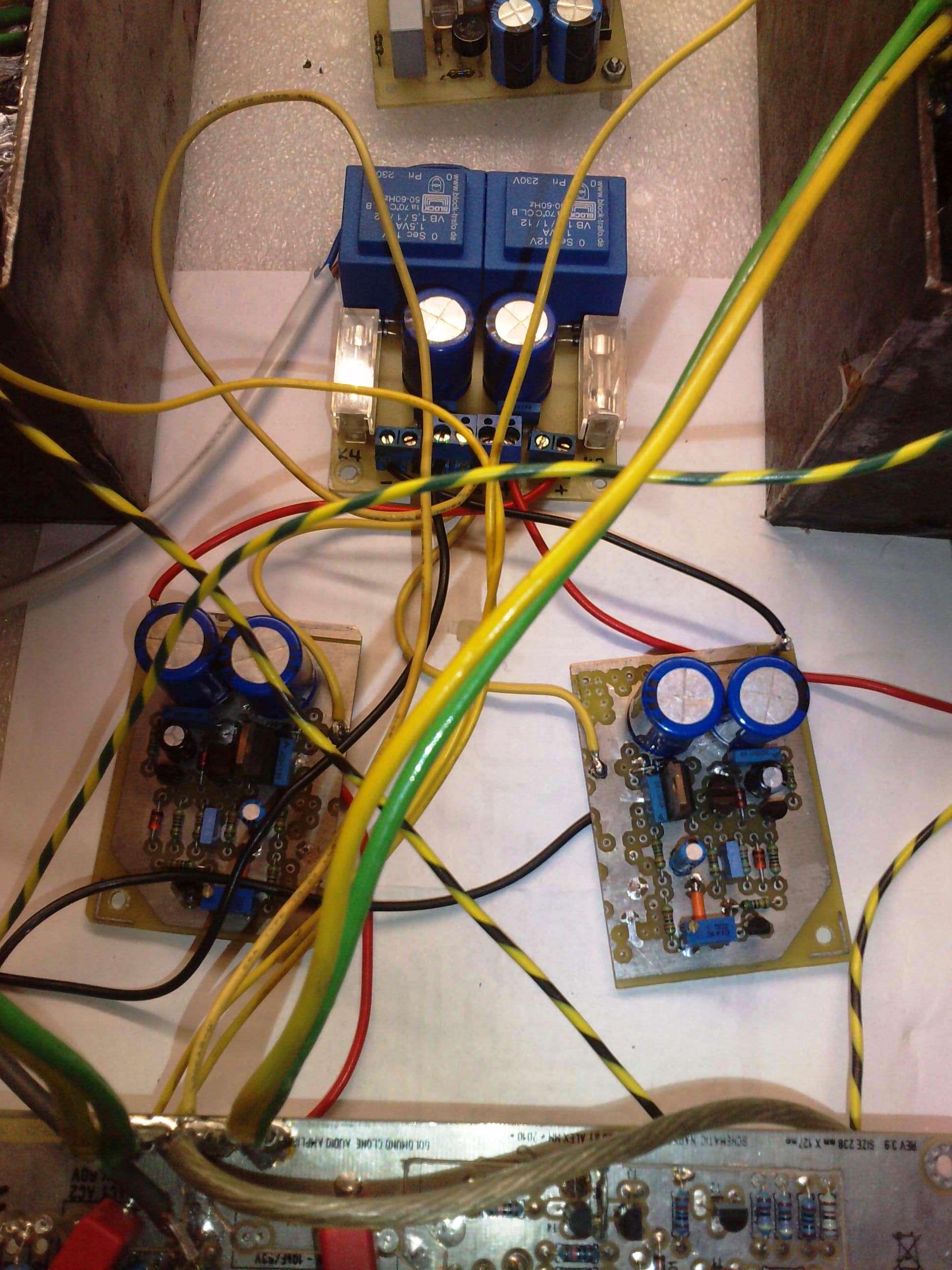

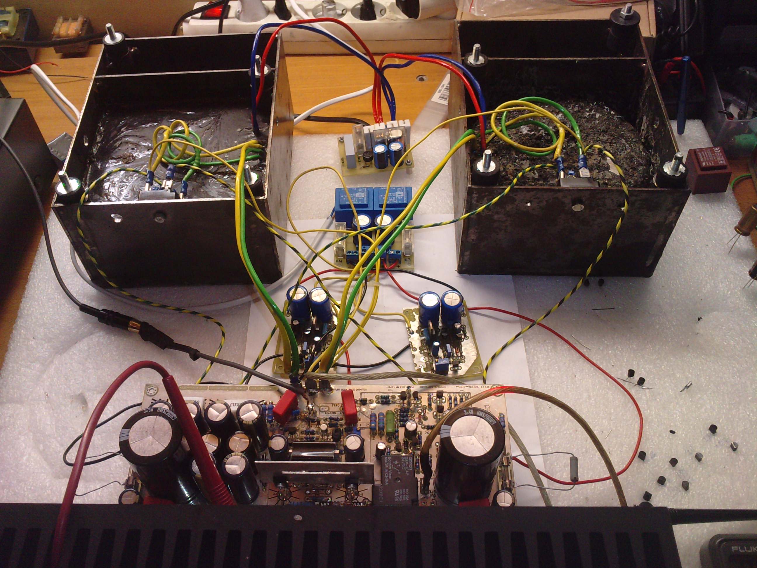

Goldmund 9.2
Oh!!! my God
Now really is the best amplifier I've heard but stable and that I have constructed. The difference now is placing a special power supply front end.
Very stable +-/ 84V with ripple 1 mV under load 0.031A
Ready to run all the time.
offset now +-/ 1-2 mv.NO SERVOOOOOOO!!!
100mA for each mosfet device
Nο flicker by temperature at all.
NO flicker because of main voltage 220V~
Unlike the previous power supply front end multiple capacitance fliker !! fliker !!
No noise at all with my ear on my speaker woofers.
On resistors R14 and R15 3025mV and 3025 mV stable under full load and no flicker.

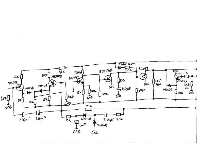

You mean that there are separate regulated PS for VAS at +- 84VDC ?
Regards
Yes very very very stable ..
