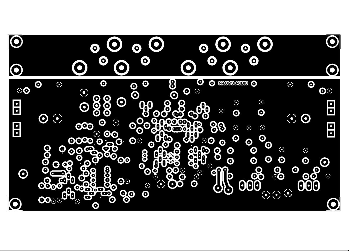

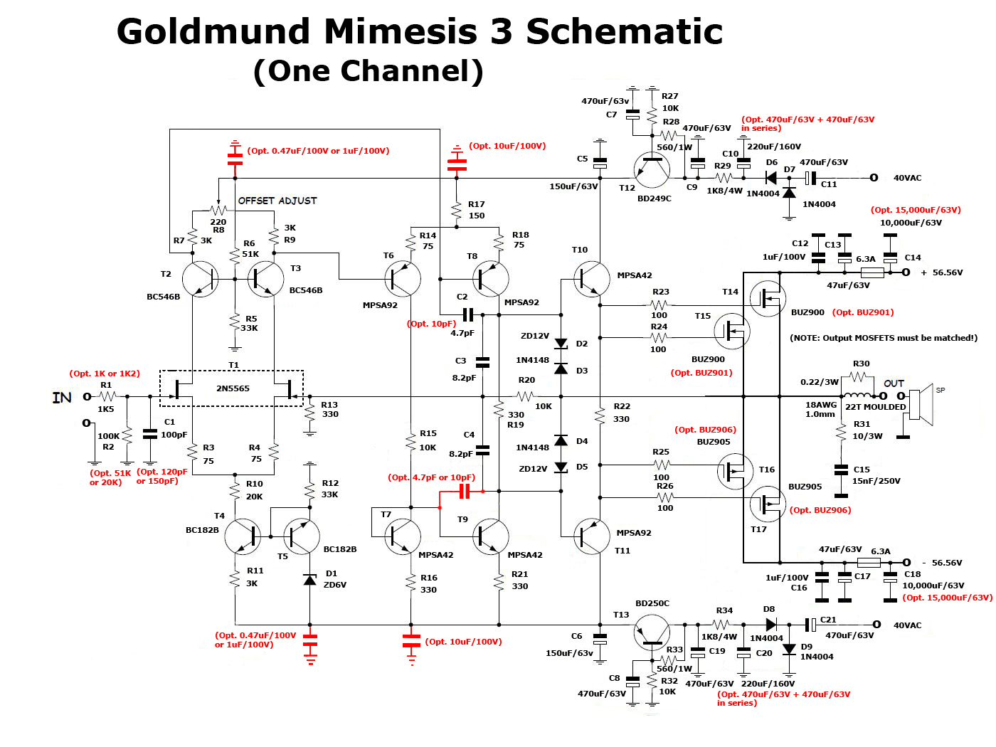

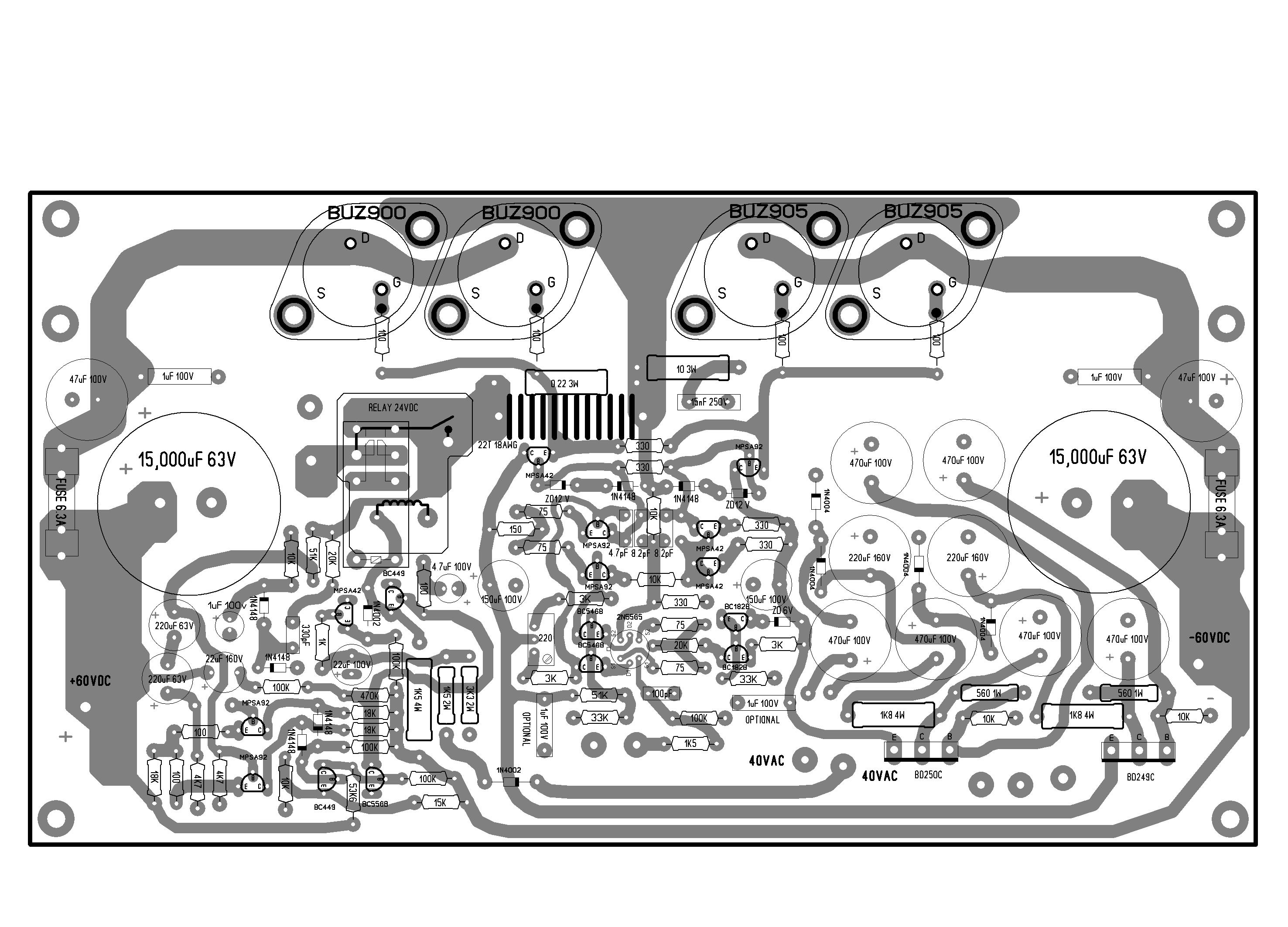

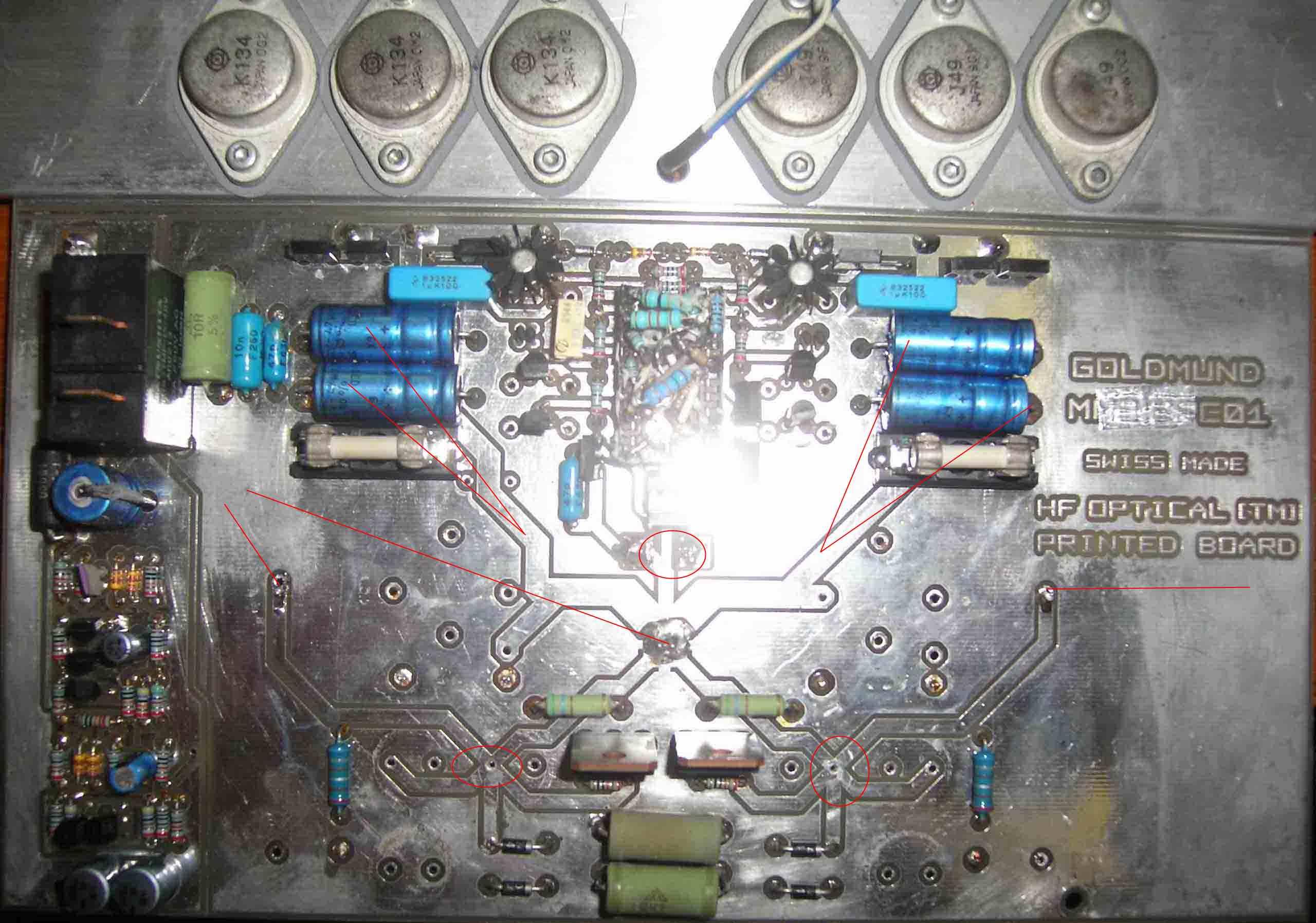

I AM LATE TO THIS PROJECT AND NEED TO KNOW PLEASE
Hello friends, about an year ago I bought 2 PCB of the Goldmund original project from NagysAudio. I received the original PCB's + schematics in time, with a bad draft drawing of the protection circuit. Nagys gave me some advice via email on how to get the parts and he was a kind person to me.
The PCB's seem to be OK but there is no silkscreen on it. The components layout came in a separate sheet. I bought 99.9% of the original parts from Digikey, Newark, Mouser, etc. I have the original Panasonic relay. My MOSFET's are BZ90X parts.
All this time I couldn't dedicate myself to the project that was kept in a box. Today I returned to the forum ( that I like so much ) to see if somebody could get this project up and running. Honestly, I am sad to know that there was a lot of trouble between some members and NagysAudio. I will keep my opinion about this particular because I didn't participate in the project in any way and also because I don't like to hurt anybody. I am simply sorry for the way the original intention ended.
Before writing a line, I tried to read as much as I could to understand where the project really ended. Please correct me if I'm wrong, so much time passed that I don't feel entitled to give opinions here, specially because I notice a lot of work from a group of members.
For some reason it seems to me that there is a new PCB version,
http://www.diyaudio.com/forums/solid-state/174468-very-best-amplifier-i-have-ever-heard-109.html #1087
After reading some posts #1297 ; #1317 ; #1325 ; #1349 ; #1444 ; #1449 ; #1453 ; #1458 ; #1462 ; #1467 ; #1484 ; #1504 ; #1530 ; #1534 ; #1566 ; #1575 ; #1577 ; #1630 ; # 1633 and # 1651 I can see that the original circuit has been modified, parts discussed, added trimpots for bias adjustments, fixed DC-problems, etc.
I don't want to bother at this point but before I attempt to build my actual PCB version I would like to kindly ask if there is a complete final circuit resuming all these changes made, specially concerning the protection circuit that is included in my board. I found this one
http://www.diyaudio.com/forums/attachments/solid-state/194573d1288582146-very-best-amplifier-i-have-ever-heard-goldmund-mimesis-9.2-schematic.pdf

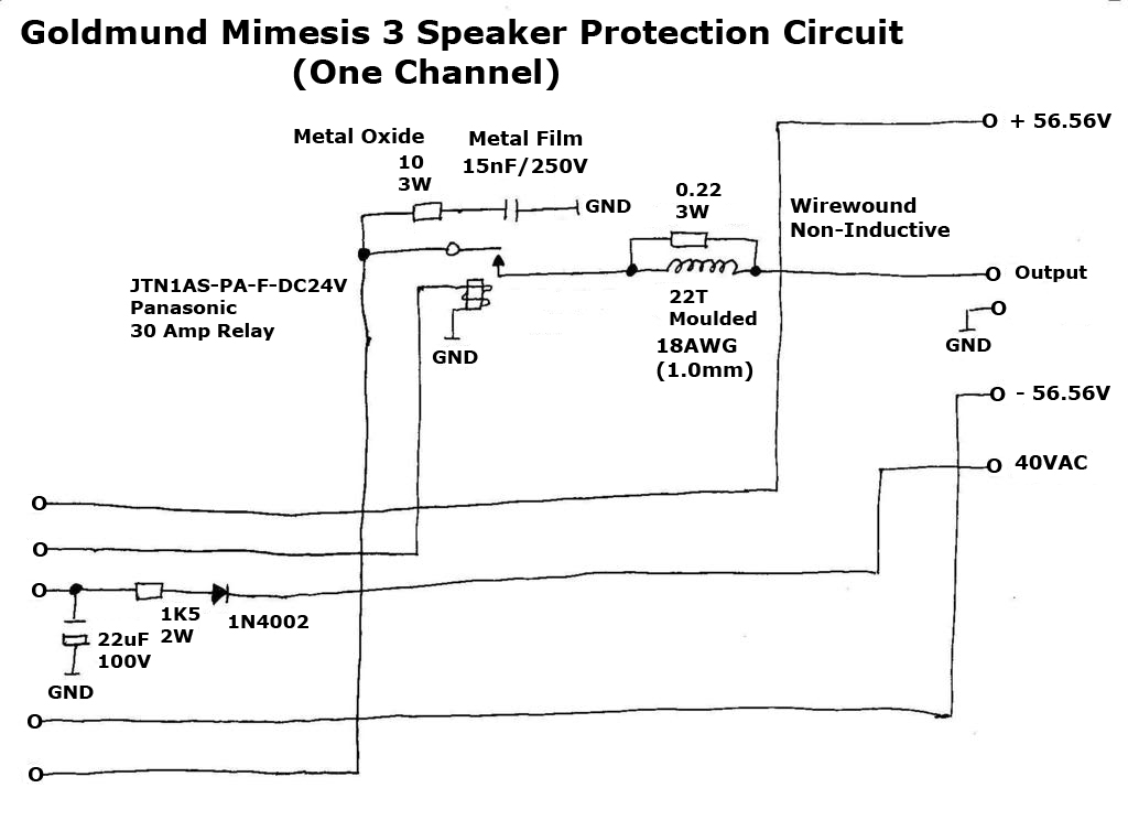

I can't see the protection circuit related to this amplifier and I can't tell if it has been modified. I don't really know if these original boards really work 🙂
Also , I have read most of the Liliya testing and results and I guess if this circuit reflects all the modifications done regarding parts and circuit.
Should I buy a new pair of corrected PCB's from bigpanda ? Or the originals may still work ?
I would very much appreciate I you could tell me what the best option is.
Thank you in advance.

Thank you nikosokey, these attached files are what I've got.
I would like to know if these are good and if they reflect the last changes.
Maybe these last changes are just about part numbers but I am in doubt because I've seen a different board with component silkscreen, etc.
http://www.diyaudio.com/forums/solid-state/174468-very-best-amplifier-i-have-ever-heard-104.html #1034
The power supply has different voltages, and the protection circuit is shown in a separate, hand draft schematic.
If the board is good, I will follow the steps about changes made, and if not please tell me if I can still get a pair of new upgraded PCB's.
Thank you.
Thank you.
Goldmund Mimesis 3 Final Protection Circuit Schematic 2.jpg164.8 KB · Views: 339
Goldmund Mimesis 3 Final Protection Circuit Schematic 1.jpg262 KB · Views: 864
YES, it has this ground plane too, but still I don't know if these boards are good or not or if they need upgrading.
Can someone tell me , please ?
Thank you nikoskey.
Thank you nikoskey.

Whatever you do, don't assume a simple relay will protect your speakers. There's much written about that around here. At the very lease, use a relay that switches the speaker from the amp output to ground - so you need at least a SPDT relay contact. Search for Rod Elliot's stuff on this topic on his website - note the comments on using a simple diode to protect from the relay motor back e.m.f. slowing down it's response and how he addressed that. A solid state relay (DIY versions on this forum) may be a better choice.
Thank you Bigun, but as you can see, I am in the process of detecting if the boards I have are good and if they need upgrades. So far I didn´t get an answer. The relay issue could be next, but first things first.
I have read many good articles from Rod Elliot from his website in the last years.
Thank you again.
Thank you again.

Thank you Liliya for your kind and precise reply.
I feel that many of the participants maybe a little tired about this project, so I can understand that they may also be a little reluctant to keep on giving information and support , specially for "late newcomers" as me. Special thanks for the received replies then.
In the other hand - and with all my respect for everybody here - (including those who argued and showed negative positions) I trusted the initiative from the first moment and tried to contribute with good vibes. I am sorry that my own activities forced me to be absent at the moment of assembly and testing, having tho keep almost 99.9% of the parts in a box.
As I said before, I will not issue any kind of "political" opinion about NagysAudio because I really feel that he acted on a "bonafide" basis and when I had private contact with him buying the boards, he behaved as a gentleman with me, despite that I could be critical about some aspects of the schematics presentation. It seems to me that the outstanding level of this forum and of its members has no relation with some conflicts I read of along the posts of the thread, some passages are (to my surprise) very discouraging and sad, everytime I think that this place should be a space for the best human knowledge sharing and contributing, an opportunity to relax and enjoy what we all love (electronics + best audio), and for me particularly, one of the best places to hear people like you, and learn from every thought and advice.
Perhaps this could be a good opportunity at this point to resume these apparently confusing inconsistencies.
Some of my doubts at this point are the following, regarding all the contributions and research done:
1. the power supply voltages in my original schematic is +/- 56.5 V and don't know if this is finally OK or requires changes.
2. the power transformer for one single channel should be Avel Lindberg 330 VA model # Y236753 (or equivalent rating) for 200 W output power over 3 Ohms load.
3. regarding the protection circuit (please see the hand made draft original files uploaded by me recently) I have no annotation for the parts, so I can't tell if the thread is referring to issues with components included in this particular section of the amplifier. I guess if this section works fine and if some changes apply here. A final neat schematic would be very much appreciated if exists. If somebody has a real up to date final schematic including the protection circuit, please let me know where to find it.
4. the moulded 22 turns output coil indicates winding over a .22 Ohm 3W wirewound resistor. I have read that 22 Ohms could be better to avoid the resistor to short the coil inductance.
5. my version of the amplifier complete schematic does not include the alteration needed for the insertion of the protection circuit that apparently my version of the PCB includes and works fine (?)
6. there is an offset adjust through R8 220 Ohms trimpot, but I heard in your post about the convenience of adding a quiescent current adjustment trimpot that I don't know if applies to my circuit version.
7. my schematic indicates (and I have purchased effectively from Newark) BUZ900 / BUZ905 MOSFET's. Some members talked about the absence of source equalizing resistors, so the matching of the MOSFET's becomes mandatory. Being myself in Argentina, I can't buy 100 MOSFET's to get 4 matched units. How can I match these MOSFET's ?
8. about "Nikosokeys recommendations to separate ground plane" I don't know if I have the skills to make these many cuts that are not very clear to me watching the pictures. Should this point justifies to buy the bigpanda boards ?
9. are these bigpanda boards available ? do they reflect the many changes ? Am I in time to change PCB's before making all this surgery on my version of PCB's ? I have the original Panasonic relay.
10. which is the difference between Goldmund 3 and Goldmund 9 ? bigpanda's boards are 6 output devices, is this a Goldmund 9 ?
These are the main doubts I have about the project, and specially I couldn't find many opinions about the finished results except for yours. As I said, this could be an opportunity to write a resume about the changes done to the original schematic and PCB's
Could you help me write it so other members in my situation can also build and enjoy this amplifier ?
Thank you very much for your and other members appreciated efforts.
