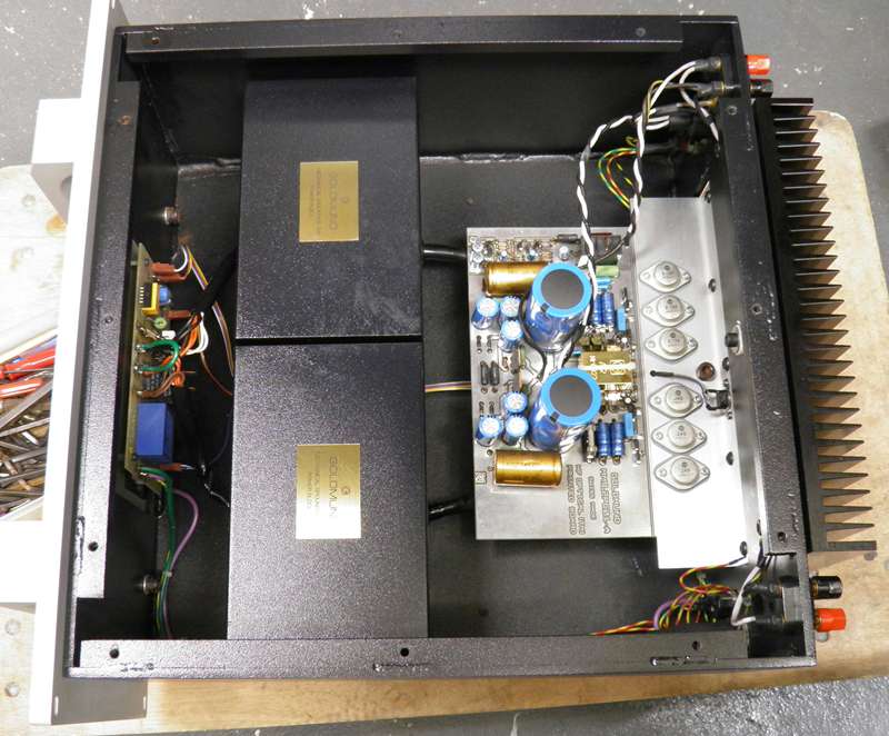

According to the MM9.2 specification the amplifier have two transformer blocks that weighs 15 kg each / channel. I think they are using some large toroidal transformers or perhaps the specification is wrong ? One 2 kVA transformer weighs around 12 kg.
The total weight of one MM9.2 mono block is 65 kg.
Hope this helps

Looks to me as it is conventional transformers.
But I have no trouble believing in a total transformer-power in excess of 2KVA.

Tommy,
take another good look at the picture you posted.
The case of the Memisis is made up of steel plates, welded together (and not pretty).
Same goes for the 4 edges the top cover screws onto, welded at three locations to the case sides.
Welding steel plates, without significant warping, requires a minimum thickness, 2-3mm takes a full manicure to straighten the case out again.
Afair, base case sizes of the 9/9.2 are 48x48x25cm.
Specific weight of steel is 7.9 (metric)
A case in 4mm would go for ~30kg, 37.5kg for 5mm wall thickness.
The heatsink is a Fischer SK56, 300mm wide, 30 rib, 10mm base.
In the size used for the 9/9.2, it weighs in at about 3kg.
In the picture you posted, compare the heatsink base thickness with the one of the case, looks more like 5mm for the case.
Makes +40kg for the case+heatsink.
The anodised aluminum front plate does about 15mm, with the massive front handles added, think 10kg more.
Makes a half-time score of 50kg.
The covers for the transformers in the Memisis are also made of steel.
And as told way back in this thread, filled with resin.
Add to that some bolts and nipples, spares and change, and you're looking at less than 10kg for the transformers.
2KVA ? I don't think so. :clown:
(2 times 625VA toroidals do 10kg)

The heatsink should be at 50-55C Max, for safety.
From 25C ambient to 55C heatsink is a delta-C of 30.
From 55C heatsink to 85C die temperature is again 30C difference.
Another reason is economics, a 50/50 ratio for output devices and heatsink is more than often the cheapest solution.
So the class AB boys did/do the same.
(serious ones, not counting off-the-shelf consumer grade)
The SK56 heatsink of the Goldmund does about 0.30C/W for 200mm high in the book (from memory *)
Times 6 devices makes 1.8C/W
(The heatsink of the Memisis is attached to the case, with plastic stand-offs. So the largest part of the heatsink is actually not touching the case, but hanging in Free Air. Though the L-profile for the Mosfets is closing up the bottom opening completely, the way the heatsink is positioned might even save some extra thermal points, btw)
Theoretically lowest Rjs for a J50/K135 is 1.6C/W with the 0.30C/W TO3 mica insulator, in practice higher than that.
Rjs for the 125W devices should also be taken closer to 1.5C/W (instead of 1.3)
For class AB, Max dissipation is at 125C die temperature rise from 25C.
50% is 62.5C
62.5 divided by 1.5 makes 41.67W for each Mosfet. (60/1.5 +2.5/1.5 *)
Times 6 devices makes 250W max dissipation. (375/1.5 *)
Take rail voltage at 80Vdc, plus 10% for peaks, makes 88Vdc.
Suppose max dissipation occurs at an output voltage of 1/2 x Vrail.
Makes the Vds droop : 44V
Power loss : V squared divided by load impedance.
(44 x 44) /8 = 242W [(22x22)/2 *]
Implies that the Memisis is thermally optimised for an 8 Ohm load !
242W x 0.30C/W for the heatsink makes a delta-C of 72.6C
72.6C + 62.5C = 135.1C + 25C ambient makes 170.1C (minus a few points for 242W instead of 250, [8Wx1.5]/6=2C)
Max die temperature is 150C. (Goldmund just likes living on the edge, counts in rail droop)
The thumb rule of taking transformer VA 3 times the power in 8 Ohm is fine.
Second rule is Not taking VA substiantially higher than total Pd of the output devices.
Take max continuous efficiency of a transformer at 70%
For a 1000VA that implies a max continuous transformer output of 700W.
Tada : the output stage of the Memisis handles 750W max. (6 x 125W *)
(* check aids for me, i'm old school, head count saves pressing calculator buttons)
I had it in my mind this was a 350W amp. But I was terrible wrong.
Hmmm... Before I made a clone of the Mimesis, I knew all the currents and voltage in every nodes of the original schematic. I'm familiar with THD versus frequency, stability, distortion spectrum etc etc. I studied all the pdf of the parts used. Everything, not just the total power of the amp ;)
The amp has been made with attention to details. So detailed that many objectivists wont "understand". You can say that the amp is in the vicinity of stability, to get the "required/selected" performance.
If you don't know what makes this amp so good, how can you upgrade it? What you will do is to design different amplifier of the same topology. And the chance seems very small as it is about the best of this topology imo.
Your favorite amp, the Tandberg. May be you think that it is good because of the power supply and the mosfet so you tried to bring those to the new topology of the Mimesis. But I guess the Tandberg is a current feedback amp. May be a symmetrical one (Sorry I don't search for more info because I don't own the mosfets used in the amp). So check out the SSA/TSSA/VSSA threads. It's my last resort for amplifier topology.
I think we can learn from building chip amps, that any small changes can change the performance of a system GREATLY. Changing voltage gain from 32dB to 35dB. Changing feedback resistor from Allen Bradley to Holco. Changing capacitor size and brand (ESR). Changing inductance/resistance between 2 capacitors in a CLC/CRC. Etc.
Nobody want to think about that when designing a discrete high power amp. But we can make a "rule of thumb" of what has the likelihood to make a good sound. Choice of supply caps brand has something to do with ESR. And smaller caps are "usually" sound better. If you have the time you can try listening to multiple 4700uF (as used by GM) and compare it to a multiple of 15000uF (same total capacitance). If you don't have time, then the rule of thumb is that multiple 4700uF may give better performance.
The GM even go further with the "crazy" mechanical grounding scheme, and extreme PCB trace design.
Seems as if we use the same calculator Vermeulen.
But believe me, my heatsink has a far better C/V.
I should guess the area is close to three times of the heatsink I have seen on pictures of the mimesis. On each side of the cabinet I have in mind, the heatsinks have a full area wich meassures 225X500mm. The base of the heatsink is approx 10mm in addition the fins are full 50mm long. With approx 30 fins each having a area of 225 cm² wich in turn ends up as near 7000 cm², that part of the cooling should be good.
In addition there will be forced cooling of the interior. wich adds up another area of 1100cm².
All in all around 6 kilogammes of aluminum on each side of the amp.
And unlike the mimesis: With forced cooling on demand.
Well, I think the cooling is well taken care of.
But do You see an inconsistent in what You are writing?
In a post earlier here You tell me that Goldmund on purpose construct the PSU to "kneal down" when high loads are present. In Your example over here You add another 10% to the rail voltage when calculating the power loss.
Wich one should I give attention to?
And another issue is this: When playing music over this amp, I will never experience the loads and losses described in your example. Actually I probably never will be producing an average power of 35-40Watt. Tops.
When looking at the losses in the transistors then I find a worst case scenario ending up with around 170W loss in the output transistors (40W in 8 Ohms equals 2,4A and 17V, resulting in 71V over the output transistors, giving around 170W)
Again to be cooled passively over near 7000cm² + 1000cm² with forced air.
Not counting in the airflow directly over the transistors bodies ang internal flanges.
As for the transformer size, we agree more than you seems to see.
The only reason for me to use two 625VA transformers for each channel, is because the price I pay for my transformers are only €57.- a piece. total €228,-
I have trouble finding two 1000VA transformer for this price.
The closest to 1000VA I have found was a 800VA transformer at ELFA at €245 alone. And that one was for industrial lighting (airport runway lighting)
Farnell have 1000VA toroids for around € 286.-
Still when I made the wrong calculations at the start, I save more than half the pice for my transformers. I apretiate such savings, and then have some more to spend on other things in the amp to do it as good as probably possible.
Included an upgrade from 3 pairs per channel to 6 pairs per channnel.
I am about to check my papers to determine the real C/W and real area of the heatsinks I am about to use. I guess I have even more to go on.
I feel you choose a rather inefficient transformer in your example.
The ones I use has internal losses (copper + Iron) at about 12 Watts.
Including regulation the efficiency is at 91%. Should give me around 1149VA for each channel. Well within all written and unwritten recomandations for a amp like this. well, maybe a bit in the upper end, but this only influences to a power reserve wich will lie there just in case I should need it.
And 12X125= 1500. Now the transformers got a tiny bit too little.
No worry, I like to have the output transistors having some headroom.
They simply live a little longer then.
