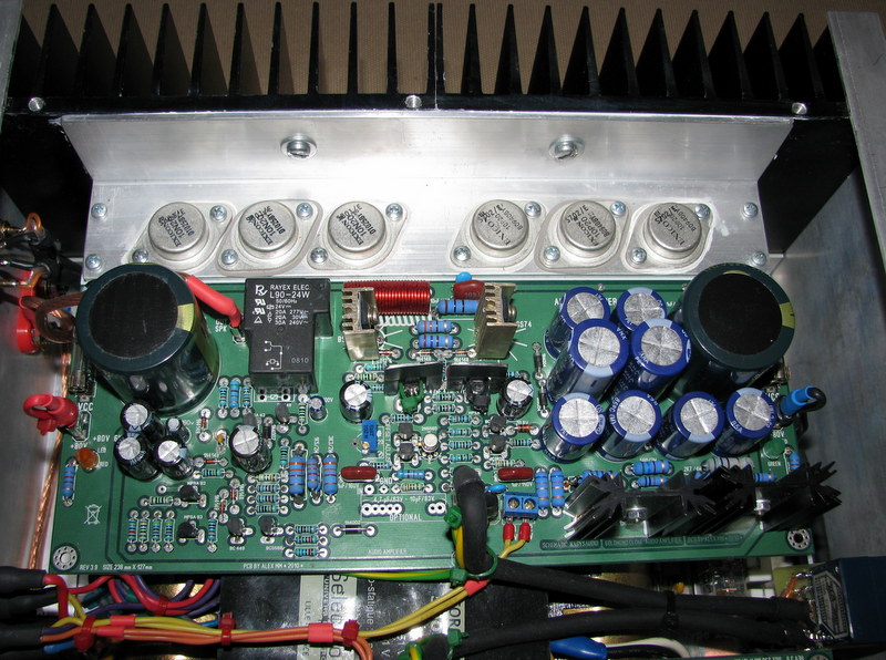

Building is on and now I just wait for some more parts to arrive.
I wonder, did anyone replace the 10K reesistors in the 82V-supply with zenerdiodes as indicated in one of the many schematics posted here?
Anyhow, a capacitorbank of 80 470uF will support the four 10000uF on the boards.
Two 625VA transformers on the way from Farnell. ending up like two monoblocks this one. Output transistors will be two three-pairs "stolen" from my TANDBERG-sparepart-storage. As mounting bracket for the heatsink there will be a custom made T-profile.
originally a 40X40mm, reduced to 40X30mm to fit the PCB.
Will fit perfectly since the 80 capasitors then will have perfectly space under the amplifier boards. Maximnum heat-transfer to the two sets of 385mm by 150mm heatsinks on each side. Transformers mounted near the front of the amp. Vertically on a steel bracket shielding them from the electronics.
I will post pictures as soon as there is anything to take pictures of.

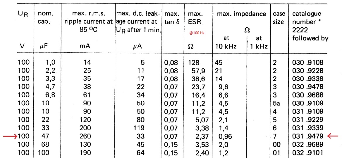

I would not just slap films and large lytics onto the board else you risk oscillation. The 47uF decoupling lytics are important. I believe they provide damping for the rails. If a low-ESR lytic were used here it may cause instability. I would be interested to see the datasheet and ESR spec of the cap on the original Goldmund.
Here are the specifications on the Philips 47uF/100V capacitors used in the original MM9.2. They are of a long life type for industrial applications. Not a low ESR type.
Thanks. That is like I thought.
In addition to a good ESR value, the damping cap needs to have a non-inductive path from the FET drains to output snubber ground. This may be difficult without a ground plane.
It seems whoever designed this amp either knew what they were doing, or made a very lucky guess. It would seem in some ways reliability was sacrificed for sonics, for instance with offset stability, and IIRC the drivers ran a bit hot?
Also, there is no need to turn around the protection zeners in the original schematic. They will still work this way. It seems they were oriented this way to reverse bias the 1N4148 to reduce the total capacitance of the limiter, and this makes sense for preserving the input impedance of the driver stage. I'm not sure whether the difference is really significant but it still functions as a protector AFAIK.

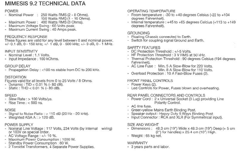

At high output levels the VAS transistors runs at around 600 mW. The original MM9.2 design uses one clip-on heatsink for each VAS transistor, but the heatsinks are small. The driver transistors does not have this problem.

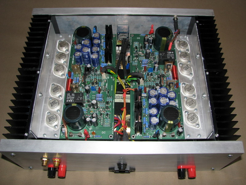

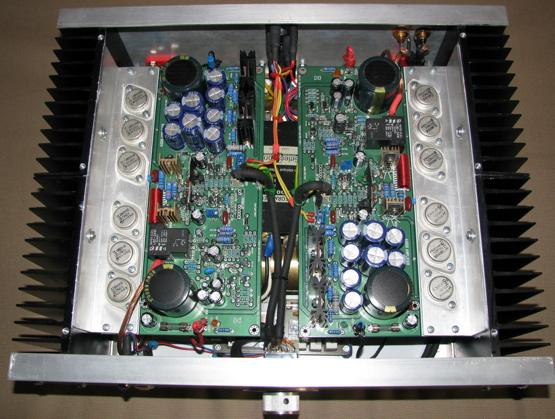

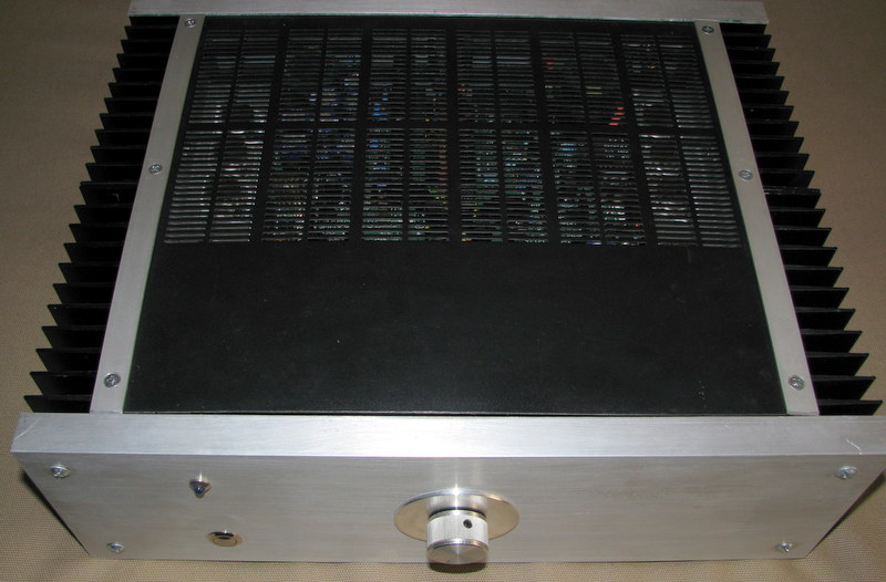

Hi tommy1000!
I also just completed amplifier similar to this amplifier, invite you to view images!
http://www.diyaudio.com/forums/solid-state/215127-637-amplifiers-10.html#post3322982

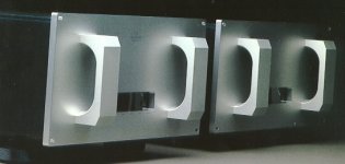

Buying cabinet from Italy.
Without those handles, I think.
But they deliver every part of theese cabinets as spare parts.
Almost identical
The Cabinet is almost identical 😉
I also see it nessesary to add heatsinks for the VAS.
Theese will be made of some 1mm Coppersheet where I will make a transistor/copper sandwich of it all. Could ofcourse make some clips, and put on individually, bud the sandwich is so much easier to make.
My goodness what trouble one gets in.
Can anyone tell me where to get the 220uF 250V capaqcitors, with the quite narrow 16mm diameter there is left space for on the PCB?
Or better: What voltage do You guys have over theese capacitors?
I am building with 2X55VAC for supply, wich I have calculated to a voltage just over 155V over those. Can anyone confirm?
