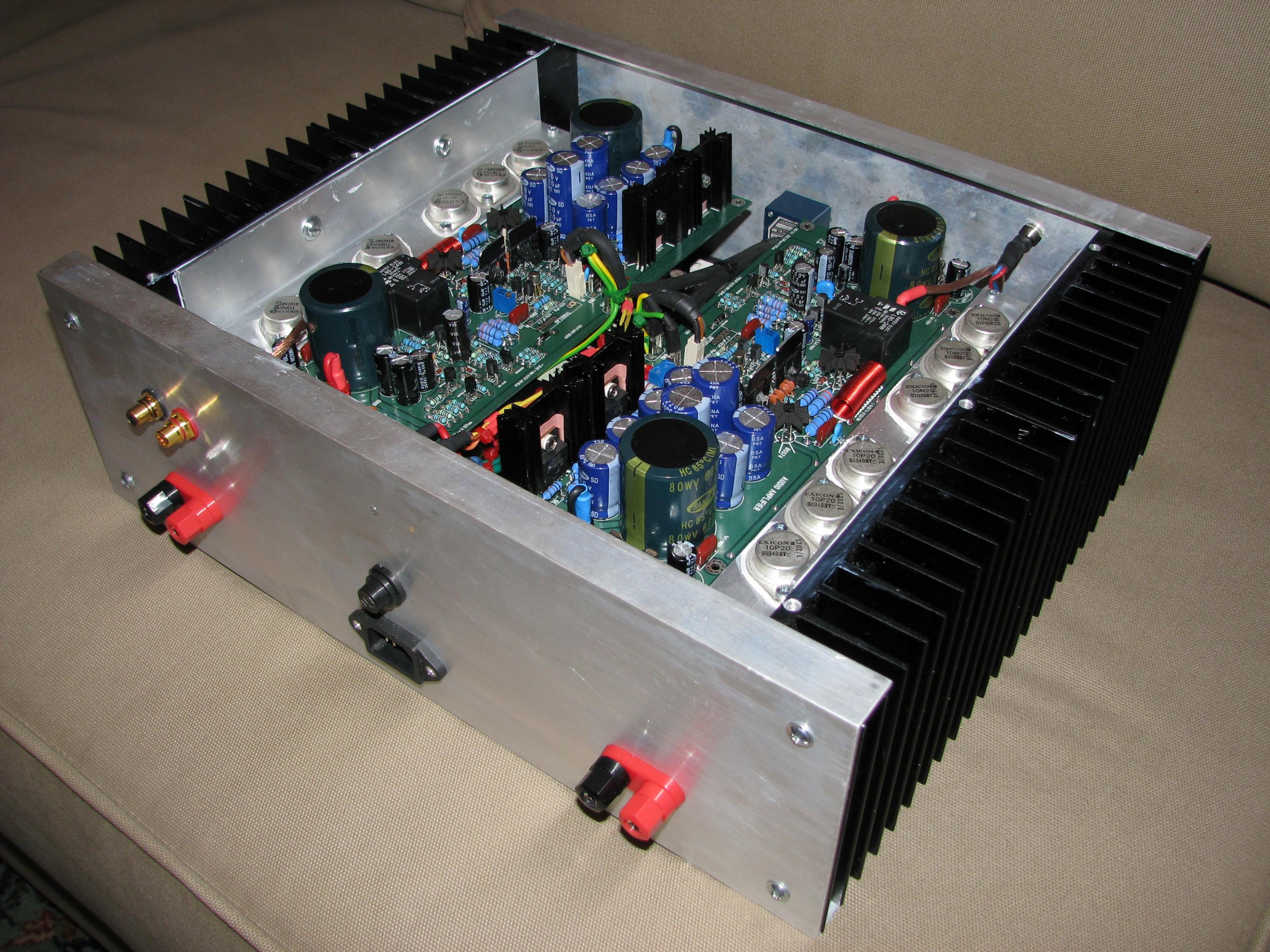

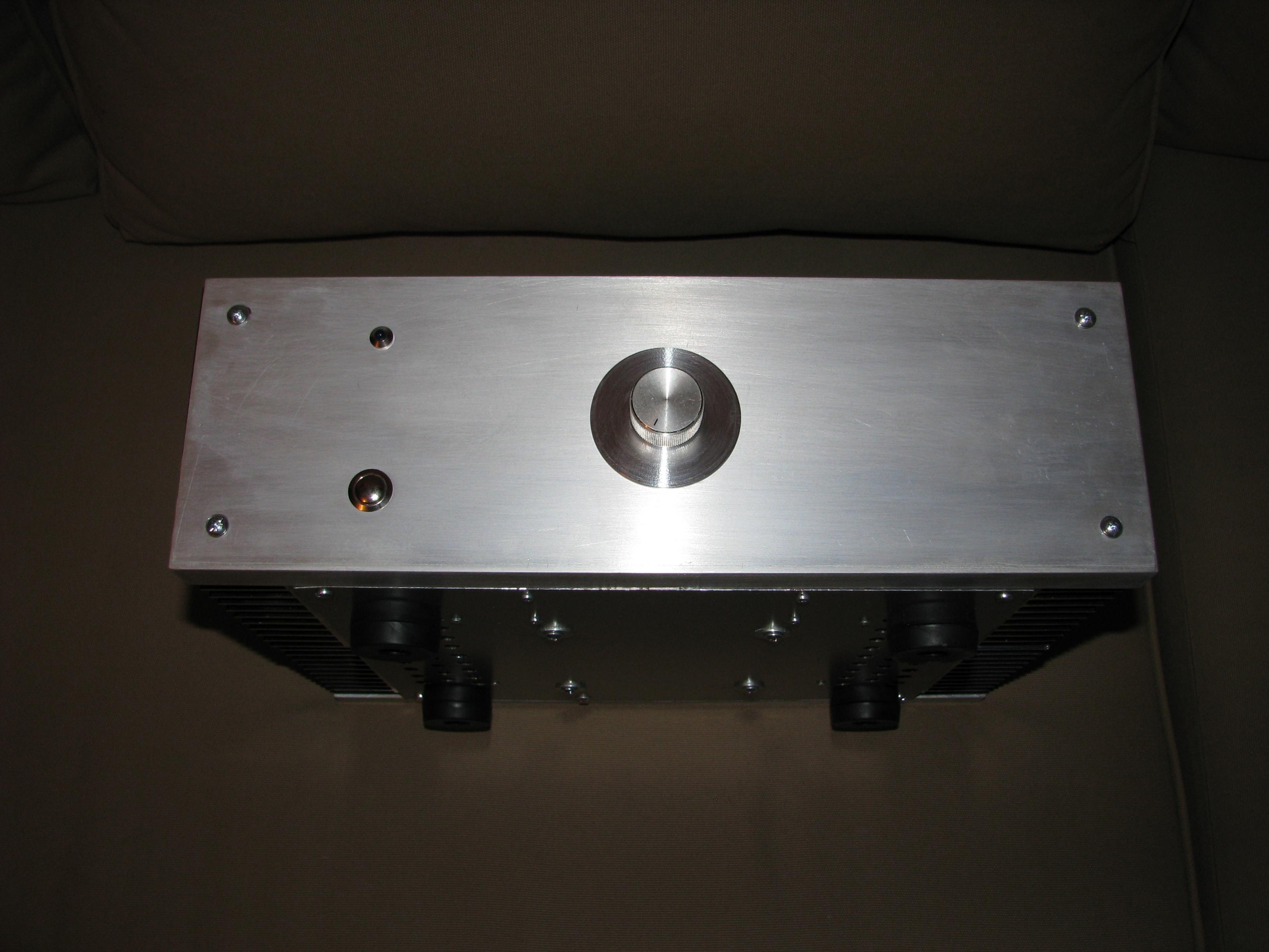

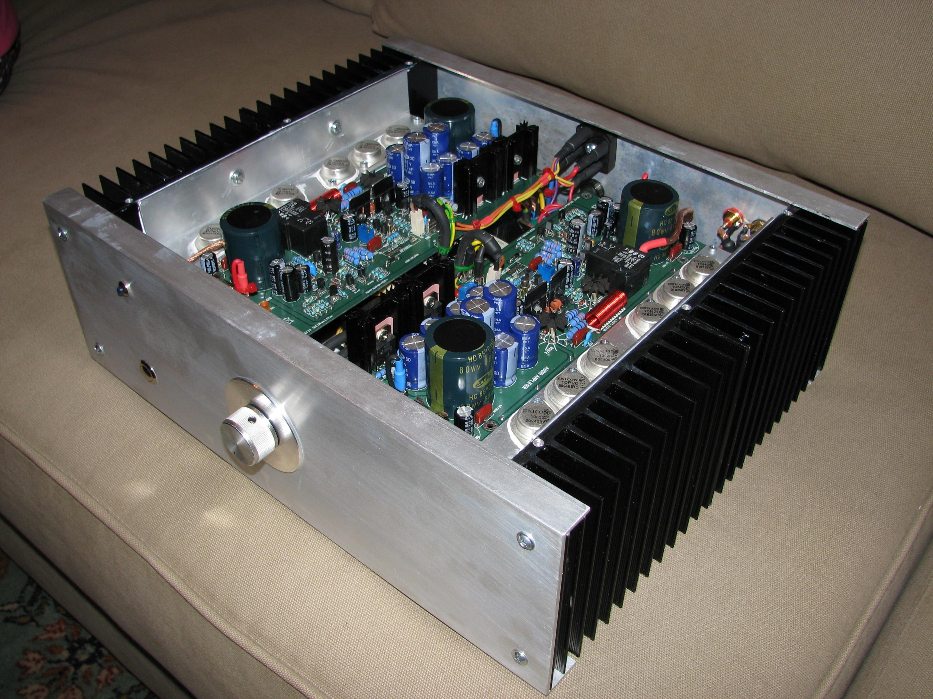

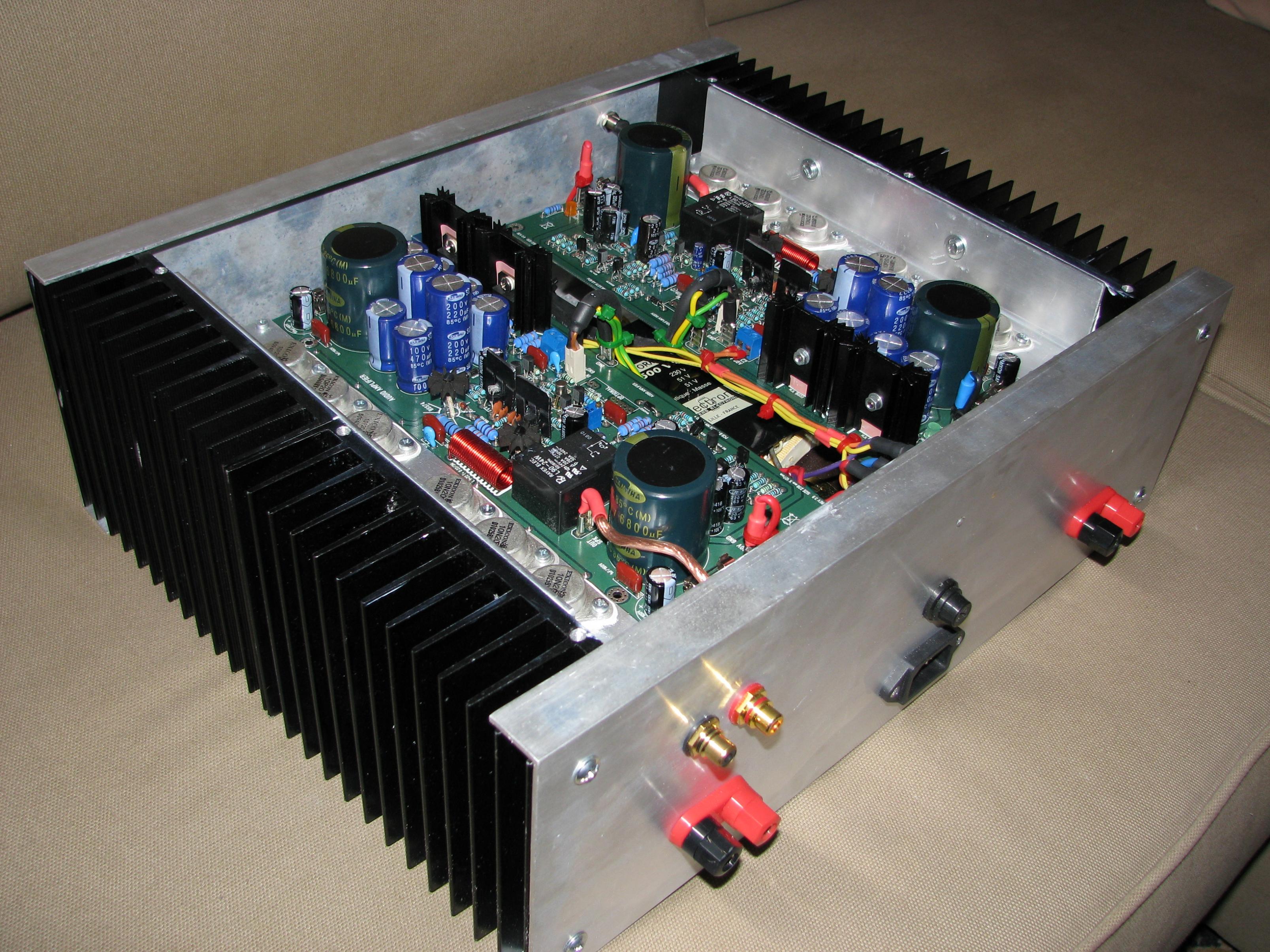

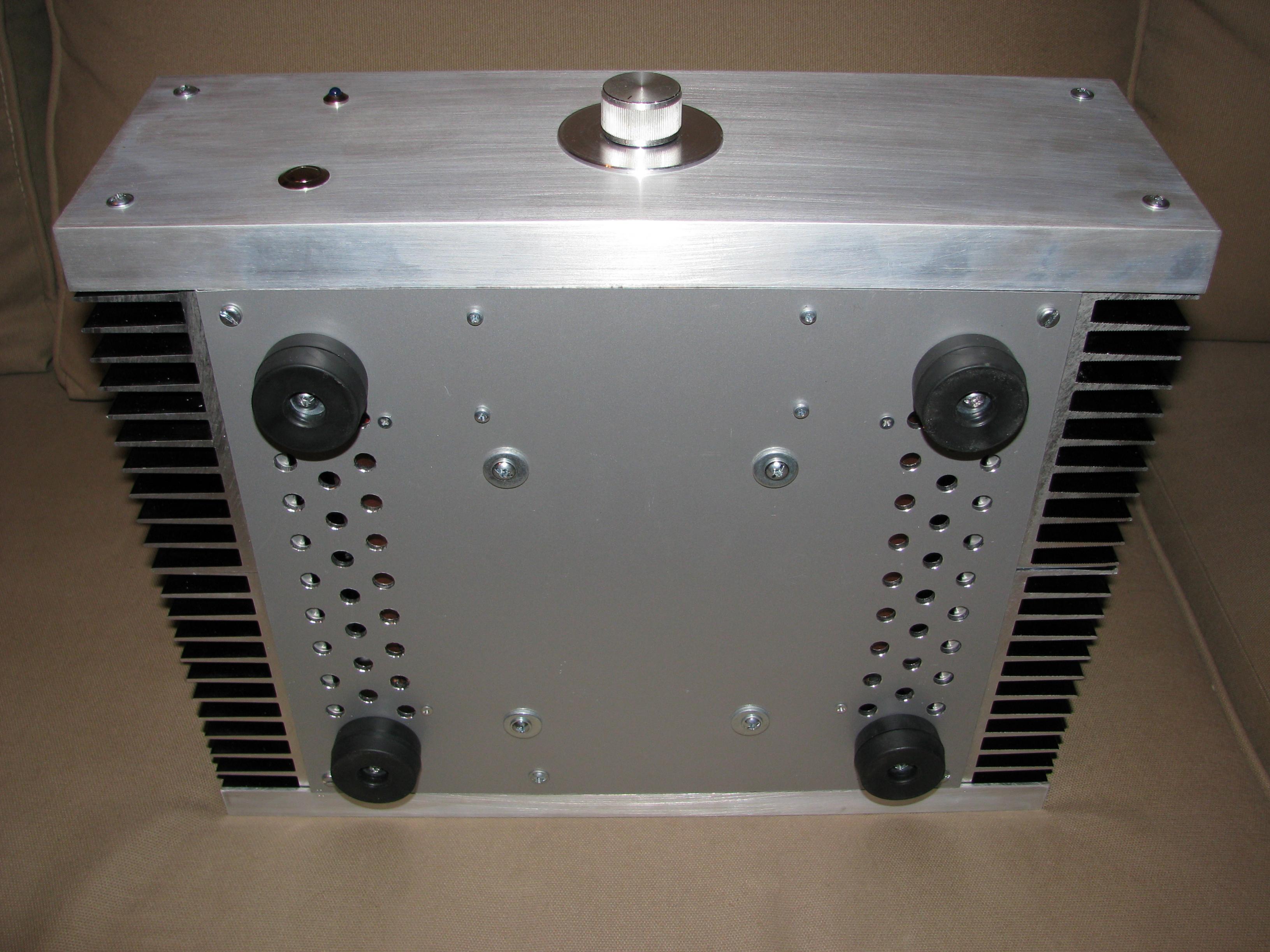

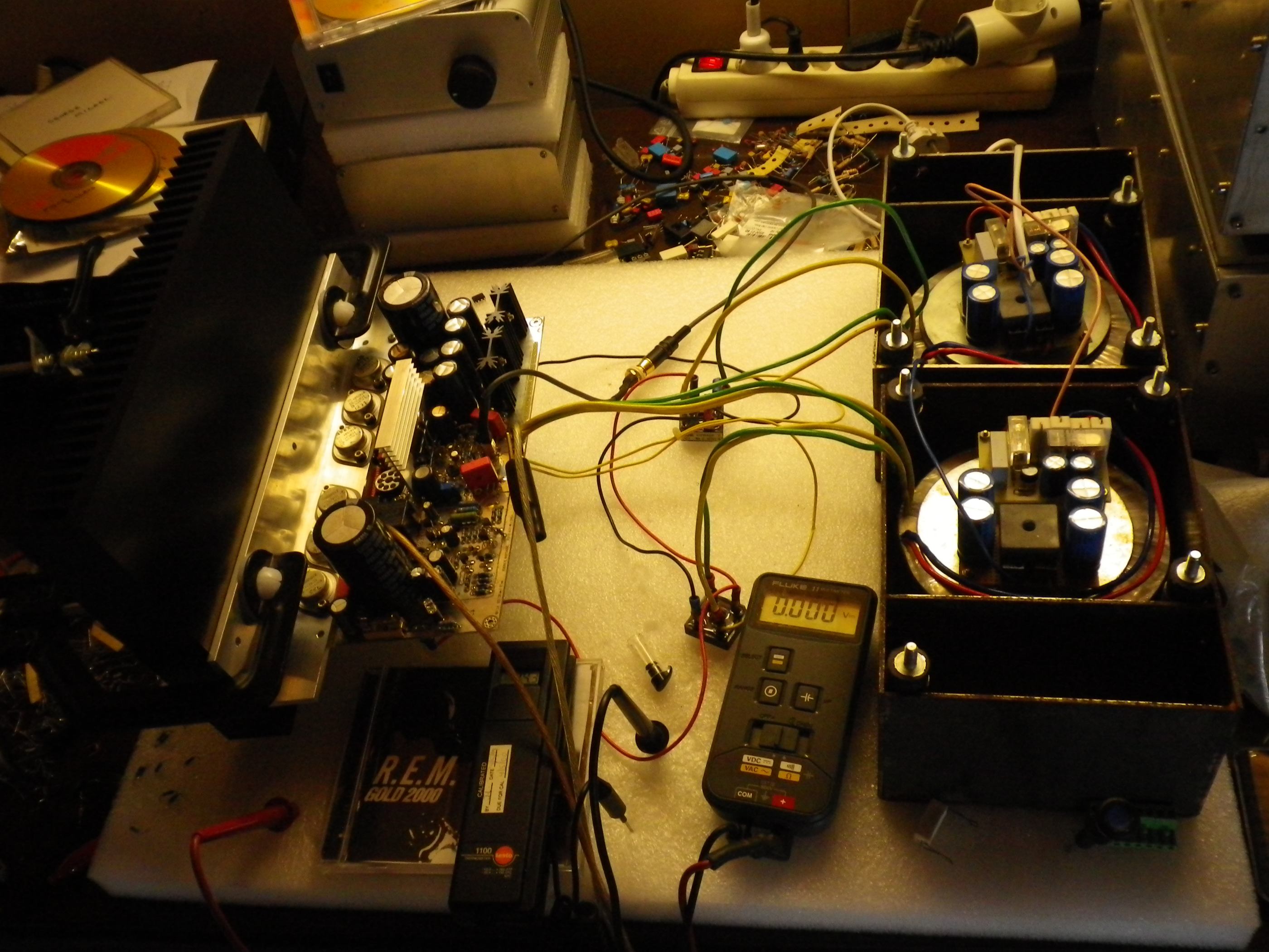

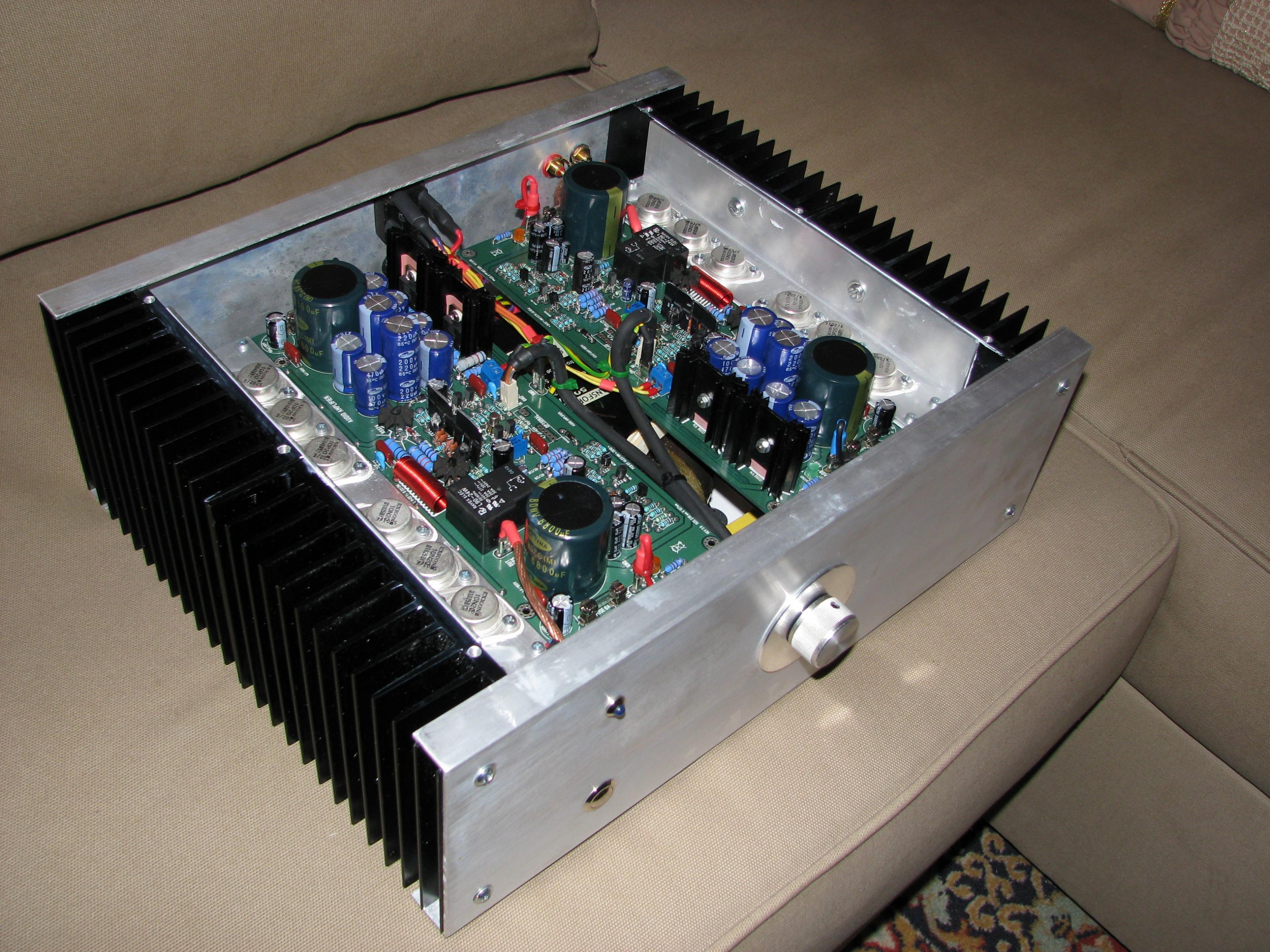

Hi Luke ,
I have, for free two PCB's from a friend ,and 6 laterals N and P (I bought 10 pairs of EXICON's)left from my last project , so I have built the second amplifier with better parts . I like the sound , warm close to tube amplifier . I have also built 2 Grommes A260 modified PP amplifier with russian 6P3C and GU 50 tubes . Ultimately the sound depends on the speakers ;)
@nikosokey
thanks for your comments , I will mount a bigger heatsink on VAS transistors.
Yes, you right , they are hot ......
regards Alex.

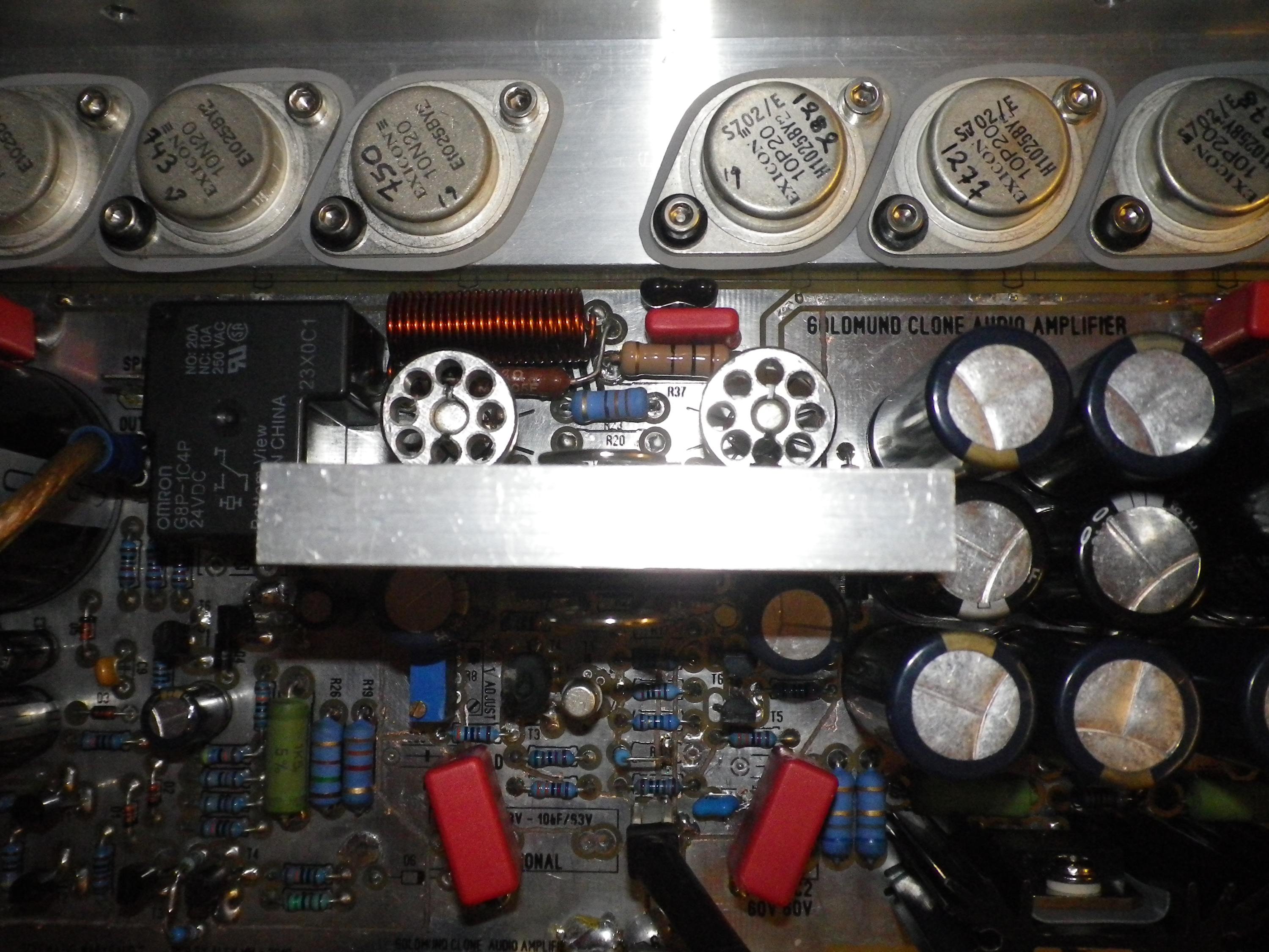

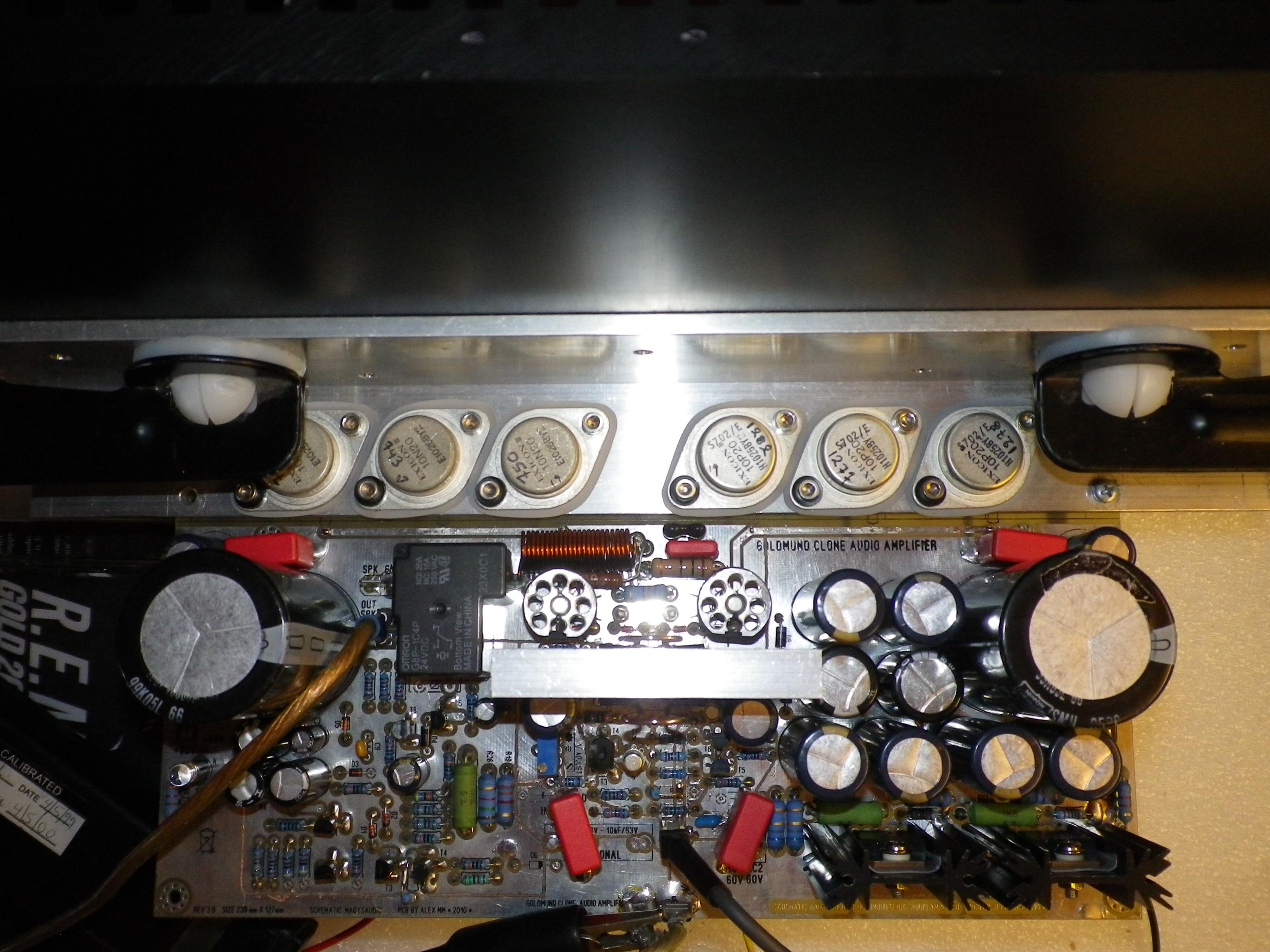

Golmund clone

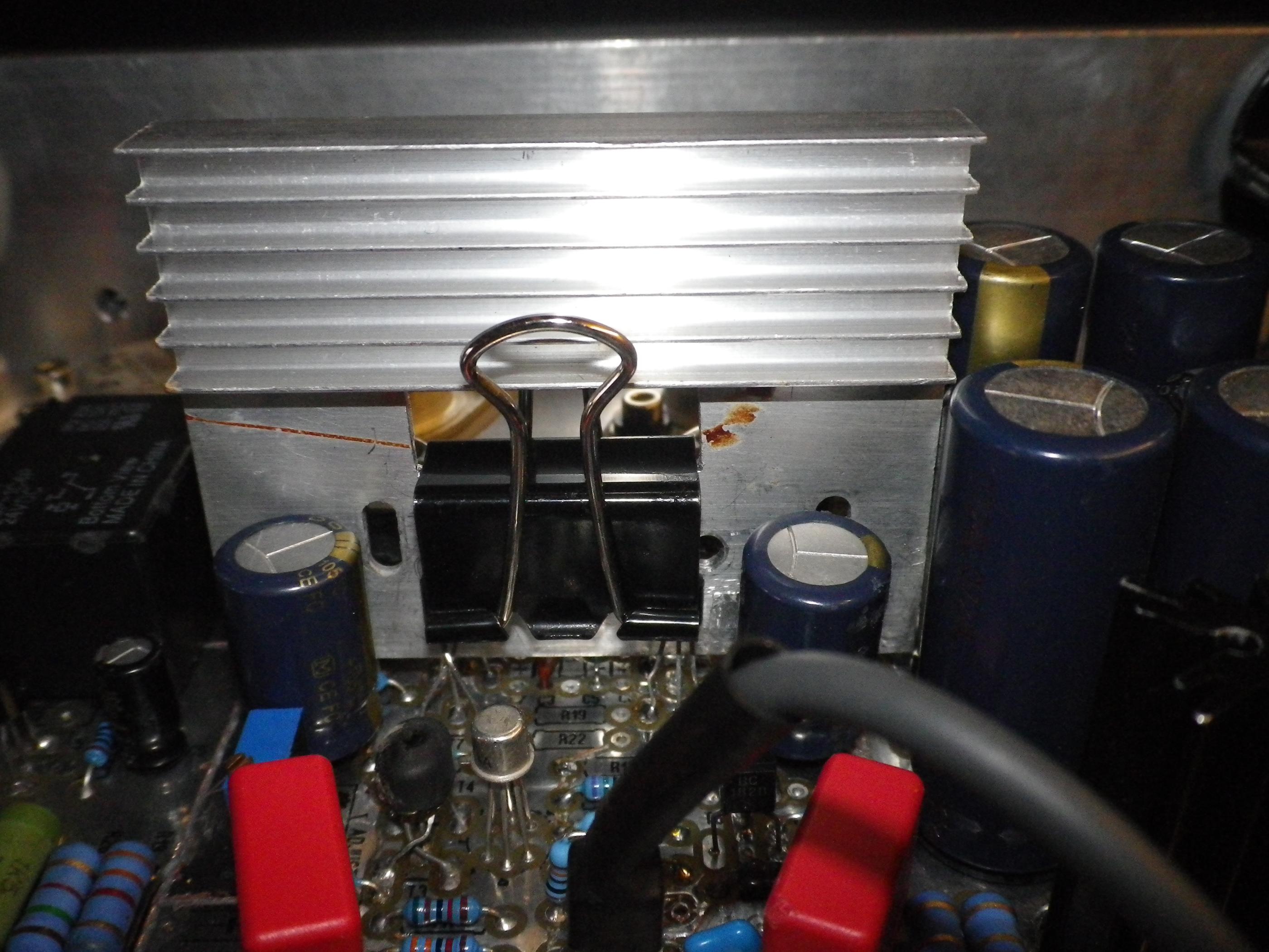

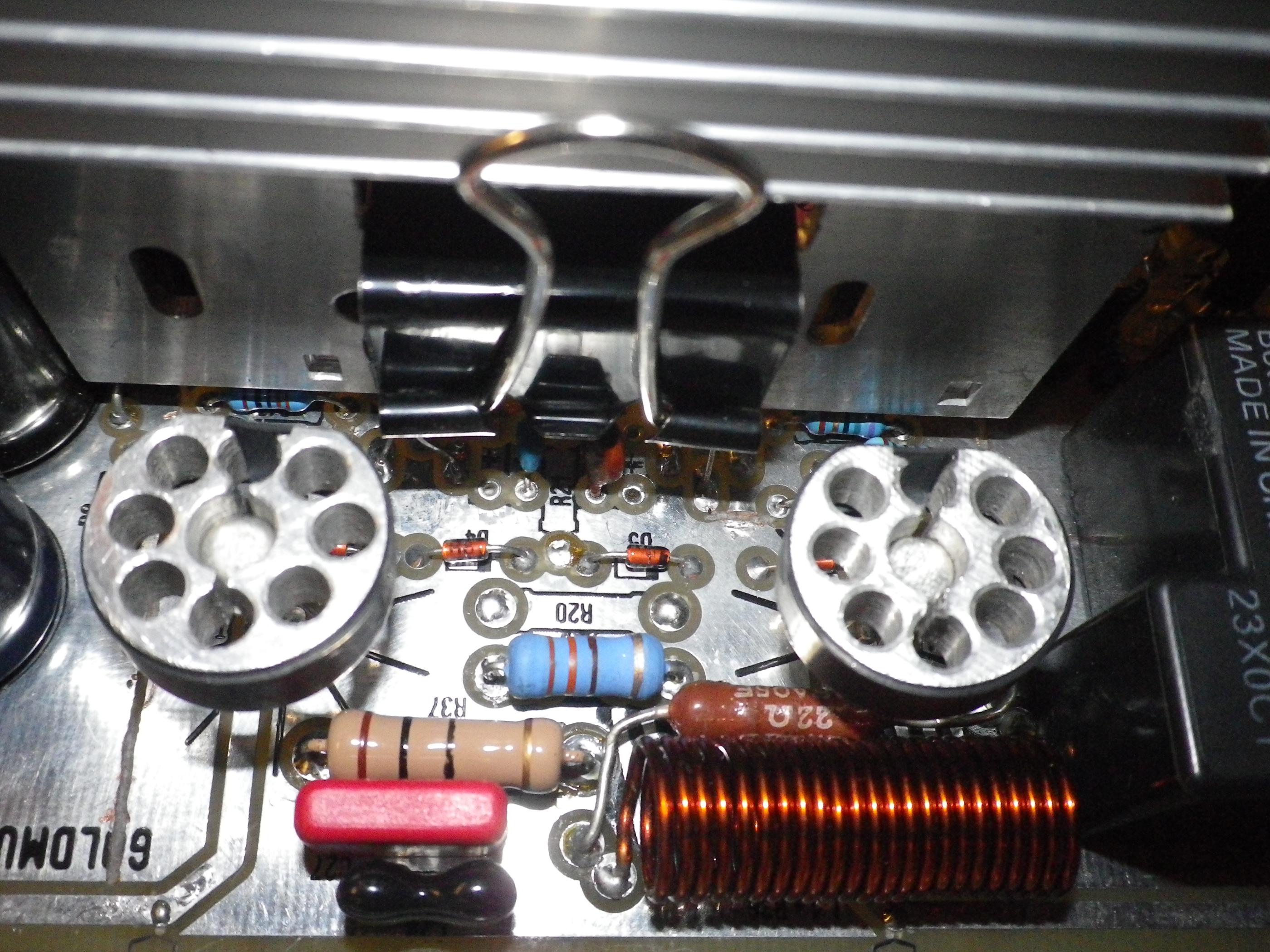

BUT this amp suffer on VAS stage 72 degrees Celsius with temperature room 31 degrees Celsius
Τhe next day i will show a new way to hold the transistors with clip to a larger cooler 52 degrees Celsius.
New way to hold the transistors with clip to a larger cooler 52 degrees Celsius.

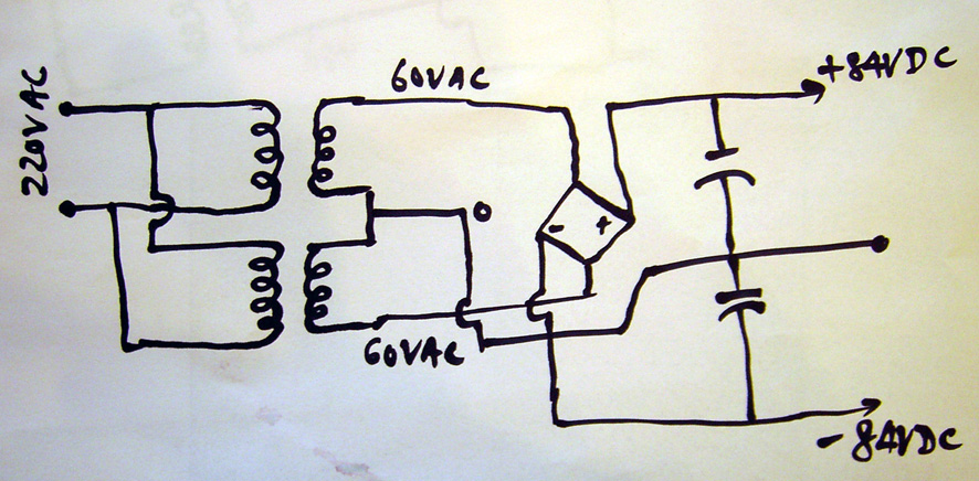

AndrewT,
I believe you misunderstand him.
He has TWO transformers , each with a 220V primary and wants to parrallel couple these two transformers and then series couple the secondaries from the two transformers.
As long as the phases is the same for the two secondaries , this is ok as far as I can see..
Koldby
