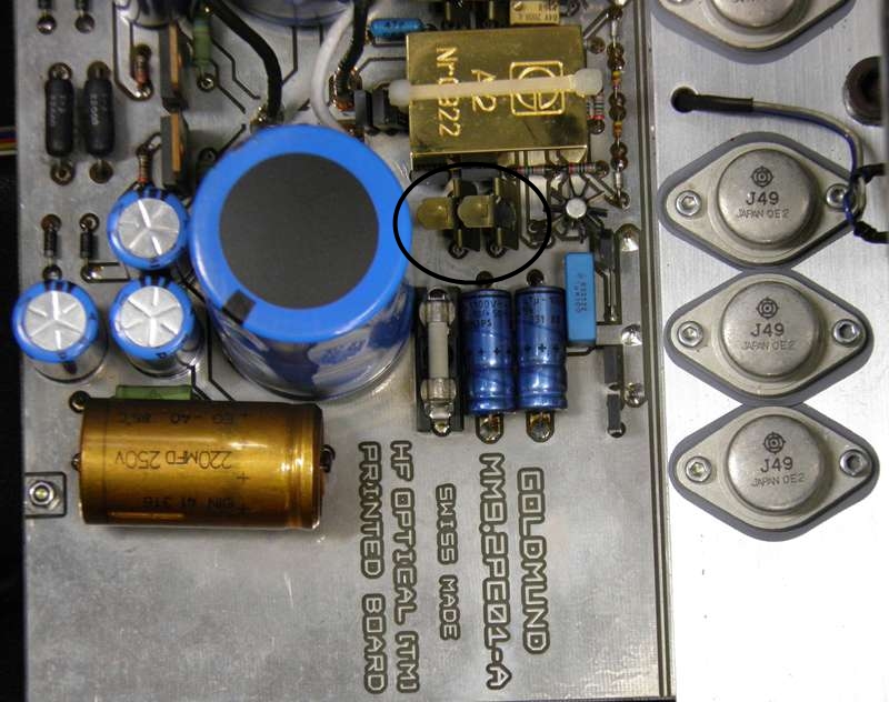

biass, 390 or 410 for K1058- J 162, if 150R change to 220R
and 410 to 510 for 10N-10P
please se the image for measure
I've done and fits perfectly with your measurements

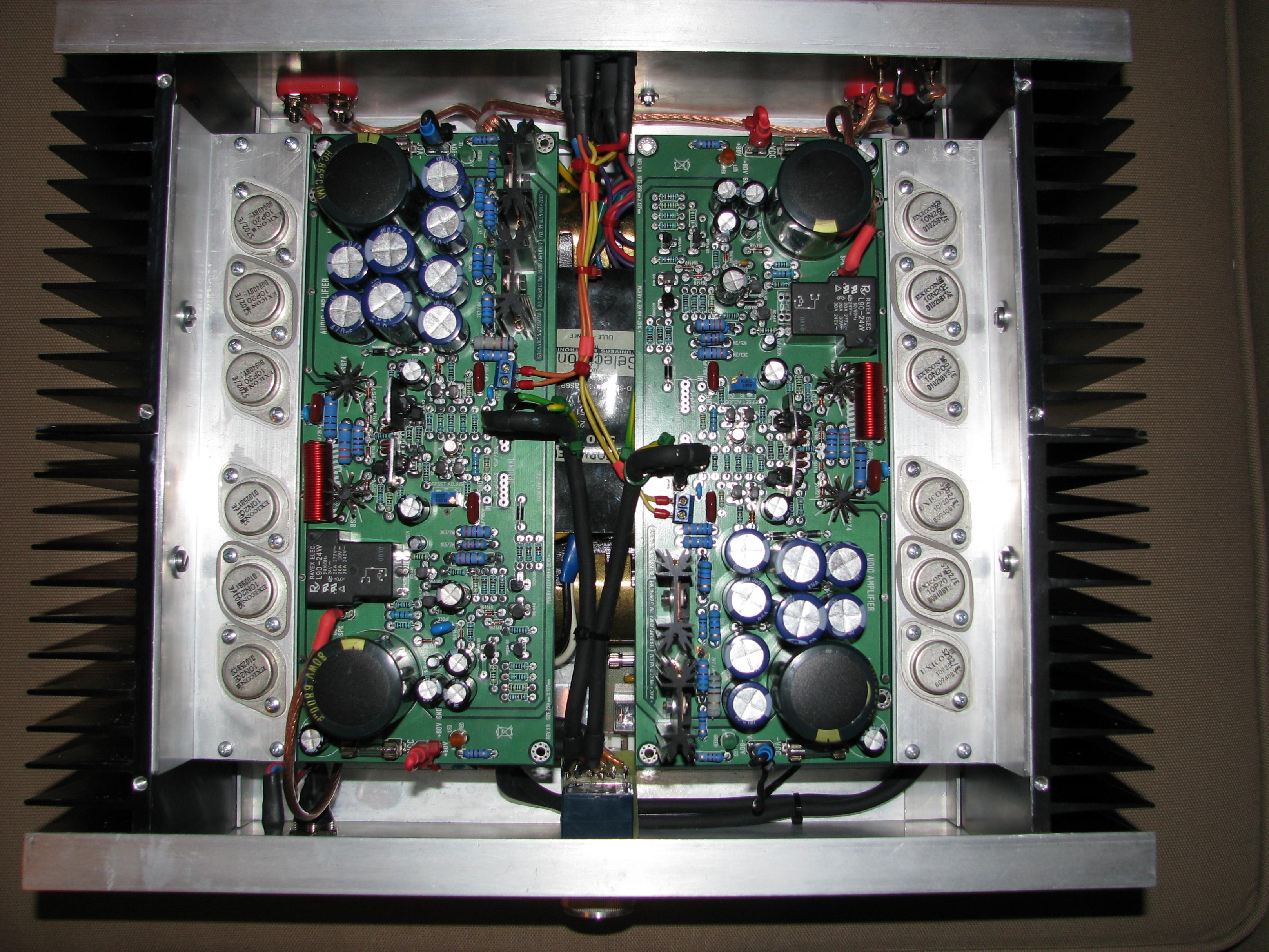

......today, have done the last connection , in my second built Goldmund amplifier, using better quality parts 🙂 I mean 500VA " R "core transformer , 47.000uF/80V Kendeil elyt caps./rail , step by step relay and , so on ....
Hardest part, as usual was the case , made from scrach 🙂 .Tomorow I will start up , becouse I want to sleep well , not to think all night .......more information soon. One picture , lazy to upload more pic.
regards Alex.
regards Alex.
