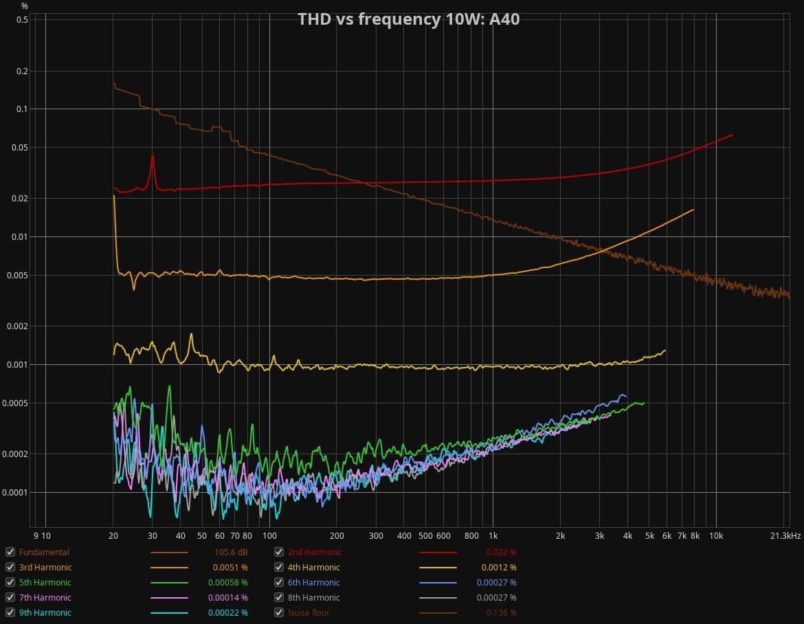

The 10W into 8ohms harmonic distortion vs frequency is quite nice. Doninant 2nd harmonic and descending higher orders. Pretty flat vs frequency. This makes for a natural and wonderful sound. 10W is what I consider a “loud” domestic level for most speakers (about 13dB plus base speaker sensitivity for stereo) or assuming 85dB + 13dB is 98dB at 1m. Wear some hearing protection!

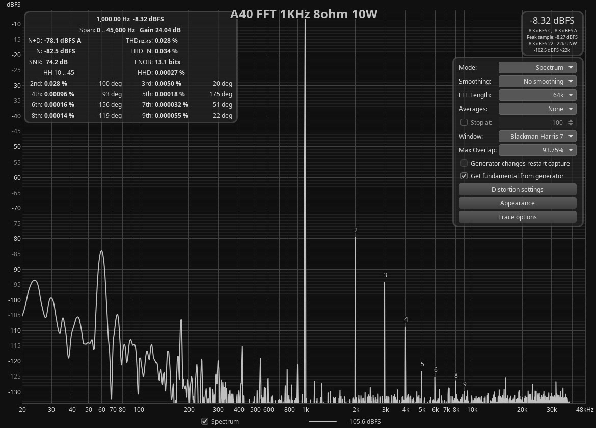

Spectrum for 1kHz excitation at 10W:
