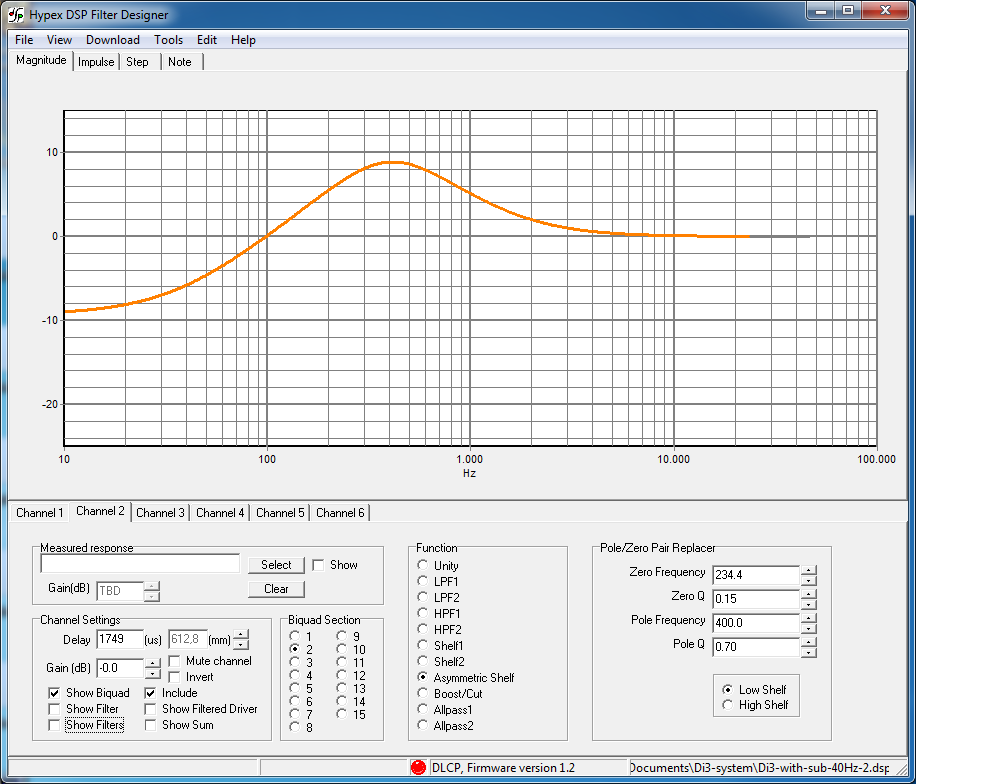

I do have a question. Can you tell a bit more about the EQ applied to these speakers, specially to the NEO10? A 6dB shelving low pass between 400 and 2khz(?).
many thanks and best regards,
Erik
Hi Erik,
Here's a screen cap of the Neo10 shelf in the DLCP editor:

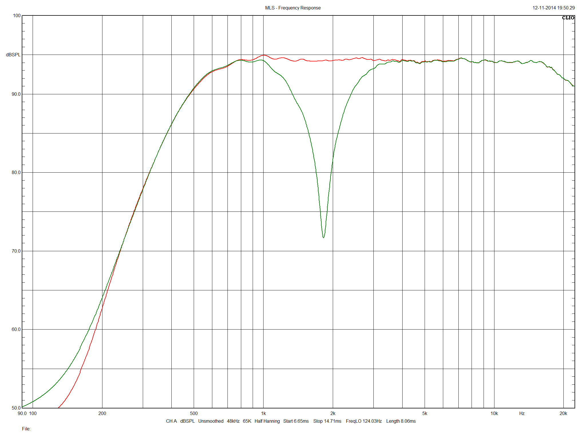

I didn't use a plain shelf but tried to combine the dipole correction and the first half of a 24dB/oct LR filter by using an asymmetric shelf (Linkwitz transform). I arrived at these settings by playing around with the zero pole parameters. I used the same approach for the ribbon, here are the normal response curve for the Neo and ribbon and the curve with the tweeter phase inverted:
This was an earlier test with a lower cutoff for the ribbon. I think this shows that this approach is working.

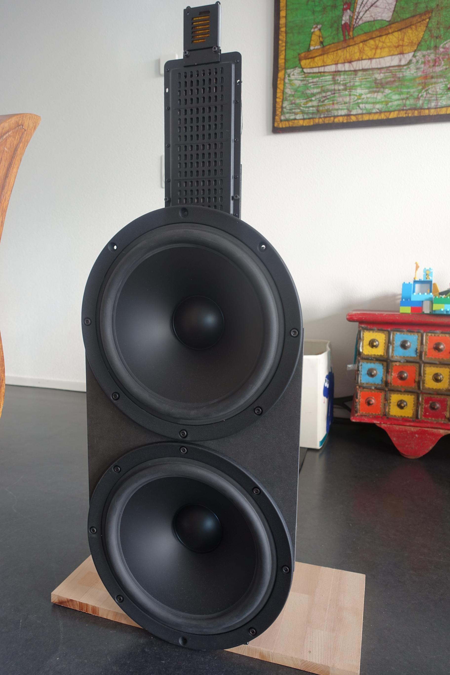

Hi Gerrit,
I completed my speakers, I dare to say the look like yours, but overall cost and effort is way lower. I wrote you a PM with some further details and questions, and doing this post to be able to show you a picture!
Many thanks and best regards,
Erik
PS. Ignore the foot, I am going to make something better.

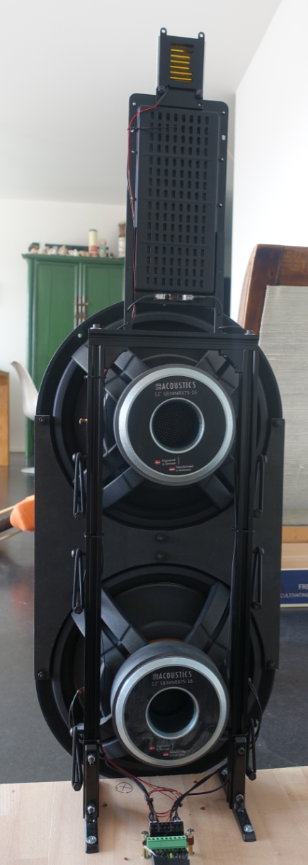

Hi karap (and Gerrit). Thank you again. I can tell you some things already, but as this is not my thread and I am still optimizing these speakers, I will limit to this post only and any further information - after optimization - I will put in an own thread!
Woofers are the SB34NRX75-16 by SB acoustics.
SB Acoustics :: 12” SB34NRX75-16
Mid is the B&G NEO 10, available again at parts express.
Bohlender Graebener Neo10 Planar Transducer
Tweeter is the Mundorf AMT 17D2.2
Mundorf AMT 17D2.2 Air Motion Transformer kaufen bei hifisound.de
For the wiring I wanted something flat, and ended up buying some industrial cable from Conrad. 12 conductors is overkill, but this was the only cable they sell per meter. Now I use some conductors in parallel for less RDC.
LAPP OLFLEX(R) LIFT F Steuerleitung 12 G 1.50 mm2 Schwarz 0042006 Meterware
Filtering is done with 2x MiniDSP 2x4 and the amplification is done with an Arcam AVR250 (75W per channel, 6 channels used). I want to use some DIY valve amps eventually, but if doing one stereo amp is already quite some work, imagine 3 matching stereo amps...
Filters are IIR, but as I am working on them it doesn't make sense to post them now. A better xover is also in the plans...
Mechanically: I used black anodized extruded 20x20 profile to mount the holding structure. The NEOs are attached to that with 10x4mm steel profile, the AMT is attached to the NEO with thin (painted) alu profiles.
The woofers are attached to a 8mm thick MDF plate. I use 6x 100mm long M6 bolts, whose ends are suspended by 6 thick o-rings. I think the attached picture is better in describing this construction.
I have some weird noise from 25 to about 50Hz, I (wishfully) think the shelving filters from the DSPs are distorting there (I noticed some distortion with the shelving filters on the NEOs) - I will check when I have time. I like the heavy panels by Gerrit very much, but lacking the tools and skills to make something similar, I hope this suspended construction is sufficient to 1) avoid rattling noises from the woofer, 2) mechanically decouple them from the Mid and tweeter.

Mechanically:...................................................................................
I have some weird noise from 25 to about 50Hz..................................................... I hope this suspended construction is sufficient to 1) avoid rattling noises from the woofer, 2) mechanically decouple them from the Mid and tweeter.
Nope, I can't see anything, but the description shows that you trust that these techniques might work; I don't think so, as I've read in the past years these obscure things about coupling/ decoupling etc. but none really stands on its feets.
The woofers need to be coupled rigidally to the baffle; the baffle itself, with that thin part at the sides, being 8 mm MDF, will not do the duty of holding them firmly ( it flaps). About the other drivers ( midrange & tw ), they need to be totally decoupled from the vibrations transmitted by the woofers ( also, I wouldn't have placed the electronics right next to them, as Gerrit did ).
That can be easily done by the mean of rubber bands...
