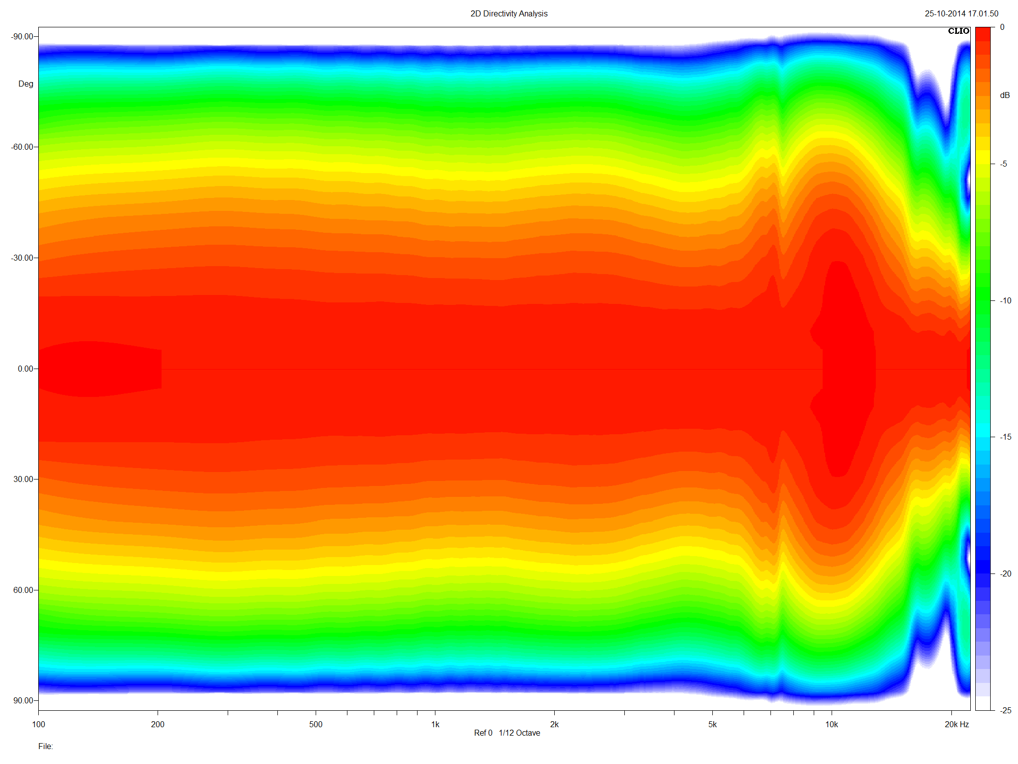

I'd love to measure the system in an anechoic room somewhere but I don't know of any in my area. In the meantime, here's an earlier measurement of normalised horizontal directivity of the ribbon and Neo10 where the ribbon still had a serious resonance problem:
The resonance at 7kHz is clearly visible but otherwise it's pretty much perfect from 100Hz to 7kHz. I don't think the transition from mid to low will be as smooth but who knows, maybe the wavelength is already large enough to facilitate a smooth transition.

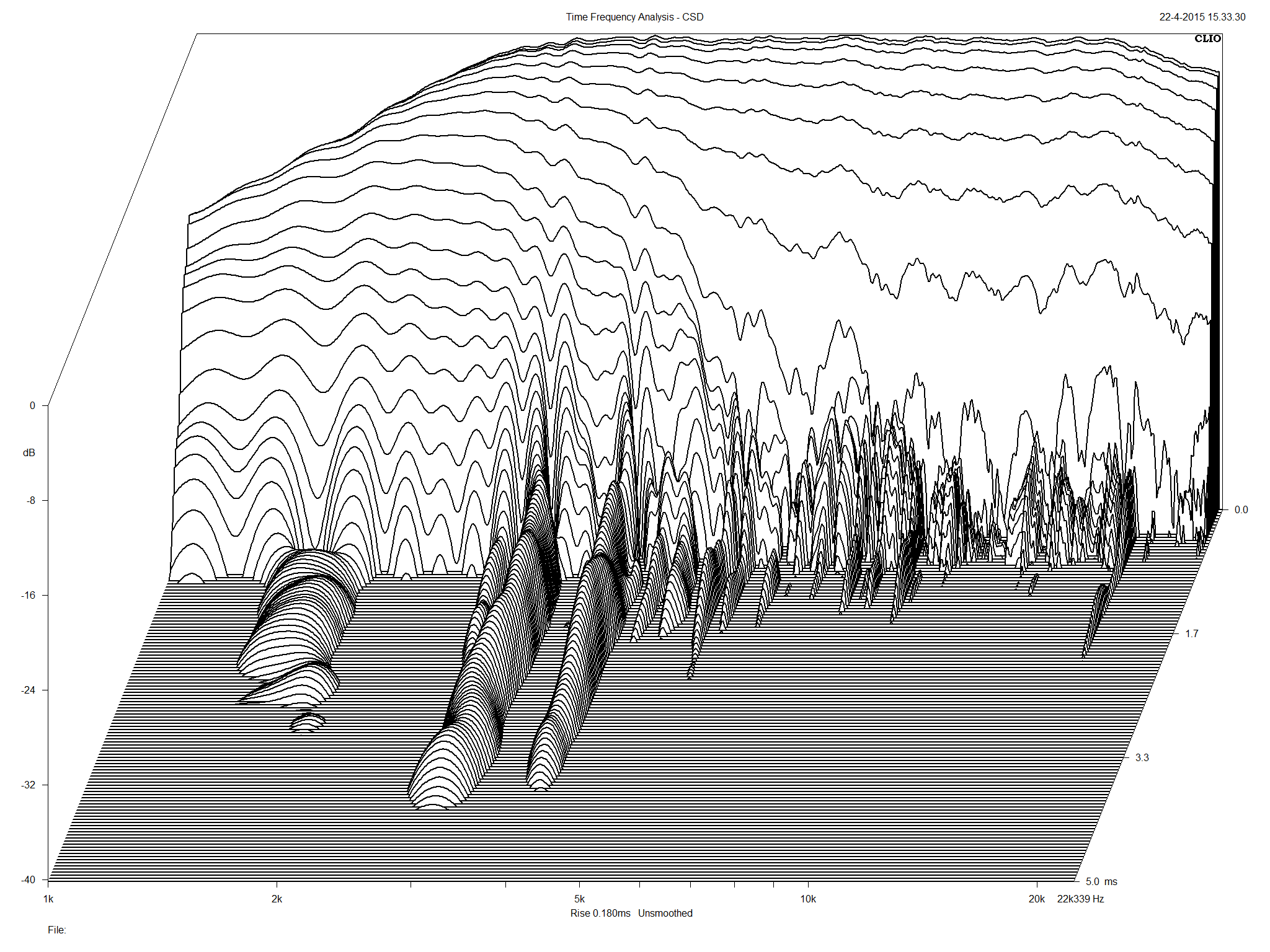

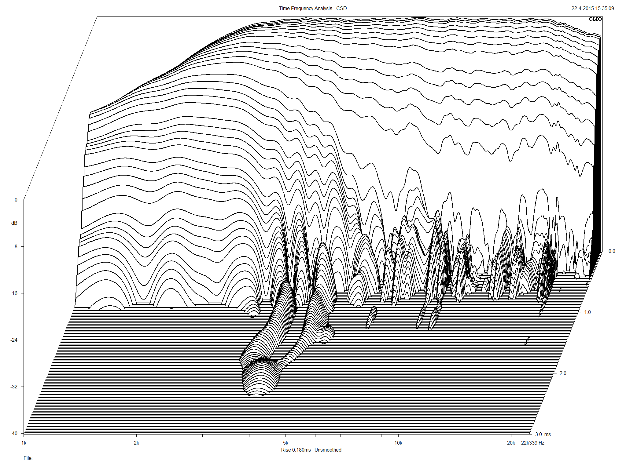

Here are two CSD plots of the filtered ribbon to illustrate the effect of the time window on resolution, the first is with a 3ms window:
The resolution is 333Hz, in the range between 1kHz and 2kHz this corresponds to 1/3 octave smoothing. In the range between 2kHz and 4kHz this would be 1/6 octave, so it is only above 4kHz that a resolution of 1/12 octave is reached and the fact that no smoothing is applied actually means something.
A 5ms window corresponds to 1/5oct smoothing between 1kHz and 2kHz:
The difference in detail is obvious.

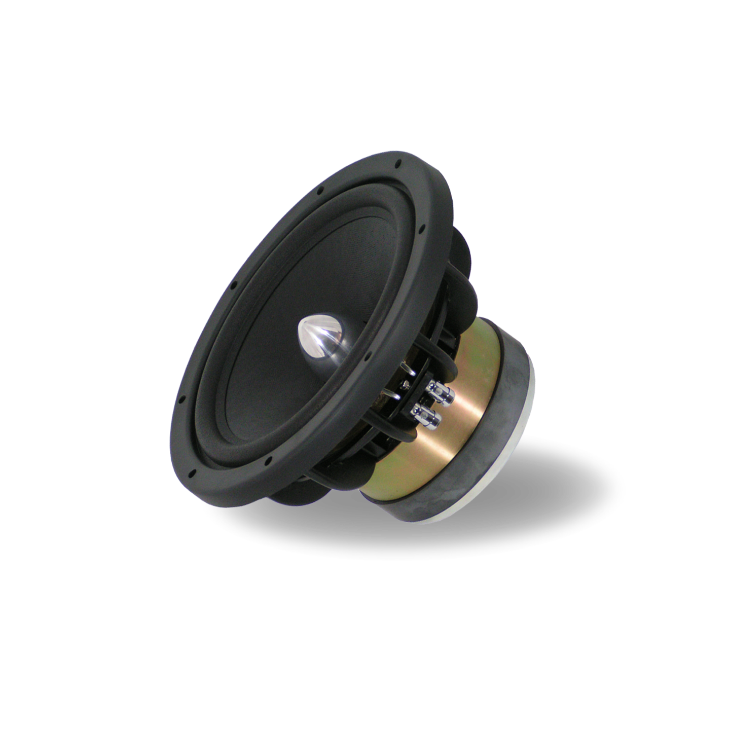

Very nice project the DIY ribbon and B&G midrange certainly do perform exceptionally well.
The choice of the AT drivers for the woofers is a little strange all things considered. They don't really bring anything special to the table except their price tag. Gornir has measured it here.
www.audioexcite.com AudioTechnology 10C772510KAP
And its performance is lacklustre to say the least.

The AT drivers were selected for their large excursion capability combined with low fs and low Mms. Gornir does use this driver in his Sequence Three – Grand Reference. To quote:
Troels Gravesen also has a lot of good things to say about this driver and I heard good reviews from others. When I have the chance to measure my system in an anechoic room the measurements will show how they perform in an open baffle. Subjectively it is a big improvement over the Orion, much more detail in the bass and lower mid.This loudspeaker is fast with very nice micro dynamics and they don’t need much power to bloom out. This is a speaker that can be listened to at low listening levels and still be enjoyable.
