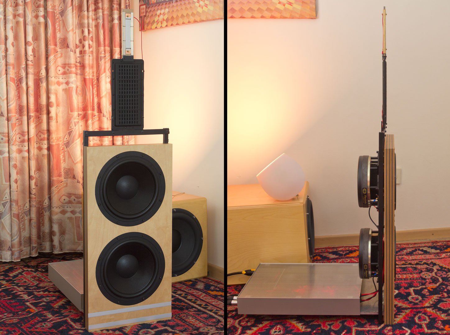

Purely the width of the driver for the dipole behaviour and aesthetic reasons. Coming from the Linkwitz Orion I knew that 2 10" would be more than enough for my situation. As I mentioned earlier it was my intention to build something better AND smaller than the Orions. If my living room would be 10m x 10m I'd put a 21" on the floor, 10" or 8" above it and the Neo10 and ribbon above that (or something like that).
The only possible change I can see now is adding another amplifier and apply separate filtering for the lower and upper driver so that only the upper driver goes up to 400Hz.
regards,
Gerrit

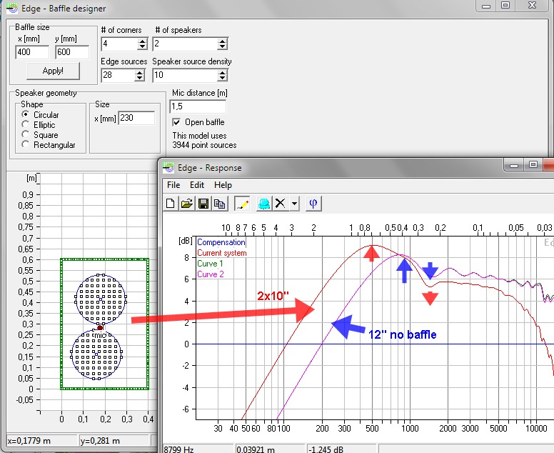

As per my experience dipole pattern is quite tricky to get right with (especially two) cone drivers.
The drivers' magnets and frames will do nasty things - directivity gets ragged way before the dipole peak at 45-60¤ and specially at 120¤ and more. Because of that usable range will be limited but 400Hz should be ok for double 10".
This will happen with every size of drivers, that's why planar dipoles are superior in the very critical 1-6kHz range. Bass (perception) is not so sensitive to uneven radiation and frequency response wiggles.
Below is Edge simulation of nude 12" and double 10" in 40x60cm frame on-axis response where you can see dipole loss, peak and null. Notice the difference in peaks not nulls!

Magnety-thing Juhazi mentioned this AT 10" looks like worst possible, but is it really issue under 200hz?

I forgot to say that problems with far off-axis and rear radiation appear at and above the dipole peak. That is why as a rule of thumb I recommend lowpassing rather deeply right after dipole peak, which usually means 1 octave before dipole null.Below is Edge simulation of nude 12" and double 10" in 40x60cm frame on-axis response where you can see dipole loss, peak and null. Notice the difference in peaks not nulls!

I can't say anything about Qts meaning but it is weaker effect than acoustic dipole loss.
Dipole null is handled by not letting it appear in the passpand, set xo low enough.

So, was it worth the effort? Yes, definitely yes! I’ve been listening to this system for over 6 months now and I haven’t yet detected anything problematic, as far as I’m concerned it is a blameless loudspeaker. The nearly constant horizontal directivity and perfect dipole symmetry (at least above 400Hz) results in an exceptionally focused and stable stereo image. Because the system is so narrow at the top it also does not stand in the way of it’s own back-wave reflection, I think this is very important for a dipole. A wide baffle will cast a shadow so to speak which will make it possible for your auditory system to (more easily) detect its position.
Yes, the system is horribly inefficient but the amplifiers and power supplies are all very efficient so the total power consumption in rest is just above 100W which is not bad for a system with a peak power of well over 3kW. The enormous peak power capability does provides horn like dynamics and ease of presentation. The operating temperature is somewhere between 30 and 40 degrees Celsius depending on output power. The system is very, very quiet, you have to press your ear against the Neo10 to be able to hear a faint noise. No hum, no clicks, no pop or crackle. The system is also free of any mechanical noise (humming or whistling).
So where’s the catch? Well, it won’t do an orchestra at full concert level despite the enormous amount of power available. The maximum SPL I measured on the my listening couch (3m distance, with acceptable distortion) was about 103dB which is more than enough for me and it also is enough for SMPTE RP 200, 83dBSPL average at the listening position with 20dB headroom (83dBSPL = -20dBFS). The limited vertical dispersion requires a minimum listening distance of 3m for proper integration of low,mid and high frequencies and sufficient high frequency dispersion. The system is certainly not child or pet proof and I would expect the WAF to be close to 0. And then there’s the cost, this particular implementation with the AT drivers and Ncore amps is very expensive but even with other amps and drivers this kind of system will never be cheap.

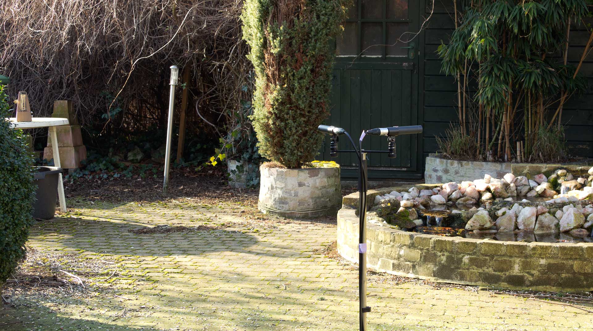

To evaluate the quality of the stereo imaging I came up with the following setup:
A little winter audio scene in my backyard. On the left on the table is a mechanical metronome, the little pond has three little waterfalls and what you don’t see is the freeway in the background. The freeway is behind 200m of trees and running parallel to the stereo axis resulting in a diffuse sound ‘carpet’ filling the stereo image. The two cardioid microphones are amplified using a simple Mackie mixer. I tried several methods, the picture shows NOS, and found that X/Y works best with the dipoles. The quality of the reproduction is quite stunning, especially the way the diffuse background noise is rendered. The metronome is rendered with pinpoint accuracy, it sounds as if you could walk over and grab it. The little waterfalls are also very realistic, just ‘there’.
As you might imagine I’m very happy with this system, it does everything that I hoped for and then some. It has definitely convinced me of the importance of constant directivity, and in the case of dipoles of dipole symmetry. The fact that the measurement results are all very good and can all be presented without any smoothing applied also gives me piece of mind, I no longer feel the need to listen for defects in the reproduction, now I just listen to the music.
I hope this short report results in more people paying attention to the directivity of loudspeakers whether it be dipoles, omnipoles, cardioids or waveguides/horns, it really is worth the effort. Maybe the ‘directivity plot’ should be renamed to ‘spatial distortion plot’. Spatial distortion has a nice ring to it and the term more accurately describes what’s going on; irregular directivity will distort the stereo space (image).
regards,
Gerrit
