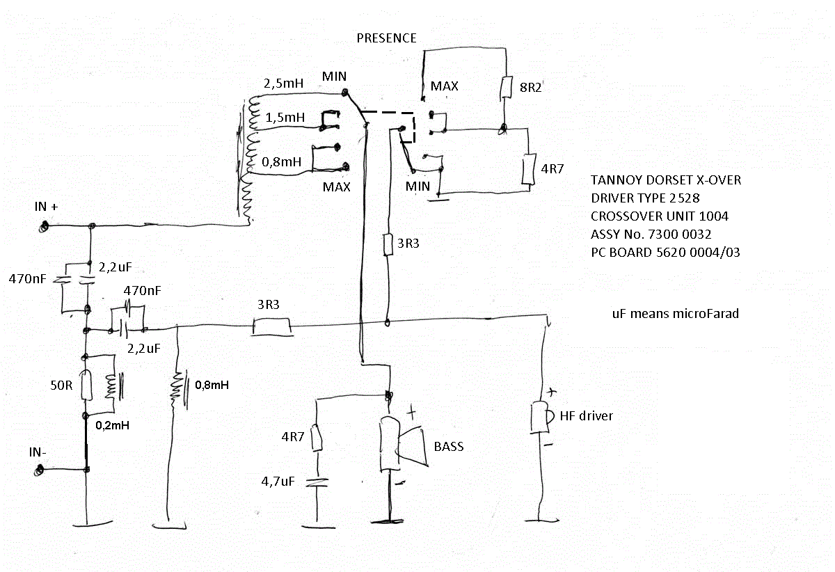

The interesting question is why shows the original in our Spice simulation a crossover point at nearly 4kHz. And nearly all brochures speak of 1k5 Hz.
I found only one source speaking of 3k5 Hz.
Mikorist and ZM, please what was the crossover point with the Dorset in Spice?
Is it possible they changed during production time this feature?
Or do we miss a point?

give me some time - tomorrow I'll post some info I have about Dorsets , on my blog
maybe I'll have time to make some sim , even if I'm not finding that so necessary

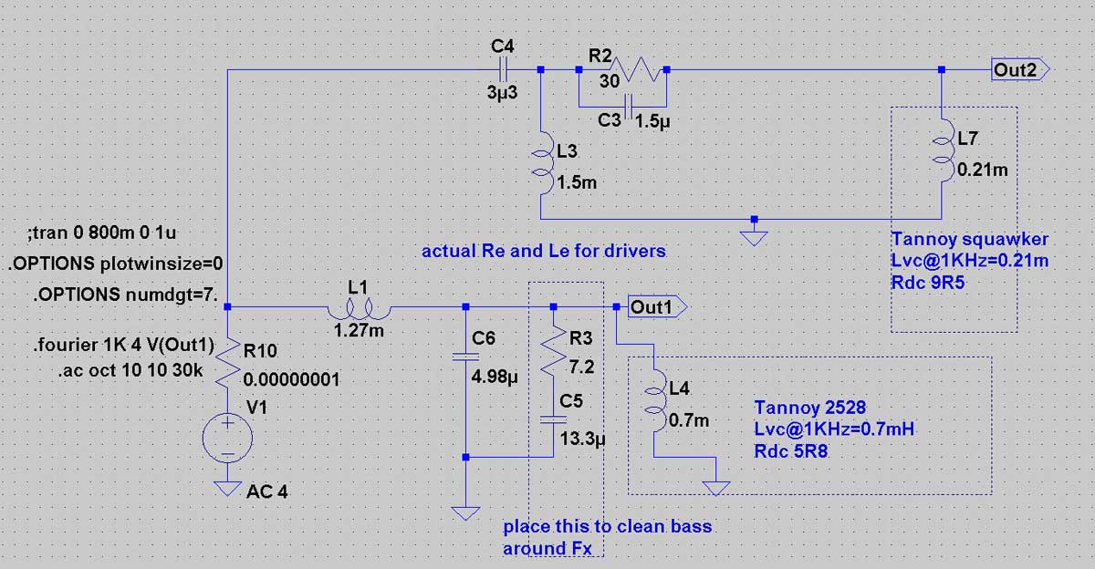

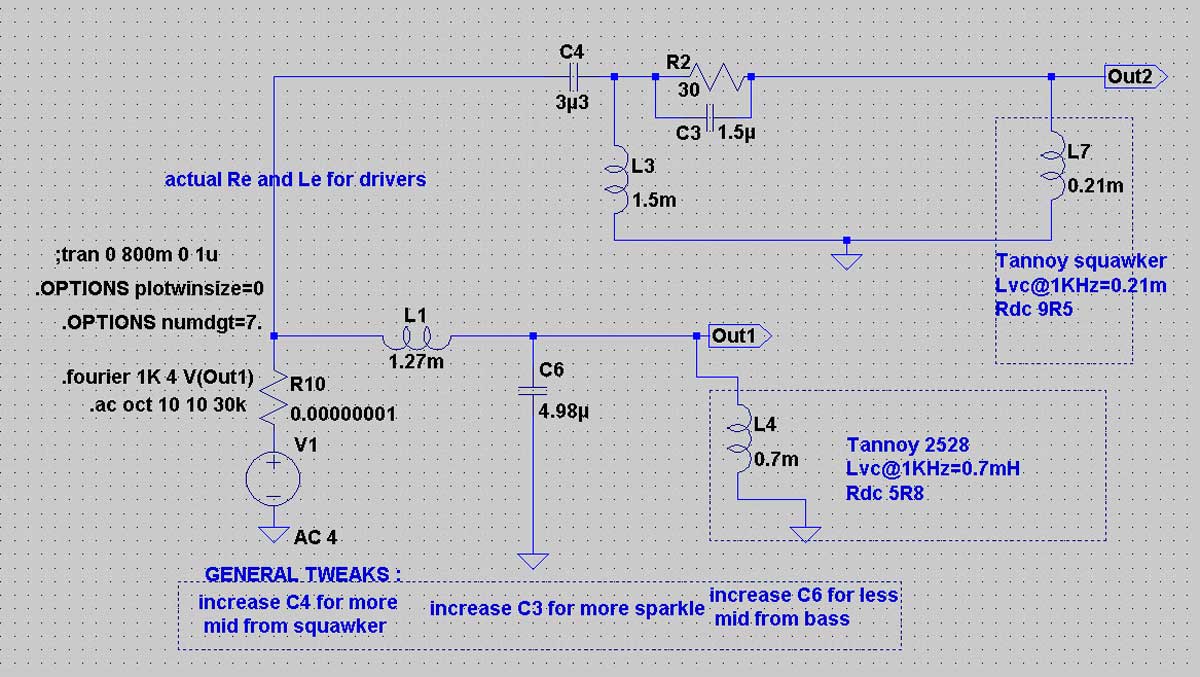

Generg , I didn't posted Dorset info on blog , but prepared this ;
will do that later , maybe even tonight
If you have mike on disposal , it can be handy now ......
for starters , you can use even crapiest quality inductors ; when you finish testing and declare final values , then you can make proper ones , or buy them
I forgot to write on schmtcs - if Hf driver is too hot , generally - place 47R (or lower ) across L3

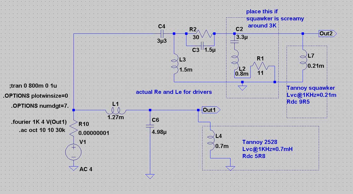

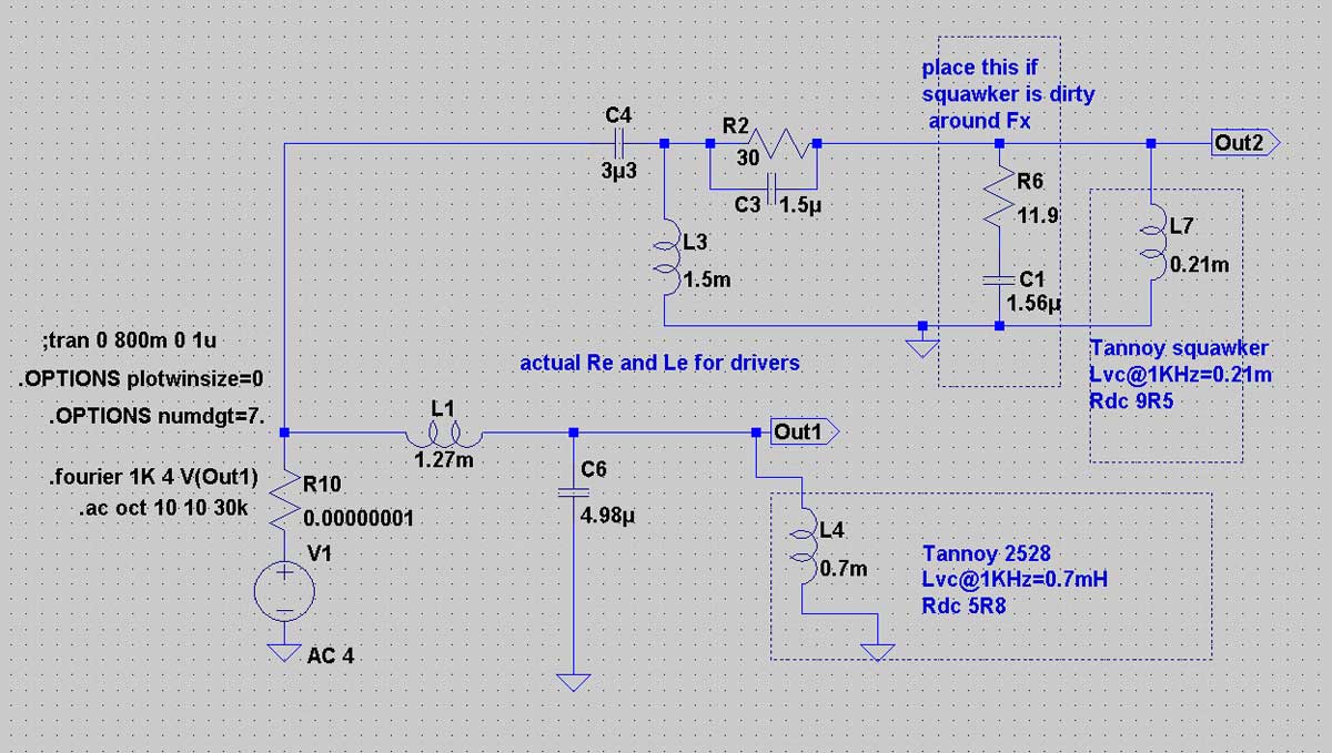

What is dirty and what is screamy?

dirty - not clear
screamy - ears are falling off

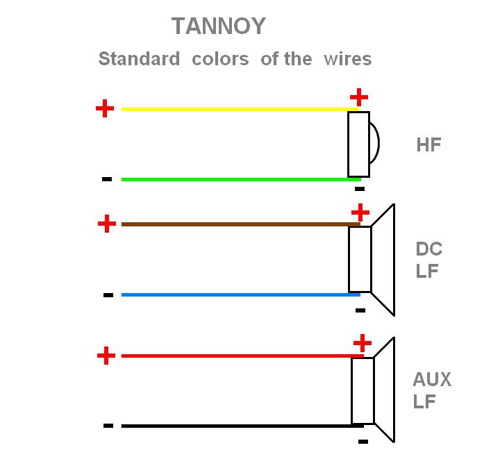

I repeat - for components - use cheapest you can find , for start
generally - try to finish with smallest number of parts/cells in xover
what's essential is in Step 1
edit - enclosed Farbe Nomenclatur ; taken from some Russian Forum
it can be handy for starters , to mark pos. terminals on drivers (check that too , with 1V5 battery)

MAX position is high - end .. I would not touch the original 😀
