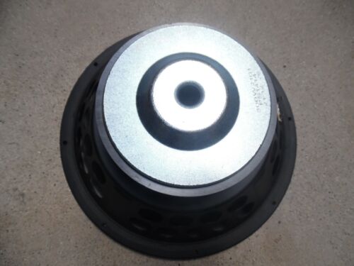

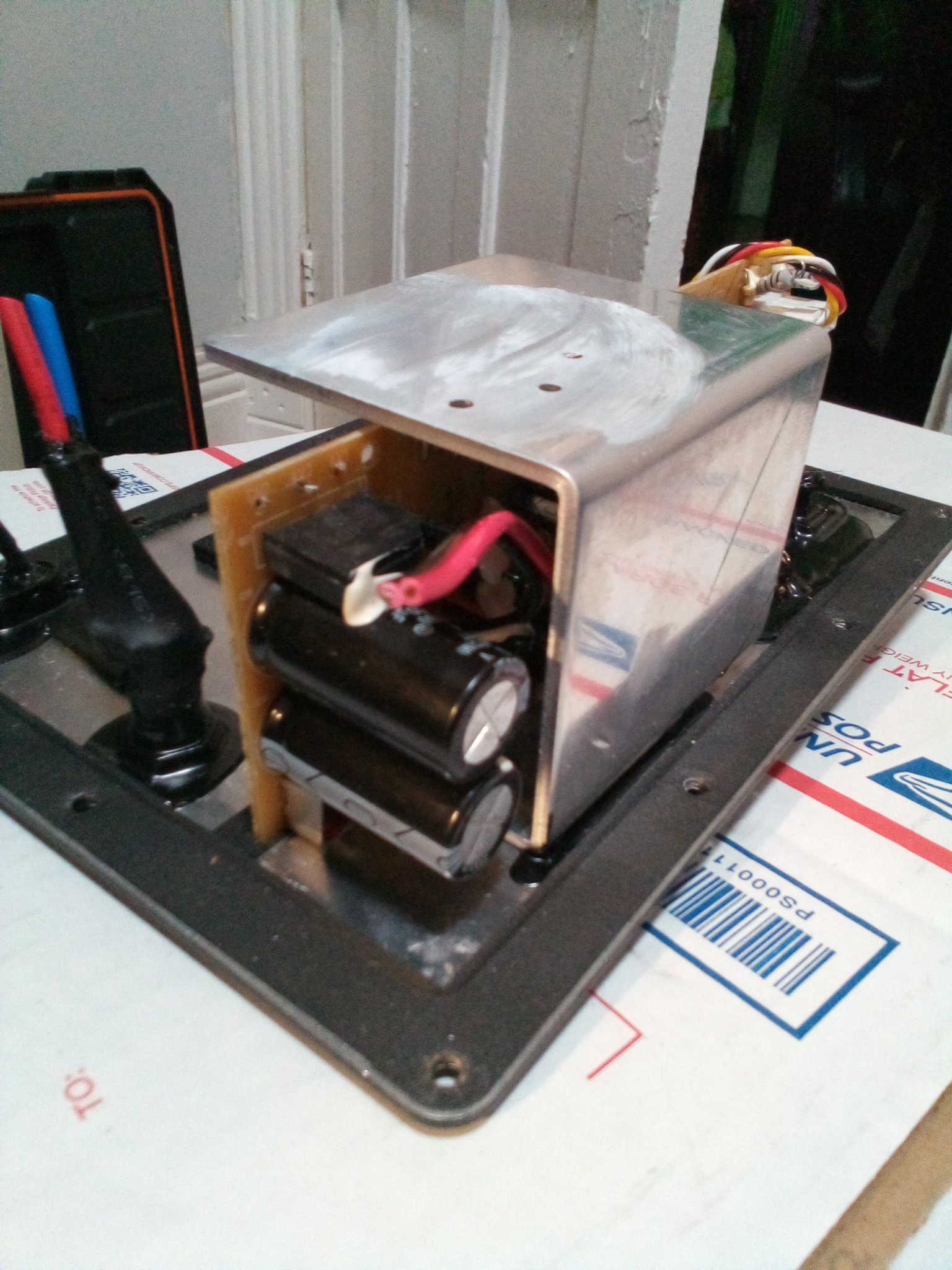

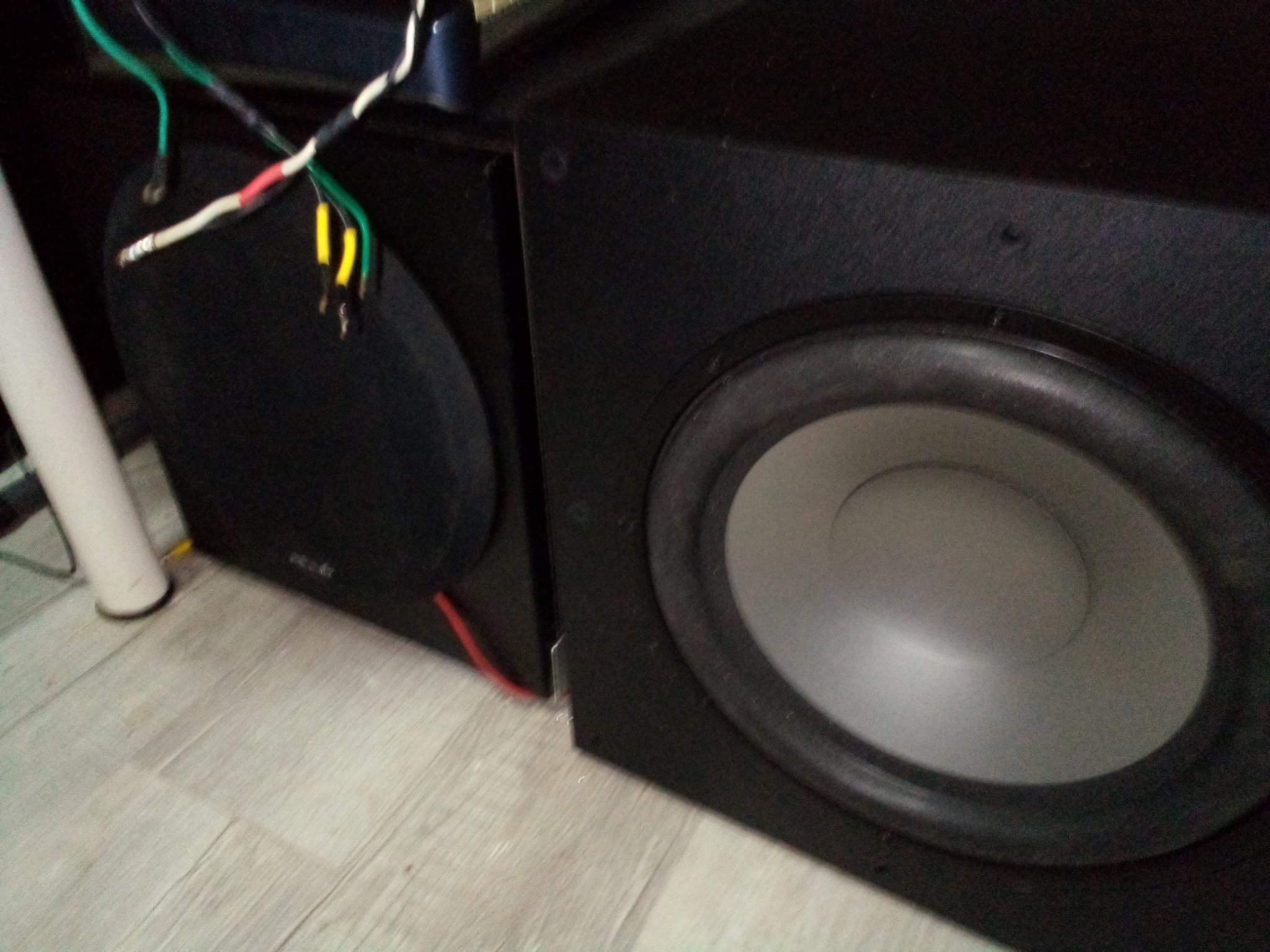

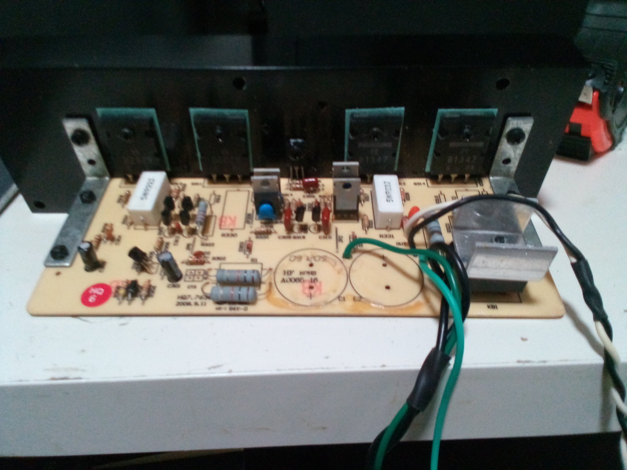

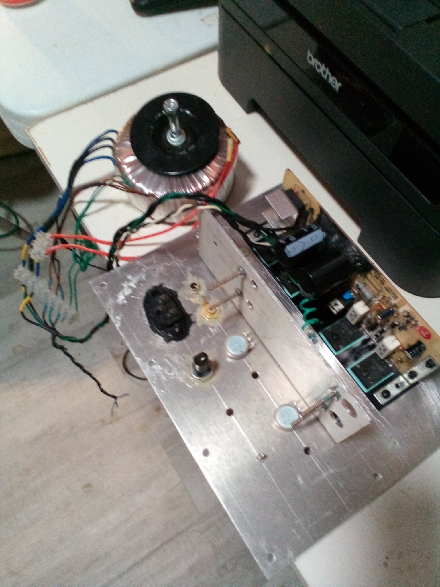

OK , here is what I got (35$) ... almost glad for the OEM BS that they get 329$ for.
I'm running it with my original 10" project amp... NICE deep 24hz bass. What a magnet (pix 2) !!
It deserves a REAL amp , not this one ... pictures 3/4 .

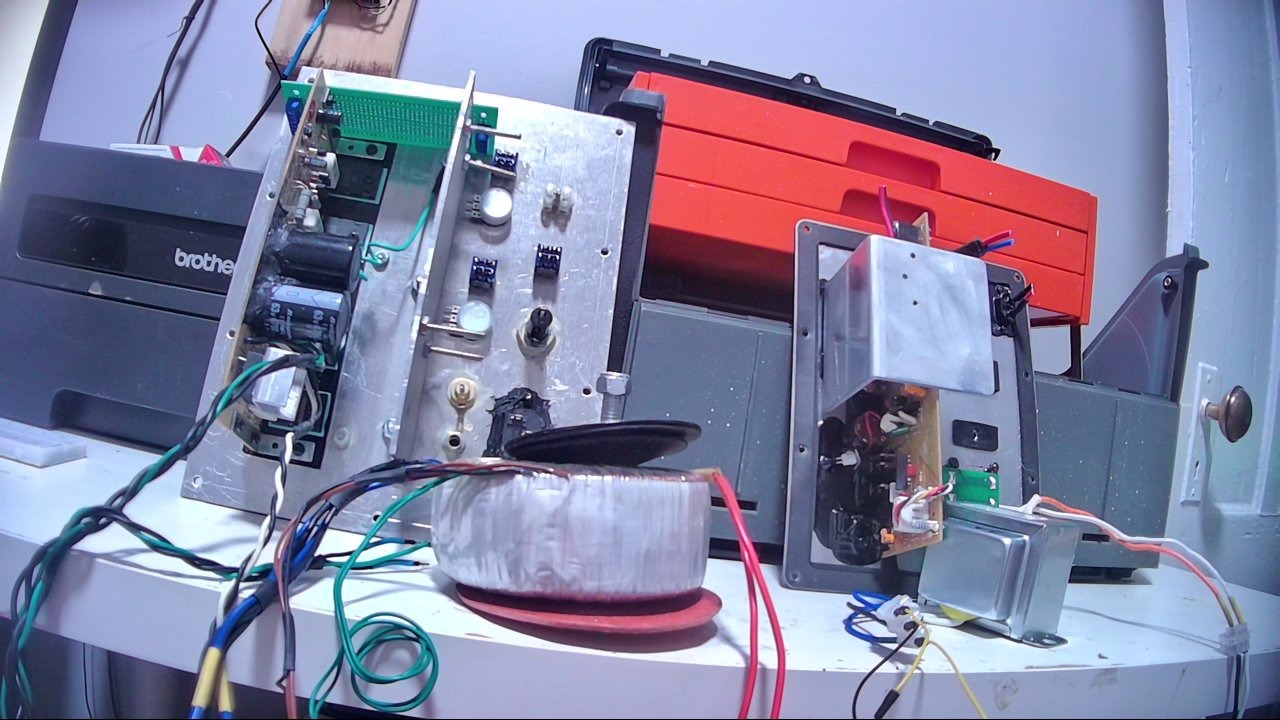

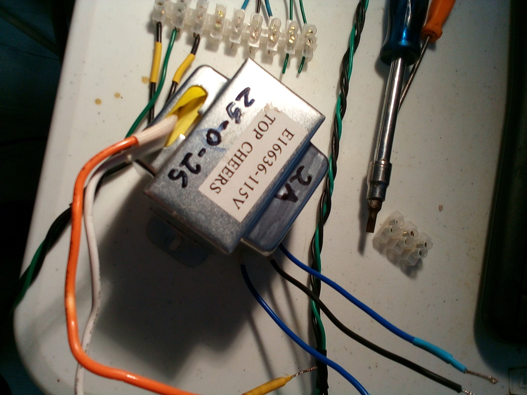

What a little 25-0-25V trafo and small chip amp !! I rocked that woofer with the full output of my new amp - no issue!
I recapped the second harbinger amp with Rubycon's and stuffed it full of Panasonic D2029-B1347 outputs. I like Japan ! (photo 5/6)
I DO NOT like what is offered for a sub filter. I will design a better filter/phase with op-amps and BJT's.
Free is nice , Trafo and transistors are from a KLH amp 40-0-40 6A and 18-0-18 1A secondary's. I'll use the old polk trafo for my headphone amp.

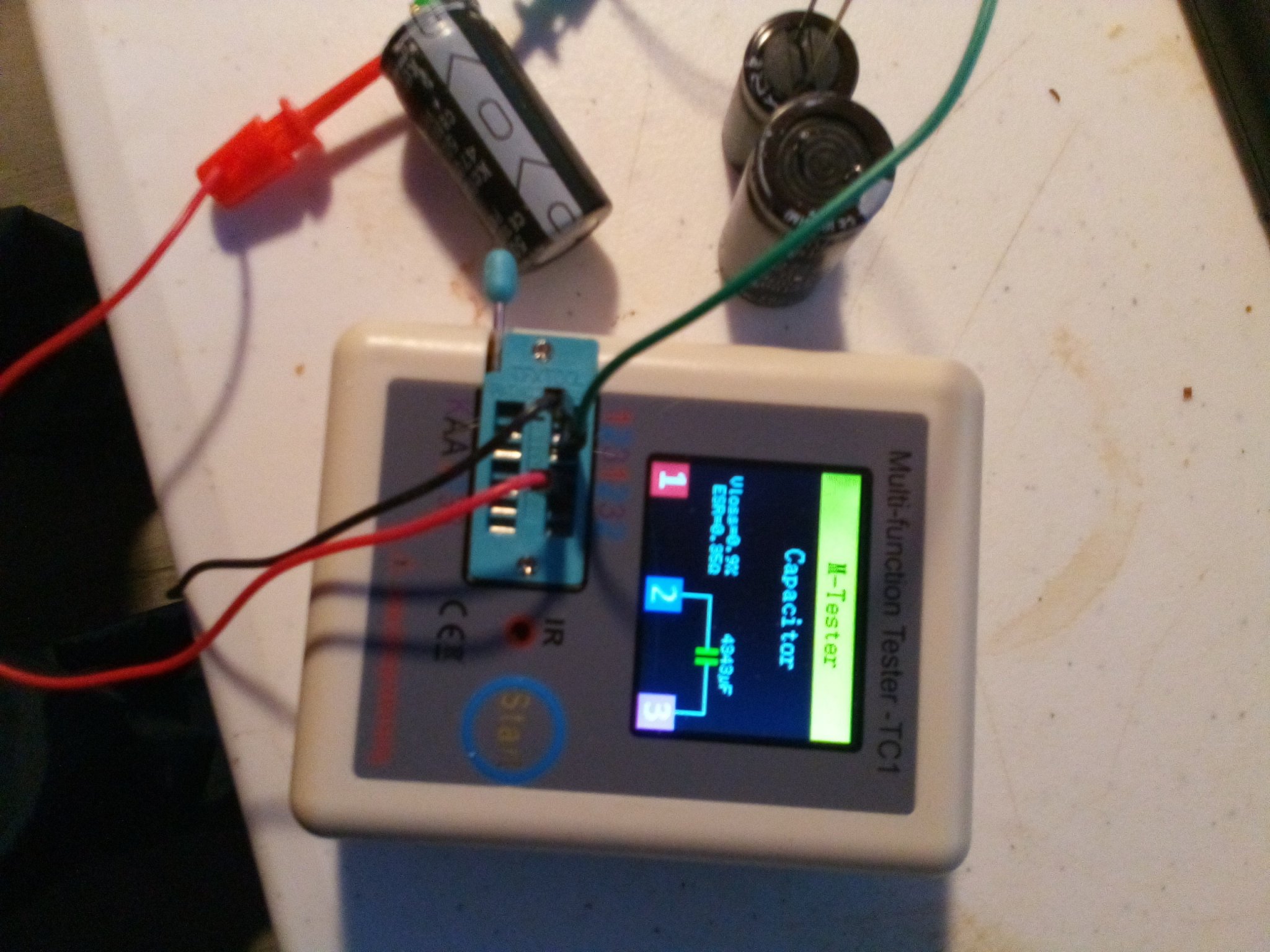

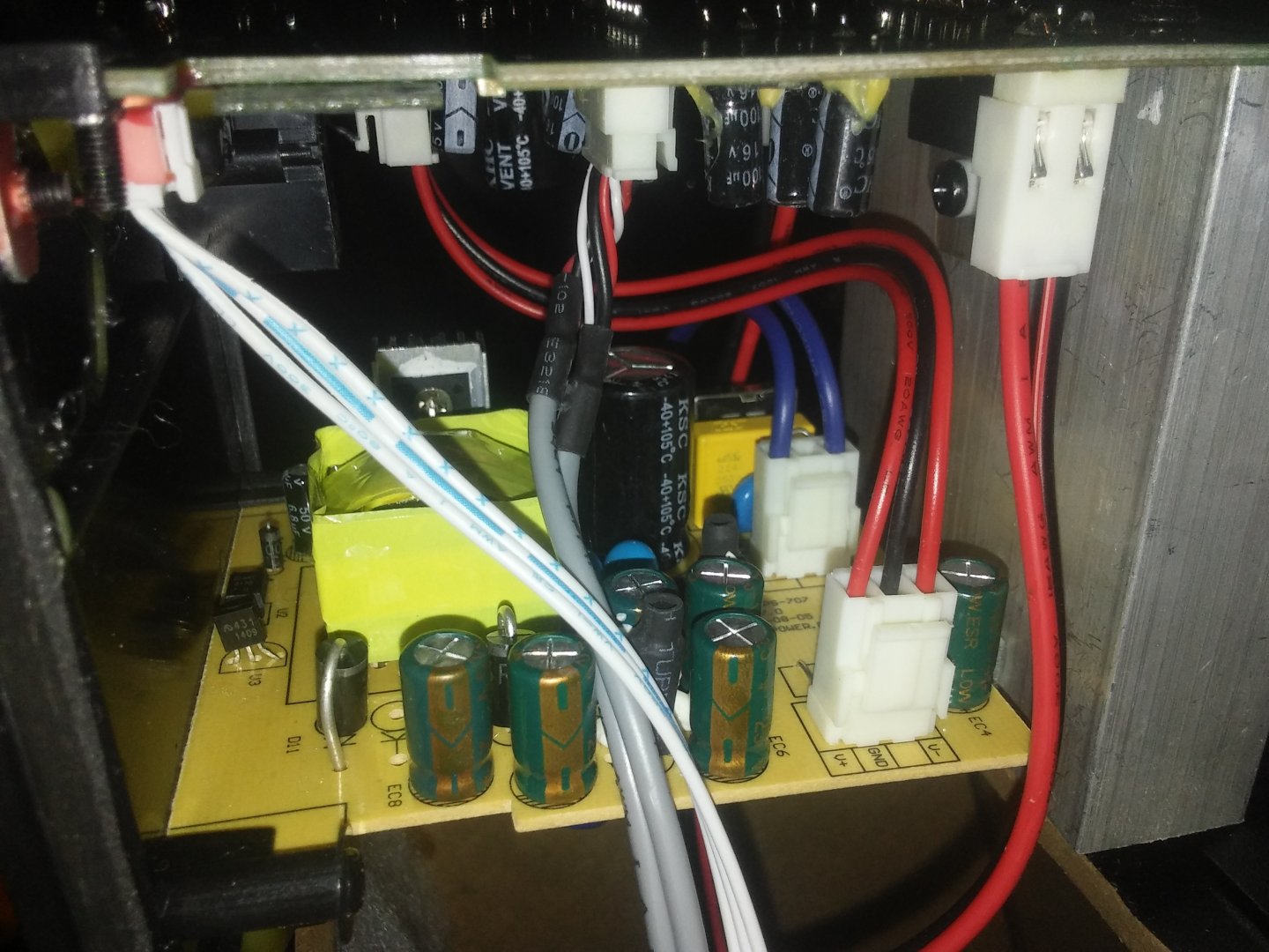

Now .... for the "rant". While stealing the larger parts of the 12" Polk amp , I noticed the "Ketuo" 50V-4700uF caps. About 1/4 the size of my
new Rubycon's (below 1). how can this be ? My fancy new arduino based tester says 4300uf+ and .36R ESR.
If I did buy this sub for 329$ , I would be pissed indeed. The little Rubicon 2200uf/35V's are almost the size of the Ketuo caps.

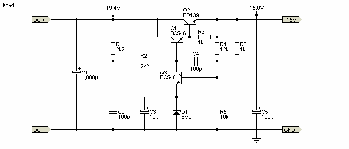

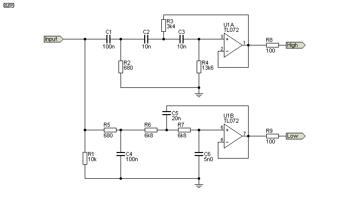

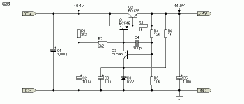

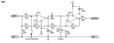

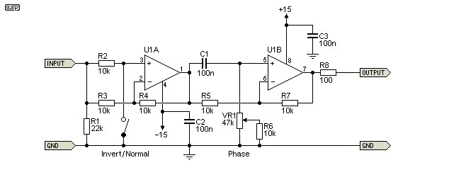

Hooking up the filter/phase , I will use a 18db/oct bessel (below 2-4) with ESP's project 123 +phase inverter and powered by a feedback zener referenced
series regulator.
NO simulators on this one ... I will build this for real (as i go along).

Ohh , nice stuff. This sub amp is yet another simpler "badger" type amp.
BTW , I was listening to this sub with the new amp ... I noticed there was NO class AB bias. The Panasonic 2SD2029/2SA1347's only have 460mV Vbe.
The original Toshiba's were >500mV+. The amp's fixed Vbe ratio was set for the Toshiba trannies.
For a sub , you can't hear Xover distortion. To be "anal" (perfectionist) , I will at least pull 20ma though the emitter resistors for true AB operation.
NO trimmer on this amp , I'll just parallel something like a 2-5K on the lower leg of the Vbe divider.
I built the ESP regulator. Very nice for a time before IC regulators , under 1mV ripple (-65db+) . Close to a 78L12 (in performance) , would be good
if you had to regulate off of the main supply. BUT - 15 components versus 3 for the 78L12/79L12 pair. Since I do have a low voltage secondary , I will use

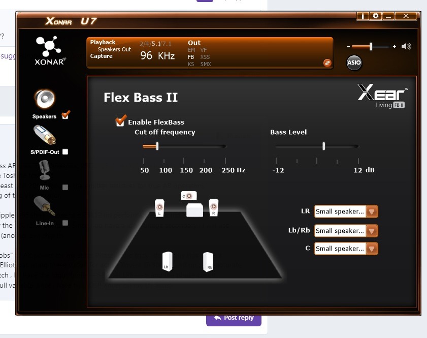

the bloody chips (oh , NO !!). I mean , I'm using a TL084 for the filter and phase (yet another evil chip !!).
I am having better luck with evil chips these days LM3886 for 80Hz up , and "gobs" of AB power for my subs. Phase is the trick , that's why this project
has the Bessel filter and ESP's variable phase. Very accurate between 20-100hz. Elliot was using these circuit for active Xovers @ 300 hz and up , less accurate
at the higher frequencies. Most sub amps just have a stupid 0 or 180 phase switch , I'll have the input buffer -->Bessel LPF ---> and the phase circuit.
LPF will just have a switch for 70 or 120hz 18db/oct rolloff. Don't really need a full variable since I have this (DSP Xover on my U7 asus).

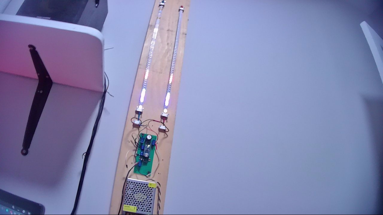

I might add my Arduino VU meter to it (below 2) , trafo has a 6V 3rd secondary , as well.
