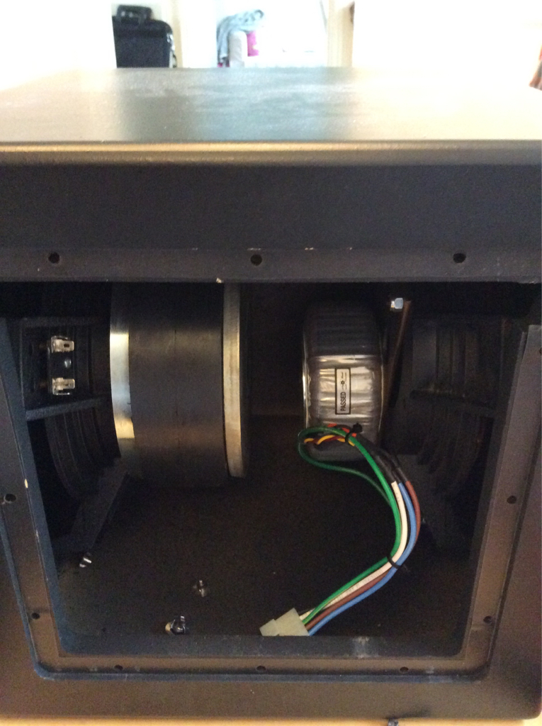

On talking apart the cheapest one I was shocked at the lack of electrical safety internally as well as the iron itself outwardly looking good but internally dreadful.
This was my intent , not to make a slur.
I have (almost) had great catastrophe because of this issue.
Coffee maker burst into flames , (Asian) Pyle amp on fire.
No thermal fuse ?? I think we here on DIYA do better in the safety realm
than some OEM's.
I'll disassemble any imported new unit , just to preserve life.
I'm sure they won't smell the burnt flesh half way around the world.

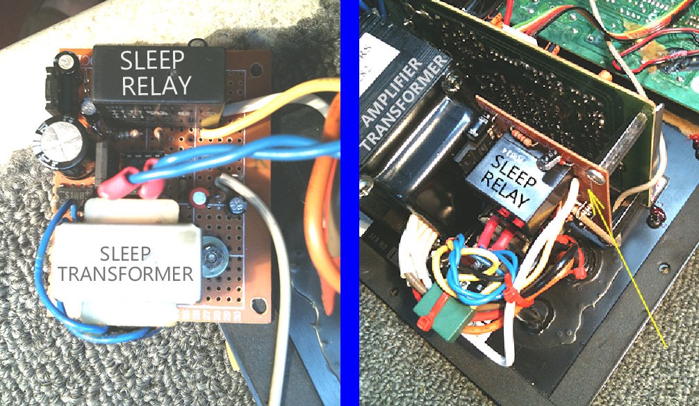

Oh, I didn't go into detail about some things, to keep my post shorter.
The "I worked my magic" part is the clue.
This PS caps were changed out to Nichicons. as were some others.
(As I've mention in some posts, I'm "picky", yet not obsessed.)
Also, I added a "sense-standby" board w/transformer, of my own design which kills AC to the main transformer until it detects audio.
Because the main transformer, even in standby/idle, drew 50 watts from AC.
My additional small standby board/transformer, draws only 2 watts AC - when it detects audio, it kicks on its relay, turning on the main transformer.
The standby circuit kills main AC after a 2.5 minute "no audio" delay.

My sourcing isn't nationalistic in any way. I just bought a 10$ Antek 10VA
12-0-12 trafo for my Sub rebuild. Made in NJ - USA !!! Did I buy it because
of the USA factor ?? No, it is just a known quality company who I am sure
would mostly refund / replace it in a heartbeat.
Got it in 2 days , as well.
All my Audio uses these units , 200-300VA ones just have a 2W core loss.
I don't see why they would use EI's in a hot sub box. My Polk's "good cheers"
was quite hot to the touch ( and had brittle wires) ... just a few years old !!
Logitech also uses a toroid in their subs.
