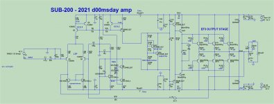

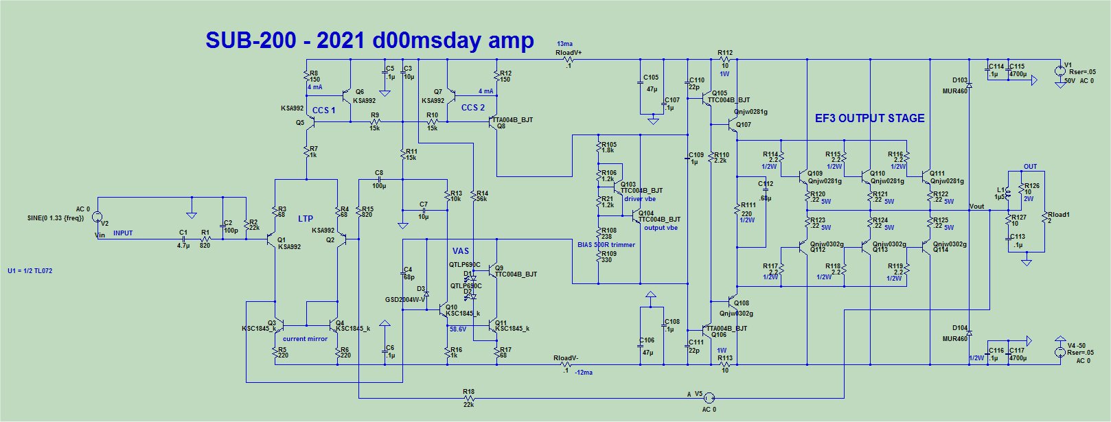

(below) is under 40$ in semi's.
The input stage uses less current than most op-amps - needs no heatsinks.
Use any 100V to-92's and any 150V to-126 devices.
The output stage has been built and lasts 30 years - it is my old HK
integrated amp EF3 (AKA "slewmaster").
Assured >50ppm full power 20 - 150hz @2R load.
R13/C7/D3 "trick" allows for all day clipping (till doomsday).

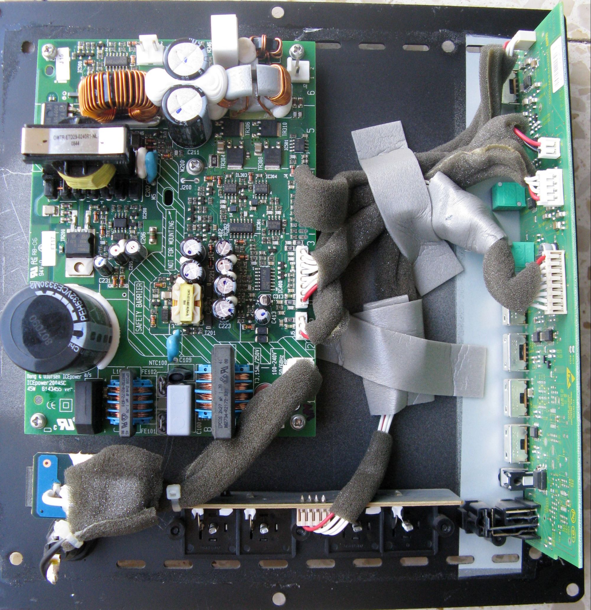

Nice "icepower" layout in the B/W plates (below).

I opened up my B&W ASW610. Its beautifully made inside. There's and input/signal conditioning/DSP board (all SMD) and output of that feeds into a single B&O ICE board that integrates a 45W Class D amp and SMPSU. Lots of foam around the interconnect cables etc to prevent rattling etc. The tag on the back says 'Designed in the UK, Manufactured in China
I paid £500 for it new - I don't feel ripped off having looked inside.

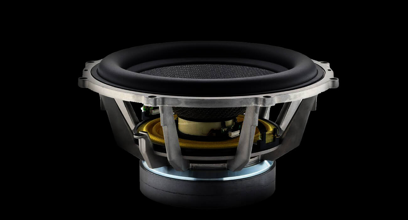

(below) is what you paid for. That woofer is one of the best OEM's I've seen.
To buy this , I would have to spend nearly 200$ for a dayton ultimax 10".
After I have bought all my parts , I will have 2 subs for 100$.
But not a ASW610 with that nice woofer , surprised they only have a
45w amp powering that.
Ohh , that is "woofer porn" -
