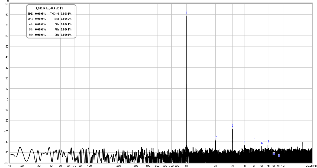

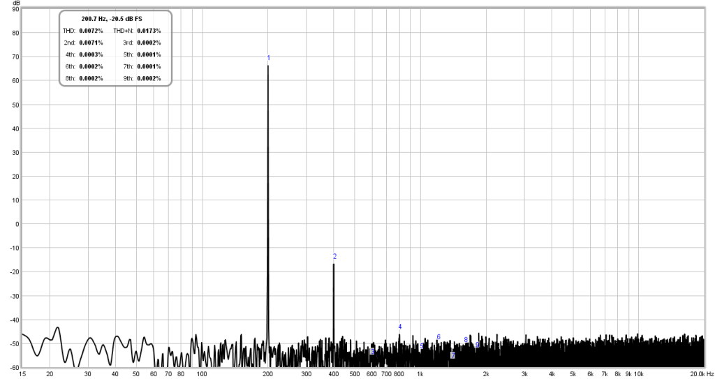

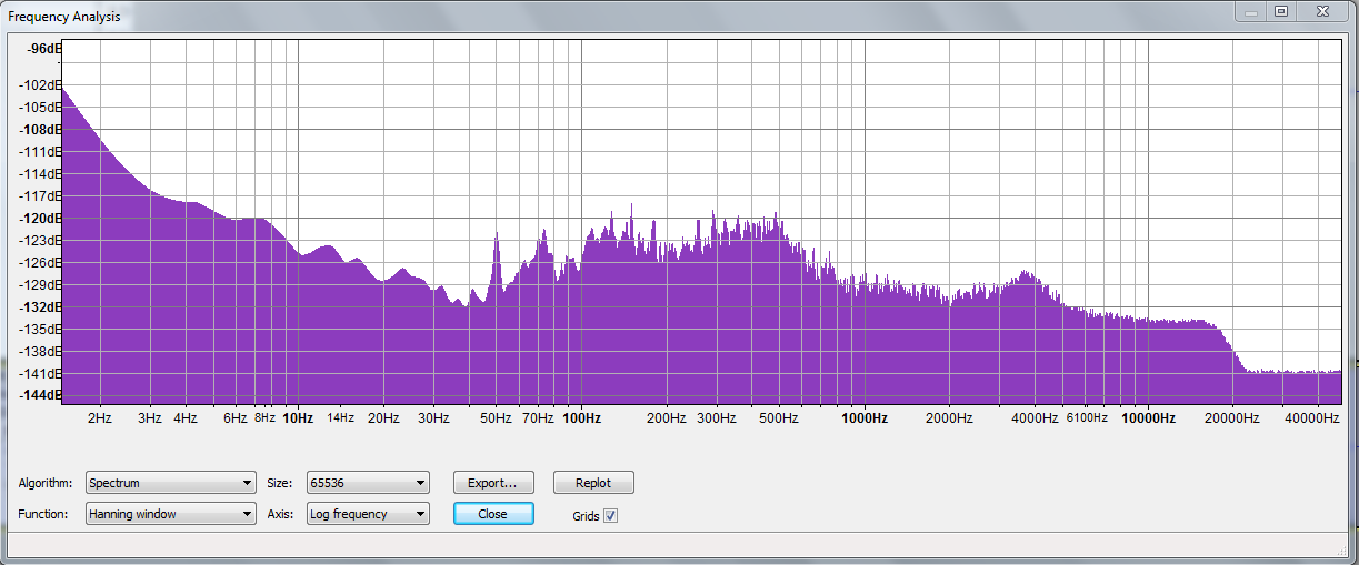

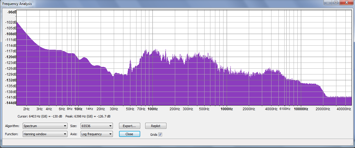

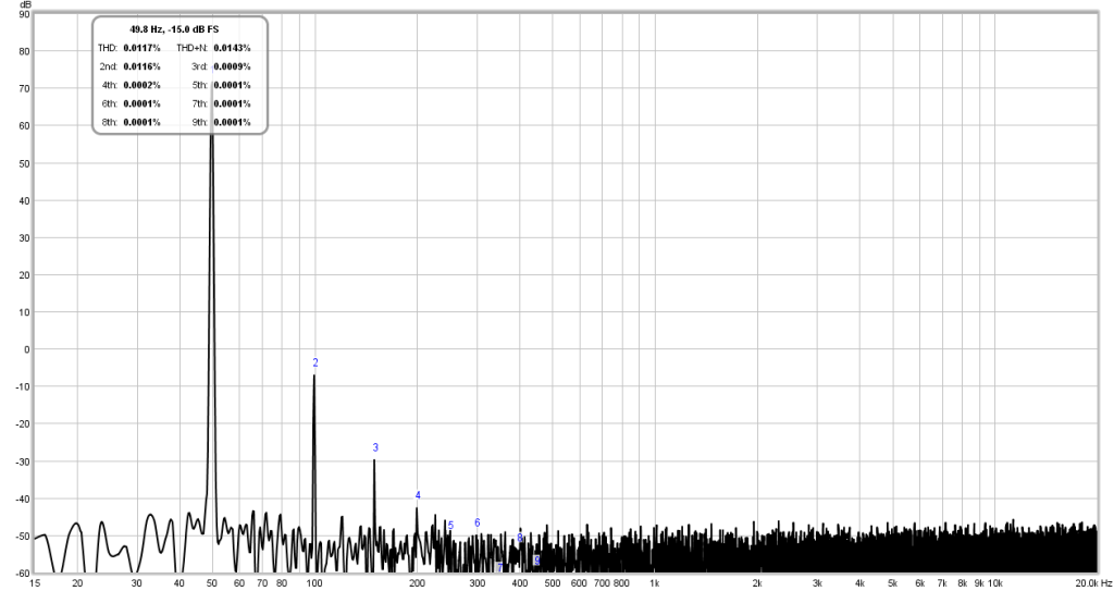

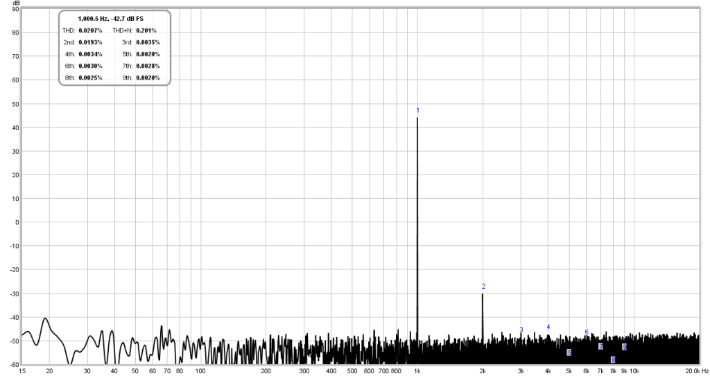

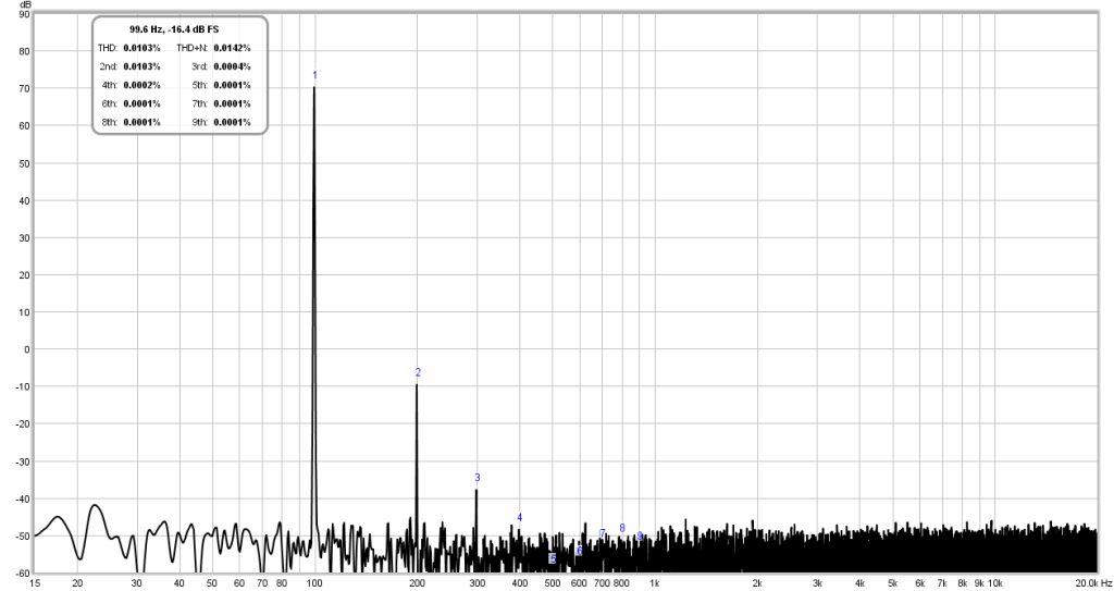

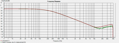

I've done Distortion tests tonight. Though they are not particularly valid, I think they show promise. My focusrite 2i2 has very good distortion performance when running in balanced mode. However the performance drops markedly when outputting balanced into a single ended load.
1st pic, focusrite in balanced loopback 1Khz.
2nd pic focusrite in unbalanced loopback 50Hz (yes I forgot to do one at 1Khz :rolleyes)
3rd pic synergy at 50Hz (note only marginally higher distortion than the focusrite unbalanced loopback). around 0.003 % more.
4th pic synergy 100Hz distortion
5th pic synergy 200Hz distortion
6th pic synergy 1Khz distortion (note that it is getting worse as we go up, but I think this is basically because there is less difference between the fundamental and the 2nd harmonic (ie the 2nd harmonic stays relatively constant but the fundamental is attenuated a lot more).

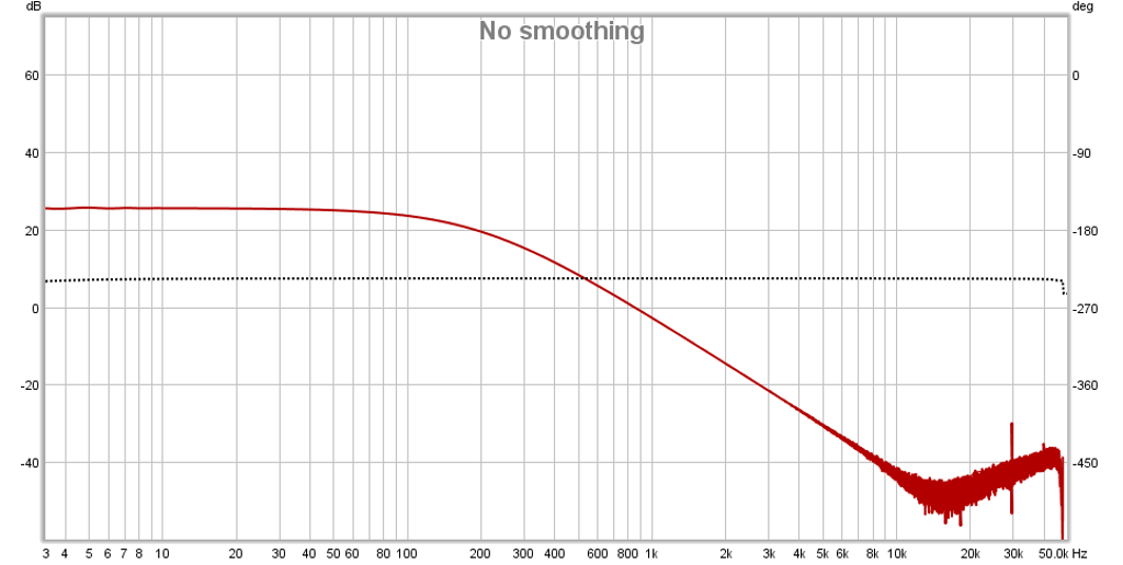

7th pic is the fr curve as REW sees it. The crud between 10Khz and 50Khz is what concerns me, and there does appear to be an abhoration at 30Khz.... I used to get this in holm on the breadboard, but it is much cleaner on the PCB.

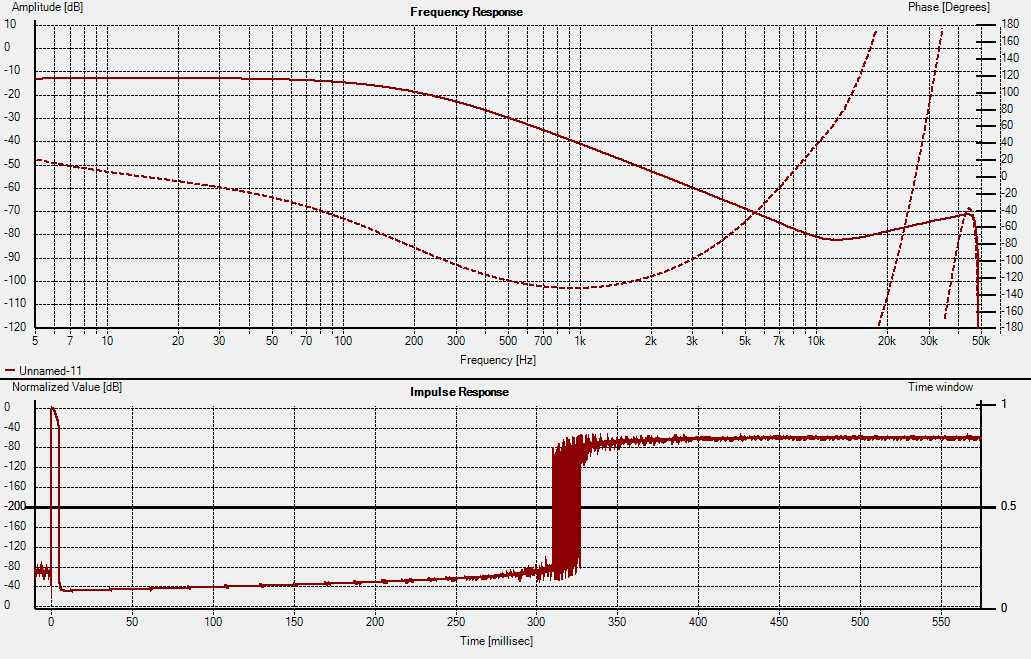

8th pic is holm impulse measurement. I clicked the reverberation button in the impulse response. I don't understand what it is showing me but I suspect it is a clue! 300ms seems a long way into the impulse though...

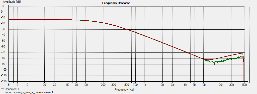

edit: added nith pic, which is rew measurement exported and imported into holm impulse. Interesting that it looks a whole lot better in holm impulse than it does in REW. I'm starting to wonder more and more about my measurements and whether it's simply time to build the proper ones and have a listen (I can here James cheering 😉 )
So the moral of this story is I need to get some of the LM opamps, and I also need to work on my little project for making a balanced to single ended converter so I can get decent performance out of my focusrite 2i2 when testing single ended equipment!
Tony.
