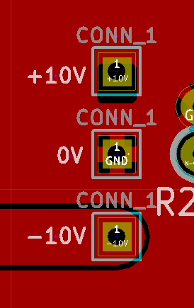

I got the boards today 🙂 Quality is excellent for the price paid! it came to around $28 US with shipping for the 10 boards.
There is an issue, but it is my fault, not the board manufacturers. I was trying to work out how I managed to do this, as I thought I had checked the gerbers over and over to make sure everything was fine. Then I remembered that the day I zipped them up and sent them, I was off work sick. Me not wanting to waste the opportunity decided to finalize and order the boards... silly me!
Basically I moved the +10V pin slightly and generated the gerbers again, I guess I didn't look at them before zipping them up and submitting. The problem is that KiCad doesn't automatically re-do filled zones when you move something, so the +10V is directly attached to the ground plane on one side of the pad 😱
Moral to the story is ALWAYS run a DRC before generating gerbers in Kicad. Second moral is no matter how small the change do check the gerbers again! Third moral if you aren't well enough to go to work, don't try and do something that requires dilligence!!
Anyway attached is a scan of the boards (and a screen shot from kicad showing the issue, which is quite obvious 🙄) , you will be able to see the problem. I'll need to use the dremel to cut a small trace around the pad. for each board, and then it should be fine. Hopefully that is the only issue!

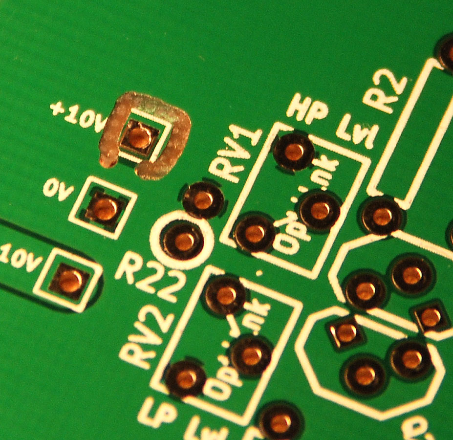

OK I've fixed the +10V issue 🙂 1/32nd router bit in my dremel with my stewmac router base did the trick. It's not as nice as a properly etched groove but it will do the job 🙂 all ten boards are fixed. The first one is a bit dodgy, I tried setting the depth on a piece of coated mdf but it was way off. It can be the experminenter board 😉
Hopefully no more "fixes".

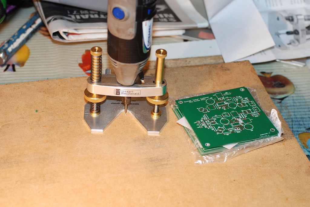

Where did you get that stand for the Dremel? It looks really useful. I got a rather neat press for the pcb drill from china (the only reasonably priced one that I could find) but that one of yours looks ideal for the larger Dremel type drills, especially if it's an adjustable fit.
Hi James, I got the router base here --> STEWMAC.COM : Precision Router Base
It's very nicely made. One thing that disapointed a bit is that it is not really able to be used (I don't think) as a plunge router. I was hoping I may be able to use it as a drill press (may still be able to using the depth screw but haven't tried.
I actually bought it for removing copper from pcboards. I just hadn't got around to doing that (non-etched) board yet 🙂

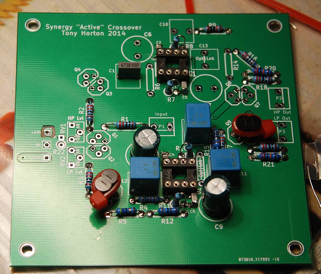

Making some progress. calling it a night. The board stuffing is going ok, no problems. Though one thing I have noticed is that changing out the opamps might be a bit tricky due to the closeness of the big caps. won't be impossible but tricky.
The SMD soldering leaves a bit to be desired, but for a first time I guess it is ok.
This is a quick and dirty one for making sure everything is ok.. just jaycar resistors and caps (though I had a few spare 1837's so have used those in the problematic low pass section). The final versions will probably get elna silmic II caps and prp resistors (except for a few which will probably be vishay's depending on how anal I want to get about accuracy between channels... the vishays would be 0.1%)
Note that RN60D's don't actually fit for the majority of the resistor positions... I had some and tried one and it is a little too long. They would need slighly bent under leads to fit. The PRP's fit just fine 🙂

Hi James, the solder is actually wicking through the plated through holes well. No need for soldering on the top side of the board as far as I can tell so far. I should probably have a look at the ground connections of some of the resistors with the loupe to be sure.
They are just plain old metal film resistors from jaycar at the moment. Had to piggyback two 10 ohm ones to get the 5 ohms I needed for one position. I might hook up the low pass before I finish the rest to try it out, since it has been the bugbear.

Yes they are the vishay MKP1837's 1% types and they are mostly the 100nF ones. They fit ok but it doesn't leave much manouvering room for getting at the opamp socket! James idea of mounting on the reverse side would solve the problem though if it proves problematic 🙂
Another annoyance has been that when simin a 3rd order high pass I need a 150nF cap for the second one and the MKP1837's only go up to 100nF... Will need to look at something else (probably a panasonic) for that one, unless I can tweak the values to get down to 100nF for that position.
Tony.
I'm forever adding 'things' to the bottom surface - I figure that as we use a double sided tracks, why not use double sided components, particularly if they're lower profile than the standoffs - can just // up another cap (to the 100nF) underneath to required 150nF value

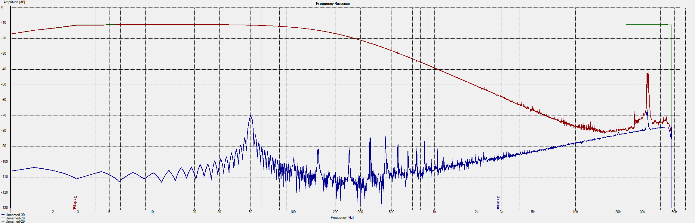

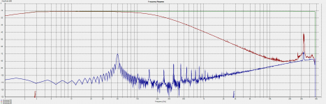

Well, I've fired up the low pass, stuck it on holm impulse, and I have to say I'm disapointed 🙁
It actually looks worse than the last breadboard implementation...
I don't know where the spike at around 32Khz is coming from. It could be noise that is being picked up, because if I do a record in holm with the input floating (ie just connected to my adaptor box) it shows a similar (though not quite as big) spike in the FR.
It could be that I am seeing noise that is burried normally showing up where the signal is attenuated sufficiently.
Anyway attached graph has green loopback of my focusrite 2i2 unbalanced. red is the synergy as built on the new pcb for the same freq (textbook 200Hz) as the breadboard circuit.
Blue is with the synergy disconnected completely... just the output lead off the focusrite dangling and the input lead dangling. This gives me some hope that the 32Khz spike is at least not something inherent to the circuit 🙂
Tony.

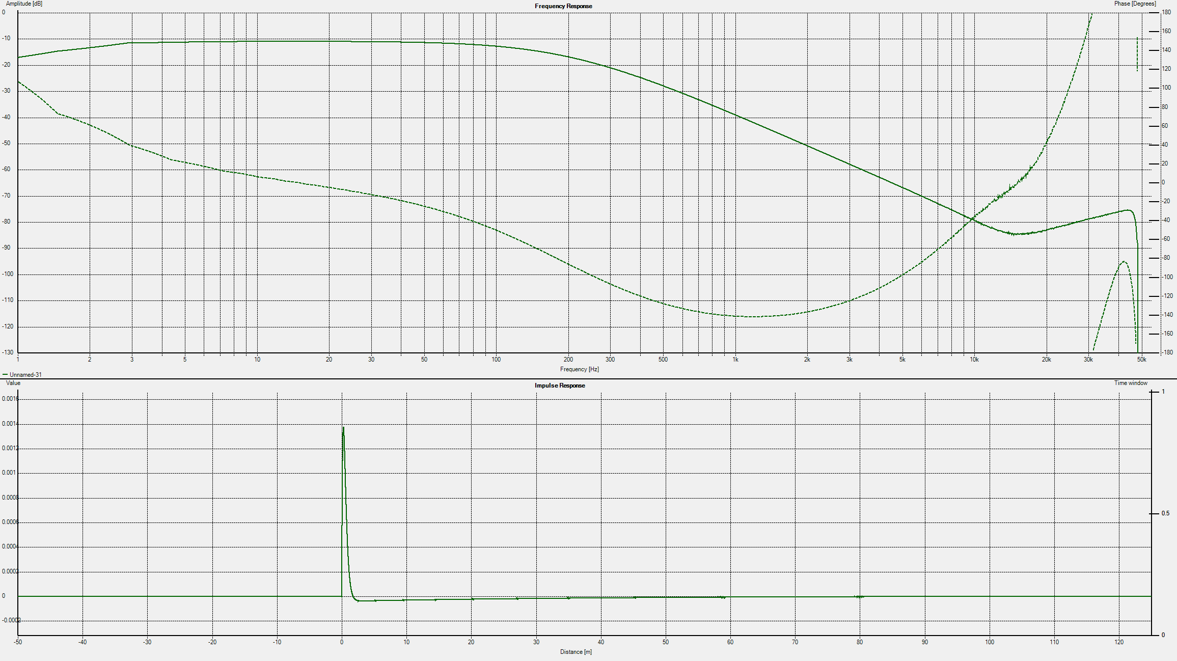

OK I had a break and came back and tried measuring a bit differently. I moved the focusrite onto the floor, and I plugged direct from the output to the synergy into my balanced in (without my normal little SE to balanced converter box (basically just a set of rca's and jack plugs wired with ring and sleeve to the earth of the rca and tip to the live of the rca).
Well it isn't 100% noise free, but it is close enough for me to put what is left down to measurement problems 🙂
I think we have a viable FDNR low pass filter 🙂 It will probably be a little while before I get something going that I can get speakers attached to but I'm feeling much happier about this now!
There are some glitches in the impulse response, and in the phase (note that the phase does go wacky in the sim as well, but only goes up to about +60 deg so I'm a little suspicious of the phase as measured by Holm)

Hmmm I could measure the noise floor I guess with input grounded. The test above is actually a swept sine test so need the input to get the effect of the filter on the output 🙂
I'm going to try some other tests. I might see what REW comes up with 🙂
