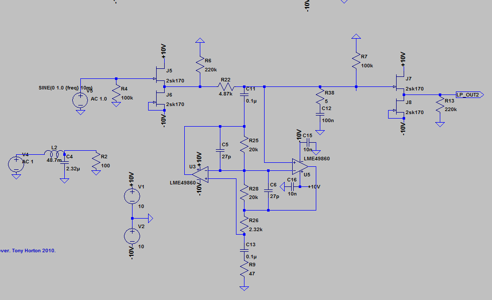

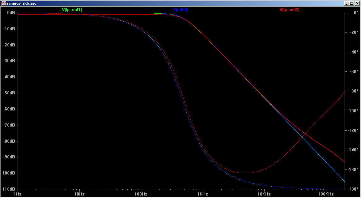

OK I've redone the sim and have values for the resistors. I also changed the synergy to have the 220K output resistors and 100K input resistors on the DCB1 buffer stages to better represent the load of your buffers. It didn't make that much difference.
I think that these values should provide a transfer function within approx 0.2db of your existing one.
Note that the resistor numbers in the sim don't match the resistor numbers on the shcematic and BOM I posted earlier, though they are in the same positions.
attached is output sim and the schematic fragment.
red trace is the synergy output. Please ignore the lower level before the corner freq, this is something odd with the sims. It does a perfect (no loss) transfer function in the real implementation, matching sims I did in PCD exactly.
R22 4.87K and R26 2.32K in the sim schematic are the two values you will need to get to best match your current transfer function with the RLC network.
R22=R4 and R26=R12 in the schematic I posted in post #205

Hi Andrew see post 217 first image for the lp_out1 VN008 is between R2 and C4 on the passive circuit on the left side. That passive circuit is what the active part is emulating... and that passive circuit is in turn a different realisation of Ricks RLC which is between a couple of buffers in post 217.
