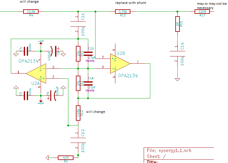

Hi Rick, the boards are on their way 🙂 Attached is the BOM I used with part-numbers from RS RS Australia | World Leading Distributor of Electronics, Electromechanical and Industrial Components and Element14/farnel http://au.element14.com/
I tend to be a bit obsessive about choosing components (http://www.diyaudio.com/forums/blogs/wintermute/119-problem-wanting-get-best-performance.html) so thought I'd let you see what I used.
You'll only need the components in the LP section of the filter. I'll double check which ones. Also I'll check which are the resistors that you will need to change for your slopes (will only be two and the other one will be a shunt as mine was third order).
I'm going to be pre-disposed for a while and may not have a chance to do any sims before you get the boards, so please be patient! 😉 If you can post a pic of the RCRC setup that would be good (I've not done passive RC filters before, I'm assuming it is R in series C shunt). I'm also assuming the buffers have almost infinite input impedance and low output impedance, I'll probably just sim it with some LM4562's configured as buffers which should be a good enough approximation for getting the slope.
edit: I've attached an annotated schematic of the LP section. One thing you may need to add is an output resistor to ground, if you do probably a 1meg would be ok, it depends on the input of your buffer. Let me know what it is so I can sim as too low an impedance may change the slopes.

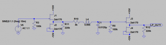

So here is what I am doing.
For low pass:
Buffer spec - the complementary Pass buffer with the 2SK170/2SJ74 -
input resistor - 100K
output resistor - 220K
The filter:
4000R series resistor - CARNHILL inductor measured .9950H - .0125 uF to ground,
This is placed between two identical buffers

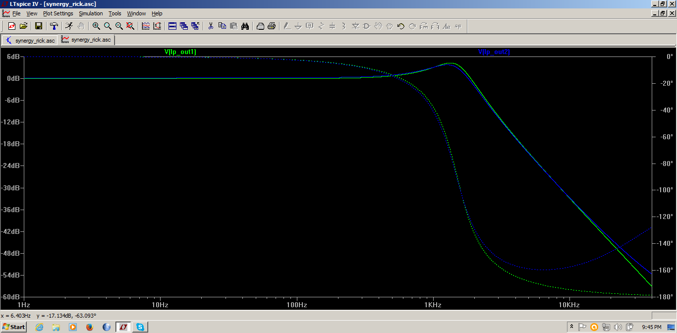

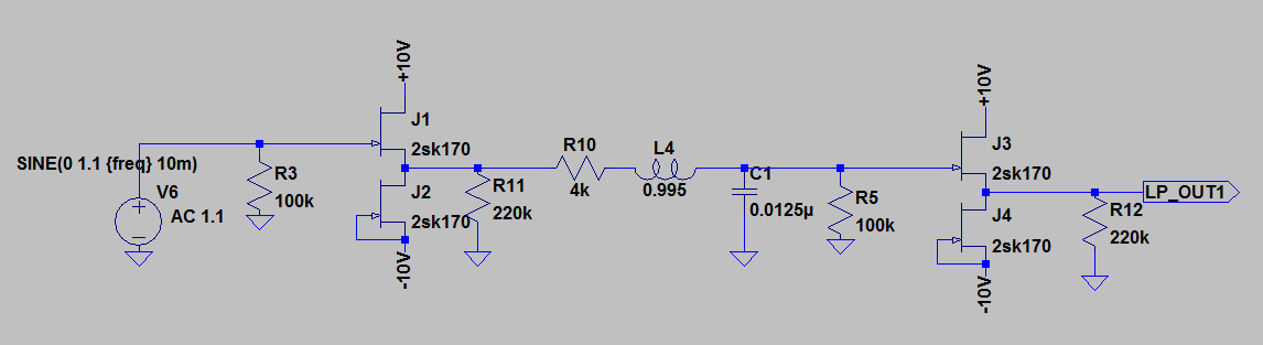

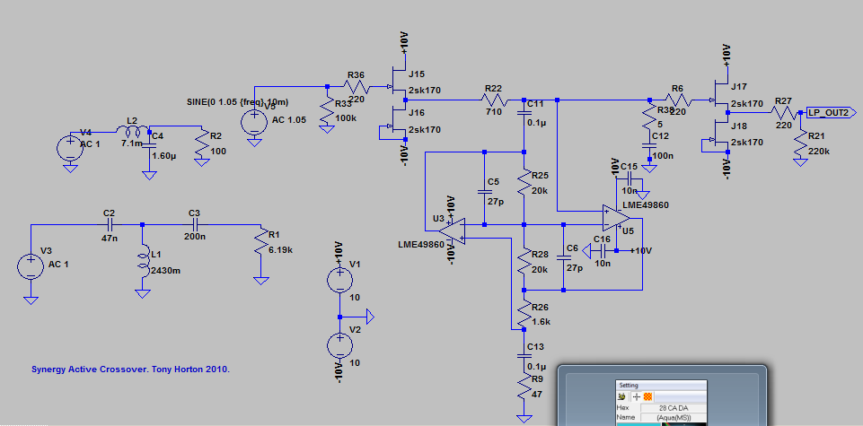

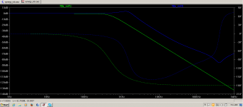

Hi Rick, I've simulated what I think you have (using DCB1 minimal buffers rather than the 2sk70/2sj74 buffer) For the transfer function, I don't believe this will make any difference, if I was simulating distortion then it would matter.
The filter seems to have quite severe peaking... What is your intended crossover frequency? Increasing the 4K resistor drops the peaking down.
I was able to make a passive circuit that will translate easily to the synergy that matches pretty much exactly. The sim of the Synergy implementation is a little off, but what I found was that in reality the actual implemented circuit behaves exactly like the simulated passive circuit, so I would say you could use these values to get pretty much exactly the response of your LC circuit.
The big question is though, is my sim of the LC right, and if it is, is that what you actually want! 🙂

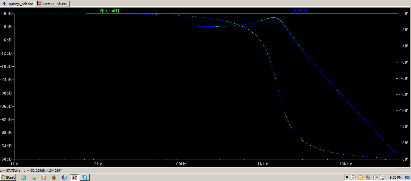

Attached pics: 1st is the circuit that I simmed to represent your filter. 2nd is the passive network (ignore the high pass) and the synergy implementation to match it, that matches the response of the simmed LC network.
Third is the response of the simmed LC (green) and of the passive circuit Blue. as you can see a pretty good correlation.
Fourth is the response of the simmed LC (green) and of the synergy (blue). Note that as mentioned in reality the implementation of the synergy matches the passive circuit in the sim up to the point where the phase starts to head up again (that really does do that). The level and slope match very well through the entire crossover region in real life. I'm not sure why in the sim it goes a bit off.

What you drew is what I have done.
Using the formulas here: RLC Low-Pass Filter Design Tool
It predicts a Q of .705 at an Fc of 450 hz.
I am just looking at room response so the peaking may be advantageous in that respect but it was not intentional. I do not see peaking but then it is blended in with everything else that is going on.
I would have thought the buffers more benign or this fellow's calculator is not accurate.
Very interesting.
Addition: I will not be disappointed if SYNERGY does a superior job!
Second addition: could you recommend values I use based upon your sims for Q 0f .7 and an Fc of 450 Hz.?
The filter:
I see the problem! 🙂 That should have been 0.125uF 😉
Response with correct cap value. Green being correct. The calculator looks fine.
