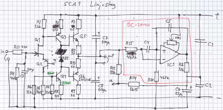

And here is a somewhat peculiar variation on the Rush cascode,
using a combination of JFET and BJT (Q1 and Q2).

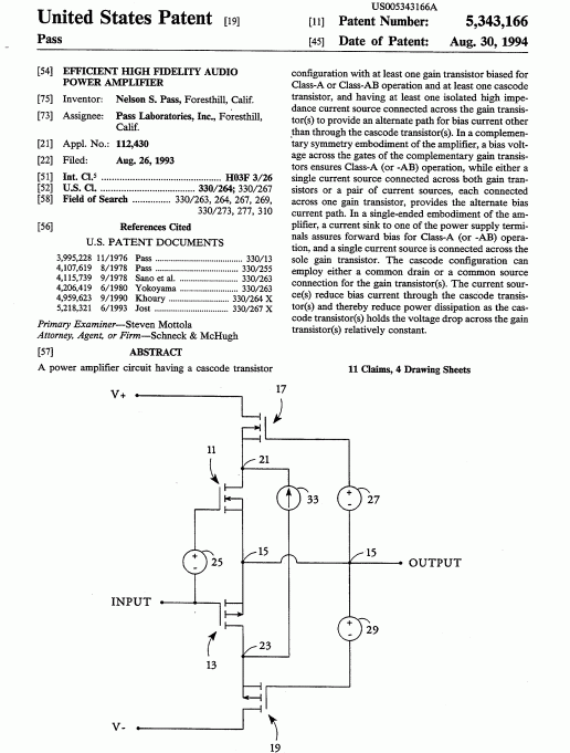

Cascoding the output stages makes the sound lack of dynamic. This is written in the A75 paper, when the authors considers not to use cascode in the output stage.
What about this patent of Mr. Pass? The device 11 and 13 is cascoded so the current source 33 can give big bias current in low voltage (less heat).
In this particular circuit, while cascoding will give lack of dynamic, what about the contribution of high current flowing? Will the total output of this patent similiar to ordinary output cascoding, or it will be compeltely different sound compared to output stage cascoding?
