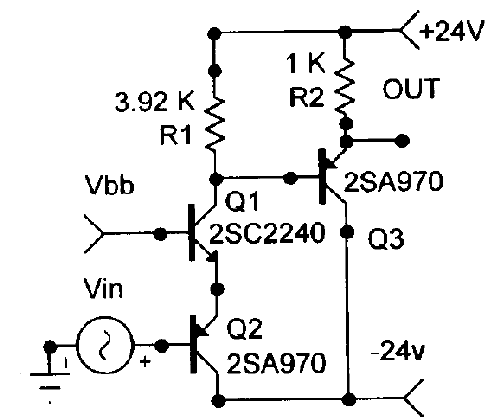

Now, may I return to my hobby horse, that pesky cascode? I am like a dog with a bone on this one, I love a friendly debate, and since I've built it and measured it, I know its performance, and the gain is huge. This is in sharp contrast to the diff pair, whose gain is trivial by comparison.
I don't believe it's a diff pair because a diff pair uses identical transistor types. These are npn and pnp, cat and dog!
I don't believe it is a diff pair because the same current flows through both transistors.

My last post (12-13 posts up) described a two-stage topology with a CE-stage loaded with 5 ohms on the collector, hooked up with a CB-stage. My point of argument is that this is not very far from what we do with a cascode, where the collector is loaded down with the input impedance of the CB-stage. First we kill all the gain of the first stage with a few ohms on the collector, then we use a high gain stage to restore the gain again.
Back to listening. What I hear with cascodes is a kind of vividness when transients are processed. A vivid sound is often the result of high uncontrolled gain. Now, doesn´t that fit a CB-stage ? This would imply that the sound of cascodes comes from the CB-stage rather than the CE-stage.

A cascode can be built with the same type of devices or different types in the case of an inverted cascode. A differential amp responds to a differential input and ignors common mode input signals (for the most part, it is not perfect in common mode rejection) If identical load resistors are connected to the collectors of a complementary diff amp, a pnp and npn collected at the emitters, the outputs will be equal and out of phase signals just like a long tailed diff pair. I can't see any difference in terms of basic input to output performance but only differences in biasing and DC levels.

If, however, we have the same current flowing through both transistors such that both share the same peaks and troughs, then can this truly be called differential? The word implies conjugate, surely; as one current through one device increases, then the other decreases. This is the differential action implicit in the use of the word, I suspect.
In any event, in my view the exact description is not the issue. This beast has very high open loop gain, and is thus useful for topologies which feature lashes of global feedback. In this sense, the building block has promise for fostering high bandwidth, low source impedance amplifiers, and this is what I wanted to emphasize.
The primary issue with global feedback is the quality of the voltage division at the feedback node; it is seriously compromised by the highly distortive capacitor used as the DC blocker. Of course, this does not apply with JFET diff pairs. Thus I believe that voltage amplifiers of this configuration are useful as building blocks, and would like to draw attention to them in this forum since they might be made to work in otherwise conventional amplifiers.

This beast has very high open loop gain.
Just how much? And at what bandwidth. Inquiring minds want to know.

Jocko,
This hurts; I did this work about four years back. Let's see, we measured at 1KHz with 6mA, CCS, PNP at the bottom, NPN cascoding, driven from a PNP diff pair. A green 1V95 LED was used as the voltage reference for the upper base.
Bandwidth was tricky to measure, but oscillation was around 5MHz if the lag compensation was under about 22pF.
The circuit was inserted into the voltage amplifier of a conventional Bailey topology (without the output stage). The Zout was 3 ohms as I recall, indicating a huge feedback factor, but I didn't do the math. Given that the same topology with a single transistor in common emitter at the voltage amp gives a Zout of around 35 ohms, indications are that this delivers an OLG at least an order of magnitude higher.
It's worth noting that stability can be improved at the cost of gain by degenerating resistively between the emitters. This techique is extremely effective, and only about 10R is required to pull back OLG by about half.
Jocko, that's the sum total of my memory. It's an interesting circuit block, and shows promise, but of course it must be said that the use of lashes of global negative feedback is extremely politically incorrect, and you risk invoking the marketing kiss of death if you implement this in a retail product........

What is the quiesent current? Gain of 50 or 50 dB? Spice model with 5mA in comp diff pair gave gain around 80. Same gain for 2240 diff pair with 5mA current source. Still looks like a diff pair to me and even measures like a diff pair.......
