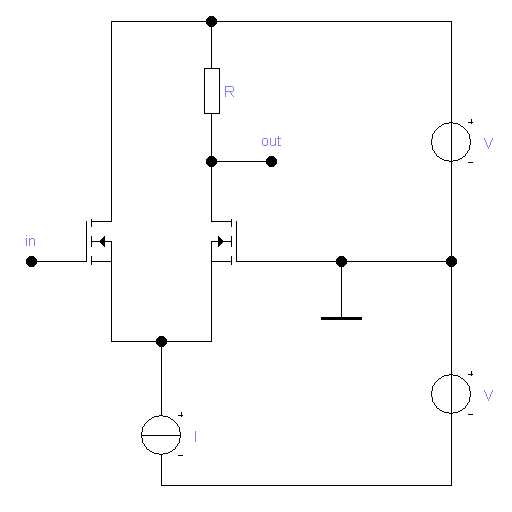

I wish to ask the board about the following "cascode".
Take a CE-stage and load the collector with a mere 5 ohms. Then connect a CB-stage to the collector of this circuit. The CE-stage voltage swing is very low (because of the low resistor) just as in a normal cascode. The output impedance is high due to the CB-stage.
Do we agree that this is a cascode ?
Back to cascodes please.

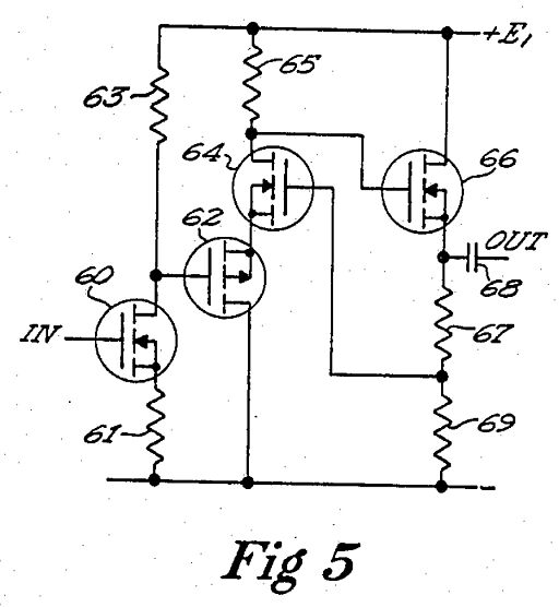

Is this a cascode?
<i><font face="serif">United States Patent 4,647,872
William Zane Johnson March 3, 1987
Cascode amplifier
Abstract
A stabilized Cascode Amplifier Circuit wherein the grid or gate control of the second stage of the cascaded input is provided by feedback of a portion of the output signal voltage. The circuit can be further enhanced by the inclusion of a unity gain follower between the first and third stage of the cascode amplifier circuit</font></i>
Cascode amplifier
Abstract
No...... transistors 62 and 64 form a differential pair. Transistor 60 is a common source inverting stage with source degeneration and transistor 66 is a source follower. I don't see any cascode.

You could plausibly argue that Q62 is a follower and
Q64 is a cascode, but that same description could apply
to a diff pair. The big difference would seem to be the
missing external current source for the diff pair, but I
don't know that this is required for it to fall into that
category.
category.
Animal vegatable or mineral
An inverted cascode has a current source and a regular cascode doesn't so that distinction maybe is not that relevent. I still vote for a complementary diff pair by my previous rational but I won't lose sleep over the matter.
Re: Animal vegatable or mineral
Cast another vote for complementary diff pair. I've also seen it described as such in a few older European electronic texts.

cascode is as cascode does
The crux of the matter IMO isn't how the parts are connected but about what is achieved in the end. The object of a cascode is to use one active device to shield another from voltage fluctuations and thereby enhance overall performance of the stage.
There's more than one way to do this, topologically speaking. For example, Horowitz and Hill's "The Art of Electronics" shows how a simple long-tailed pair can be connected as a cascode -- although sticklers might insist that this is more of a folded cascode -- but the effect is the same in the end.
I agree with HH et al that if the circuit doesn't achieve this effect, then it's not a cascode, even if it resembles one superficially.
