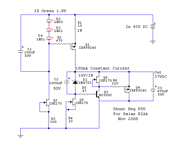

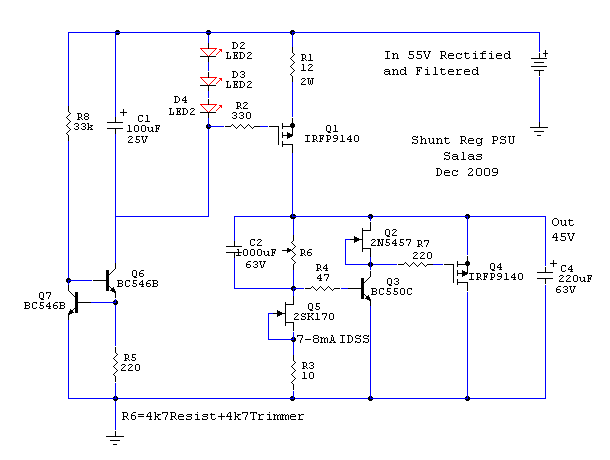

Are there any advantages in your new Dec. 2009 design to the 2008?

Apart from the resistor being a more reliable ref considering noise against average zeners, the right one is the same. It only uses a ring of two BJTs instead of a Jfet in the CCS tail for max voltage reasons. Its a 45V out schematic. It uses a lower Idss Jfet than a BL for thermal reasons of the TO-92 BJT underneath at nearly such vce, as well.

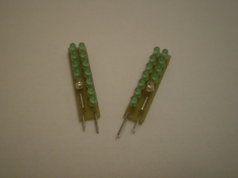

This is the board, copper is 2oz!😀

That is not a latest design, just adaptation for 45V. Remote sensing works for the subjectively better on it too and without problems as Ricardo Cruz reported. The buffer is a 1.1 advance that needs careful placement as you know. It pays back in more resolution too IMO, can be a bit ''lean'' in systems needing 1.0's ''roundness'' more, though. It worked in different gain and B+ 2 phonos of mine, and in your dual reg on OpAmps for the better, but Ricardo for instance had oscillations in his layout and got some of the performance lift by choosing the remote sensing route in the end. So the standard for all should be the easy 1.0. Its SUV all terrain, well received and liked. I recommend remote sensing on that for some carefree improvement when with a bit of excess wire. OTOH you have no reason to go a step back. Remote sensing may cover more ground towards your sonic blend goals and is worth testing on your dual 1.1. It is just the more things we add, its getting more technical, stability margins narrow, and becomes less plug n' play. Also taking out the buffer and reverting to 1.0 for a comparison is a piece of cake. Just a jumper.

I saw schematics with and without C1 over the three LED´s. Is therefor a specific reason?

In some it helps enough with ripple rejection, in others not that much. Whatever does not contribute much I skip it.
