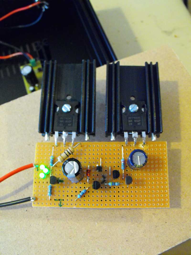

Another Salas Simplistic Shunt!
Up and running this afternoon, so I'll leave it on for a couple of days, so that it feels at home, before I have a serious listen.
Set for 5V, using a 4V7 zener, and gives 5.06V out. Volts drop across the current set resistor is 1.9 Volts-ish, and the resistor is 10R2, so roughly 190mA.
This will be powering Vd of my B32, but will soon have the parts on the way for the two 15V supplies.
Once I've had a good listen, I'll report back!
Thanks again, Salas and Ikoflexer
Nicely done!
Now that you have it working, there are two things you can do to improve performance by quite a bit. First, use a quieter reference. If you could see the noise coming out of the zener, you wouldn't hesitate. This mod addresses the zener noise which is amplified by the bjt that drives the shunt mosfet. A 1000uF across the zener will decrease the noise, but it's still there. For 5V you can use two 2V LEDs and a diode.
Second improvement can be had by using a super-beta bjt to drive the shunt mosfet, such as mpsa18.
Nicely done!
Splendid advice, you seem to know how to appeal to me!
I have two 2.4V leds sorted out, and ready to drop, but will be having a listen to the base version first. I also have a bag of MPSA18 from another project, which I can use.
When it comes to the hfe of the bjt, how high is too high? I ask as I do not want to get in osciallation. The BC550C I'm using at the moment is about 520ish, which was the lowest in the bag.
With this version, which we call v1, there is little chance of oscillation. The mpsa18 will have quite a bit higher hfe than the bc550c, and it didn't oscillate for me. But it's easy to try and see for yourself.
A third improvement, use as small an output cap as you can get away with, and short, thick, cables to the load. The best is to have no output cap, but that leads to oscillation sometimes.
I think you have enough tweaks now to keep you busy for a while. Let us know your impression once it settles a bit.

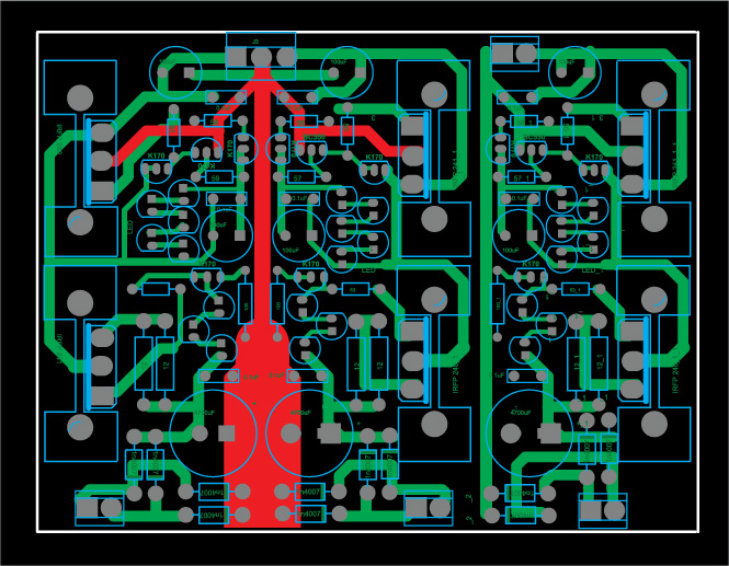

i do that and I layout for may DAc, the sound is good!
But i want out put +- 5.3-5.5 v! You can show for me change leds???
Thank you very much!
You can see my layout!
Just use 2X2.2 Vf leds and jumper the rest. In what position and for what circuit it sounds good? Can you expand on what you compared it with? Thanks.
