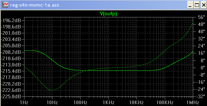

So, let's laugh together at another one of my simulated fantasies. Here's the psrr of a new regulator I'm working on, possibly v4. There is a RC filter before the regulator (R=60R, C=4700uF). The output impedance is not affected by the filter.
OK, we all know reality is not so, but hey, it's nice have a target.
