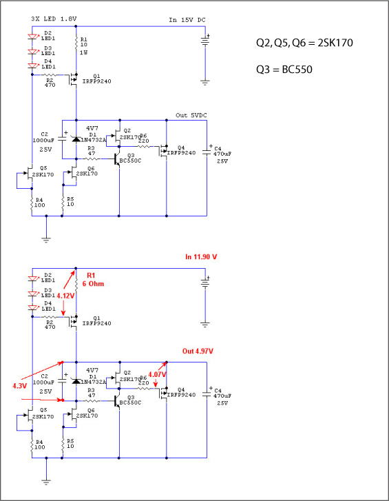

I want use shal shunt for my DAC, out put +5v and -5v, but In my contry I dont fine 2SK170 and Bc550 in you cricuit Q2, Q5, Q6 = 2SK170, Q3 = BC550.
Aloso What transitor I can replaced 22SK170 and BC550???
Can you show for mee. Thank you very much

As a replacement for 2sk170 , can you find 2n3819 in your part of the world? If not, any n-channel jfet with an Idss of 6-10 mA can be made to work. As a replacement for bc550c, can you find 2n5088, or 2n4401? Ask your local electronics store for an NPN transistor with higher gain. That would be what I would try.

Don't do it. To use a higher pinch off than -0.5V that the 2SK170 provides, takes to lift the Vbe margin with a resistor under the BC550. That will squeeze the voltage across a lot. The output Mosfet can measure 4V Vgs for instance. Use a transistor shunt.

It will work alright. But when able put the 470R because its damping it a bit better in this particular schematic.

In the circuit linked above, Q5 (fed from the LED's in the CCS) should ideally have an Idss of 5-10mA, Q6 (under the zener) an Idss of 4-5mA and Q2 (above the BC550C) should have an Idss of 5-10mA. With the BC550C we are looking for an HFE of 300.
I have sk170bl's for Q5,6 and 2
Hopefully I'm correct in the above, but feel free to correct me.
Larger HFE will give you a higher loop gain, and thus lower output impedance. I wasn't very careful with the Idss of jfets, used them all in the 6-10mA range, and everything was fine.

Yes on all counts. People try different % current going through the shunt, and set on something that makes sense sonically and/or as far as power dissipation goes. The 20% you mention I'd say is a minimum, to power a preamp. For a power amp, it's a different story. Worth determining the max load current you'll ever have, then top that with some percentage.
Hope this helps. I'm sure salas will have some insightful comments.
10R would give you 200mA. Roughly a 2V drop across it. If you feel that the sinks available get a bit hot, then use a 15R 2-5W R1. That will give you roughly 150mA with most Leds. Measure 2.2-2.3V drop across R1. At such power levels, it is good to run enough current so to keep the Mosfets alive enough for transcoductance. Since you will use some sink, better let it work.😉
