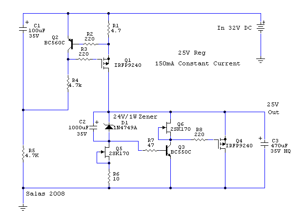

In my T-Amp shunt, I just specified about 25% on top of its peak demand (two channels). We can't practically have the luxury of double the current in a heavy situation like with power amps. We retain most of the benefits for +20% peak setting, plus at Ampere and over settings, the gm of the Mosfets is much better and they compensate subjective loss to our general practice. All in all a sonic blast from just a capacitor filter anyway. If you have headroom so the minimum 5V Vin-Vout drop won't make you lose much power, try it. Of course if someone is thinking of a shunt before ordering the mains trafo, just allow for some extra Volt, no problem. Can even burn it with still beneficial RC filtering if will not use a shunt, is always better to have some spare.
@anatech
nobody is saying that single turn is inferior.
I recommended multiturn for only one single reason: with single turn trimmer you won't be able to precisely set desired shunt current.
Agree with you, after desired current is set, measure resistance & replace with fixed resistor to avoid possible problems.

There is no universal design for all, too many variables. For proper design, you have to know VLED and Idss of JFET bellow and desired shunt current, then can you individually restrict adjustment range with resistors.
If you use single turn 500 Ohm trimmer, small movent of wiper & your shunt current will jump a lot.
You should use what you want to reach your goal, this is DIY 😀
I like to use simplistic approach with minimum parts and will use multiturn for fine adjustment, then replace it with only one resistor.

There is. If you use a transistor for Vbe CCS Vref (as I have shown in enough examples) then your current is more or less Vbe/R1.

My 5V shunt reg = shematic post#745, replaced D4 with trimmer.
With Rset 36.5 Ohm, shunt current is 250 mA. With Rset 105 Ohm, current is over 1A. This is very narrow range for adjustment.
If you use 2 resistors on each side of trimmer, as Chris sugested, adjustment range is even narrower.
To use 2 resistors, each resistor with value of 10 Ohm & set trimmer value to 0 Ohm, then Rset is 20 Ohm. With Rset 20 Ohm, shunt current is approx. 165 mA. For powering digital circuit with 20 or 30 mA consumption, this is too much, we are only producing excess heat.
Yes, I am using trimmer only during development & suggesting to use multiturn. It is easier to make fine adjustment 😀
Hope you understand my point & my bad English :smash:

By using external resistors on each end, you are expanding the range that you want to control. This makes adjusting the current (in this case) very easy and repeatable with a single turn control. This is the proper way to execute this design. That way you can rotate the control full one way or the other and the extra resistors will restrict you current range to some safe level that you have defined.
An example. Anyone who has worked on older audio amplifiers from the 70s to mid 80s (approximately) will remember that setting the bias on a Marantz was pretty easy to get bang on where you wanted it. By the same token, Yamaha amplifiers tended to have a very sensitive bias control. It was difficult enough to put the bias even in a range where you wanted it. Marantz used external resistors to make most of the adjustment range usable, whereas Yamaha did not. The result was that in a Yamaha, you only had a small usable range on the trimmer. This ended up compressing the usable part to a small section and the ends would either shut the bias off, or allow it to run to destructive levels.
Using a multi-turn control for development is not what I would to. It is usually easy to figure out what the range of resistance will (should) be. If you miss the target, change padding values a little. This is, after all, DIY where you should use good design habits. Yes, you can do things any way you want, but I think we should only pass on good habits to other members.
