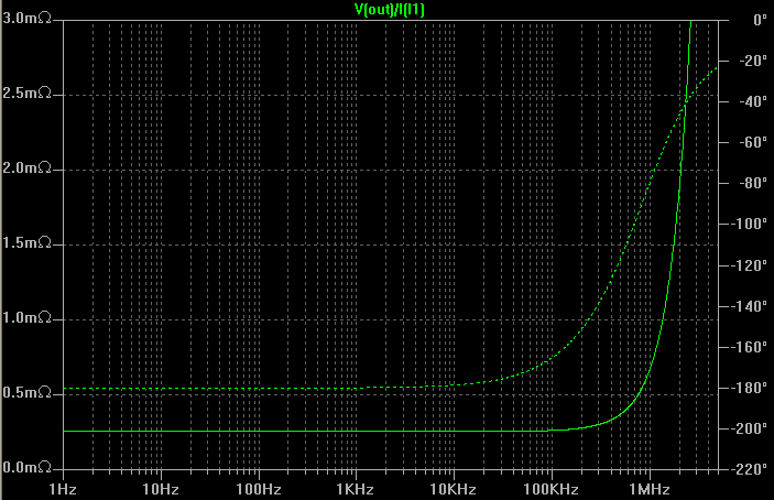

Hi stormsonic,
Here's how I see the situation. IMHO v1 is an excellent regulator from many points of view. I've said it before, I'll say it again: low parts count, easy to assemble, stable and robust to small parts variations. Very good psrr and output impedance. Have a look at the output impedance plot I attached, which is for v1. Look at the shapes. The dotted line is the phase angle. Note how Zout is pretty flat up to about 10kHz. The phase shift starts increasing pretty rapidly after 1kHz. There are some people who think that a flat curve to higher frequencies for both Zout and for the phase would be beneficial. See jbau's thread on the lm317/lm337 regulators
http://www.diyaudio.com/forums/showthread.php?s=&threadid=143539&perpage=25&pagenumber=10
for some arguments for this. v2 was the result of my trying to both lower and flatten the output impedance and its phase angle at least in the audio frequency. As soon as you want high loop gain at higher frequencies you get in trouble because it is highly likely that the circuit will become unstable and oscillate badly. So you see, we left the nice world of v1, where it's actually hard to make it oscillate, and enter the world of v2 and v1.5, where it is hard to make it NOT oscillate, while still maintain a small parts count, and have great performance (psrr and zout). Greater loop gain and wideband, sounds like RF, right? Hence the use of RF transistors in that position. It does not have to be the bft92, that's just one part that I happen to find while searching in a hurry for an RF transistor. There are many to use, but the higher the frequency of operation, the lower the chance of phase shift, and therefore of oscillation. Please correct me if I'm wrong; I'm just a beginner.
Another great thing about v1 is that you can make it work for low current, high current, low voltage, higher voltage, with almost no changes to the topology, and with just a few resistors changed here and there. Unfortunately, v2 and v1.5 are not as universal. That's why, for a specific application, it seems I have to change it quite a bit to make it work well and stable. I'd say that v2 can work well for lower current type applications (< 200mA load) where you want very low output impedance with a flat shape well into the 100 to 200kHz range. I was thinking specifically that DACs may benefit from this. Tham used v2 even for some other circuit and he reports an improvement, perhaps because of the flat phase in the audio range.
Post 857 is the latest version of v1.5 and that's the one to try for flat Zout to higher frequencies, 12V output, and high current. I specifically put this together for Tham's request to power his t-amp, and I think I'll use something like this for my chipamp when I get some time to do it.
Sorry about so many changes, and any confusion this may bring, but really, we're exploring right now. With the time this will stabilize and as more people implement and give feedback, we'll improve it and have some sort of final recommendation. There are many regulators to choose from, and if you want something true and tried, v2 and v1.5 is not it yet. Welcome to the bleeding edge 🙂

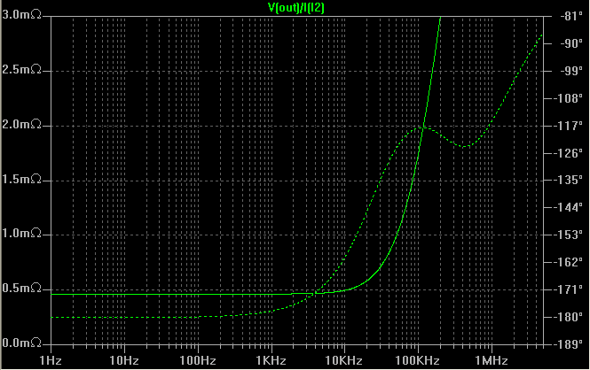

For comparison, so you see what I'm talking about, here's the output impedance plot for v1.5. Please do not read too much into it. This is just a simulation. In reality both v1 and v1.5 will behave quite differently, depending on layout and many other real world factors. We're just comparing designs here, until someone with proper measuring equipment can actually measure them and report the findings.
P.S. This simulation for v1.5 used mpsh81 as Q2, and mpsa18 as Q1, with 5R base resistor, and 5pF cap on B-C pins.

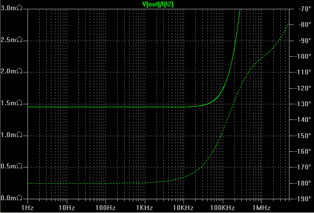

Salas said:
How will V1 fair for early HF phase turn if you substitute IRF9510s in the sim?
Improvement. But now it needs compensation at high freq, because as it is it oscillates. Probably a small cap on B-C pins of the NPN driver would do.
Standard stuff. You make it lighter for Ciss, it opens, but it gets more dangerous and ups impedance. Nahh, I prefer it conservative as it is V1. Better go V2 for more open, so we do it in the drive department.
