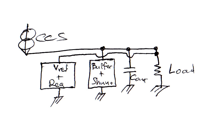

Like this more or less? (All grounds to a star I would prefer).
salas, I would treat both points of the "Vref+Req" module as sense points. Then their traces should be connected to the load and load ground points respectively, no? The load ground can go to star point. I've done some simulations of small resistance in the traces and it agrees.

ikoflexer said:
have another look at post 857. Is this more like it?
....................... many people see the schematic and automatically think that also shows the layout/connection points, which may often not be the case.
yes, now just flip over the whole central section to show everything in it's correct position (well almost).
I would show C2 connected at the top and bottom corners. Otherwise some will think it is important for the sense points to be connected to the cap.
It is important that the sense points are connected to the output terminals.
The location of the cap is much less critical.
However, Salas' comment on star connecting is very valid. Just identify the priorities since not everything can connect perfectly to the star. Some connections have to compromise.
IMHO, a proper layout should be done and the schematic used only as an rough indication of what the layout should be. I guess what I'm saying is that a proper discussion on the PCB layout should be done with a layout in hand, i.e. traces and all that.
Otherwise, I would advise whoever wants to implement the schematic to at least keep the two wires connecting the regulator and the load as short as possible, and the same length (seriously thick too).
Salas said:
It is best for the CCS to be connected with shortest wire to the load too? I.e. Schematically moved to the right?
the CCS mimics a very high impedance.
If the lines from it to the load or to the sense points are longer then these lines will have a bit of added inductance.
Any additional impedance from the voltage source to the shunt element improves the attenuation of the unwanted pulses/glitches.
But, stability must be maintained.
Here is where plugging in parasitics to the model and asking the simulator the right questions is paramount to understanding what the overall regulator is doing.
