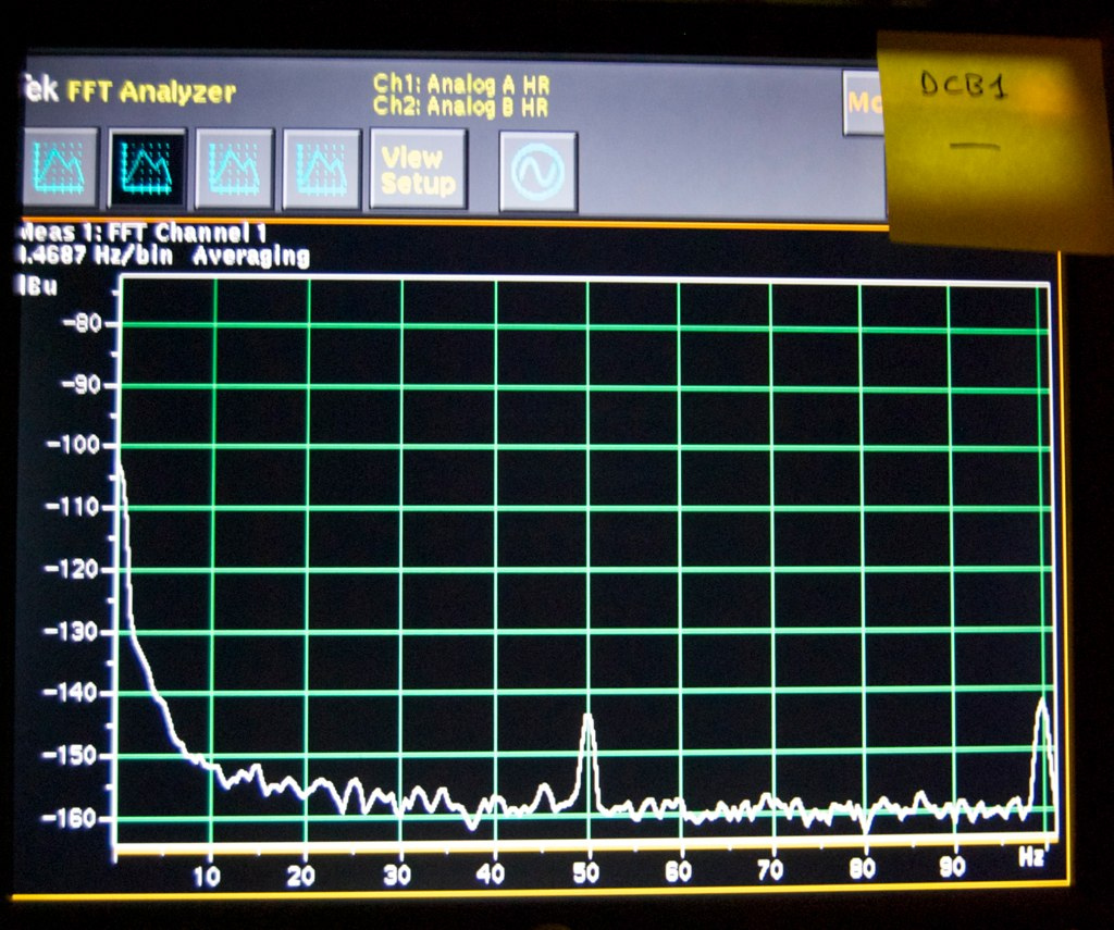

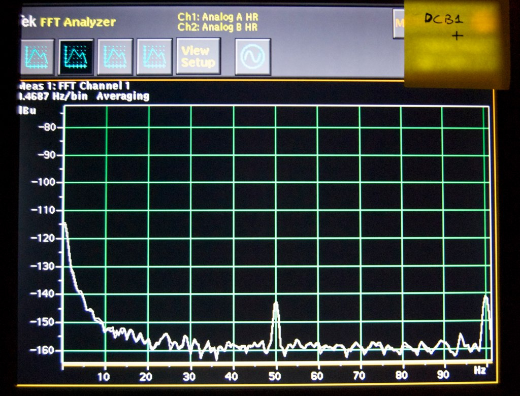

P.S. Here are two pictures from a Tek analyzer that a member from Spain once used to measure the rails noise on a Mezmerize DCB1. This is similar to yours (V1.0 family symmetrical, same MOSFETs, with K170s though, but LEDS instead of Zener with 100uF across them). I hope this will give you some kind of reference for your own measurements. I don't know what was his 0dB level setting in dBV though. Maybe I see a dBu mark shadow to the upper left. 0.7746 volt = 0 dBu. Good luck.

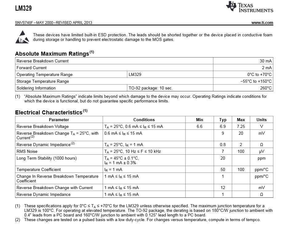

I'm fine with 16V. Two LM329 would be closer to 15V though.
Some recent enough LM329DZ I have in my drawer are measuring almost all at 7.1V. That X2 + 0.6Vbe = 14.8V

Really? Those should be darned close to 6.9 V! Is it possible you have a very loose tolerance, or that they are not genuine?
I have a bunch and they all measure close to 6.9 V.
-Chris
-Chris
They are from Mouser. The data sheet says they are within tolerance though. Maybe the room temperature difference between Canada and Greece at this time of year. I had measured them after I checked the Fluke with a Scott's AD581 10V Vref chip first, and it was bang on.
