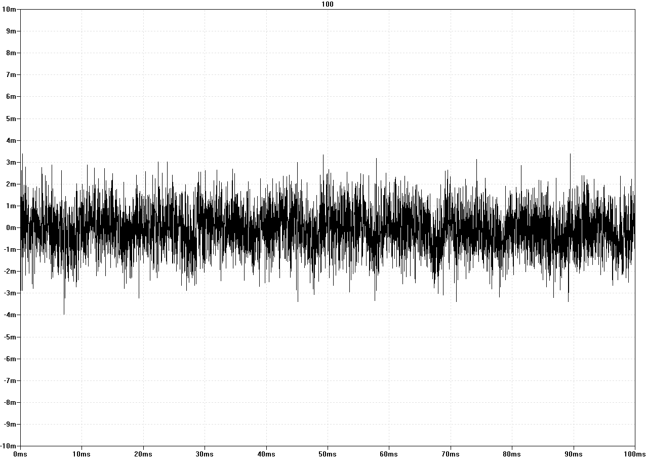

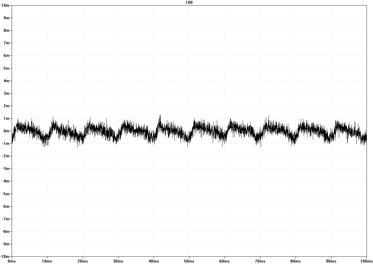

I got one of them borrowed by a member here to test it's performance together with an LM317. The attached example shows the Sipex part vs. an Estek el-cheapo. Schematic and more info here: LM317 regulator under test preamp.org
The SPX431 is through-hole and actually less noisy than your average 431. Might be the same die as the SPX2431, didn't check the datasheets.
Thanks! Yes, oddly the datasheets are not that similar, and in particular there is no noise spec for the SOT-89 and TO-92. Even the highly simplified equivalent circuits are different. A puzzle.

Not bad Brad. That's a pretty decent result.The noise across the 21.5k was indistinguishable from the Ap self noise, which was as I hoped. But 21.5k is larger than I would like
I'll agree with you on this.In any event, compared to band gaps and zeners, this approach for references is much lower noise.
-Chris
That's of course with the 1uF across the 21.5k, hence a NBW of about 11.6 Hz. It could be still lower with a larger cap.Not bad Brad. That's a pretty decent result.
-Chris
The major noise source is the current noise of the source resistor, about 2.67k, determined by the ~zero tempco conditions. With more FETs and higher currents the noise will fall further.

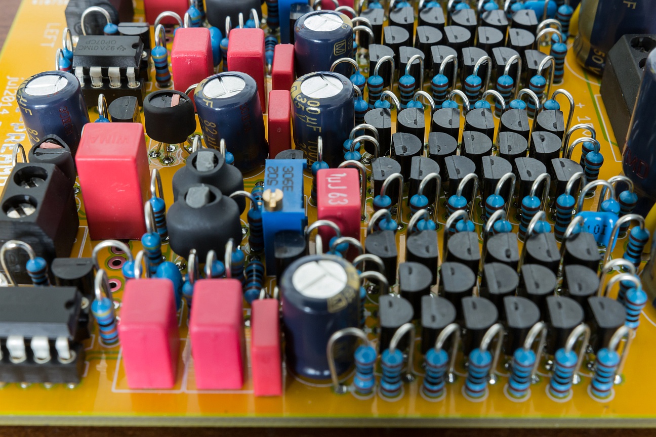

Here're some bipolar gangs
Heh!
My personal favorite using BF862: I stacked about ten of them using a tiny bit of adhesive from package to package, then ran a bus wire along the gate leads as both a composite gate connection and a heat conductor (the chip sits on the gate lead), then made similar connections to drains and sources. It worked, and had about the lowest parasitic inductance short of some hybrid using raw chips.
What a lot of antennas!!!!!

How do you feed all those little mouths? You have a small army lined up in formation - and yes, many antennas!
Hi Brad,
Did you just stick the assembly onto a board using one set of pads? You could use some kynar wire as guys!
Did you use round or flat wire? I'm just curious because you used the gate lead wire as a heat radiator (I think that's what you were getting at).
-Chris
