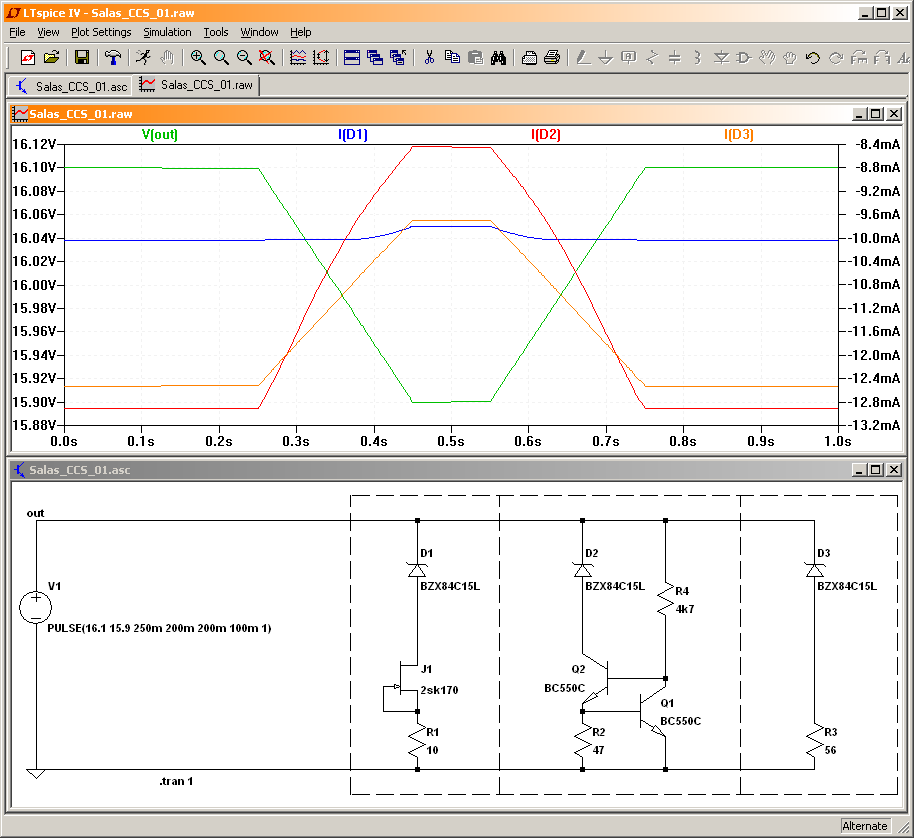

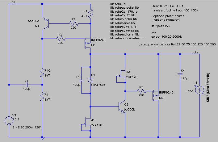

It is about the CCS made up of J1 in the circuit posted in #8 (attached here again for easy reference). Since it is paralleled by Q2's Base-Emitter junction, it should never have more than around 650mV of working voltage range, give or take a couple mV. According to a simulation in isolation, a CCS with any JFET needs at least 1V to be working properly, thus it will always be out of regulation, acting more or less like a simple resistor. The B-E-voltage will not rise above 1V under normal circumstances, so the question arises: Will a simple resistor in position of J1 be any/much worse than the CCS?
Things to consider: Does a JFET CCS in reality actually need more than 1V to regulate properly and hence the sim is actually predicting worse behavior here? Anybody made any actual measurements? Did anybody try this already or is willing to do it? I don't have any SK170's or something similar at hand, so I can't test it myself...
I tried to simulate three possible versions for a 15V zener and just over 16V output. The plot shows 16V output varied by 100mV in both directions and the corresponding change in zener current. The JFET clearly fares the best here and the bipolar CCS seems totally unusable with such low voltages. Except for allowing a higher current with greater voltage difference, the single resistor seems to keep up pretty well. It's advantages would be the cost savings and better possibility to adjust the current - it might be a trimpot, for instance.

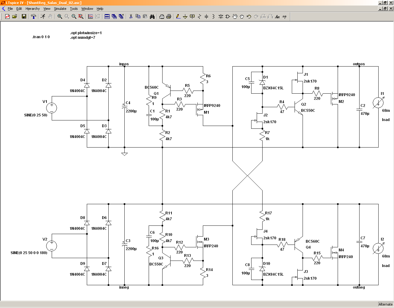

That's the one thing. Here's another thought: Since I'm planning on building a symmetrical version for 2x200mA, I could easily tie the CCS' to their opposite rails, together with, say, 1k each in line, for an increased voltage drop over the JFET so that it stays in proper regulation. Then it would also be possible to use a bipolar CCS instead, which seems to be a little more constant than the JFET (according to the simulator), and again could be more easily adjusted for desired/optimal current. You'll find a schematic of this idea attached. Unfortunately I couldn't figure out yet how you did those nice impedance plots... 🙁
Hi, please read posts 6831 - 6847 where J1 and its VDS impact has been discussed again fairly recently. In brief the JFET would do best with more voltage across indeed but holds better still than a simple resistor which is not that bad and if having no very low noise very low Vp J1 type, using a resistor won't break the deal.
Cross referenced CCSs among polarities we have not practically attempted.
